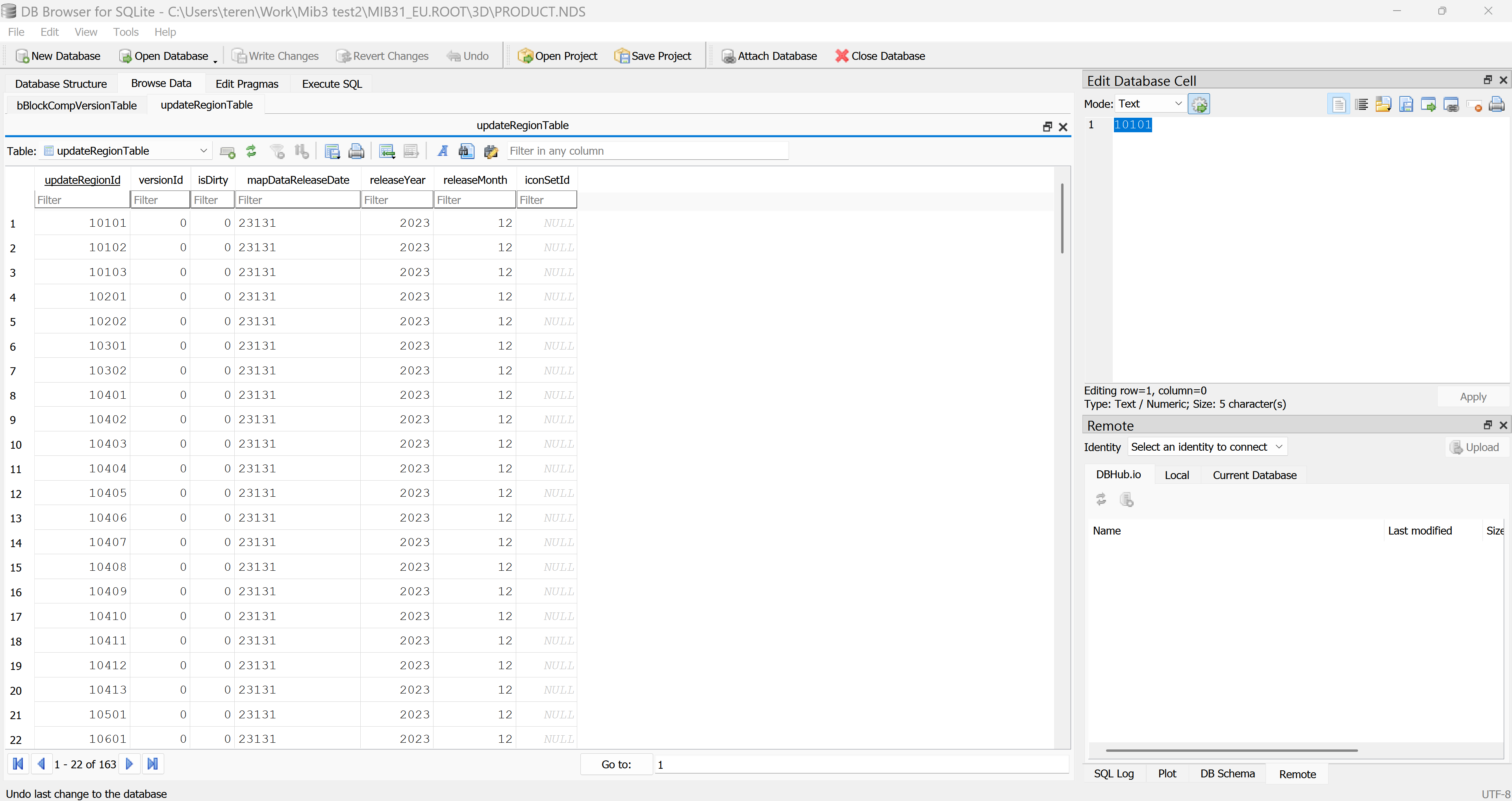

  • Update OI_P119_EU_202425_Offline_Update.zip contains data from 23.12 (YY.MM). You can check this for example in the MIB31_EU.ROOT/3D/PRODUCT.NDS file. This is a SQLite database, you can find this
  • I successfully opened the MIB31_EU.ROOT/3D/PRODUCT.NDS file in DB Browser for SQLite.

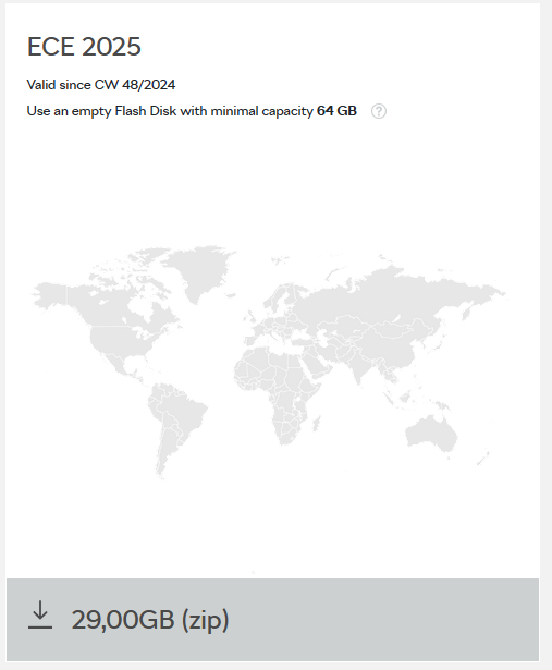

Been trying to update my mib3 for weeks now, my current version is software 0442 Nav Database 24.8, I have the latest version from the Skoda site ECE 2025, Valid since CW 48/2024....... Nothing updates, is that because the two versions are the same, if so, as a non techy how would I know, as the two versions don't seem to have any logical link......
The most recent offline is 24.6 which @MartiniB has posted at the top. Online services once you come off them there will be a delay of 6-12 months before you can do better with offline that is this thread, catching up process.
I had asked where in these files was the release code, on this thread and a kind sole told me:
This is really useful for us people that look across releases to study what each of the three main brands are offering, the files are interchangeable but not all are recent, for example Seat lags significantly in their offline free posted offer.
(You do need a bit of SQL database knowledge to poke about in the files... isn't something you need to do yourself if you take what's posted up as is... as said more for us to audit what is going on. Under no circumstances attempt to save these files after poking about since that wont work and they are encryption signature protected. Look but dont change, same with mib2 high... thats answers your question on how do you know.)
So MartiniB now takes a look using this method (I believe) hence he denotes the current one (which will change) as 24.6 tallies with the contents. Basically you have a freeze date, a preparation date, release date. The yy.mm tallies with what is on the screen in Mib3. The ECE information tallies with the previous mib2 high method of denoting the releases. The production cycle of map changes generally means it takes about a year before new items in Here Map files get released. Online has an edge of 6-12 months, you pay for that in the online subscription and convenience.
Thus the short answer if you are at 24.8 you can't out do that by 24.6. June 2025 you will.

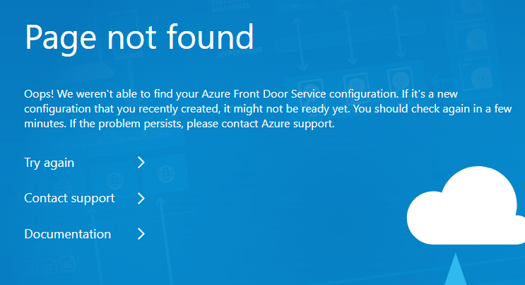

Just tried to download latest map updates from Skoda portal (https://updateportal.skoda-auto.com/en-GB) and entered my VIN.  It shows me a download link for a new map database zip file, but when I click on the download I get some strange 'Page not found' message.  If I click the "contact support" (thinking I could report the error to Skoda) it takes me so some Azure webpage.  Has Skoda deleted the map update file?
image.png.4363f730407222fe8b3ede6ed3822974.pngimage.png.f0cafd89532cabd54ab65fc64d2670cf.png

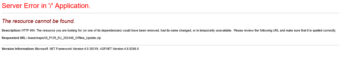

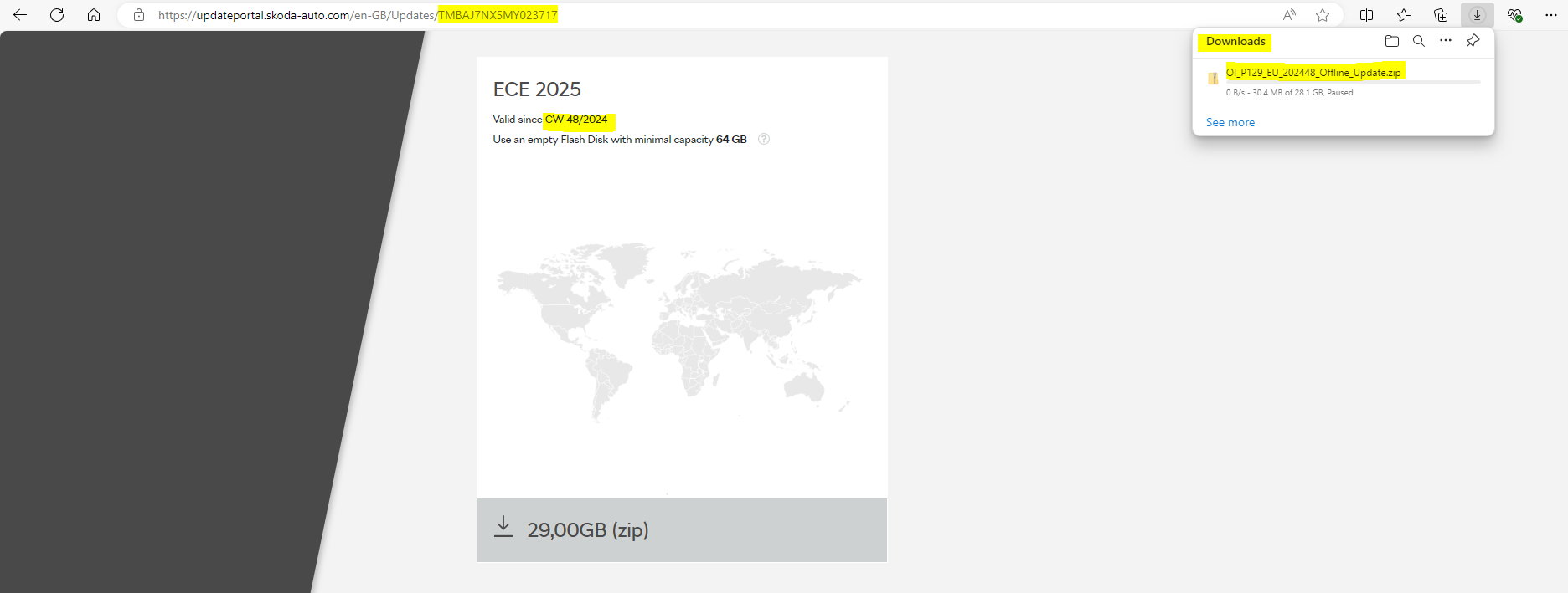

I also get an error message when I put my VIN in and hit download. (this is a Wi11 PC on 23H2, not the latest 24H2 update which is known to cause problems)
Screenshot2025-01-17at14-53-45Theresourcecannotbefound.thumb.png.651ba86b817812055e323e75f3624027.png
However, I downloaded a copy of OI_P129_EU_202448_Offline_Update.zip   on the 12th December 24 using a link from somewhere on this forum.  So it does look like it might be a problem at Škoda’s system.

Basically, their file servers must have been down. MartiniB publishes the direct link rather than wrapped in a webpage.
Edited by Tell
The download link now functioned. The problem is solved. Thank of all
Yes just down time.

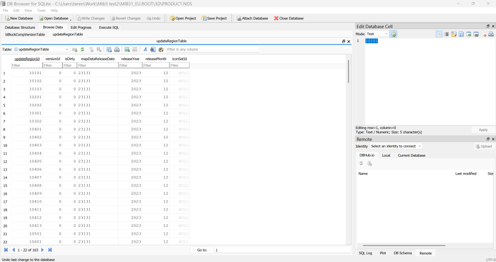

Using the @c34 method... I need a youngsters again🤣, I can't find that bit in the file to read YY.MM. That would be the cross check of the VW file verses the Skoda
Still we got the Skoda one working now but a worked example to where that is in the VW file would be useful.
OK sorted that VW link which VW people are getting pointed to is older than the Skoda files:
The all important file was missing when I used 7zip to unzip the TAR files. The built in explorer gave us
\MIB31_EU.ROOT\3D
So we could use the @c34 magic on it... take away use the built in Windows Exporer but I reckon only @MartiniB and a few will be doing this checking.
