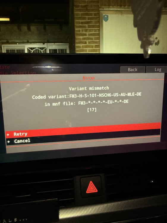

I have also tried to install this NavDB. My Karoq has N Africa maps preinstalled, but I need EU. But this NavDB doesn't suit me, because my Bolero is Preh, but this DB is for LG. Official update package is not installing

Can you give us the Youtube link to get to the bottom of what it does. The file comes off VAG servers so nothing from elsewhere.
2 hours ago, Sanchous98 said:
I have also found nav db for mib3 with North America region for audi (probably should work for vw, skoda etc, but i'm not sure)
https://vwgoa.app.box.com/s/zexspm3t3veqm5y4q893eid9gsvvv1kv
I found it in a manual for restoring corrupted navigation db
https://static.nhtsa.gov/odi/tsbs/2023/MC-10230844-0001.pdf
Thanks.
Ok the pdf seems to be the restore if it gets corrupted as it says. Will have a look tomorrow at what file it's pulling up.

Normally there is a parts ID on the file so shouldn't load into a unit that isn't compatible.  You have to study assorted firmware files and uploads to work out what it is. Firmware isn't compatible but whether you'd classify that as firmware needs studying. The maps are interchangeable within a hardware type across brands. The logos get driven by another brand ID check but compatible if it's listed.
