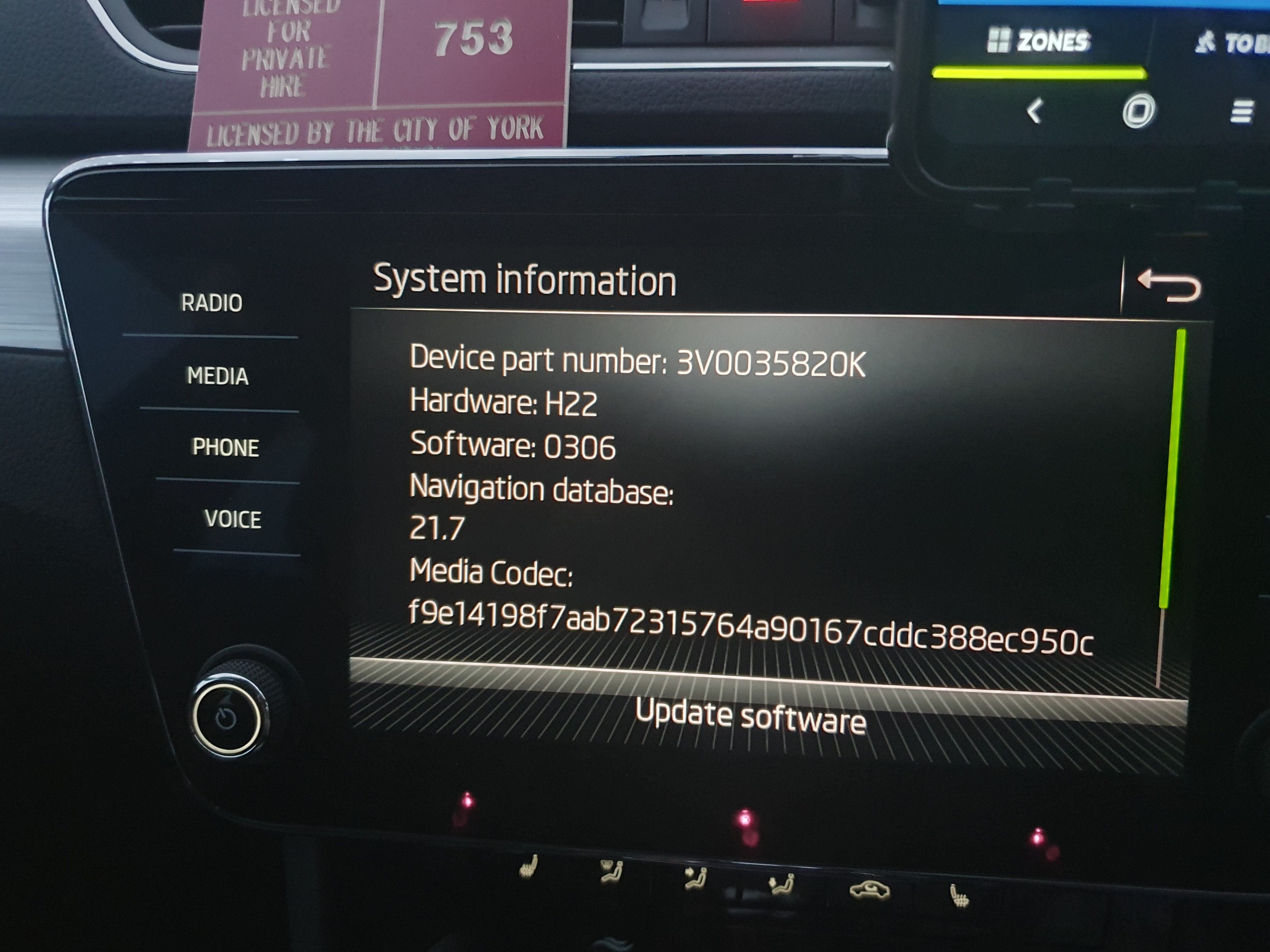

I'm at a complete loss with trying to find out if my maps need updating! I have just got a 2022 Superb. The system is telling me this:
Just been into Skoda and the tech guy says everything is up to date, and the car will automatically update over the air. My understanding from reading on here is the map version is 7th month 2021, the tech guy says it's just 27.1 release i.e. the next one will be 27.2. I don't even know how to tell what make my system is. Skoda's portal says it's Amunsden so I assume that's correct. Finding this so confusing!!
To me that's old 2021 month 7. Possibly for some reason it's not updating over the air. @MartiniBhas mib3 he may have better suggestions. I'd try the download above if you get fed up waiting. Either of those two links, if it's not compatible it won't do anything.
Thanks Tell. I've downloaded the above. I looked at the long press on the menu button today and that gave me an option to download over the air I assume, gonna try that over the weekend if not I'll try the usb option. Will post back if I have any luck.
Any advance on 23.12 with that file release above means it's taking it over the air. You lag with a 6 to 12 month period if you use the file loads rather than over the air but saves money on connect services (get out of contract). If you live in a 4g black hole like where I live it also has merit. Quite large down loads over problematic 4g, fine for people living or traveling in good 4g locations. Horses for courses.
Tried the update with the hidden/engineering menu, couldn't get it to do anything. Had the offer of Skoda Connect free for one month so gone for that and see if anything changes.
Checked today map version 24.8, so I'm guessing it updated because I got Skoda connect up and running for a month.
That's it.
