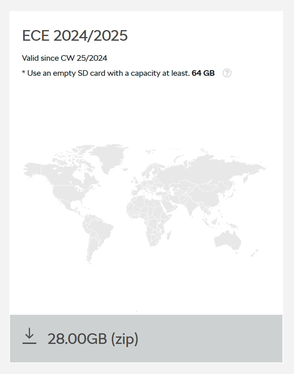

look, how is titled previous P119 23.12 on Škoda portal
This practice is standard behavior over years -
Titles of realized maps are half year forward while archive's content half year outdated
not hard to guess, new P129 24.06 will be titled as ECE 2025

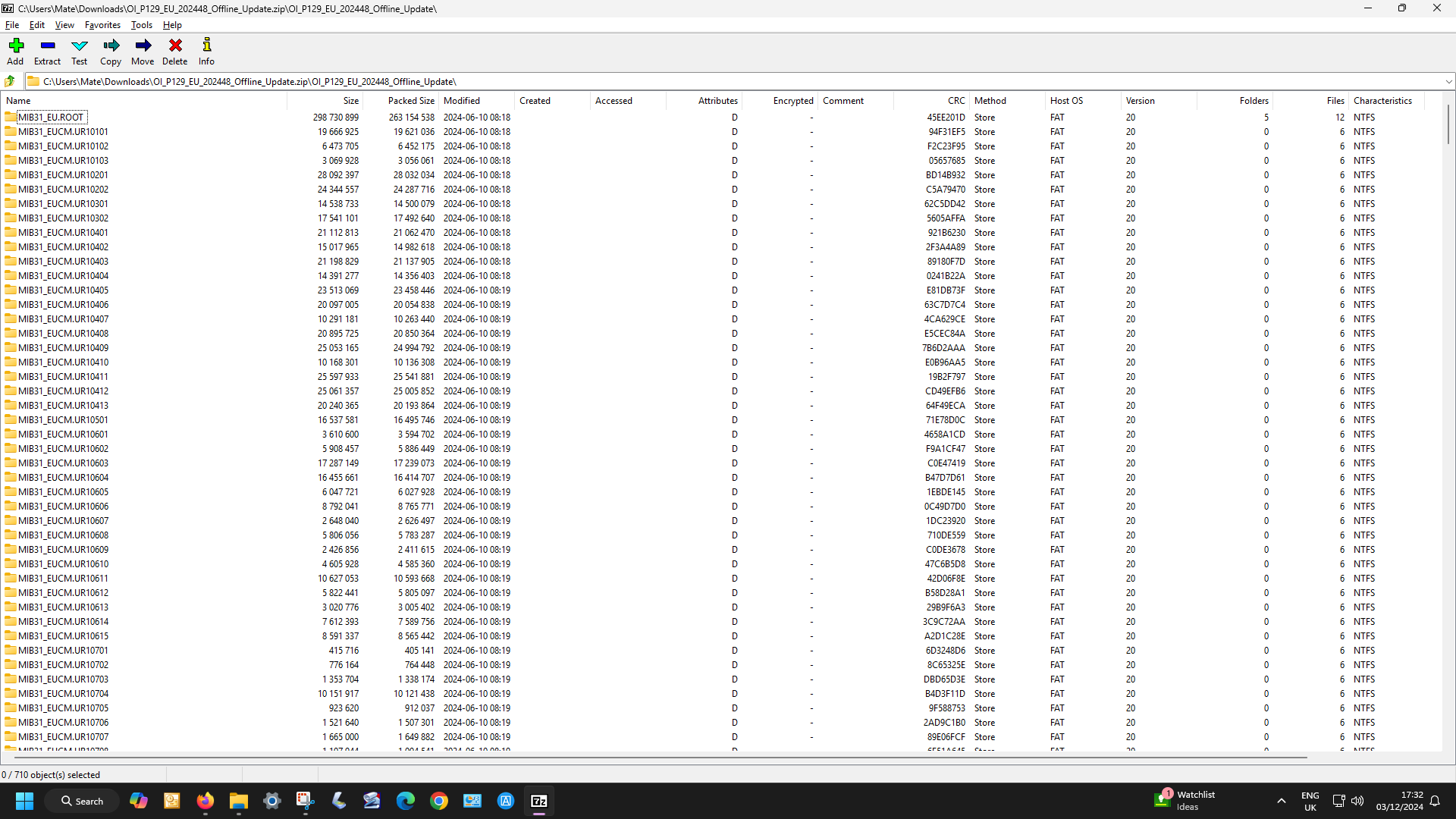

Your download folder will have this in it
Then all of this stuff is got to be in the root of your USB.... not one down if you see what I mean. I ball the PDFs. This is what happens people get it in the wrong level. You might be fine using the
built in Filemanager opening up of the zip file but it's got to be as below in your root. You don't want to see OI_  blah, blah on the USB what's below is in the route. USB needs to be blank before the copy.
As per the SKODA PDF
https://www.seatcupra.net/forums/attachments/skoda-map-updates-mib3-pdf.36225/
But I open it up and copy out to a save area, then copy it out to the USB but as per the documentation that is what goes in the route and it's exFAT, there are NTFS lovies about
but they really shouldn't be using NTFS on SD and USBs !. It's slower.

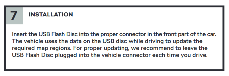

On this bit:
That's the incremental update with roll back restarts if it does roll back. Should take the 40 minutes on the EU maps.

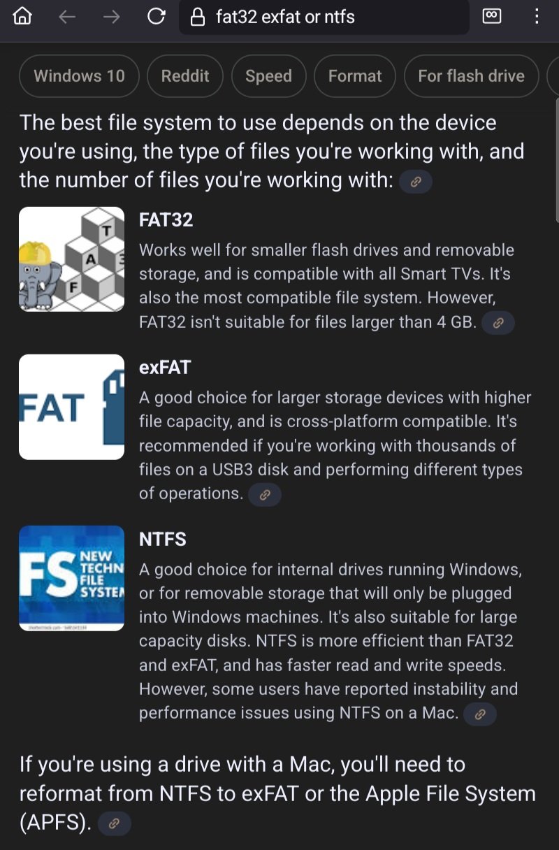

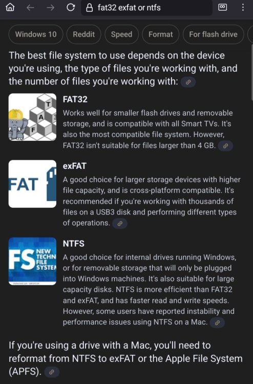

Google friendly AI system says this which I wouldn't disagree with... exFat is designed for solid state memory. I did do some timing on an SD card when this came up about mib2 high maps bridging the 33gb limit. There is a burst mode on some USB drives which is how they get different speeds.
At the end of the day it's whatever works for you although keeping to Vag guidance makes it easier to give one set of instructions of how to do it. I quite like the idea of the stick with the data flashing light on it. Mib2 high I use the engineering menu so see the components parts go over as the map is updated. Not sure of whether anybody has mastered the mib3 swdl. Probably. In the meantime flashing LED on the USB does show some data traffic.
