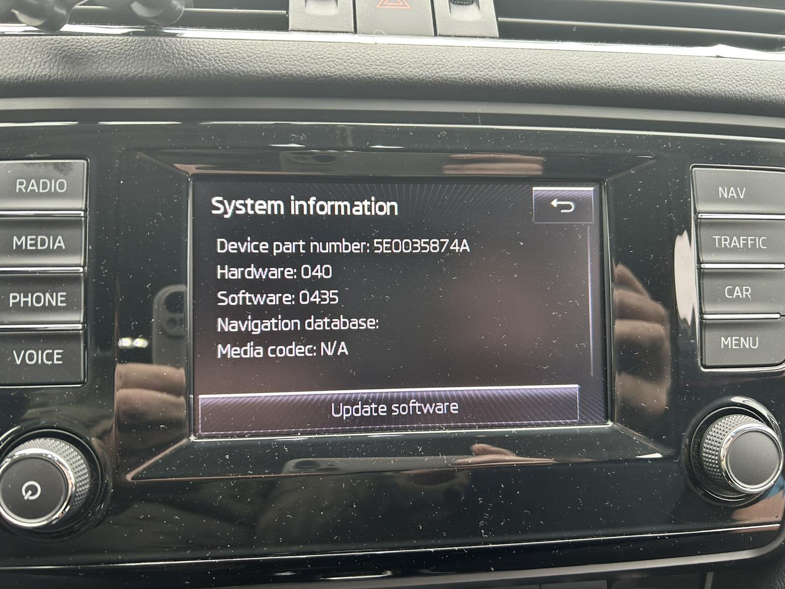

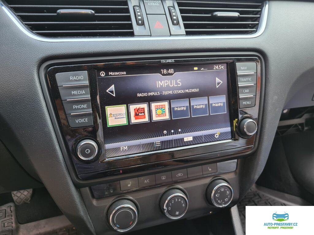

Hello, can someone help me? I have a Škoda Octavia 2014, VIN TMBJJ9NEXE*******. I believe I have an Amundsen MIB1 system and a display that is neither the smallest nor the largest, but the medium size. I do not have CarPlay, but I would like to have it.
Can someone tell me whether it is necessary to replace the main head unit in the glovebox, and which part numbers / unit versions I should look for? Also, would I need to replace the display if I want a larger one than the current medium-sized screen?
If possible, I would appreciate a brief explanation of what display sizes were available for this model year of the Octavia.
Finally, is there any cheaper or simpler solution to get CarPlay, or is replacing the head unit and display the only option?
Thank you in advance. Photo 1 is my display and photo 2 is diplay they want.MIB2.jpg
