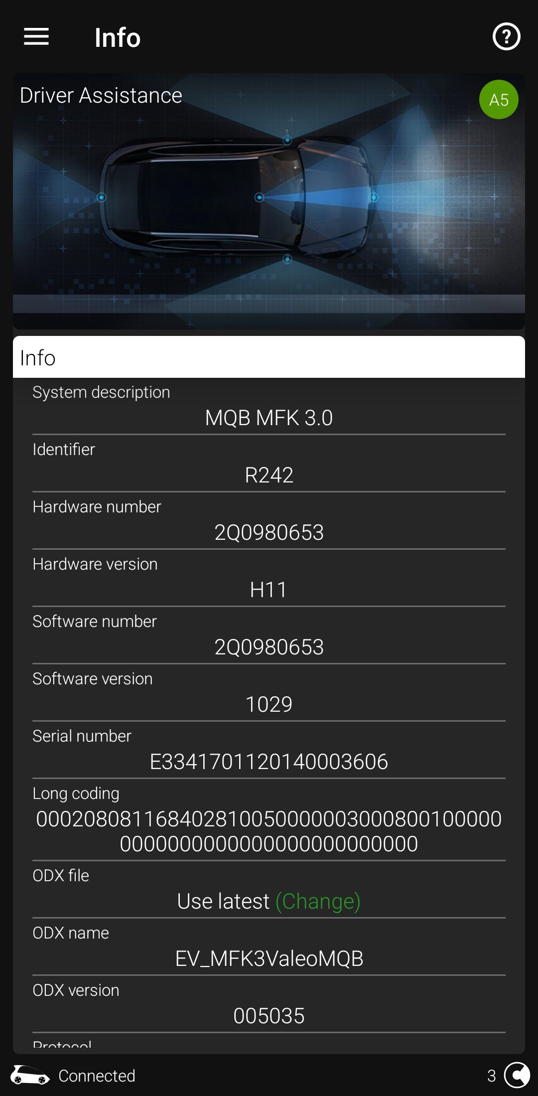

Has anyone been able to code lane assist in FL Superb? I have 2020 SE L and followed guy in this video Skoda Superb MK3 FL Lane Assist coding (he's Polish but so am I so hadn't any issues following his steps). I've done each step like him using OBDeleven PRO and only managed to get option shown on radio screen and maxidiot but with exlamation mark and unable to actually enable it 😭
What part number does your big camera have?
Where do I check it using OBDeleven?
Control unit A5 under Info.
But if you don't know that, I wouldn't code anything.
Here you go
2Q0
There are instructions for that and it will work. Then you either didn't code everything or did something wrong.
I've followed steps of this video included, I know it's in Polish but all commands in the wideo are in English
I didn't watch the video because there are other instructions in text form. There's no need for a video.
