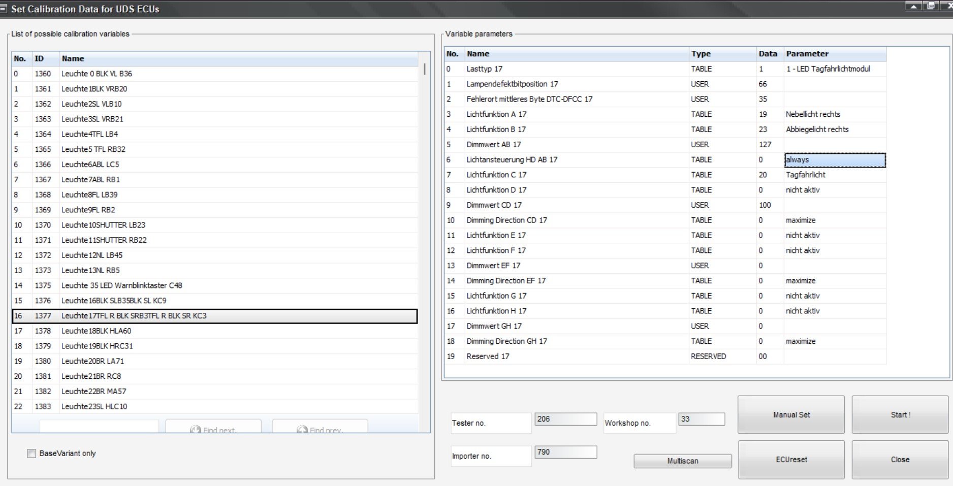

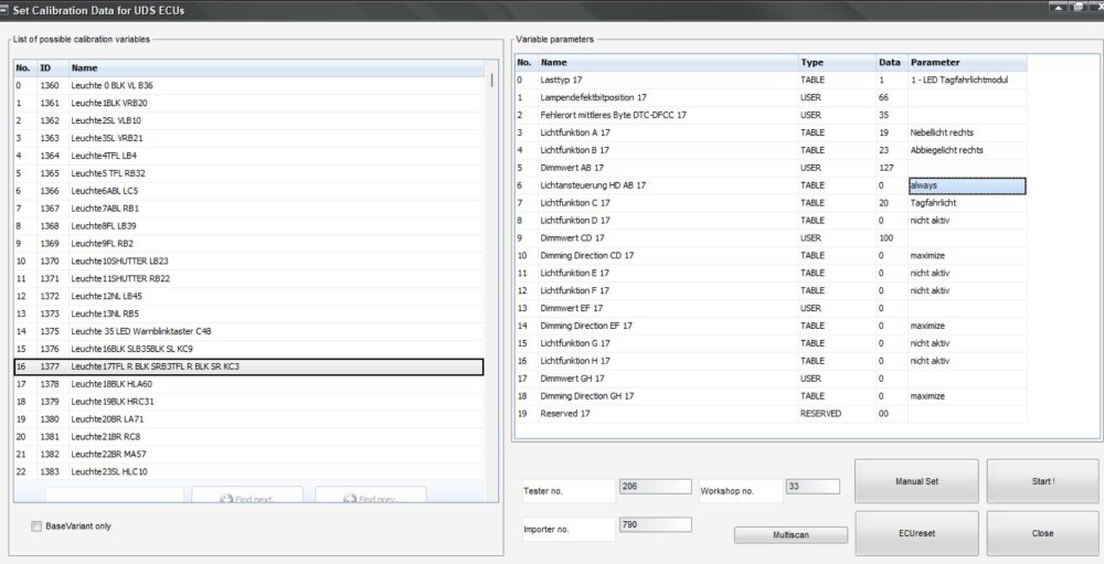

- - Coding Eyelashes always on in the headlights
09 Central Electrics
            Access Code 31347
            Adaptation
            -> Change (8)Leuchte17TFL R BLK ......... C17 to Daytime running lights
            -> Change (10)Leuchte17TFL R BLK ......... CD17 to 100
            -> Change (8)Leuchte16BLK SLB ......... C16 to Daytime running lights
            -> Change (10)Leuchte16BLK SLB......... CD16 to 100
23.03.20          OK

I would have liked to code the eyelashes!!! I have taken a screen shot of the lamp adaptation page. If anyone knows which lamp numbers are the eyelashes I might try again. When I coded as described I received an error to check my fog lights.
I was left with a stupid error which I am unable to trace back so far. I tried to code the VZE /TSR and after getting nowhere I simply copied and pasted my original coding for the controllers.
STG17 is still showing VZE error in the dash when I switch on the ignition.
The error is in the attached pdf file. Does anyone know which adaption I did not revert by any chance?
DTC STG17.pdf
