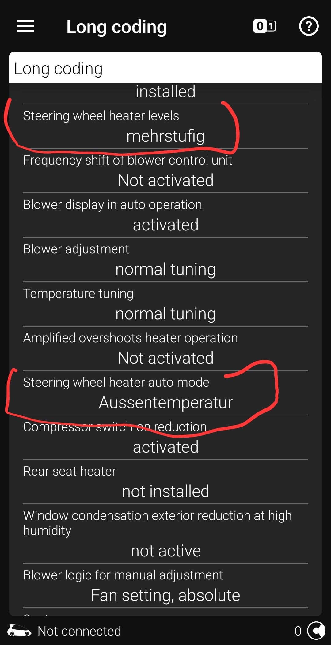

But now I changed the steering wheel to the "new" one with capacity sensor.
I coded everything properly, but from the button on steering wheel I can only turn ON/OFF heating. I know there is a possibility to turn on the 3 level of heating option.

Check what do you have in 08 Climate Control Module cdoing - Heated_steering_wheel_automatic_mode

1 hour ago, bobbest said:
Is it possible to code 2 things to work:
  • Changing the steering wheel heat level by the button on the wheel (3-2-1-0)
    And
  • Automatic heating in low temperatures + automatic heating when seats are heated?
New type of steering wheel from the factory. Heated steering wheel retrofitted.
Exactly - I want to code it as in first option (3-2-1-0) But now I have only 2-0 (2- according to the graphic on VC)
Heated_steering_wheel_automatic_mode - Not installed
By these settings - autoheating with seats and tempetature works properly. Button on steering wheel does not change 3-2-1-0 but only on/off
