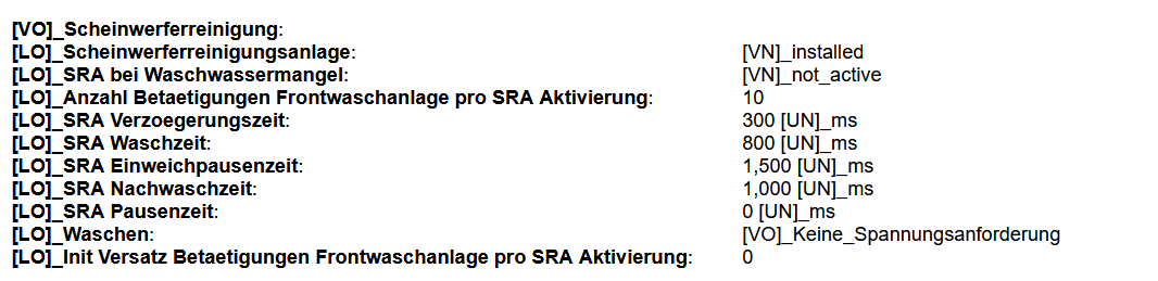

Can it be coded to force the headlight washer to occur only with a long pull of the stalk? I'm getting through far too much liquid which would seem to be due to the headlight washer frequency.
It can be changed.
Change SRA Verzoegerungszeit to 500 ms in STG09.
Yes, you have to change two values:
09 – Central Electrics - Adaptions
Search 'scheinwerferreinigung' (headlight cleaning)
Select 'SRA Verzoegerungszeit' and set value to '2000' (don't worry that the range is '0-250' on the input field) - it is the time in ms how long you have to hold down the washer stick to initiate headlight wash request.
Commit the change
Number of activation front wash per SRA activation - Anzahl Betaetigungen Frontwaschanlage pro SRA Aktivierung:
This is by default set to 10 and means if you pull the washer lever 10 times it will activate the lights cleaning. You need to change it to 1 so that every time when you hold washer stick for 2 seconds, it cleans lights. If you leave it to default then headlight wash occurs only after 10 time of holding 2 seconds.
Now when you hold washer stick ~2 seconds, it will spray water on to lights.

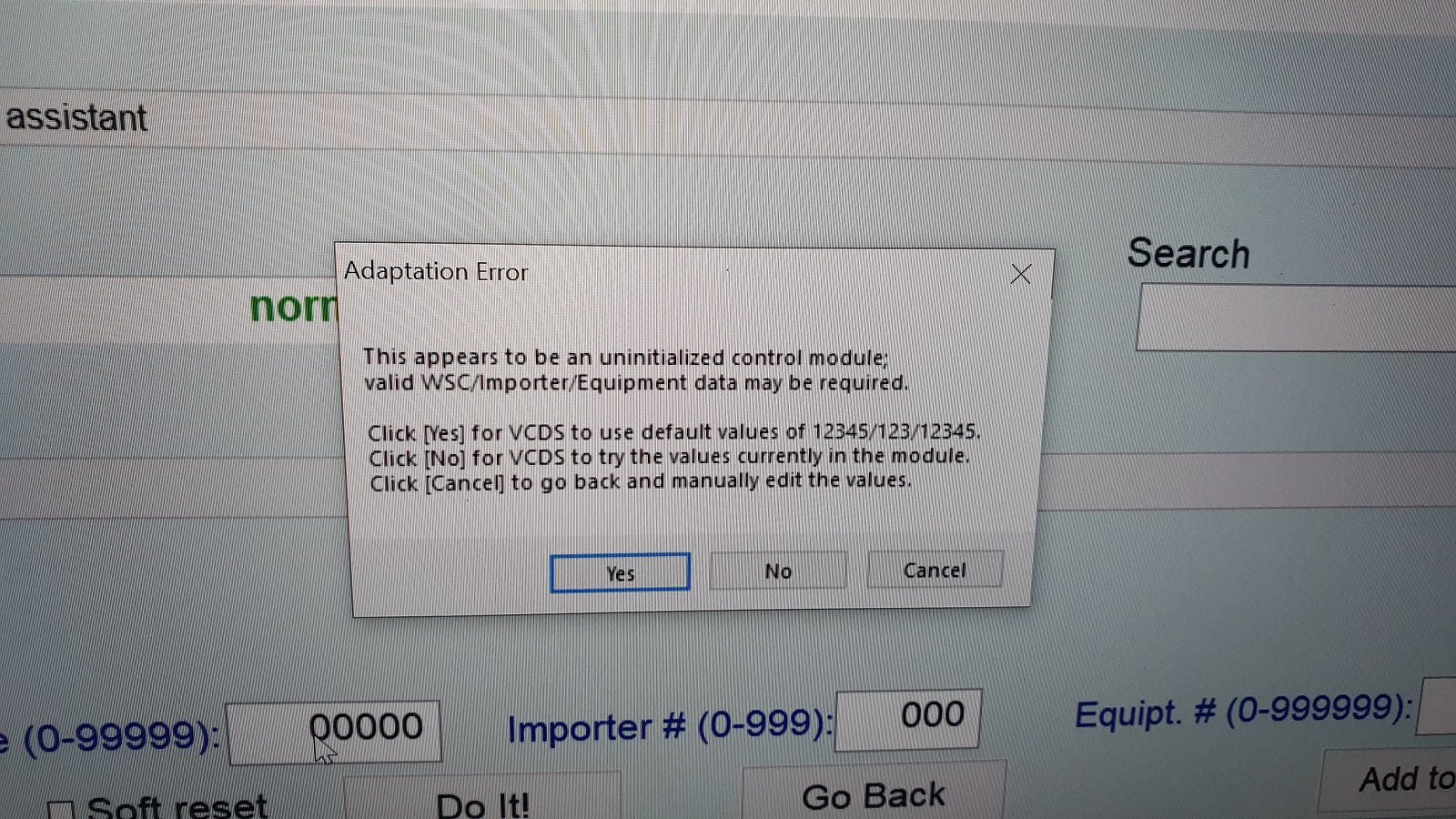

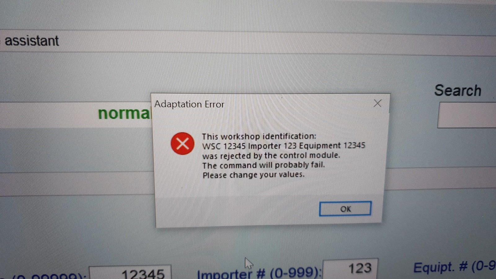

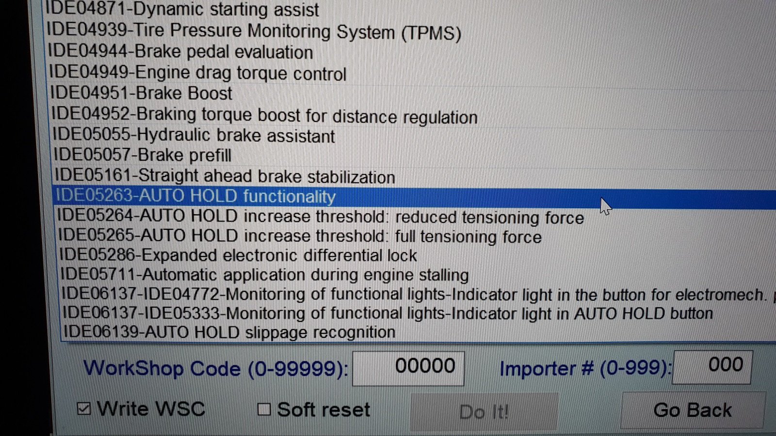

Brakes, set autohold to "early".  Here it was the only hairy moment, first when I try to access and confirm the adaptation I get this warning message, then trying options I get an error, then finally with Access code listed here 11996 I adapted from 'Normal' to 'Early' and in that moment all Hell brooke loose, Christmas tree lighted up and all systems offline errors started to pop up 😬
I managed to re-enter and return the Autohold to 'Normal' and all went away ... cycled ignition on-off and couple times and run an autoscan and no errors. Will see when on the road, but something was not of the liking of the brakes' module...
However, I noticed in the options there is some "Autohold functionality" options. Has anyone ever tried any of those?

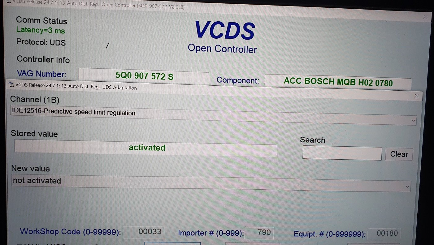

Finally, some silly questions
1) when I was searching for the coasting, I've noticed a 'predictive speed limit regulation", anyone knows what this is?

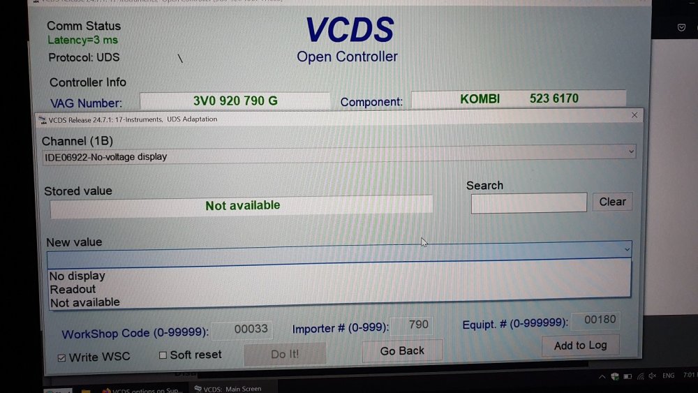

2) in the instruments there is a "no voltage display" set as "not available", I set it to "readout" waiting to see if there was a voltmeter, but I did not see anything ...

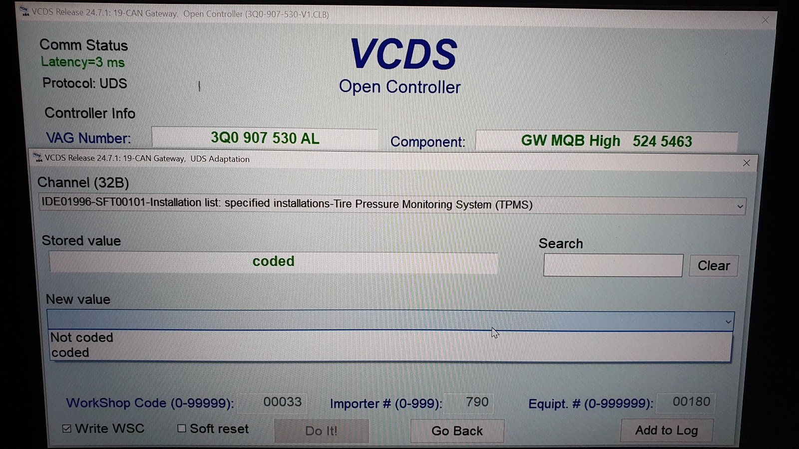

3) I forgot to mention in another post for the tires, but a combination of two dimwits - one being me - made me end up with the winter tires without the TPMS sensors installed. As I do not want to take them out again just to refit them, I guess I will survive this winter the old-fashioned way of visual check every forthnight or so. Is there any way I can disable it to prevent the lamp to light up?
My car came with them installed ... they were on the summer wheels/tires, I told my tire guy to source sensors for the winter ones he said "no problem"and the the usual chain of events: he did not order / I forgot to remind / then, all in a rush: I left him wheels / I forgot to remind him / he forgot to order them / I forgot to ask / he did not remember to mention / I put them on like two weeks later because I was busy, and the day before travel .... and here we are 😜
I have been looking at your setup, but I wonder if compatible with the OE system ...
"predictive speed limit regulation"
Sounds like what Travel Assist can do - it can adjust to speed limits and it does it predictively - meaning taking speed limit data from navigation and slowing down to a speed limit before you reach it.
Edited by komoornik
Sounds like pACC, which can brake independently if the camera recognizes signs or the navigation system recognizes curves or roundabouts from the route data.
Noted.
There is a newish section of the ring road opened recently close to my place, there will test this, which, if is what you guys mention, is really bothering ...

As the two fellas mentioned above, my changed setting has removed the "auto speed" when PCC is on.
