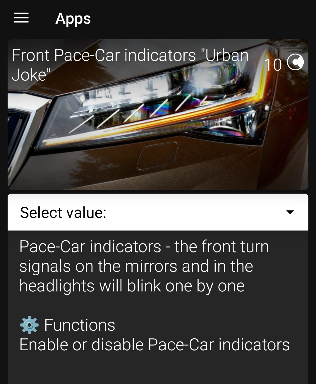

What do you hope to achieve with this? You set this in the lighting channels in control unit 09.
I want to achieve this effect.
It's the "Urban Joke" Pace Car effect.
I would strongly advise against using these apps
Thank you so much. Do you have any verified guide?
Sorry no, I don't have any further info apart from the above that it is available on OBDEleven as an App.
I have no interest in such a lighting effect.
U'll have to Google search Urban Joke effect, maybe u'll find instructions on how to enable it.
