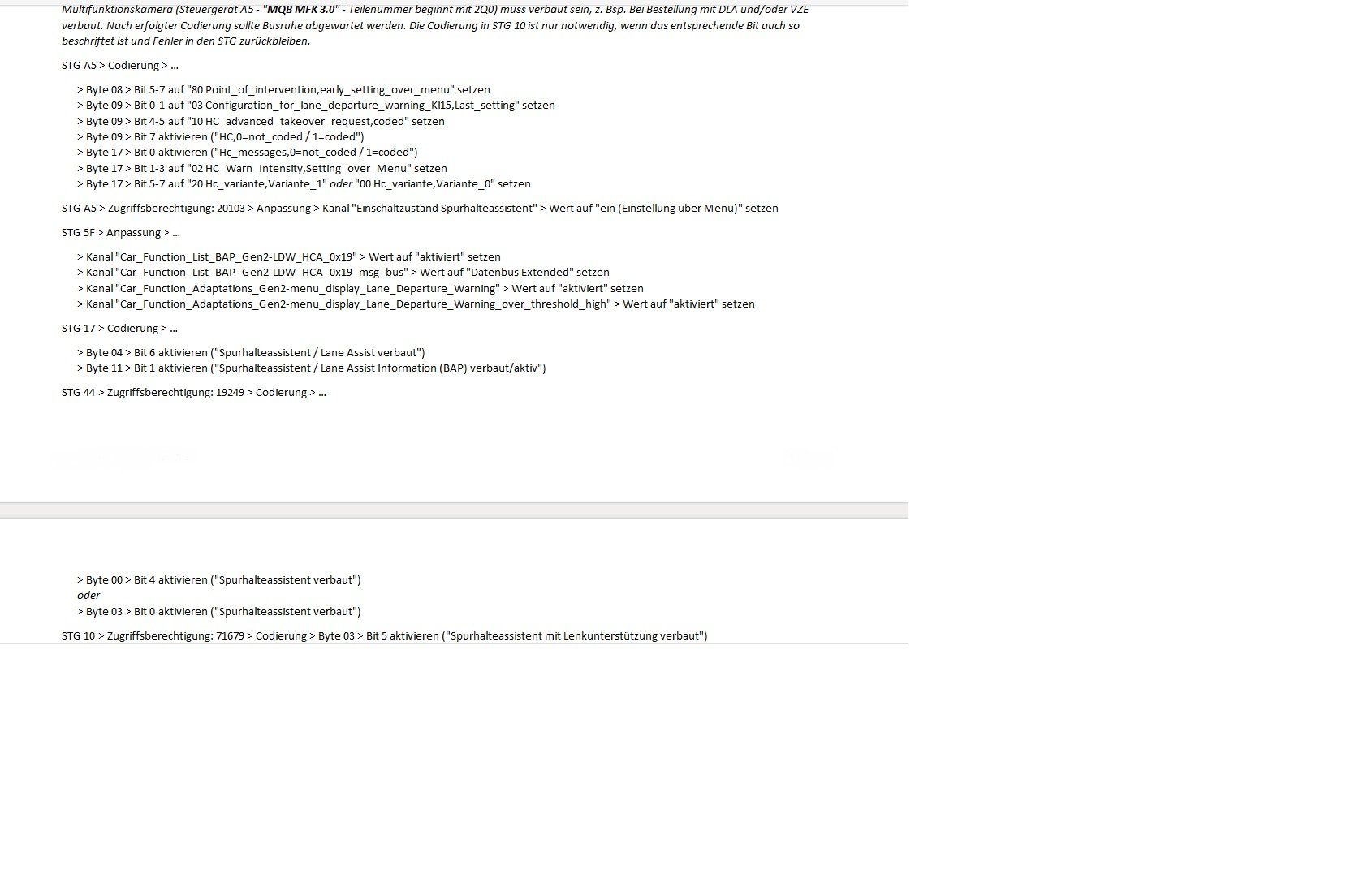

Does anyone have the instructions to enable lane assist in the FL model? I believe it's slightly different to the non-FL.
Here's list that I've followed using VCDS and got it working, only difference is that I've not done adaptation part on A5, only coding (initially had some issues but I'm guessing it was because I was trying to enable it using OBD11 few months ago and must have change something somewhere that was stopping me from enabling it now). Currently everything is working fine with lane assist, just having issue with blind spot (It works and I can enable/disable it on maxidot but I've lost option to enable/disable and adjust brightness on MMI).
Thanks, I've found this one too, no mention of coding in 10 Park/Steer Assist like shown above though. The above translates to "Lane keeping assistant with steering intervention installed"
