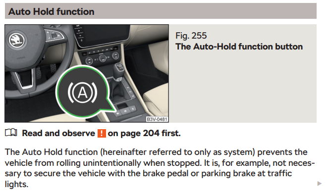

I have no idea if the Octavia is the same as the Superb but TBH I tend to just leave Auto Hold enabled and I only ever go to P just before getting out of the car
Edited by Winston_Woof
'Autohold' is great.
BUT,
for extended stops the Rear Brake Lights are on, and unless you are last in the traffic maybe not necessary and not how the UK Highway codes indicates you should use Brakes / Brake lights.
Just another thing where the EU and the UK have differences.   Like the EU / Type approval seemed to be OK with Cornering Fog lights, or Front Fog Lights that can be enabled to automatically come on when reverse is selected.   (Rather than a driver thinking, nothing coming, i am reversing and need more lights to the front to see where i have come from, best put Front Fog lights on. Or just putting the Full Beam on.)
Lots of drivers have no idea that the Brake Lights are on with Autohold, not all VW Group cars are.  Or that the Fog Lights come on in Reverse because someone thought it a good idea to enable.  Yeti Drivers.
I thought they (the brake lights) were supposed to come on as well (same as with the footbrake) but TBH I've never noticed them shining on the car behind(even at night).
Hmmm maybe I should go out and check ;o)
BUT,
Seems to me you are both agreeing that the brake lights are on with Auto Hold?
With Skoda,s by 2016. Not necessarily with Seat, Audi or VW,s.  Several threads on that on the forum.   Ones asking how to code them out as well.   It is good if drivers know what lights are on when.
yes & no but I dont recall them being on , will need to check ;o)
and having been out to check? Yes they do stay on with the autohold engaged :)
