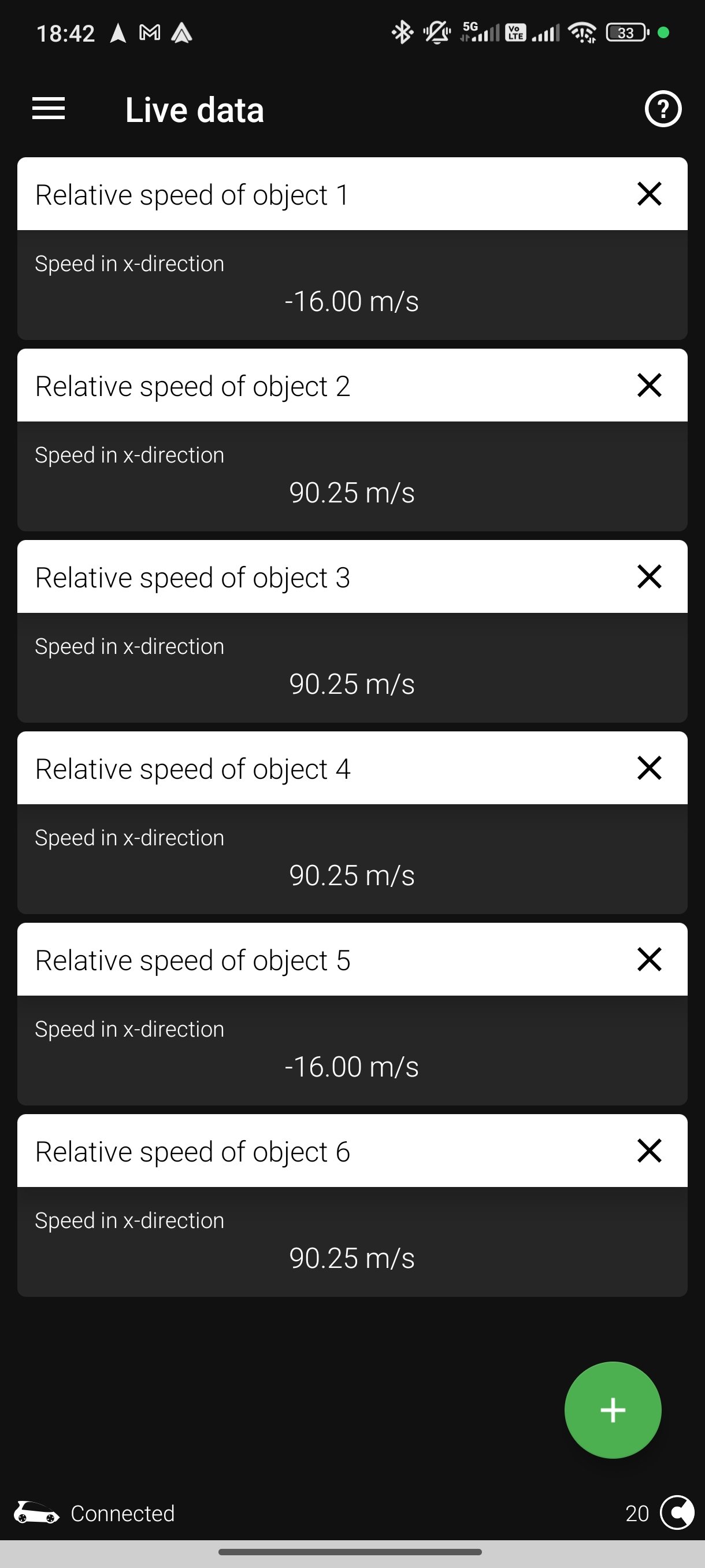

Does anyone know what the objects correspond to? I have already identified that number 3 is the car following us in the same lane.Screenshot_2025-10-24-18-42-06-467_com.voltasit.obdeleven.jpg
The Sensor can detection max 6 Objects
I see 1, 3, 4 and 5 moved but not 2 and 6.
3 is for the car follow me, 1 is for left first lane and 5 right lane

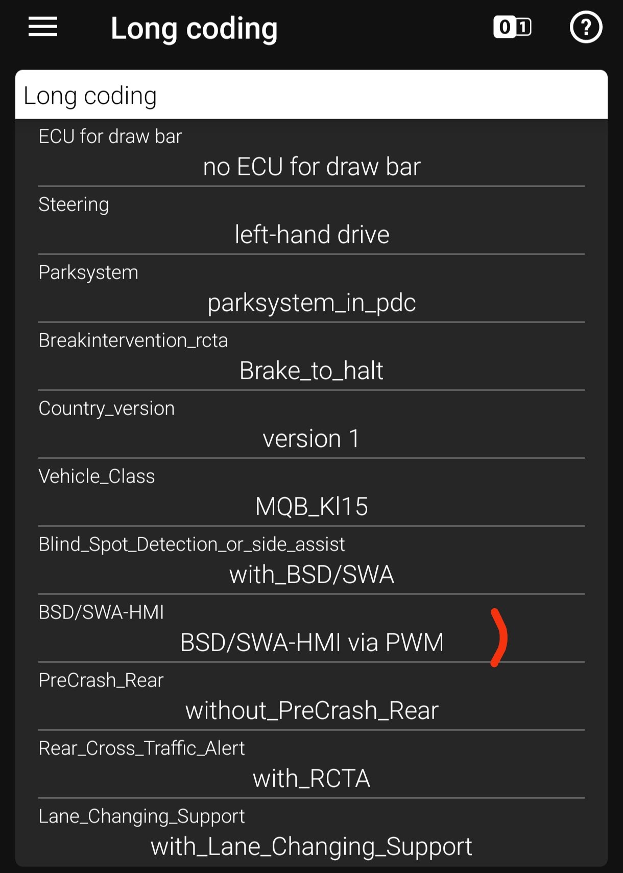

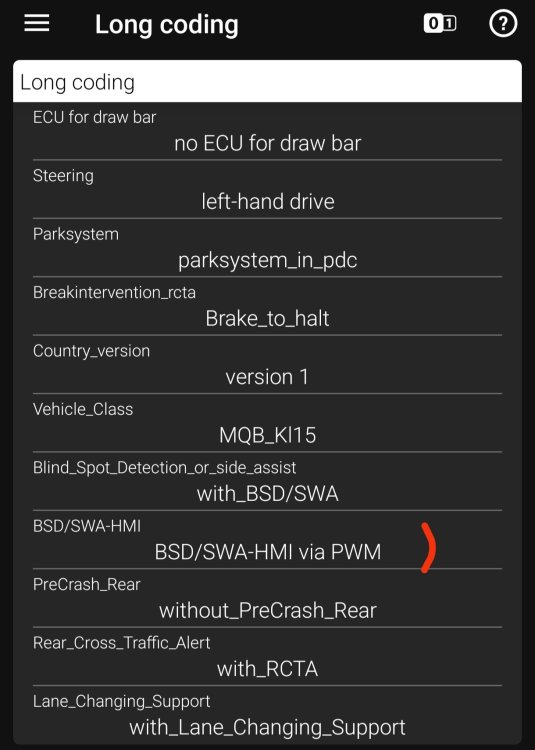

Only Coding
I don't see any options in long coding, maybe this line but I can't change it : the other options is via LIN instead via PWMIMG_20251025_162418.jpg
100% wrong
You want to Change something Over HMI
3 hours ago, Cairus said:
100% wrong
What is HMI ?
Realy?
H(umen)
M(aschin)
I(nterface)
Ok, it's the multimedia interface.
So this line refer to the mean for the system to communicate the power to the light. PWM or LIN
