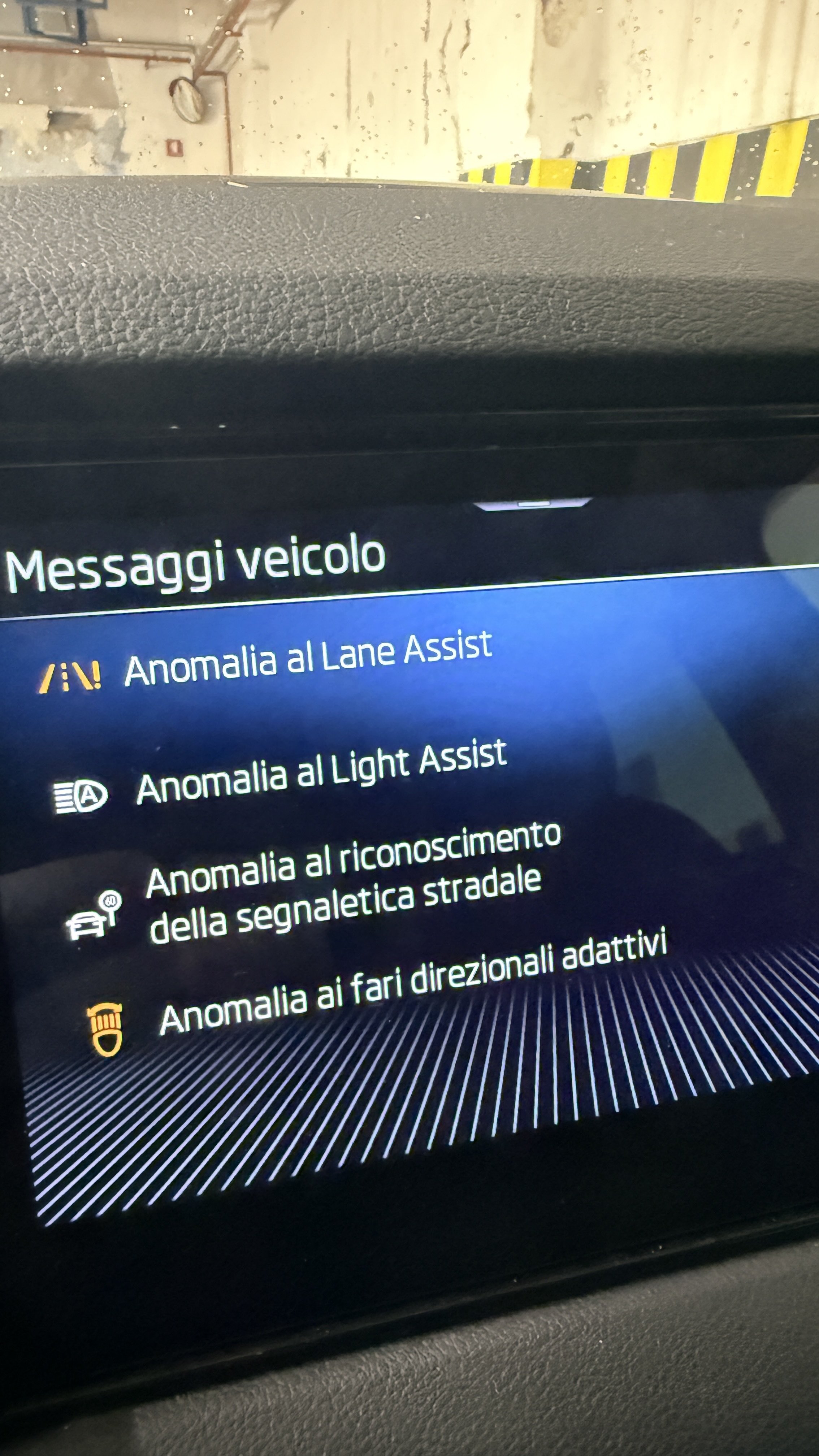

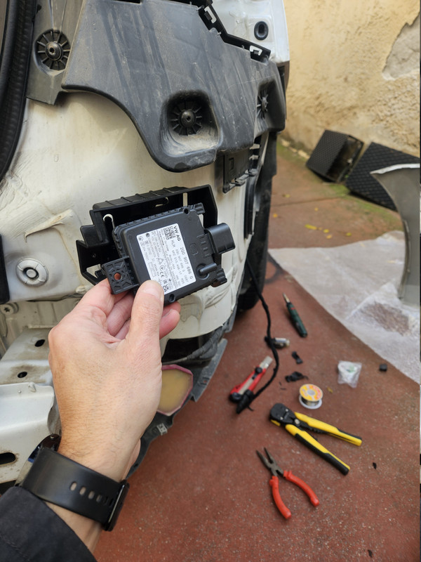

I know it’s the Octavia section, but let me share this joy of mine! The retrofit works!!
Reason for which it didn’t before it’s because the first mechanic passed the harness on the LEFT side of the car instead of the RIGHT one (after reading so many posts/threads I never found such clue) and the second mechanic had to have to check the whole harness! Curiously, Lane Assist, Light Assist with Auto Hi-beam, Traffic Sign Recognition and Adaptive Cruise Control are not available and the become so only disconnecting proper the Blind Spot: I believe it’s matter of coding the front camera!
But the fact the retrofit works is even more of what I can imagine!

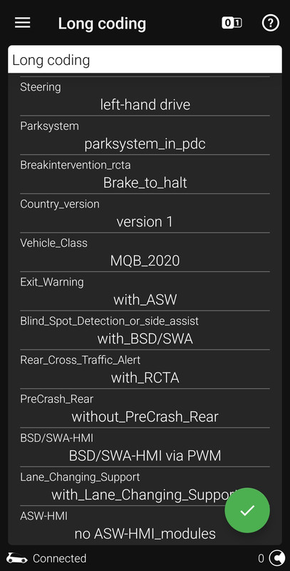

2nd attempt for BSD installation
Used radars with index G
2nd-attempted-with-index-G-radars-(1).jp
The result (from the OBD11 perspective)
2nd-attempt-Screenshot-20251201-183543-O
2nd-attempt-Screenshot-20251201-183925-O2nd-attempt-Screenshot-20251201-183931-O
Because the radars are used, they are already encoded and can be seen here:
img%5D
Next step, removing Component Protection... the most crucial step.
Putting the B version I had no problem (they have NO protection), even if those I put were initially fitted on Kamiq (car 20cm circa shorter than those parametrized for Karoq).
I think that flashing the right dataset I should solve that "problem" (if we wanna consider a problem): however I noticed that the area covered by the radars is pretty wide, they see up to 50m (if not more on freeway)! Furhermore since I installed them, I noticed the exit alert ADAS funtion appeared on the ADAS list on virtual cockpit!
I also noticed that the area covered from the radars appeared on the car when OPS is engaged as well from the area view
Edited by Benja77
