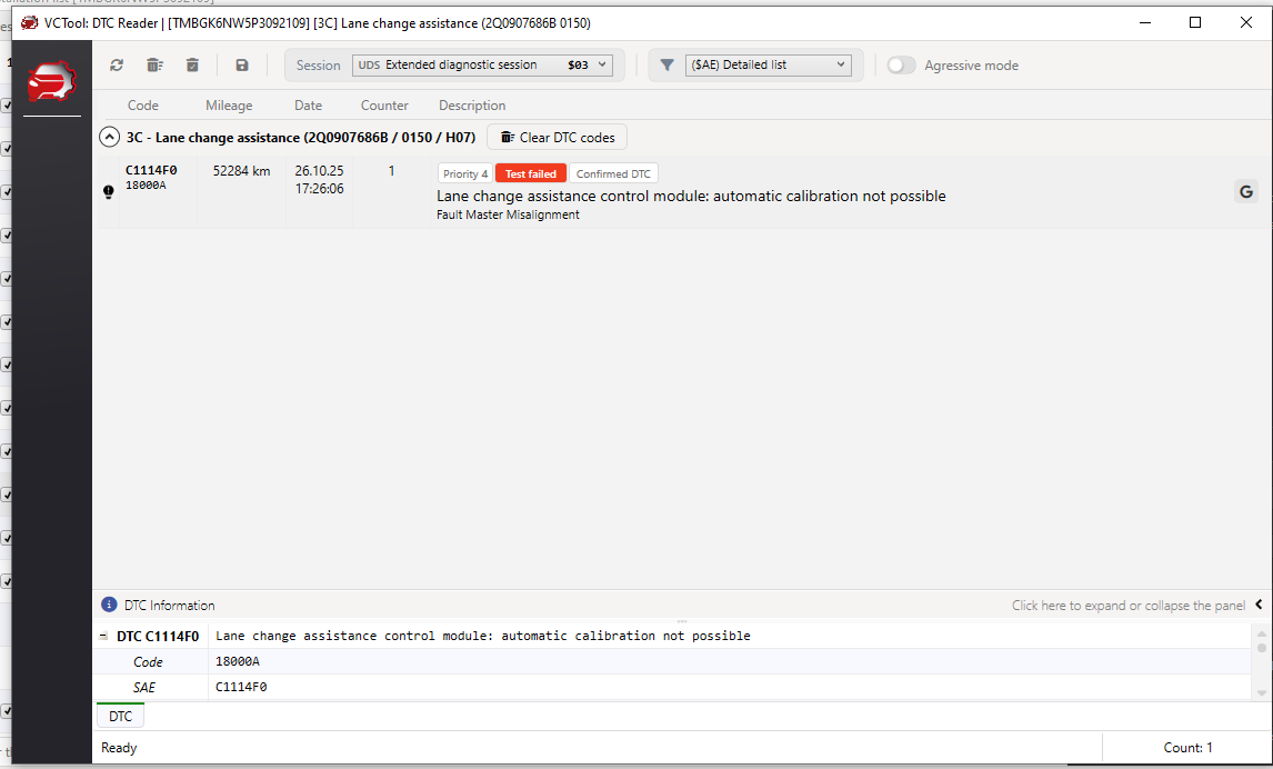

Ho no, after somes kilometers, I have a error
Correct brackets?
Correctly installed?
Correct dataset?
Correct brackets?
Correct dataset?

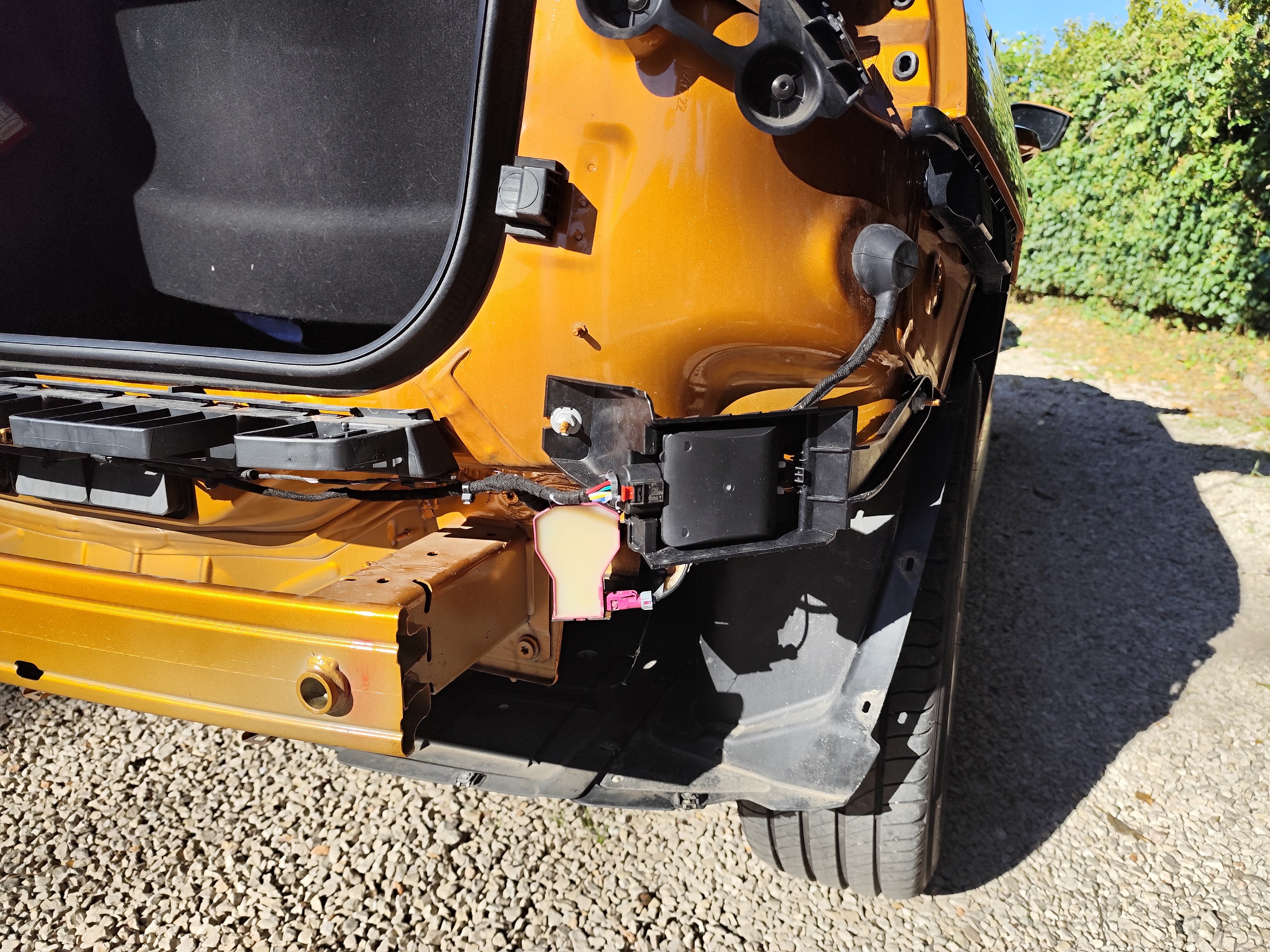

Correct brackets :
I have installed 658907455 / 658907456 brackets and with the information I have, it's for Kamiq (not for Scala) : OK
Correctly installed :
I think but I see the fault is on Master side (right) and this unit come with a physical default on one of attach. --> to be investigated
Correct dataset :
I have installed dataset V03935363XP which is for Troc --> Maybe I have to installed for Kamiq but I don't find this (on VCTool) --> to be investigated
t Roc dataset works without problems on the Kamiq where I made the parameterization
So, I think the issue is due to the default on Master unit (on right side).
For the left side (slave unit), the fault code is different.
I have to check my fitting

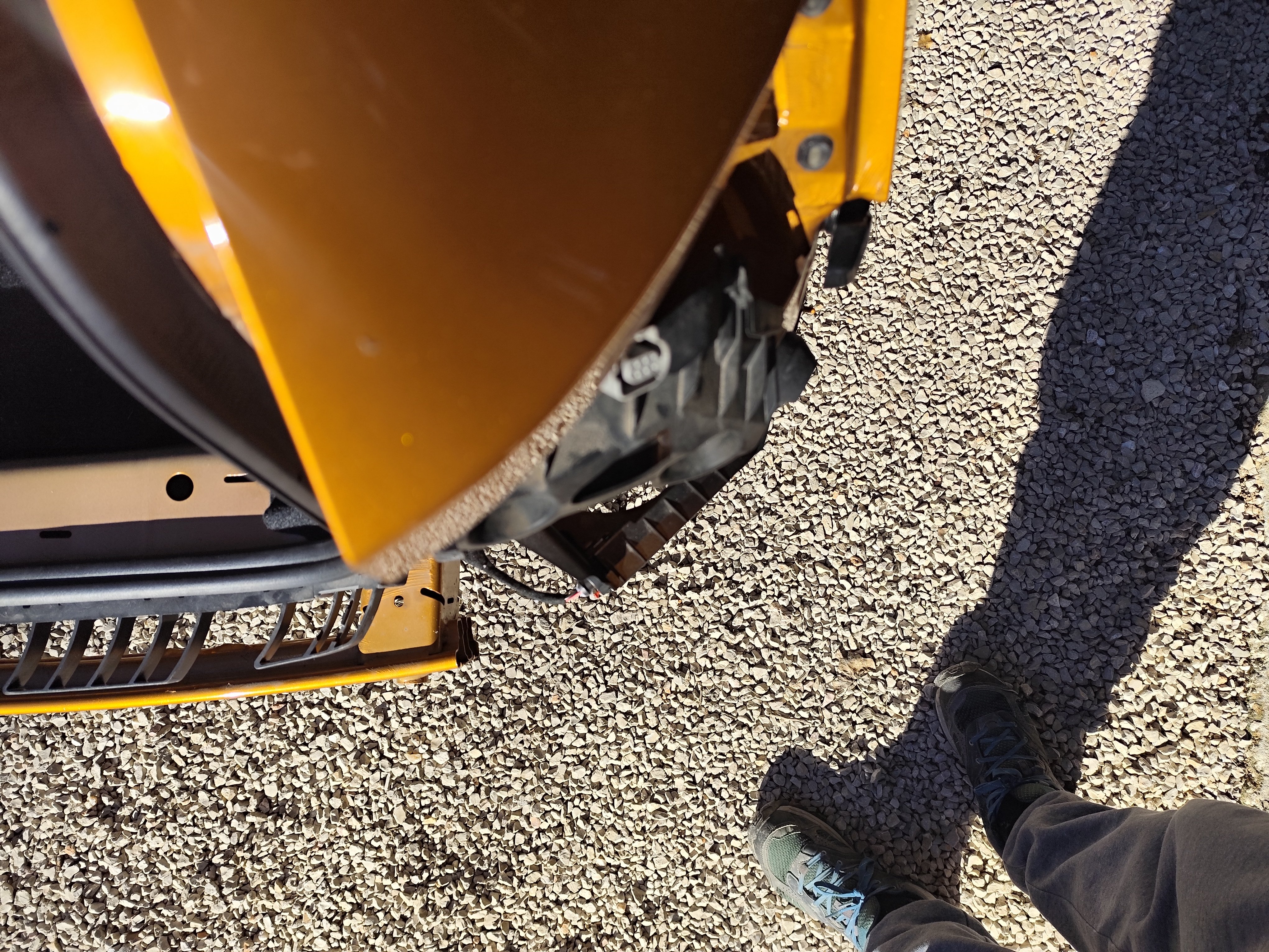

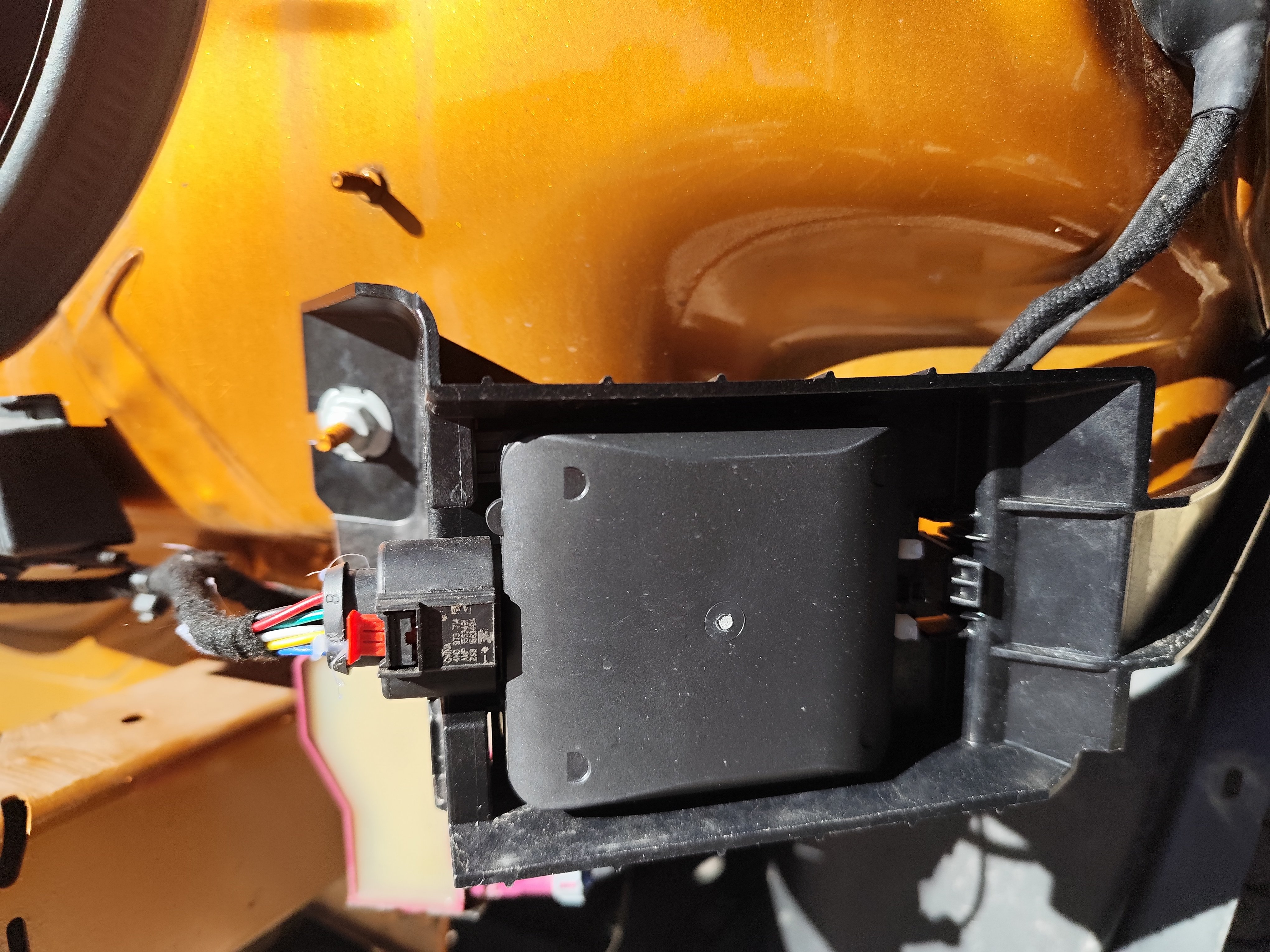

I have rework my assembly and put a shim under the radar.
Dynamic angle reduce to 8° to 1.5° so it's good. With these changes, all work perfectly.

It was just an installation issuie I think. Support are "flexible" with only 2 attachements points.
I haven't photo of shim but for now, it's just a piece of hard foam and I'm modelling a real shim according to this in order to print a definitive shim.
1 minute ago, Vincent_83 said:
Yes of course 🙃

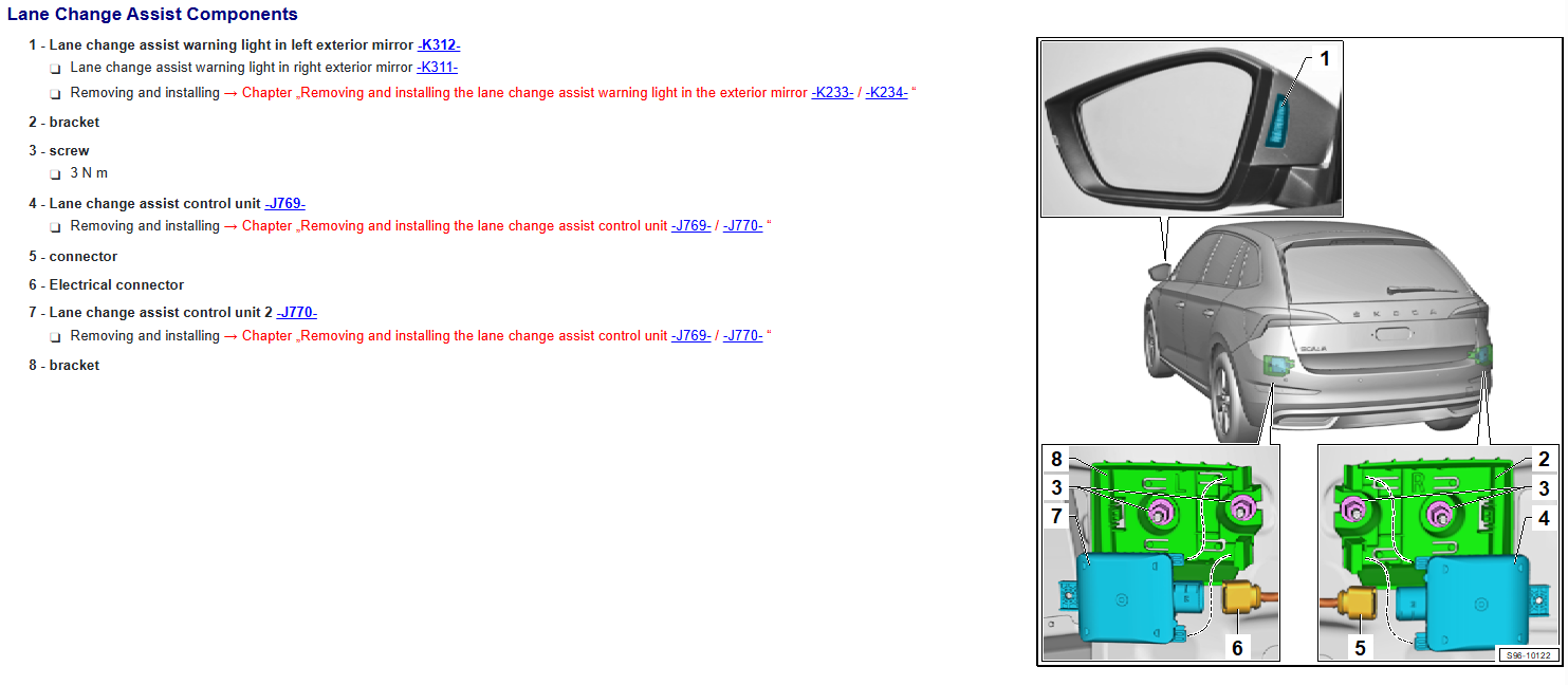

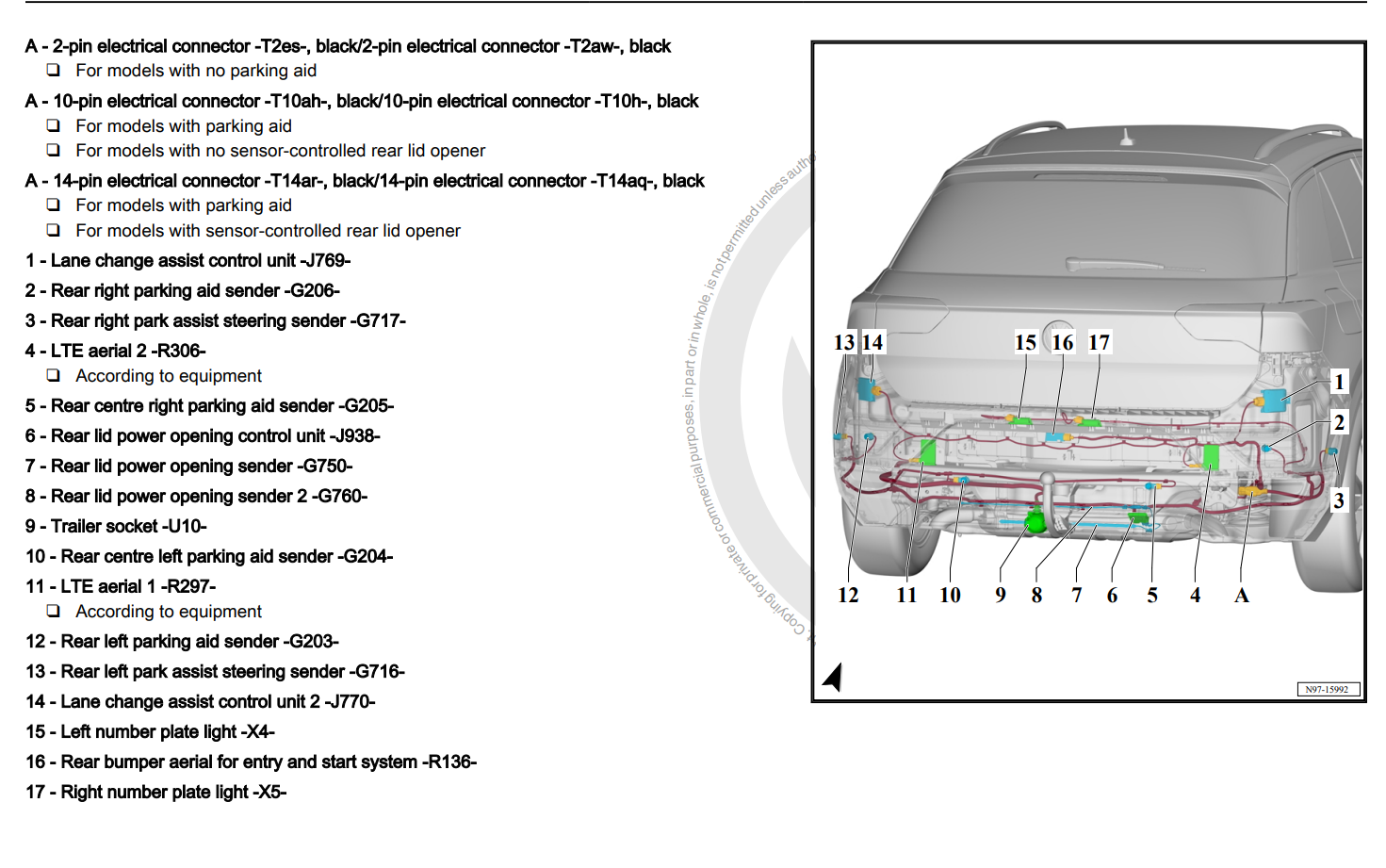

On the official documentation, we see clearly the connector are inside the center of the vehicule (not than all other VAG car ☹️ )
