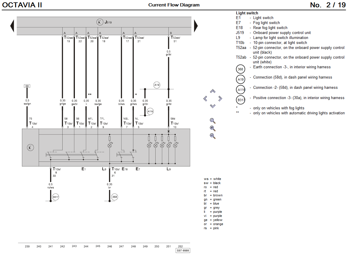

  • Here is the wiring diagram.

Sorry for reviving this thread.
I have a 1Z0 941 431 J switch that was replaced because it gives an implausible signal, causing my low beams and rear lights to be on all the time when the key is in the contact and turned on. I paid close to 70€ for the replacement part, so evidently I'd love to know what's wrong with the old part.
Does anyone know if this can be tested with just a multimeter? Evidently there's more than just a set of contacts inside...
It's just a bunch of switches so a multimeter should be fine. Great thread here taking the golf version apart: http://www.golfmkv.com/forums/showthread.php?t=31272
This is the wiring diagram for the Octavia version:
Looks to be:
- Off, 8 to 9
- Auto, 8 to 2
- Sidelight, 8 to 3
- Dipped, 8 to 1
- Front fog, 8 to 5
- Rear fog, 8 to 7
Great thread indeed. So the PCB is just for the internal lights, or does it contain the logic for the auto lights-on (I cannot help but not notice that the Eu version with auto function has a more complex PCB)?
Do you know what the 0,5 and 0,35 values stand for?
Also, didn't you exchange sidelight and dipped? The sequence on the switch is Off/Auto/Side/Dipped, which corresponds to the 9,2,1,3 (RtL) sequence in the wiring diagram.
The numbers are the wire thickness, so 0.35mm2 and 0.5mm2 assuming they are in mm2.
There is no logic in the OEM auto switch, it's all done by the BCM and RLS (rain light sensor). The switch only reports it's in the 'auto' position.
If you use a Chinese retrofit kit with an extra sensor, that will have some logic built in.
The rotary switch isn't in the order that you'd expect ;) If you look at which pole is connected on the diagram, from right to left it's:
- Left (off)
- Second left (auto)
- Right (dipped)
- Second right (sidelight)
