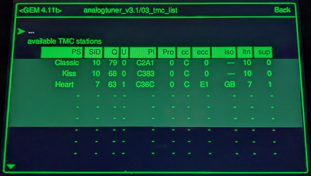

I’ve debugged the data being received on another VAG platform (Audi’s RNSE system) and can confirm that although the TMC identifier for table 0x07 is still being transmitted on Capital and Heart, there are no actual TMC messages present. Classic on the other hand still has its 0x0A identifier AND has actual messages being broadcast.
I’m going to attempt a switch in the RNSE firmware to listen to the alternate table ID, but I’m 99.99% sure that the location IDs will be different and so this will ultimately prove fruitless (or at the very least result in totally garbled meaningless locations).

The factory setting for IDE05111-Fee-based traffic information (TMC) is 32771 for me which suggests it should be using Trafficmaster with the option to fallback to INRIX.
The headunit certainly knows that Classic is a TMC source and seems to want location table 10 (0x0A):
Makes me wonder what's missing....
Thanks for that. I suppose certainly worth looking at the MIB2 maps a seeing if the location table is extractable.
For your unit looks like the SID (whatever that is) is incorrect. XML says 55 and GEM shows 10. Looks like SID is same as LTN, so I suppose it could be a mistake on the GEM display? But then also there’s the “sup” column. Supported perhaps? Maybe not supported because the SID is wrong?
