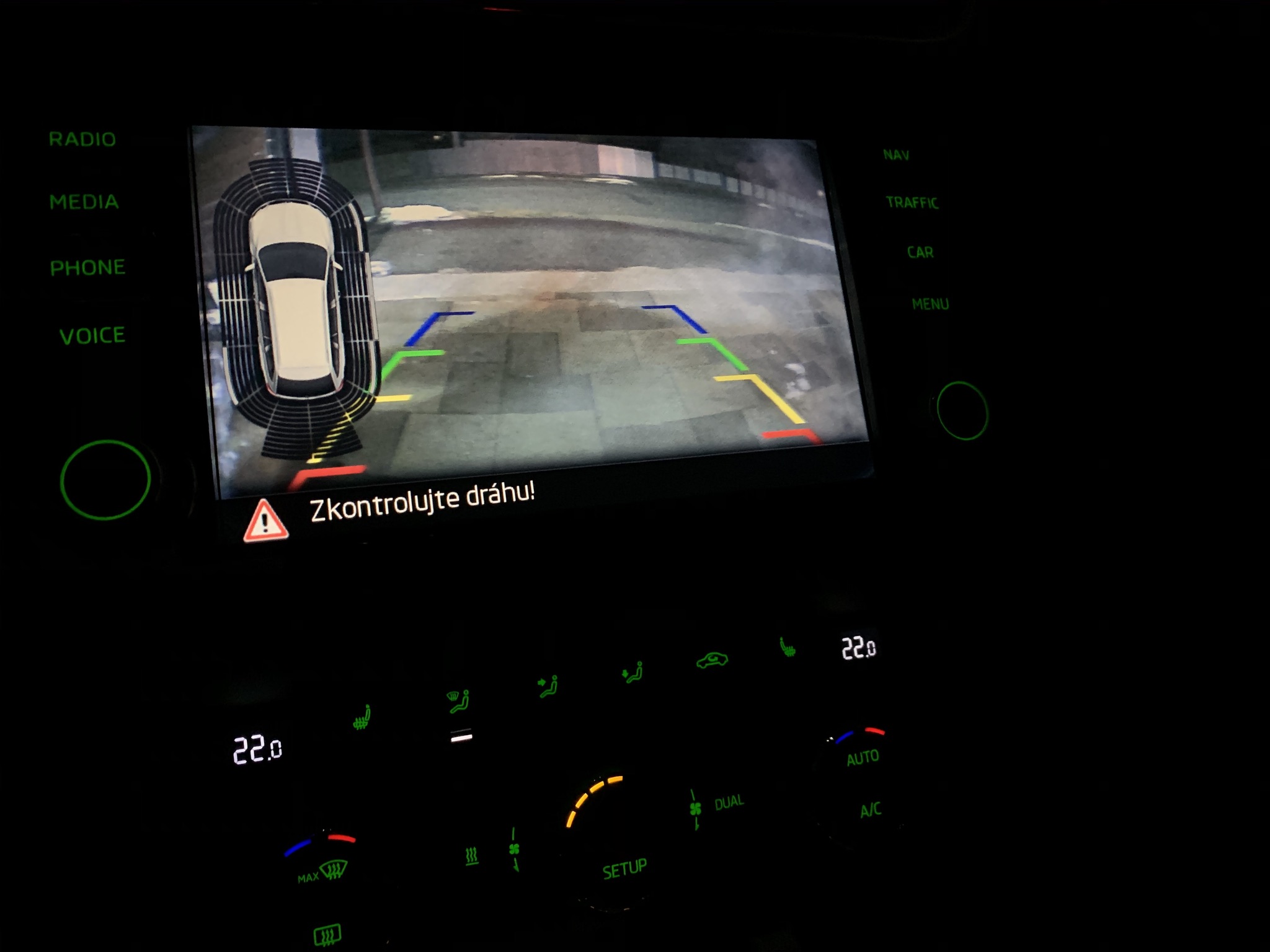

  5. Just to slightly update my retrofit. For those, whose cars are of earlier MYs (MY15 in my case, manufactured 11/14). I couldn't get the camera working in case the parking sensors activated automatically when getting closer to the objects in front of the car. When selected reverse, I got just the OPS view, not the picture from camera. It turned out that my gateway needed newer software to communicate with the camera as well as with the parking sensors module. So, the gateway has been flashed from index AC to AM, camera has been calibrated using special "domino" board. Now it works as it should. Picture from the camera is available immediately after switching the sensors on with the button, even if standing still and it doesn't matter which gear is selected and after automatic activation and selection of reverse, too. Completed.

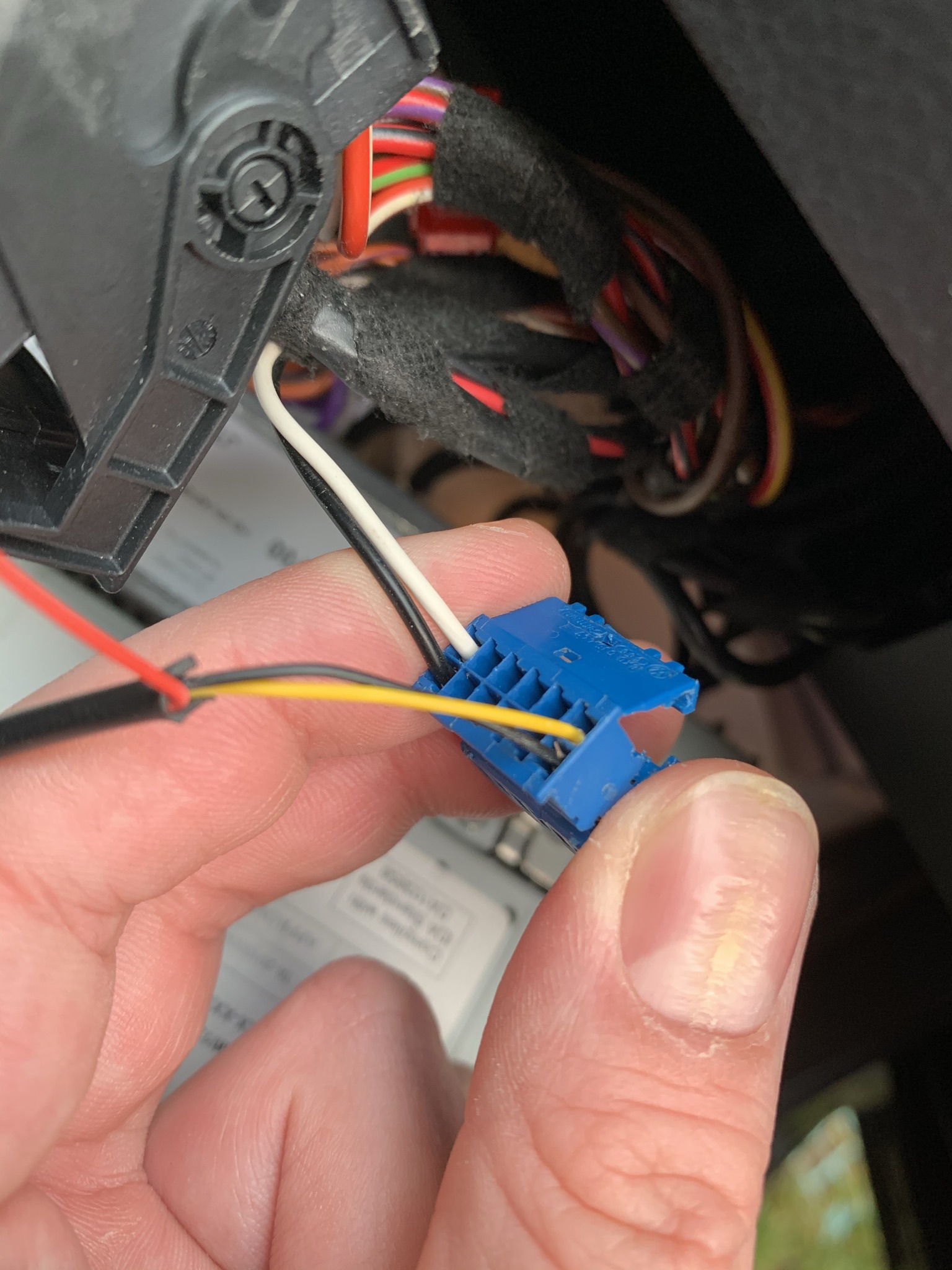

  11. Hi all! I'll give a small bump to the topic. I've fitted this RVC yesterday. The package includes all the necessary wiring as you can see in a photo. Everything seems to be an original part. I put the loom through the passenger side (LHD) along with the original wiring, what means you should remove: - boot lid lower panel - D-column trim - cover for boot lock carrier (doorsill?) - right side boot trim - rear passengers' seats (just the seating part, not the seatback) - right side rear passenger seat trim/airbag - right side front passenger lower trim - glove box I put + to the red-yellow cable in quadlock connector and - at the grounding point under the right side boot trim. Everything went well, no complications, besides the incorrect canbus connection. I followed the guide from vwmodul.de, but I didn't notice that the wires are in incorrect pins, so I had two differently coloured wires (orange-brown, oprange-violet) opposite each other in the final connection. So, I just pulled them out of the connector, changed the pin positions so that same colour connect together and problem solved. It doesn't need to be calibrated, just coded in gateway, park assist and infotainment unit. Camera works well, but in my opinion it has slightly worse image than the old cam. However, I like the benefit of various regimes, dynamic lines and that it doesn't shut off immediately after switching from R to D. It also has a washer, but I hadn't the parts to connect it, so for the next time. If anybody is considering the retrofit, I can recommend.

  18. Hi Rabah, the last one is my post at the Czech forum. The picture was provided by the seller. However, I followed the YouTube video guide in combination with the guide forwarded from another forum member. I have estate, so the video may slightly differ. My camera is lined to the rear wiper connection and video cable is routed through the right side of the car to the infotainment's blue 12 pin connector - pins 6 and 12 (I don't remember which one is ground, but if you have mic connected, it's at the same side like the black wire of mic connection)
