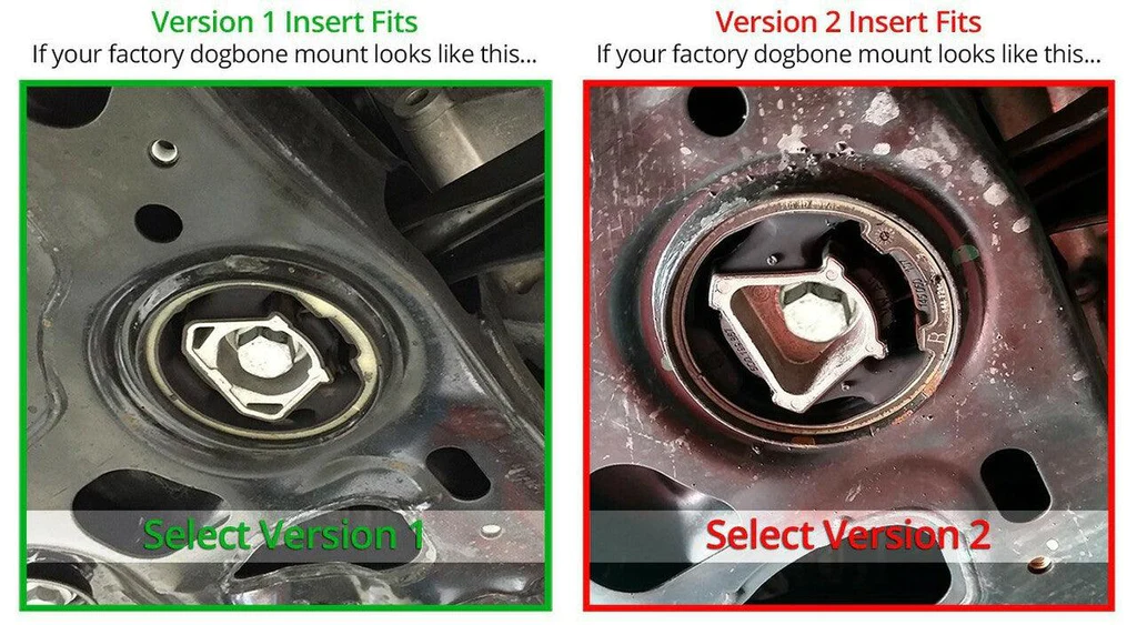

Sorry I missed part of the post during an edit! Yes an 034 Motorsport insert into the rear rubber mount (Version 2 in my case). https://www.awesomegti.com/034motorsport/034motorsport-billet-aluminium-mqb-dogbone-mount-insert/ In Joel's case it is probably just down to the worn front bush in the dogbone itself though. (My car was pushing 505 Nm after the remap)

Yes that one will be pressed in, not looked into that one in too much detail (my car was brand new when I fitted the insert, so nothing 'wrong' with it other than not being stiff enough) I would imagine the gearbox side will wear much quicker due to being smaller and getting warmer so you may get away with just doing the dogbone? You really need to remove the undertray and use a pry bar to see where the play is all coming from.

Could be the (dogbone) gearbox mount. Had similar knock when mine was remapped, cured by fitting an 034 Motorsport insert into the rubber mount. (Mine was a type 2)
