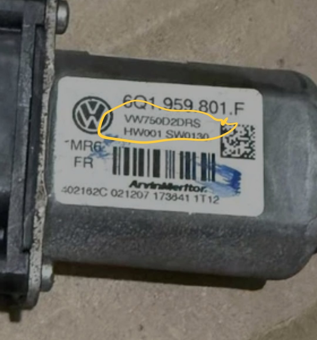

- Another infamous broken electric window
The damage in this picture is affecting the connection I would expect yours to have damage at. (Driver's window switch input)- Another infamous broken electric window
On the way to removing the board, the first step is to unclip the adaptor which connects door loom plug down onto the board. Close scrutiny of the contact forks of this that go down to the board-mounted connector will be worthwhile before delving any deeper, as there may only be corrosion on there, but I doubt it. (Second, obvious step is to remove the 4-off Tx20 screws holding metal motor can to plastic housing).- Another infamous broken electric window
It's in the plastic part of the motor module. I made a little video which shows safe removal of it, in this thread: https://www.briskoda.net/forums/topic/537822-front-window-going-mental/#findComment-5996101 If the steel motor casing is just pulled out without the precaution shown in the video, brush damage is very likely.- Another infamous broken electric window
All of the above damage is produced by condensation in the gap between the plastic connector body (connectors have been unsoldered in all these images) and the board surface.- Another infamous broken electric window
From your excellent investigations I would think the problem is almost certainly a corrosion problem that is affecting the driver's side motor module circuitboard. The pin of the connector on the board which is the input which controls the right (driver's side) window from the switch, specifically. I have posted lots of images of the sort of damage that can occur under the connector body, but can't remember which thread they are in. I'll search out one or two examples and post here shortly. Replacement or repair of motor will be only effective solution, I believe.- Intermittent power steering failure + ABS light linked to 12V socket?
