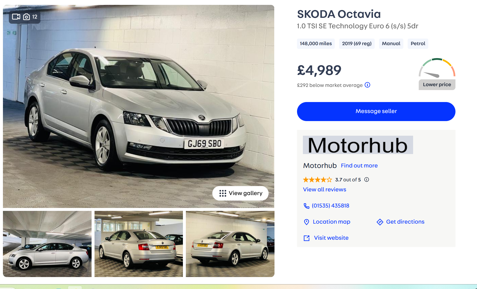

You could compromise and get an Octavia with a 1.0tsi engine. Frugal with practicality. Here is a super cheap high mileage on for sale:
