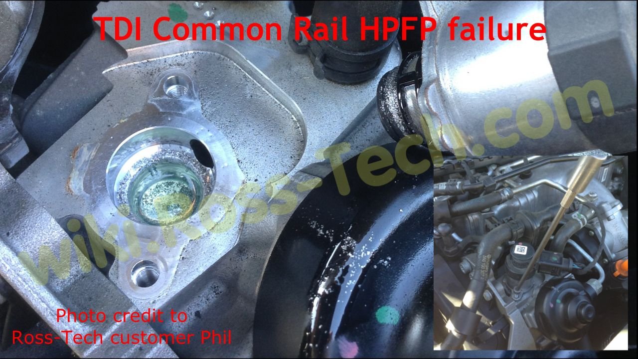

  2. P0087 is a fuel rail pressure issue. Suggestions to look at: Possible Solutions Check Measuring Values for Fuel Pressure Check for bent/squeezed Fuel Lines Check Low Fuel Pressure System for Leaks Check Fuel Filter & Filter in Fuel Pump Check the Fuel Quantity supplied by the Fuel Pump Check for fuel pressure loss from leaking fuel injector Visual Inspection of Hardware (Camshaft, Cam Follower, ect) Also check to make sure you don't have fuel contamination as that would also cause problems. Look at testing the Fuel Rail Pressure via an analogue tester. When you changed the fuel pump, assumed you used a good quality part? There is also a good image from Ross-Tech about high pressure pump failures:

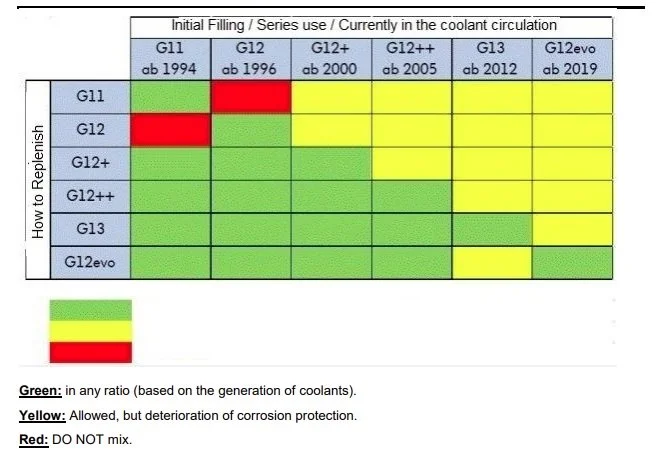

  7. Excessive moisture and also as a lubricant (sorry I missed out that bit). I would also correct an earlier statement about G12+ - that should have been G12++. The helpful chart gives a better timeline.

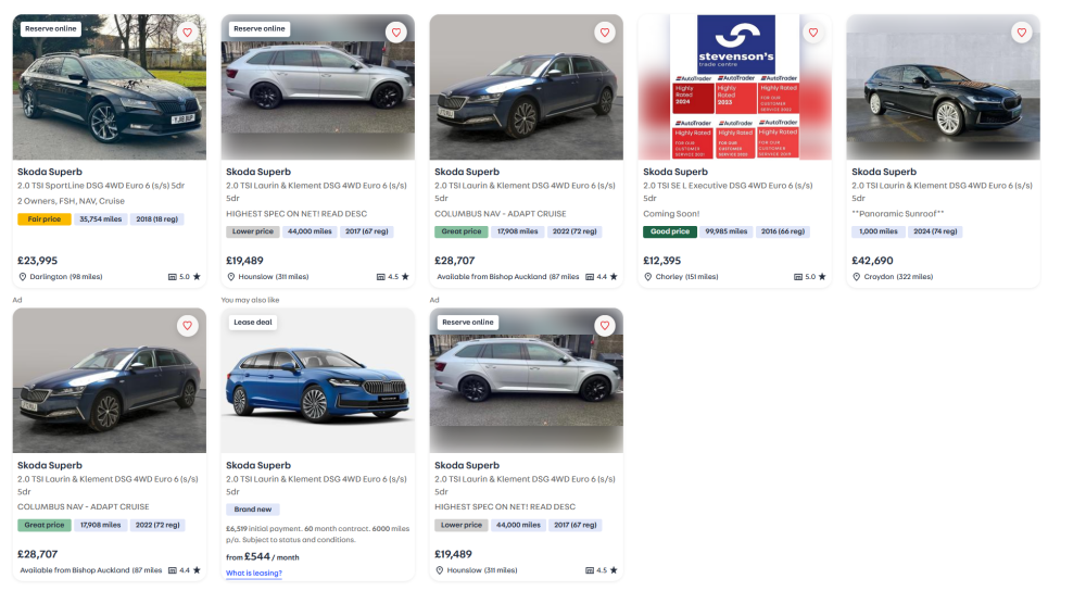

  21. oh yes, there is. It just isn't called a VRS. If you can get hold of a TDI Bi-Turbo 250bhp version, they are definately quick. You will even see the recent articles of breathed upon TSI cars making 500bhp, so they are out there. Typically, you are looking for a TSI Superb 4x4 version and ideally an Lauren and Klement version too. A quick Autotrader search showed the following:
