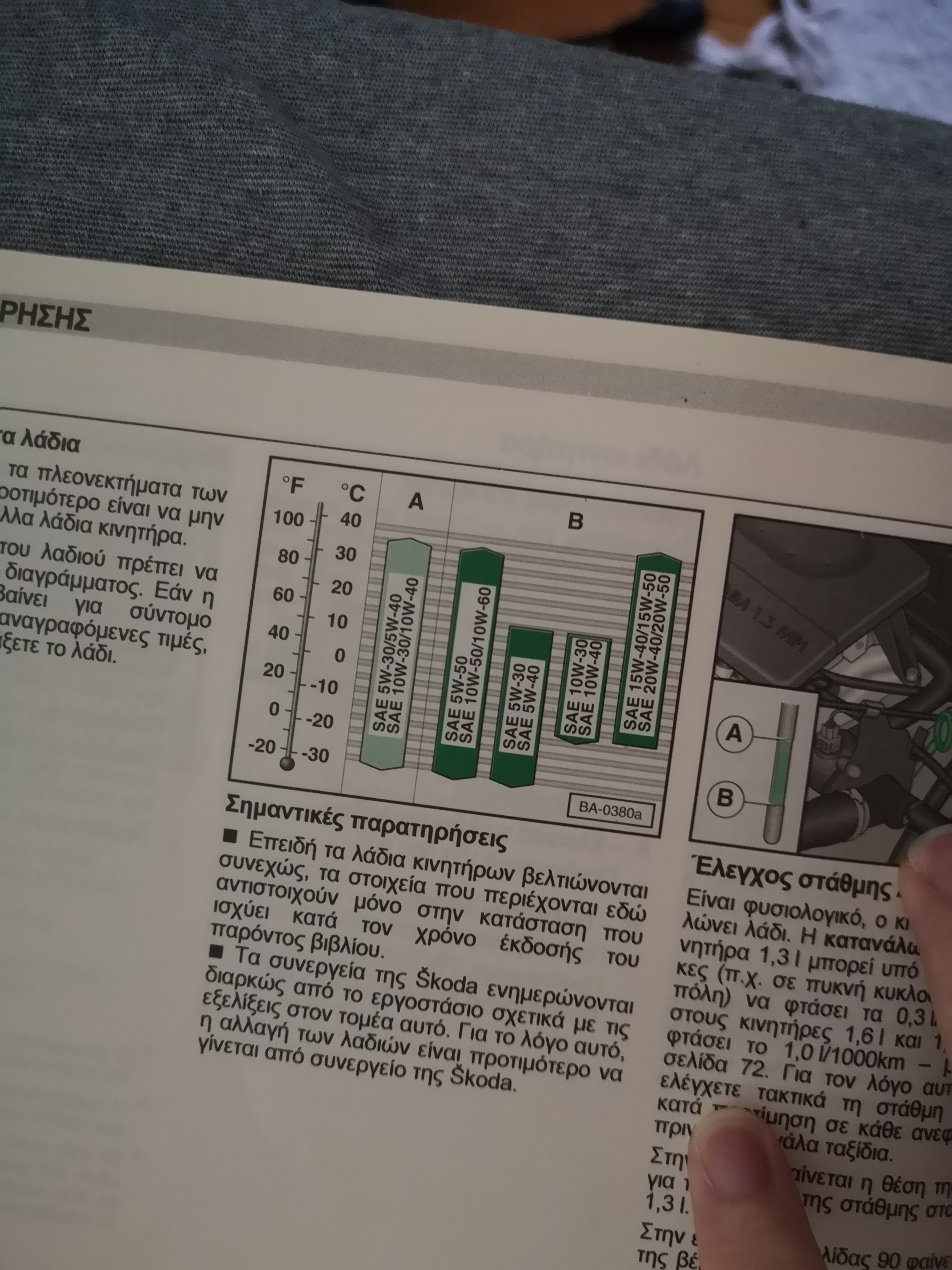

8 hours ago, RicardoM said:
Skoda factory recommended at that time (1994-2001) to use mineral engine oil 10W40 for petrol engines.
Sorry to break the news to you but you are wrong this time.
According to the official user manu in my possession for the environmental temperature range in southern Greece
-5C - 40C the reccomened oils are the last bar
Not 10W40 as I have advised maybe 5W50 for the widest range but 15W40 or 50 for the real mediterranean conditions
Edited by Thefeliciahacker

In the chart that @Thefeliciahacker posted:
Petrol engines
A - Light Multi type oils
specification VW 500 00
B - Multi type oils
specification VW 501 01
specification VW 502 00
specification ACEA A2 or A3-96
The viscosity class of the oil must be selected based on the diagram. If the temperature exceeds the indicated values for a short period of time, there is no need to change the oil.
Important Notes:
Because engine oils are constantly being improved, the information contained herecorresponds only to the situation valid at the time of publicationof this book.
A 10W40 multigrade oil is designed for outside temperatures between -20°C and 40°C. I quote from my previous replies "Skoda chose mineral oil 10W40 for most countries having a temperate weather". I didn't say anything about mediterranean or tropical weather.
Furthermore, I have attached a screenshot from Skoda Felicia Workshop manual. You will find interesting notes that I emphasized in red. Remember that Skoda dealers' recommendations from year 2000 take into account two things: 1st: Felicia's engine was designed for cheap, mineral oil (to keep maintenance costs low and also because it is not a performance engine), and 2nd: temperate weather was different in temperatures range than today.
Felicia workshop manuals are above Felicia owners manual, also I had the occasion to exchange technical information about my Skoda Felicia with numerous Skoda mechanics in VAG dealerships when I worked in Europe.
The engine on my Felicia 1.3 is running strong with high compression at 180,000 km and I used 10W40 mineral oil till 2010-ish, then 10W40 semi-synthetic oil till today. Any full synthetic oil IN FELICIA engines has two visible disadvantages: leaks around all seals and also "boils" in the engine oil sump, then the vapors are sucked through the PCV hose into combustion chamber where they are burned. The mineral part in the semi synthetic oil FOR FELICIA prevents those 2 issues.
PS. I hope that our friend JR will find my reply satisfying for his sarcastic demands.
Interesting facts, but from what I see the owners manual preety much has combined these oils in my right most category but the 50 weight oils seem to be able to stretch a bit higher in the temp range which I like.
As for the notes it doesn't come as a surprise that lower than 10w shouldn't be used, the oil pump has to be able to pump it and it's a straight gear style.
As for fylaktos I've warned him he shouldn't use 5w40 he does not listen, quite frankly I cannot care any more...
Petrol engines
B - Multi type oils
Important Notes:
I hope you understand I am trying to protect you here, yet you keep on insisting about the 5W-40 being fine, which everybody on this thread is saying no, some people suggesting 10w40 some people 15w40
Some people 15w50.
All of them more viscous, it's your motor your money your time at play, I think you should reconsider for the life of your motor, or at least fit an oil pressure gauge
