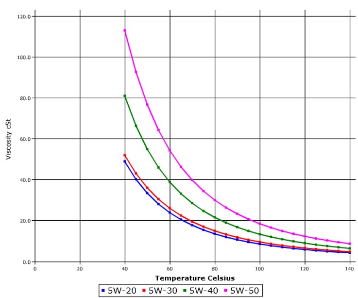

10W40 @80C has a kinematic viscosity of 24 centistokes
5W40 @80C has a kinematic viscosity of 21 centistokes
and thats relevant for brand new oil the more the polymers mermanetly shear the bigger the gap...
You want to keep using 5W GO FOR 5W-50 at least

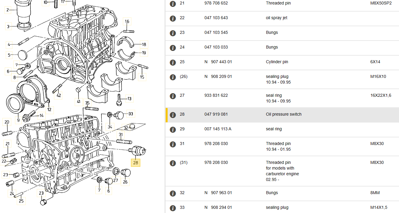

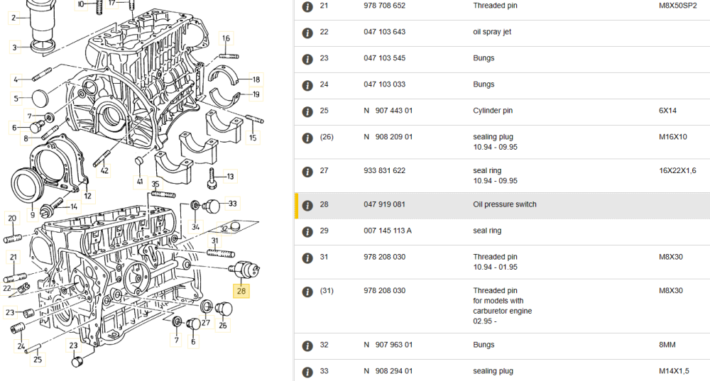

Here, I think.

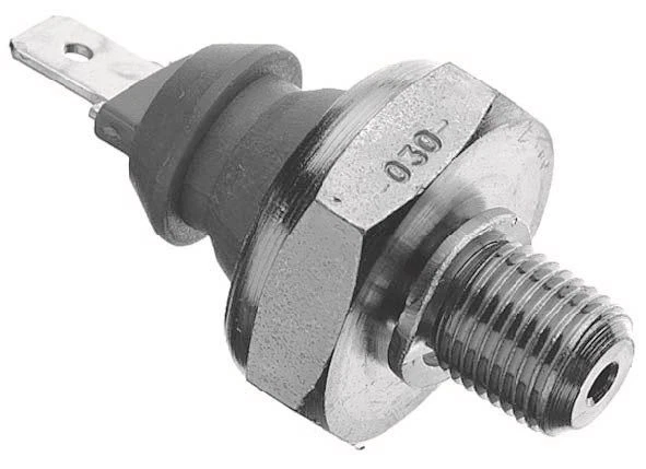

I know only for one, looks like this
the part code is 028 919 081 D, has one cable and a plastic cover for protection.
Yes, that is an oil pressure switch. According to this page though, that one is only correct for 1.6 and 1.9 engines?
See my previous post for 1.3 engine PN.
@Breezy_Pete Here it is in a Favorit, it's in the right side of the block in the lower section of the picture.
  • Sponsor
Different screw threads. Not equivalent.

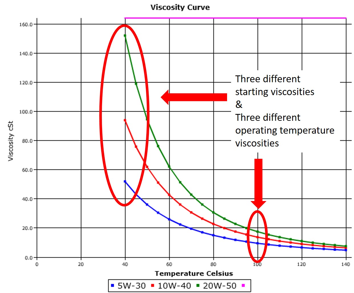

Don't get stuck too much on the numbers, a better oil with better base stock and better additive package will offer better and wider protection for longer.
If you only want numbers then why not cover the range with a 5w-50 (bearing in mind 5w and 50 or any other set are ranges and oils vary where they are in the ranges and how long they stay at their figures).

Usual chart.
