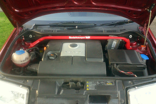

CIMG3022.JPG?imgmax=512
Got mine on this evening; though I did have to loosen the third bolt on each side to allow me to reseat the strut on its mounting to get the brace to fit cleanly. There's enough tolerance in the mount that the chance of the brace fitting with just 2 bolts removed is a bit hit and miss.
