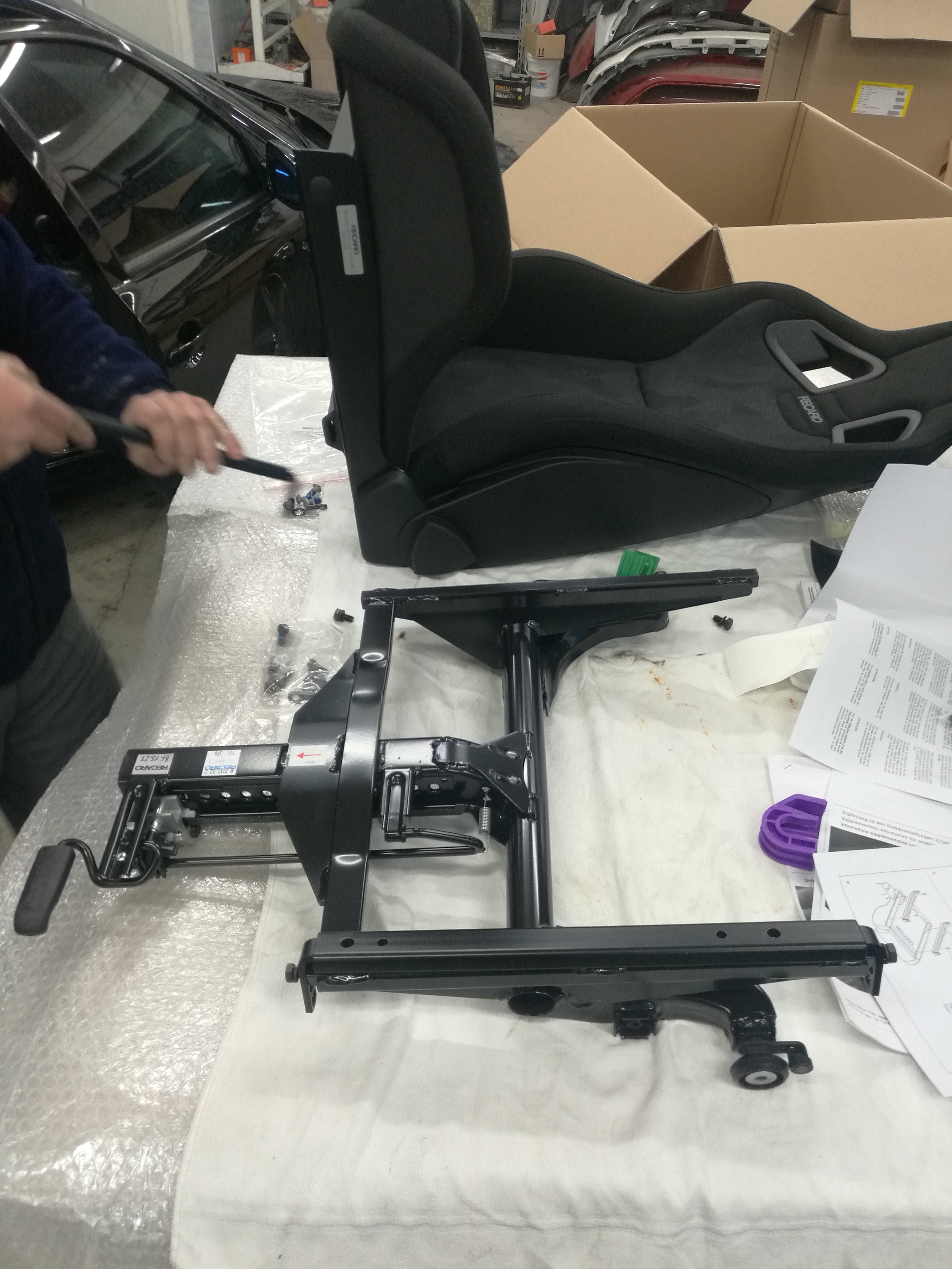

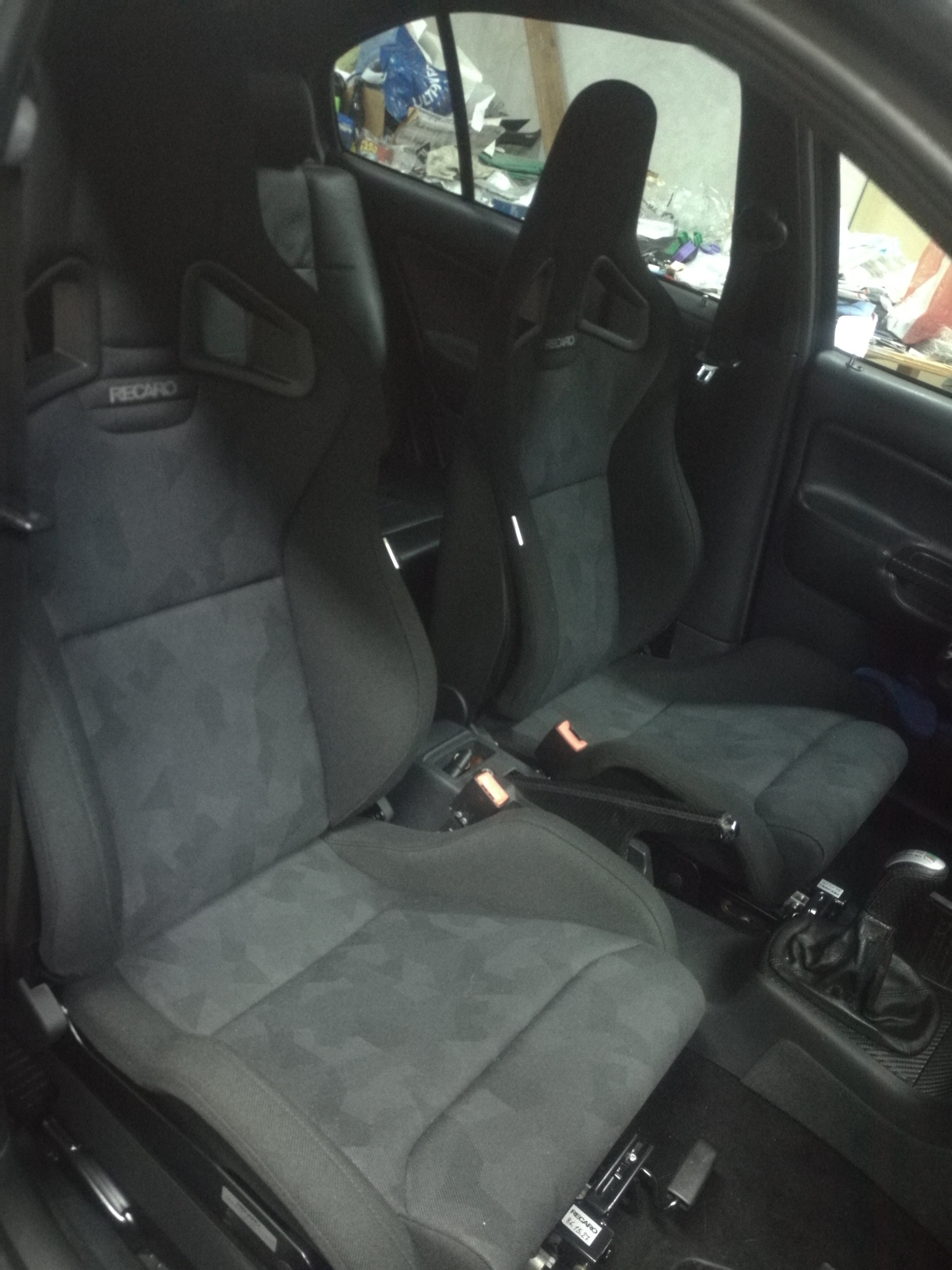

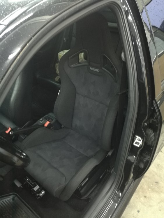

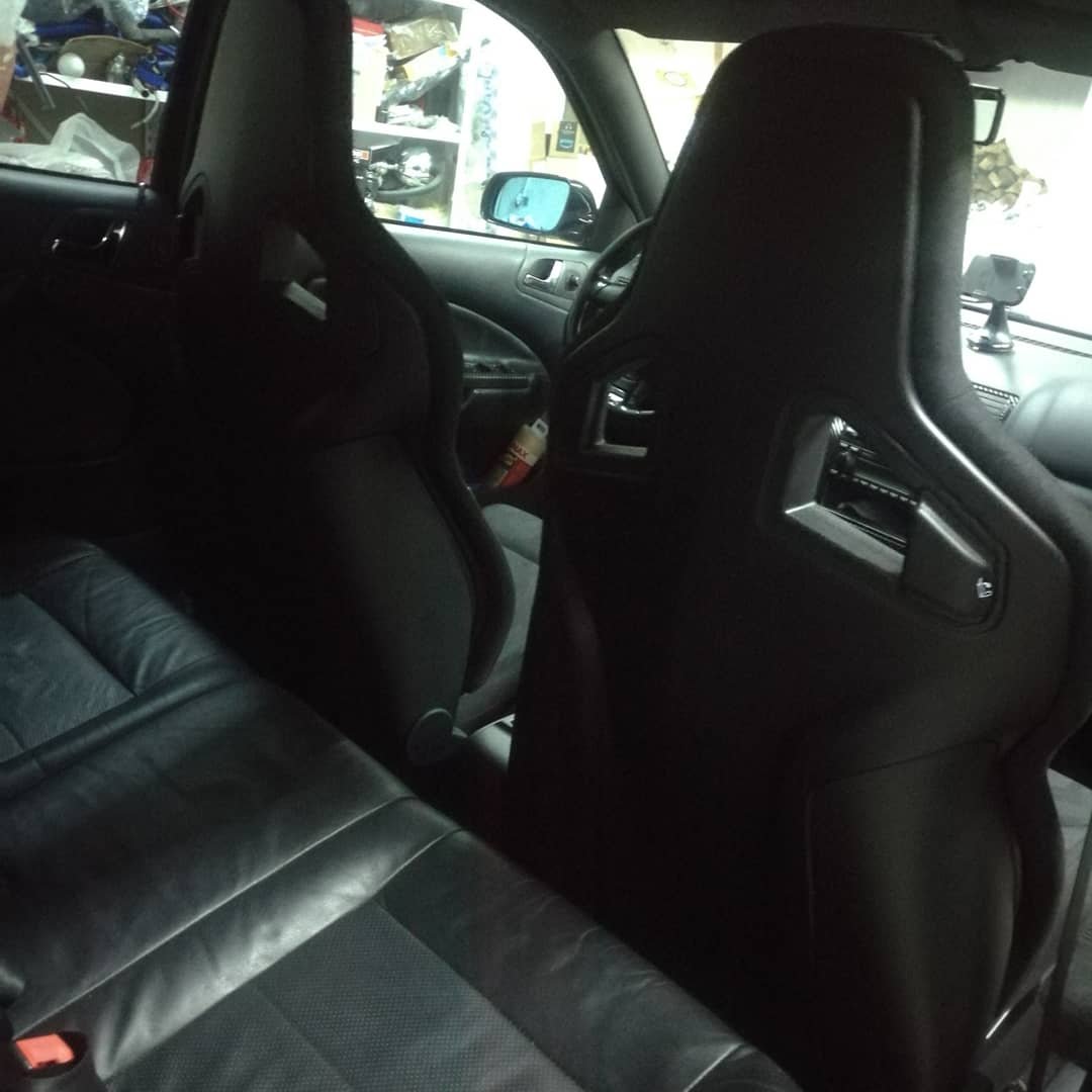

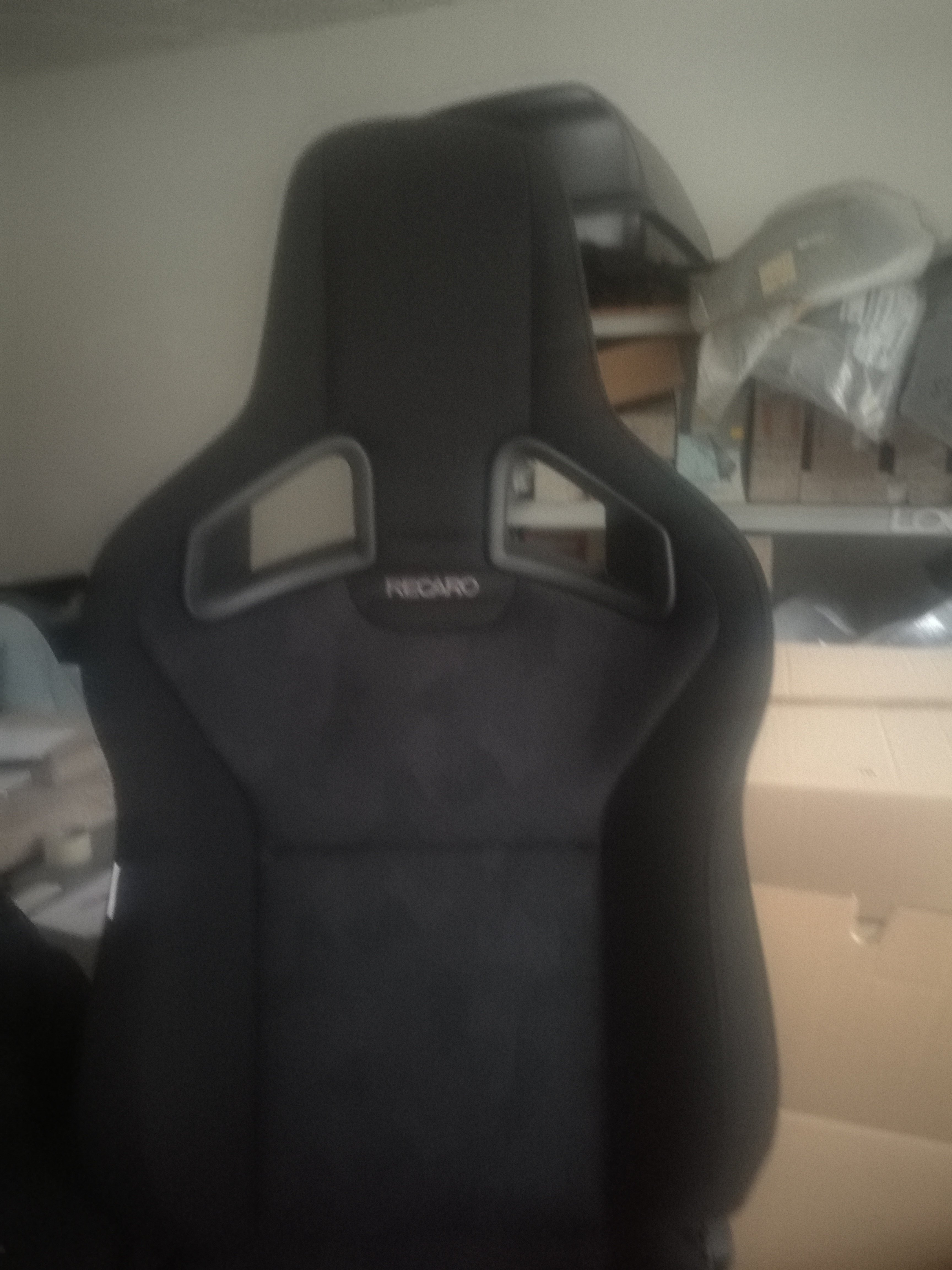

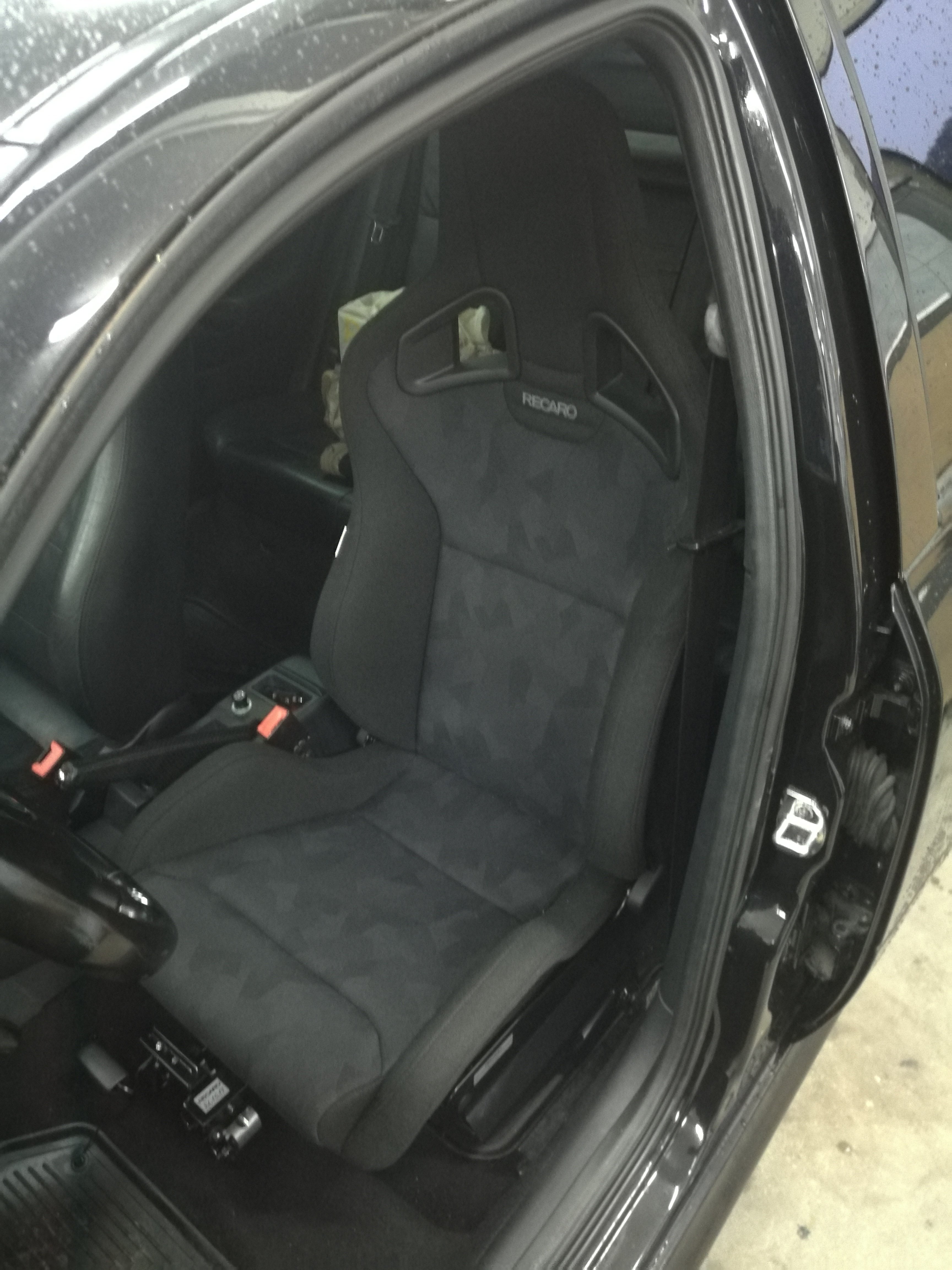

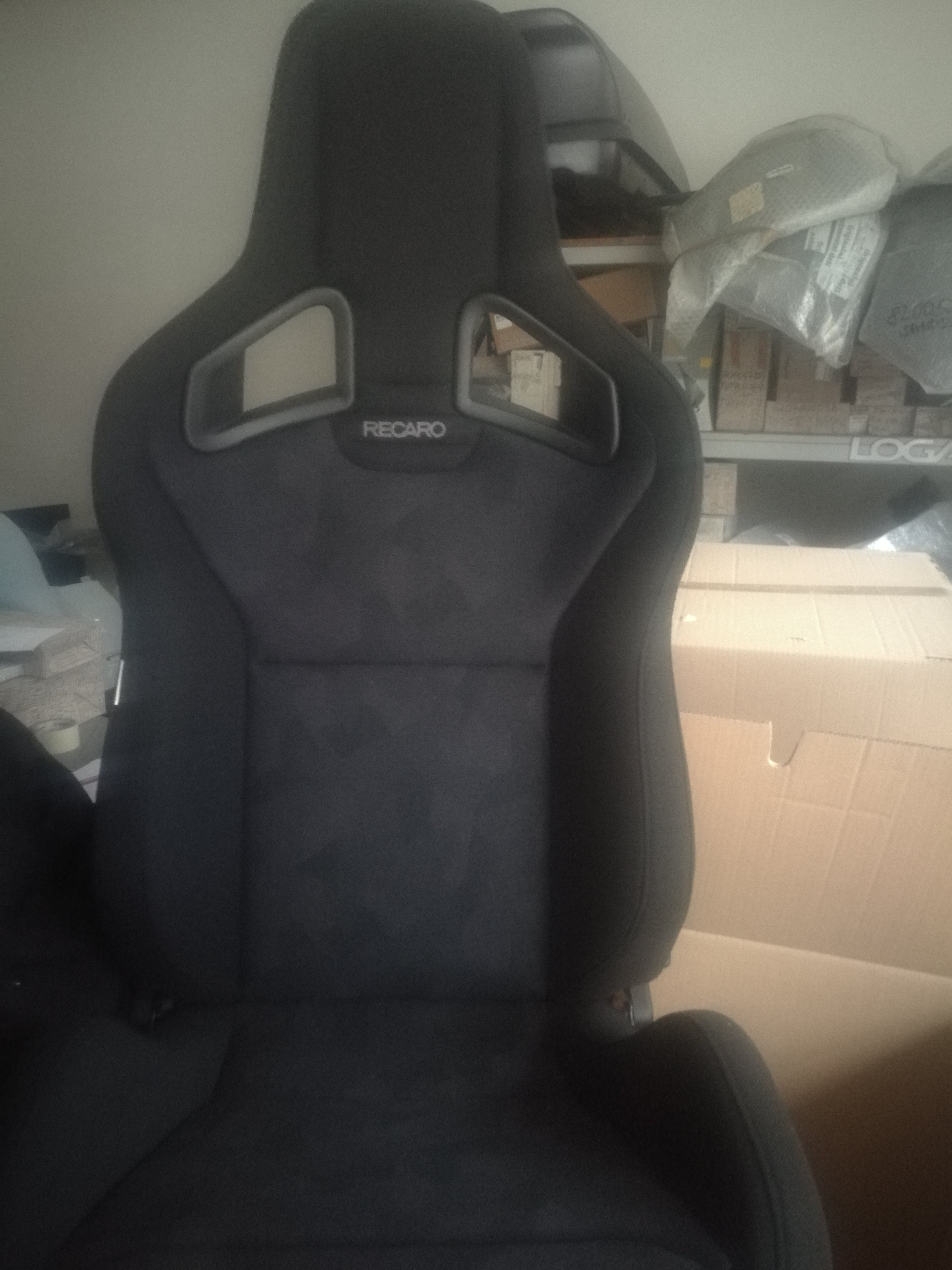

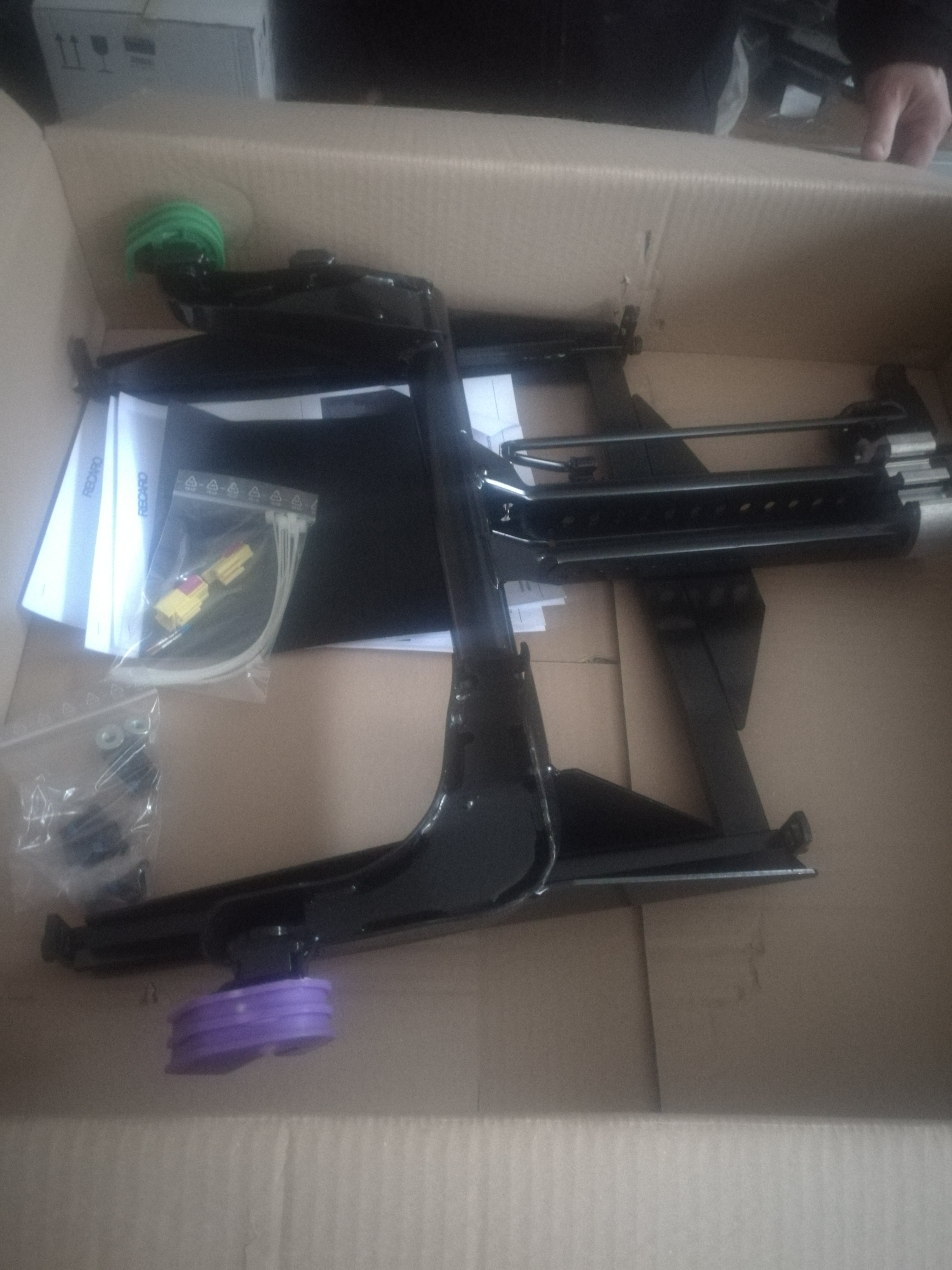

So today I finally introduced myself to my two new best friends: left anf right brand new Recaro Sportster CS with Recaro car specific rails. It was great pleasure. Can't wait for installation on monday. Alive they look much better-dark black and design in center almost non noticeable. Great!!!?!

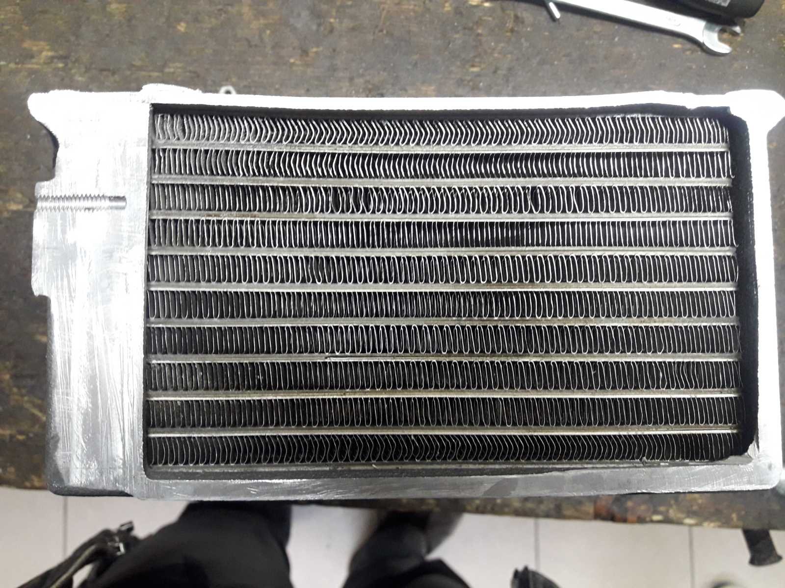

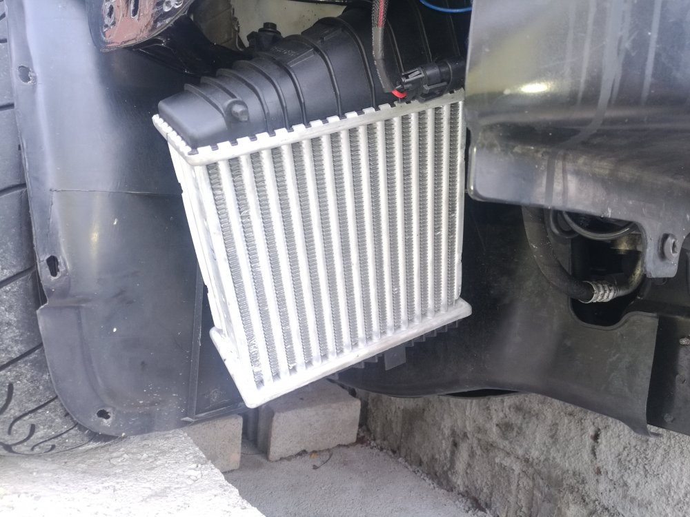

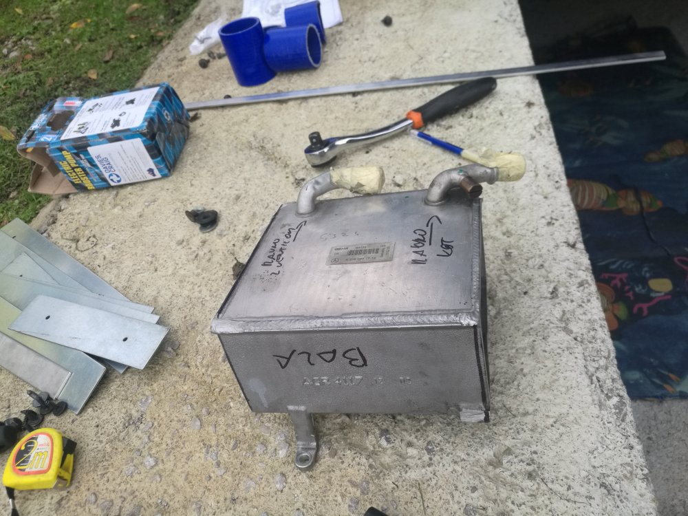

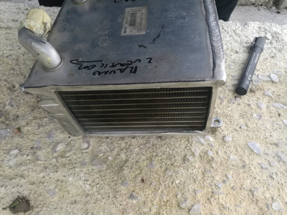

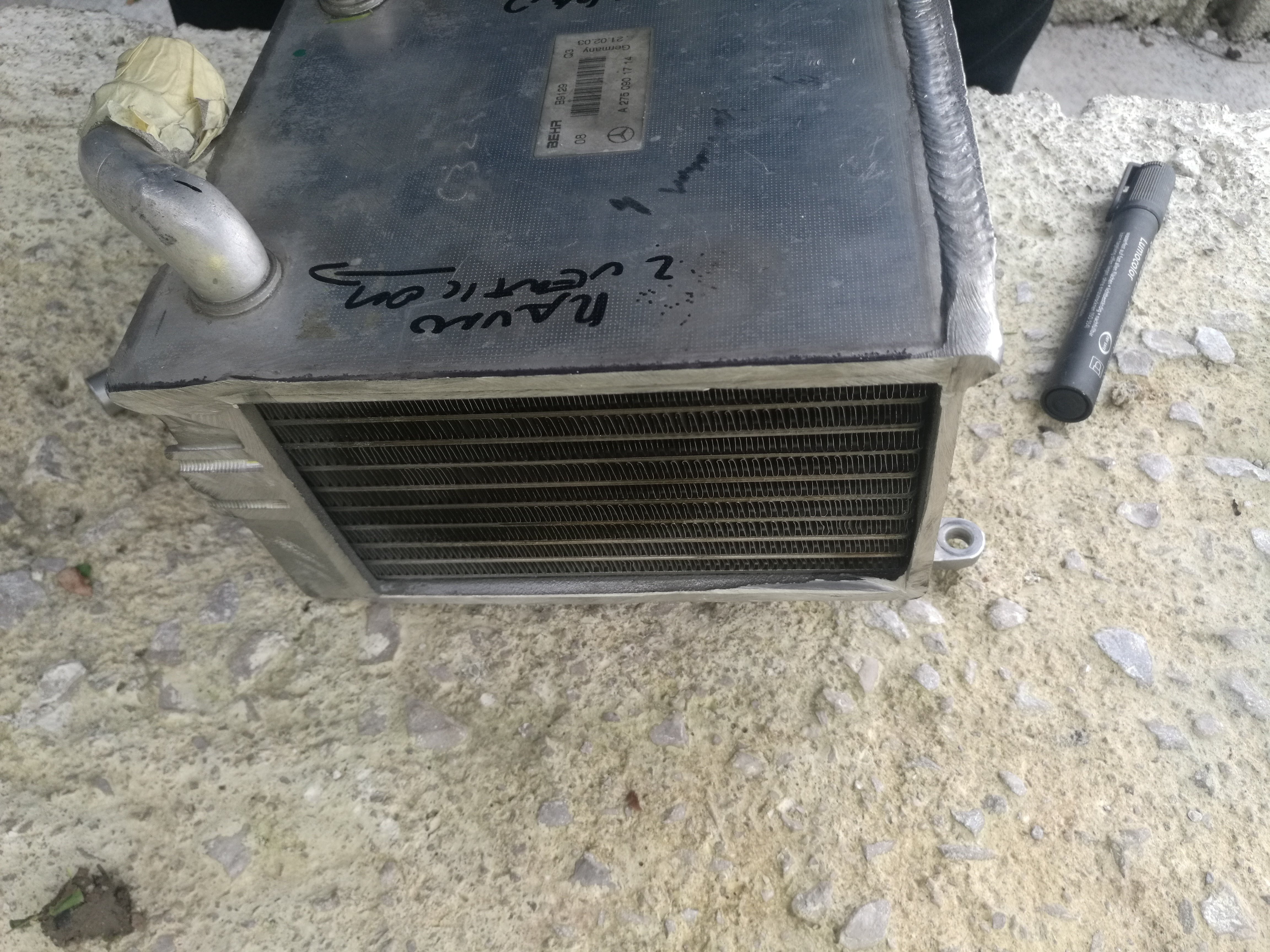

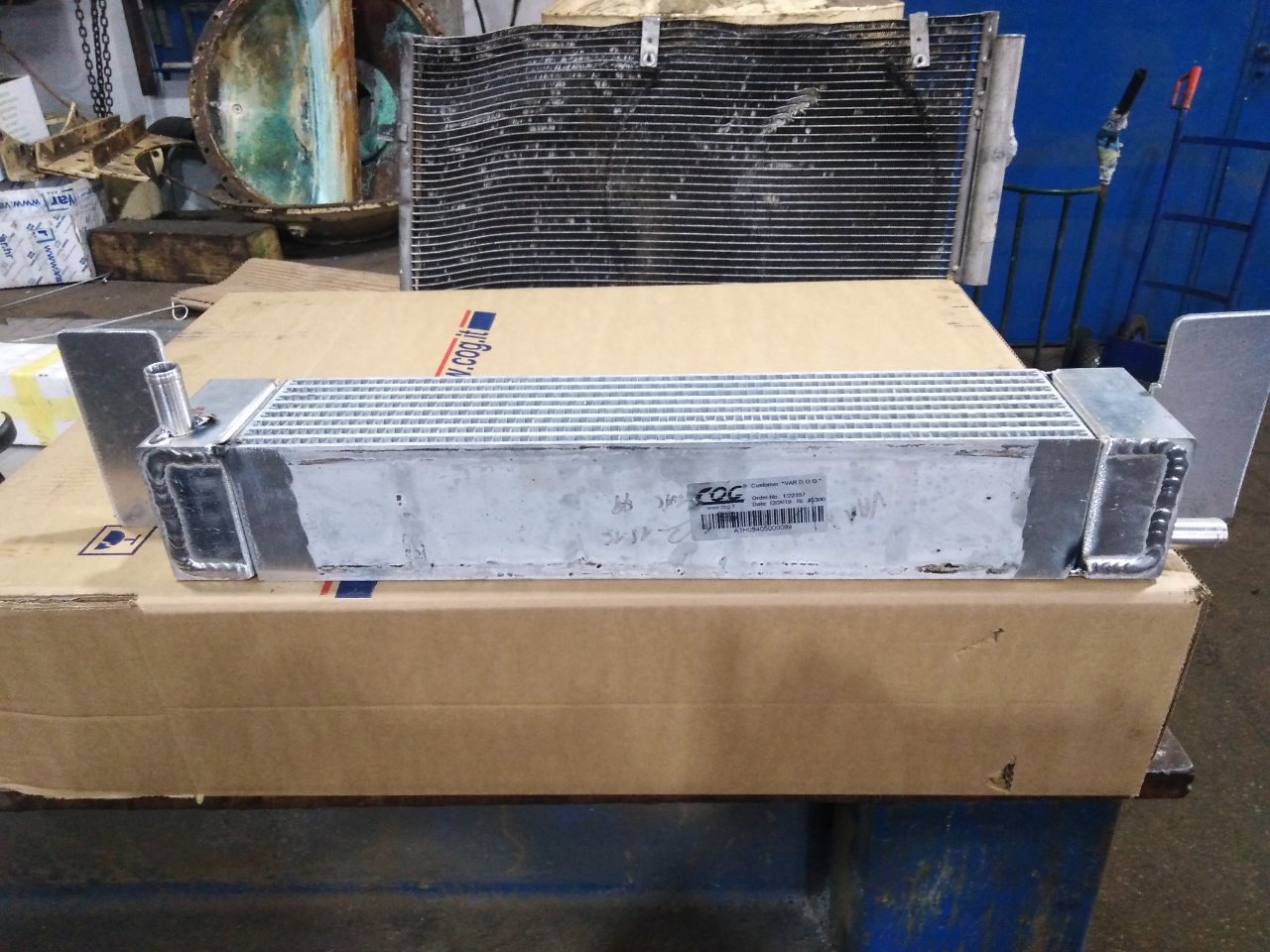

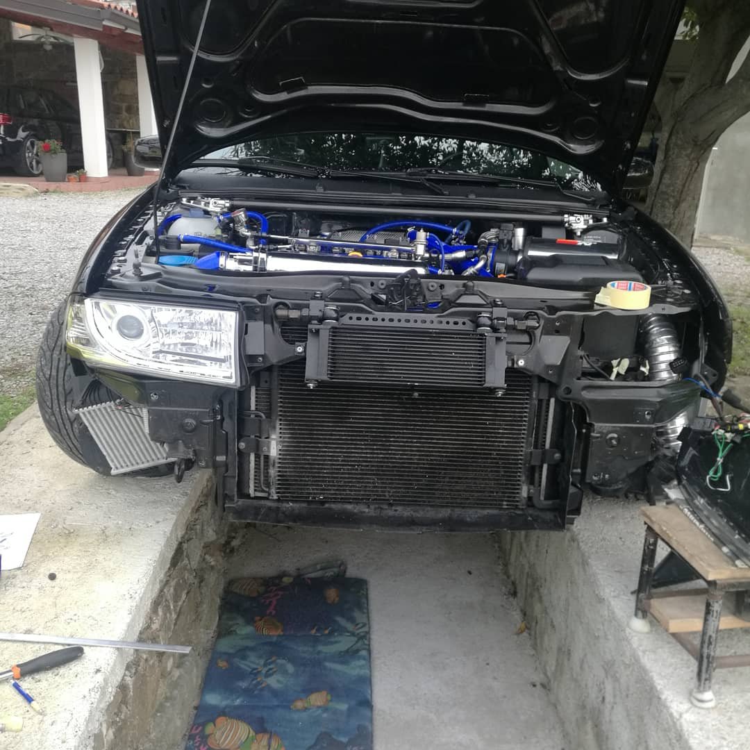

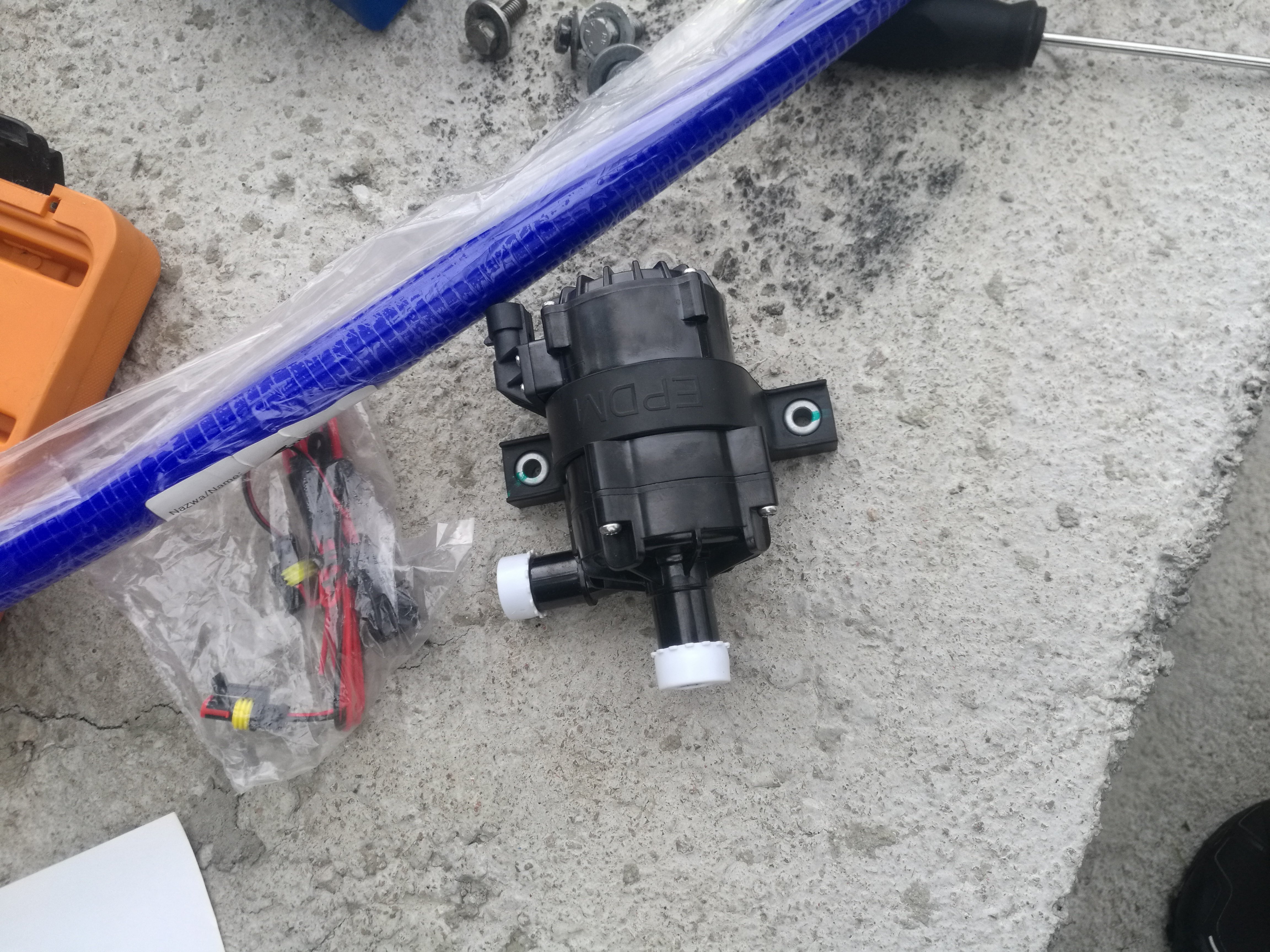

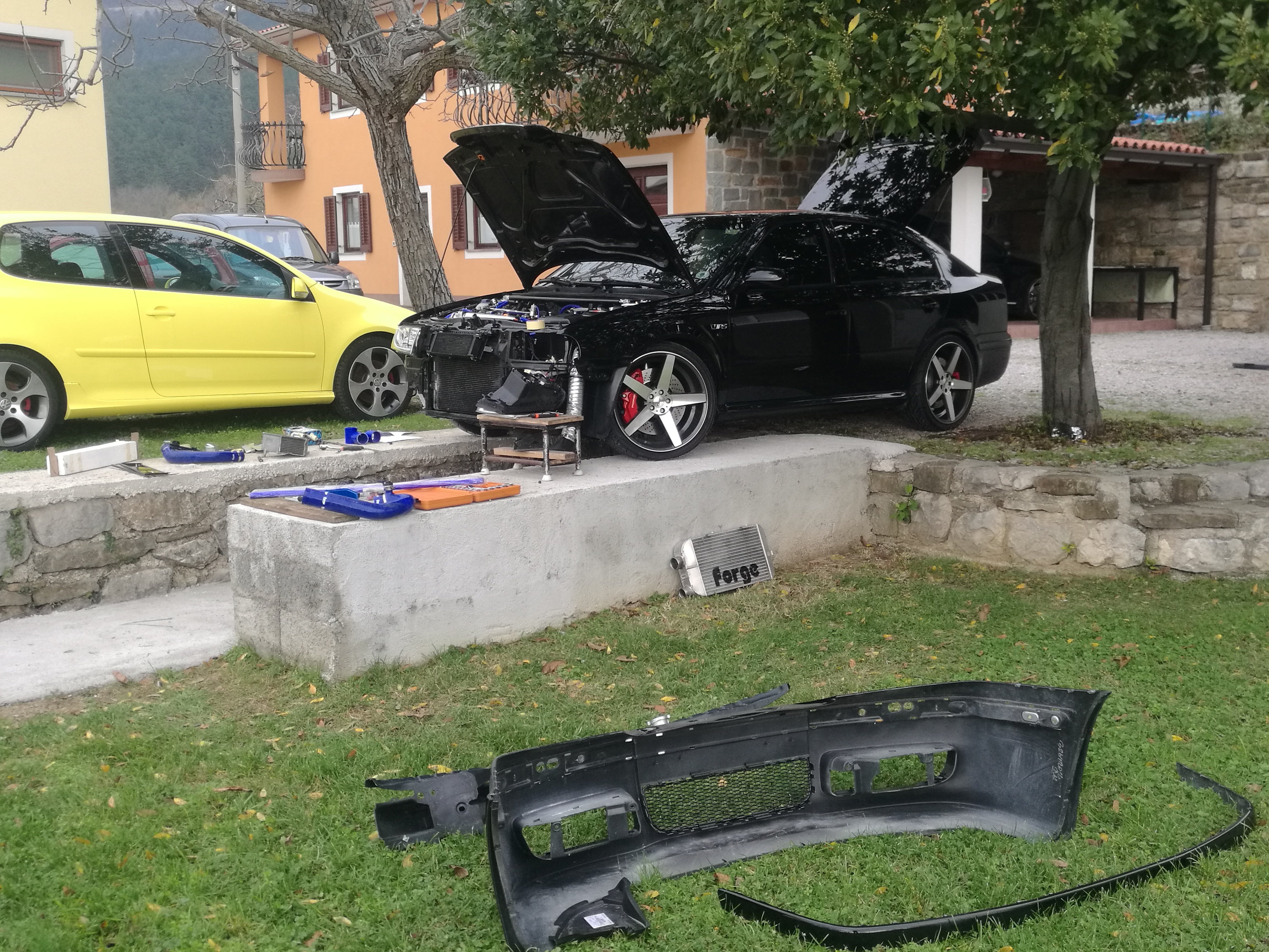

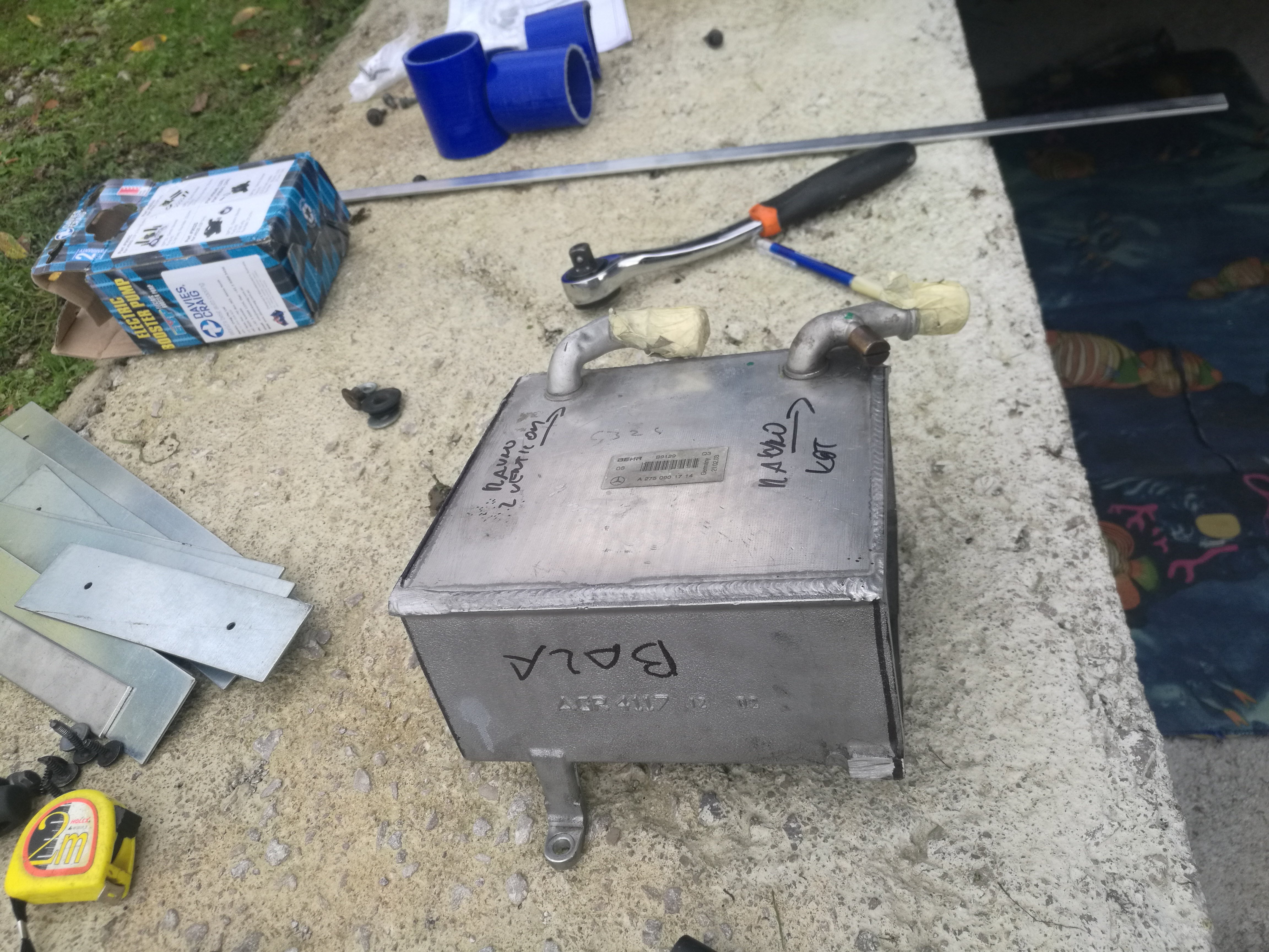

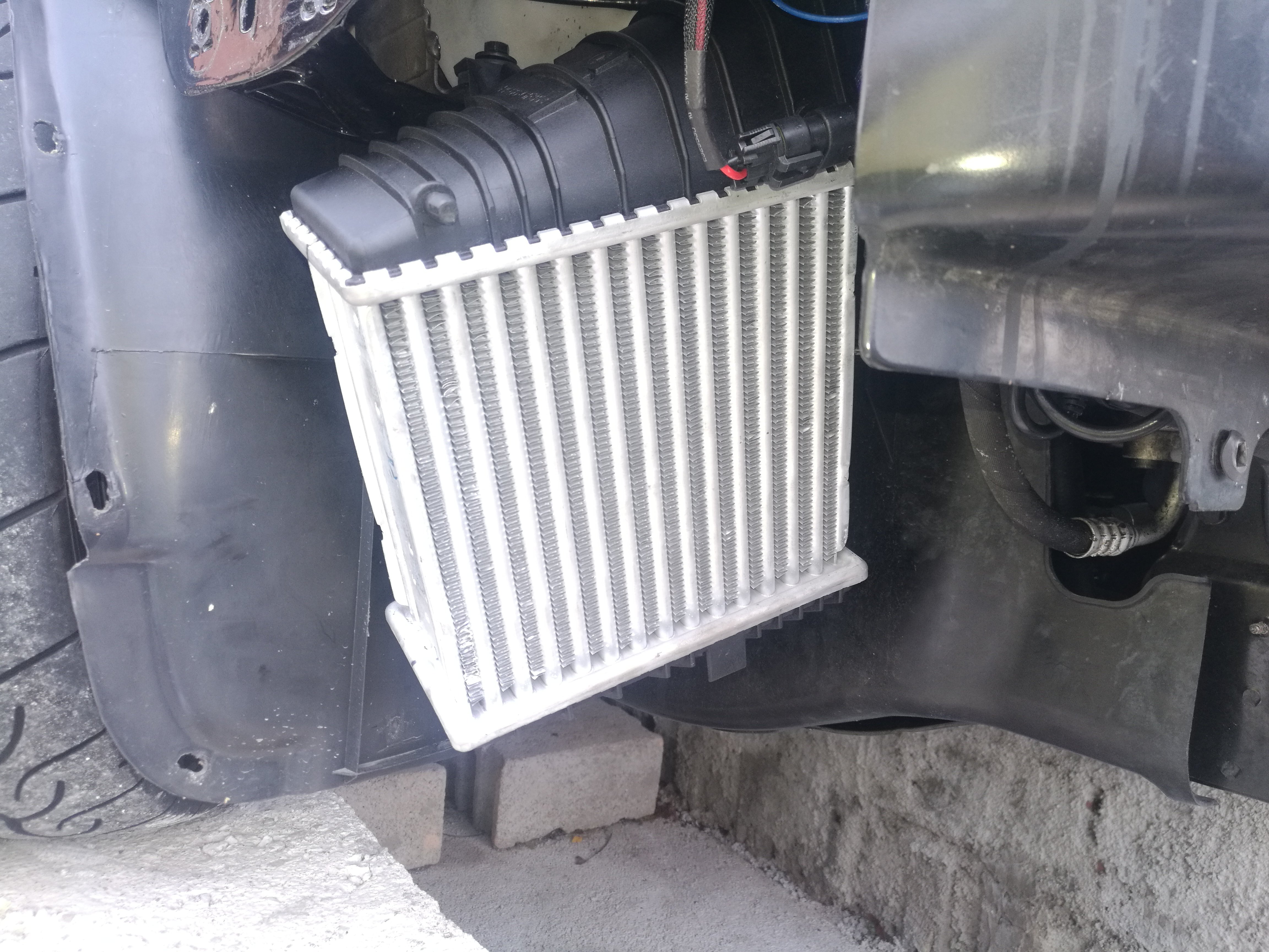

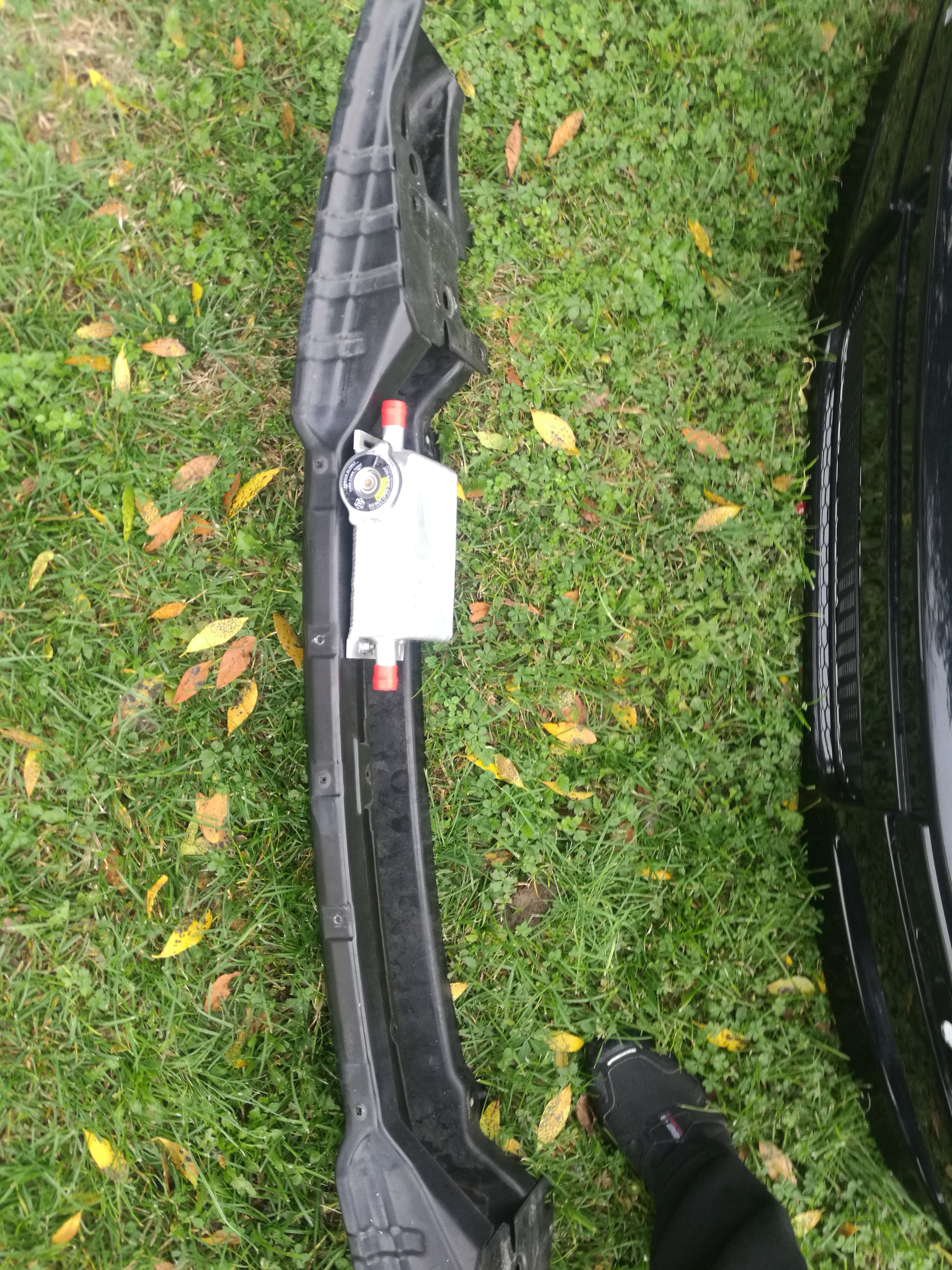

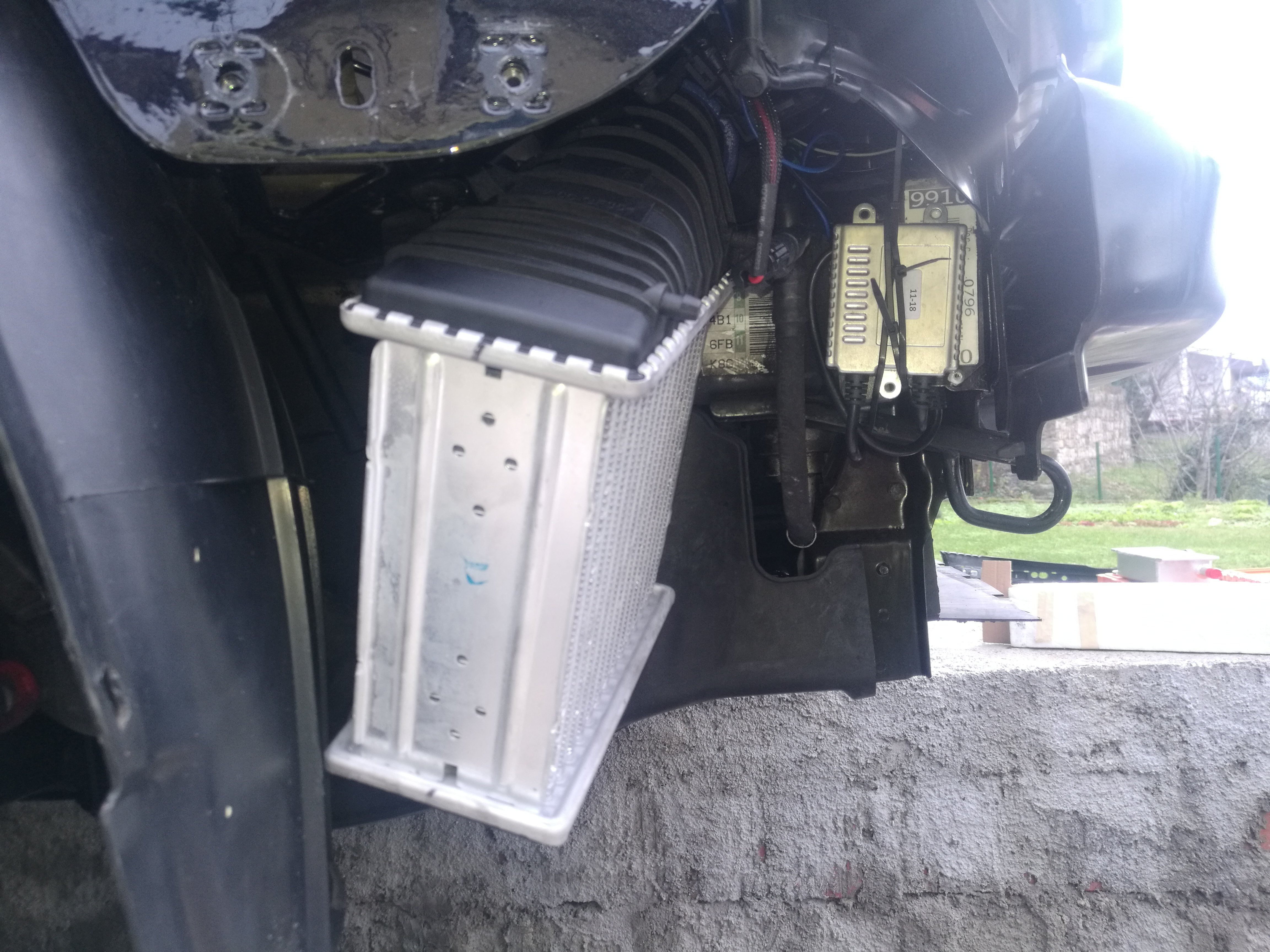

Due to the fact "custom" made wcac by Bell intercoolers USA had poor flow on flowmeter from Akrapović exhaust compared to stock AMG one, I took OEM SMIC to make endplates according to it for AMG core. I cut of AMG endplates and checked its position in place, decided where to route water inlet and outlet. Corrected sheme for installation regarding fill and expansion tank, and checked route for 19mm tubes. Changed position from inlet pipe on water cooler-not any more at driver side but on top of cooler on the same side-still to beimageproxy.php?img=&key=00da0a65627968c1imageproxy.php?img=&key=00da0a65627968c1 done. Accidentally we found all there Inconel bolts holding turbo were lose-one sticking up for 1 cm. We retighten them.

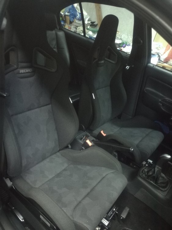

Recaro twins succesfully Installed🍾👍💪

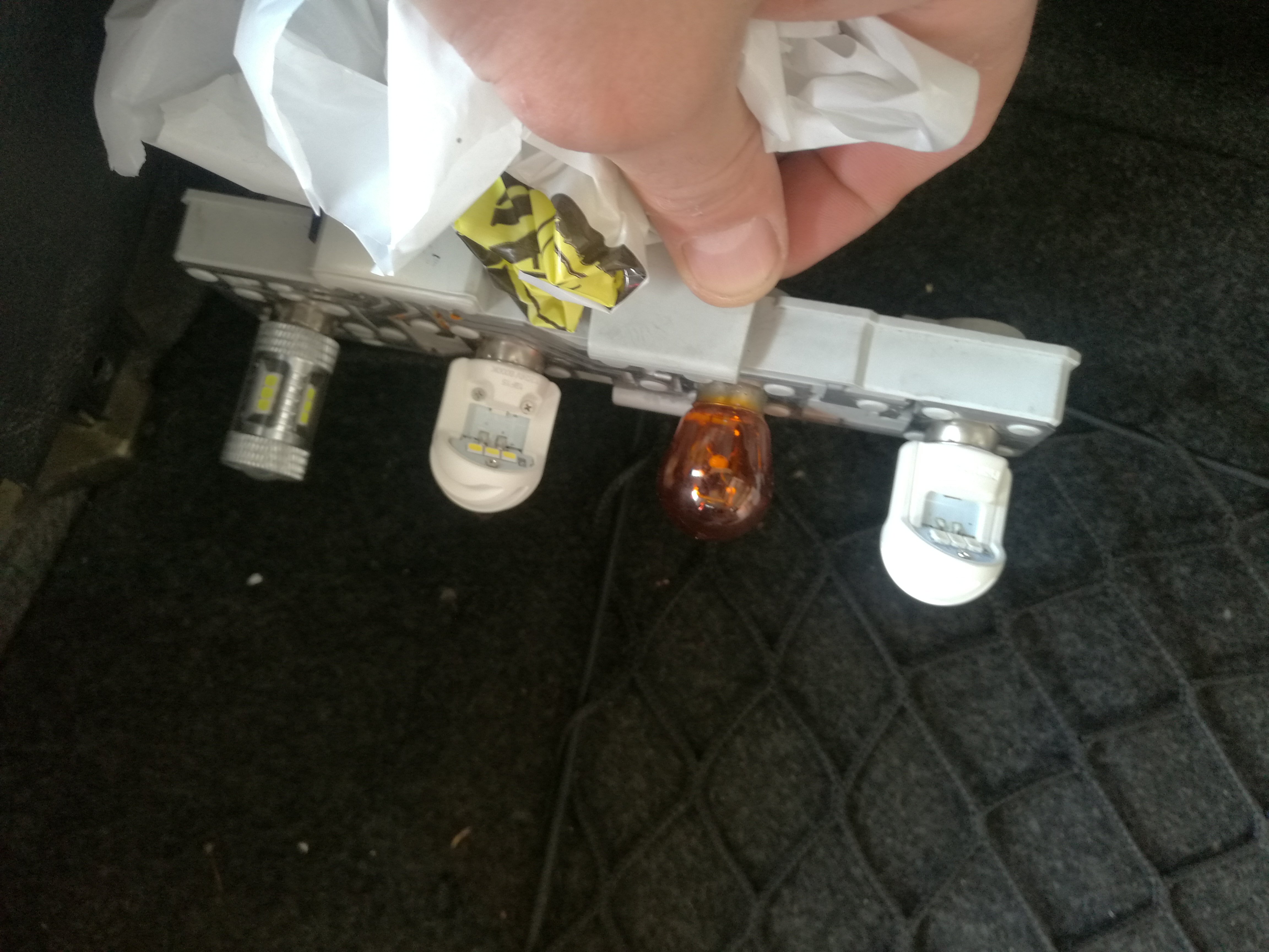

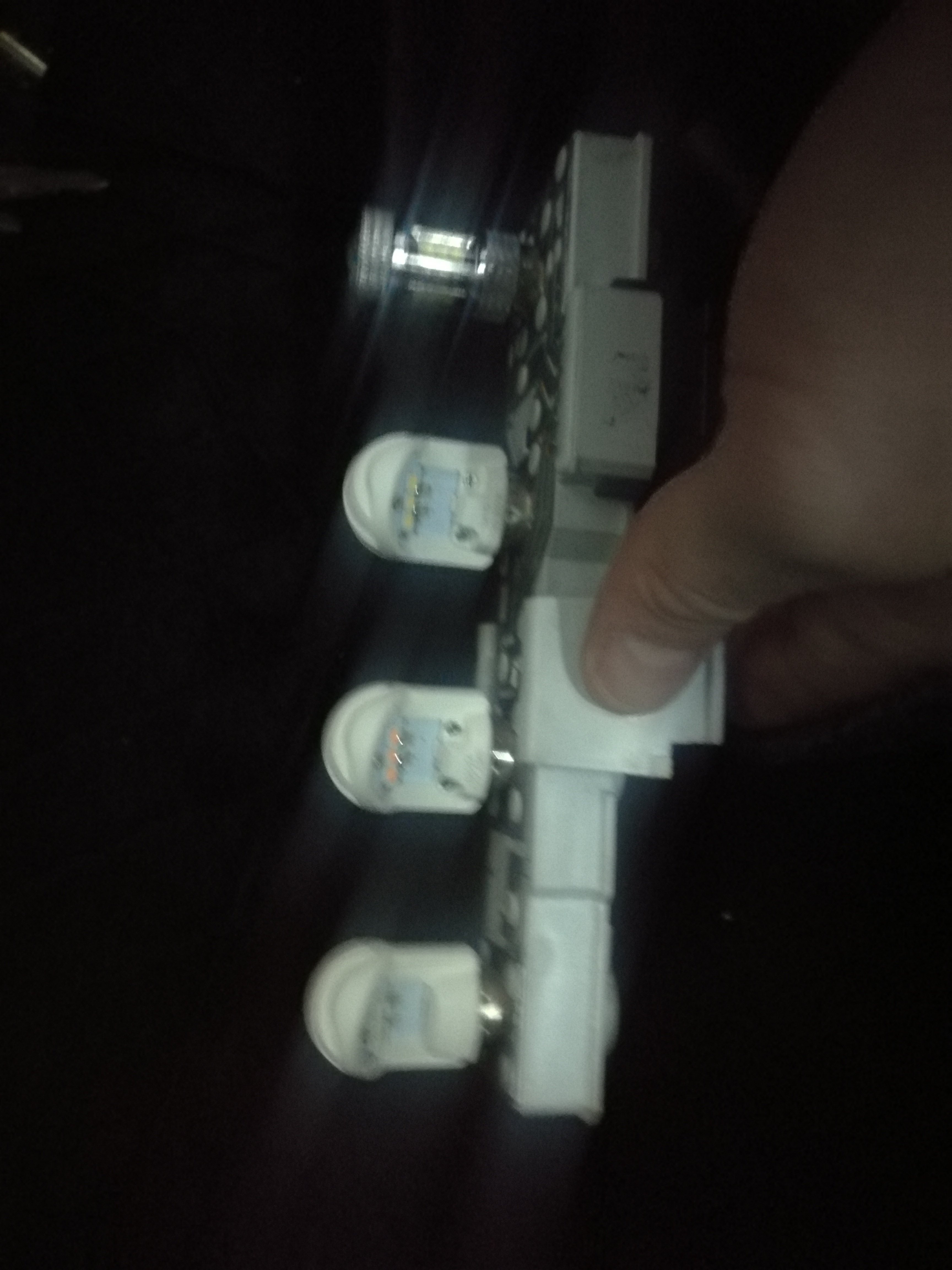

Whole set of Philips Ultinon Extreme led bulbs with one with Samsung chip

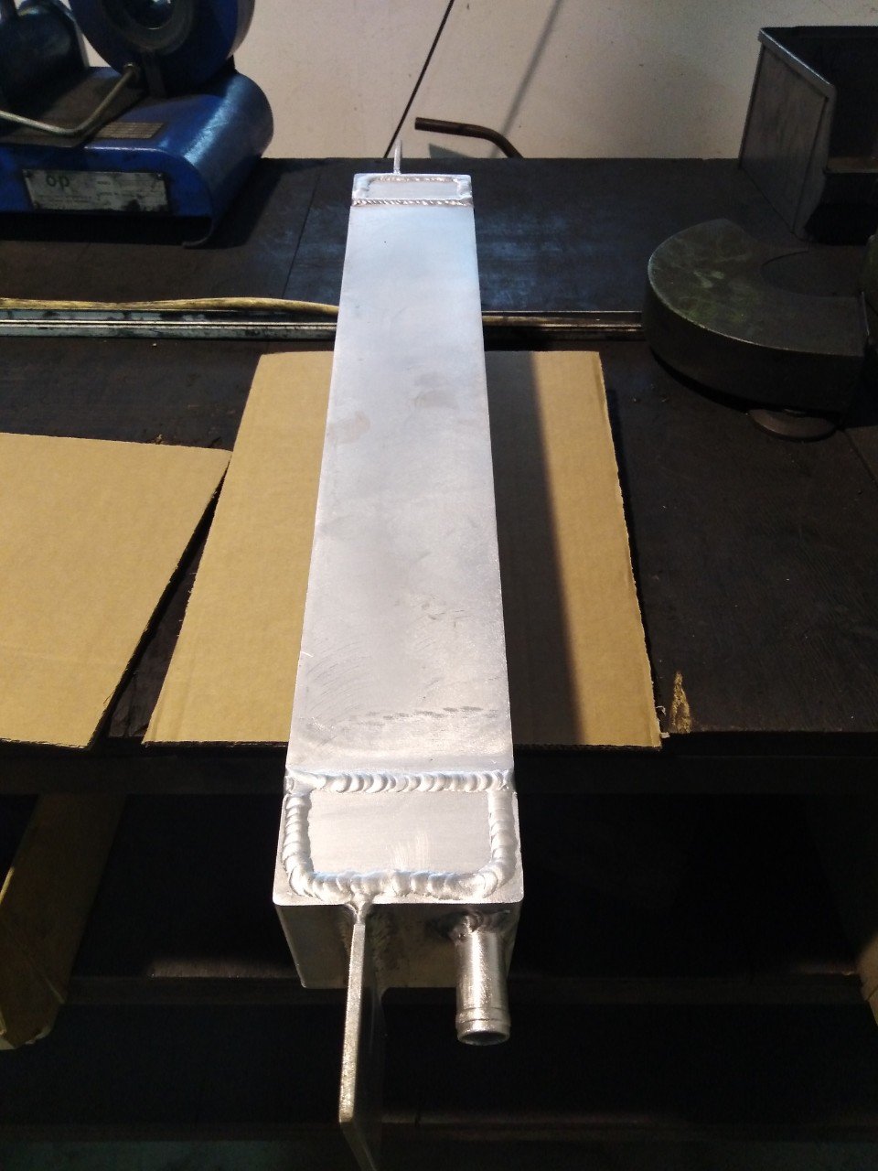

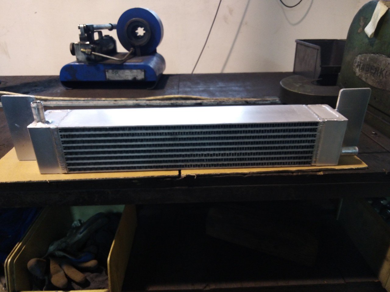

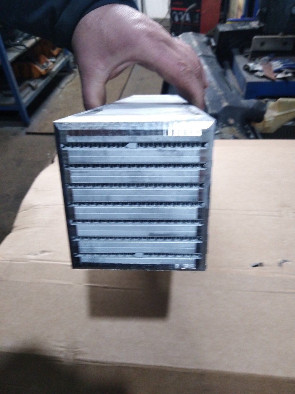

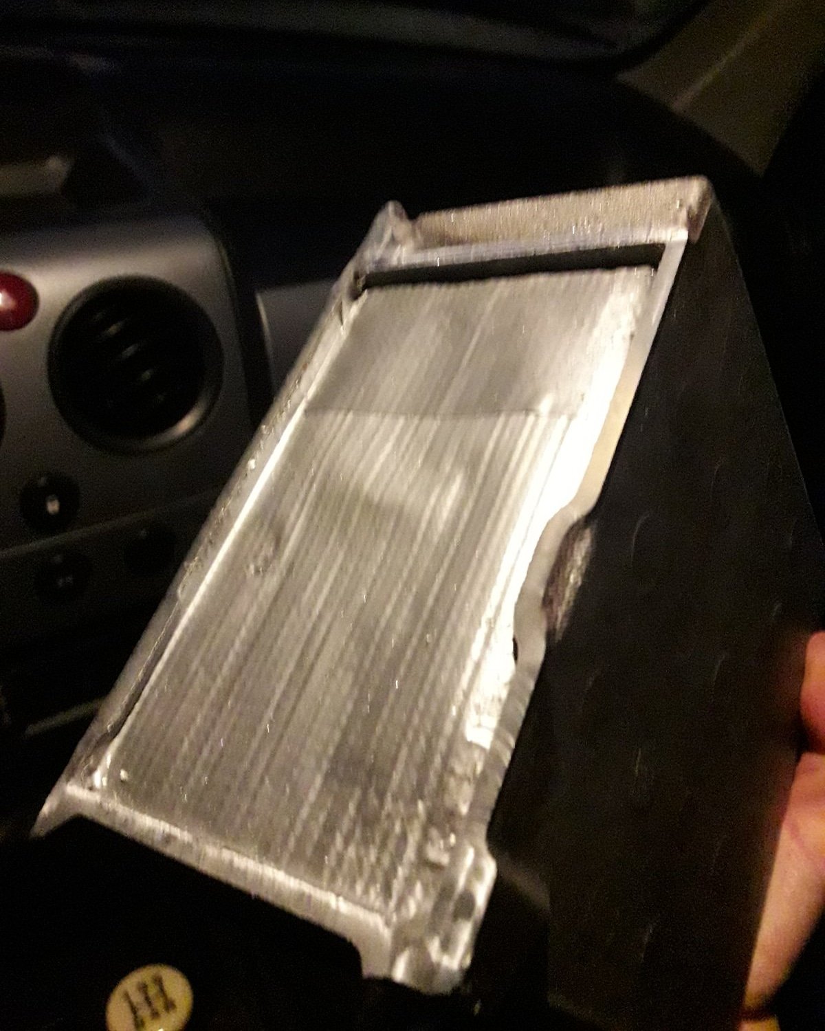

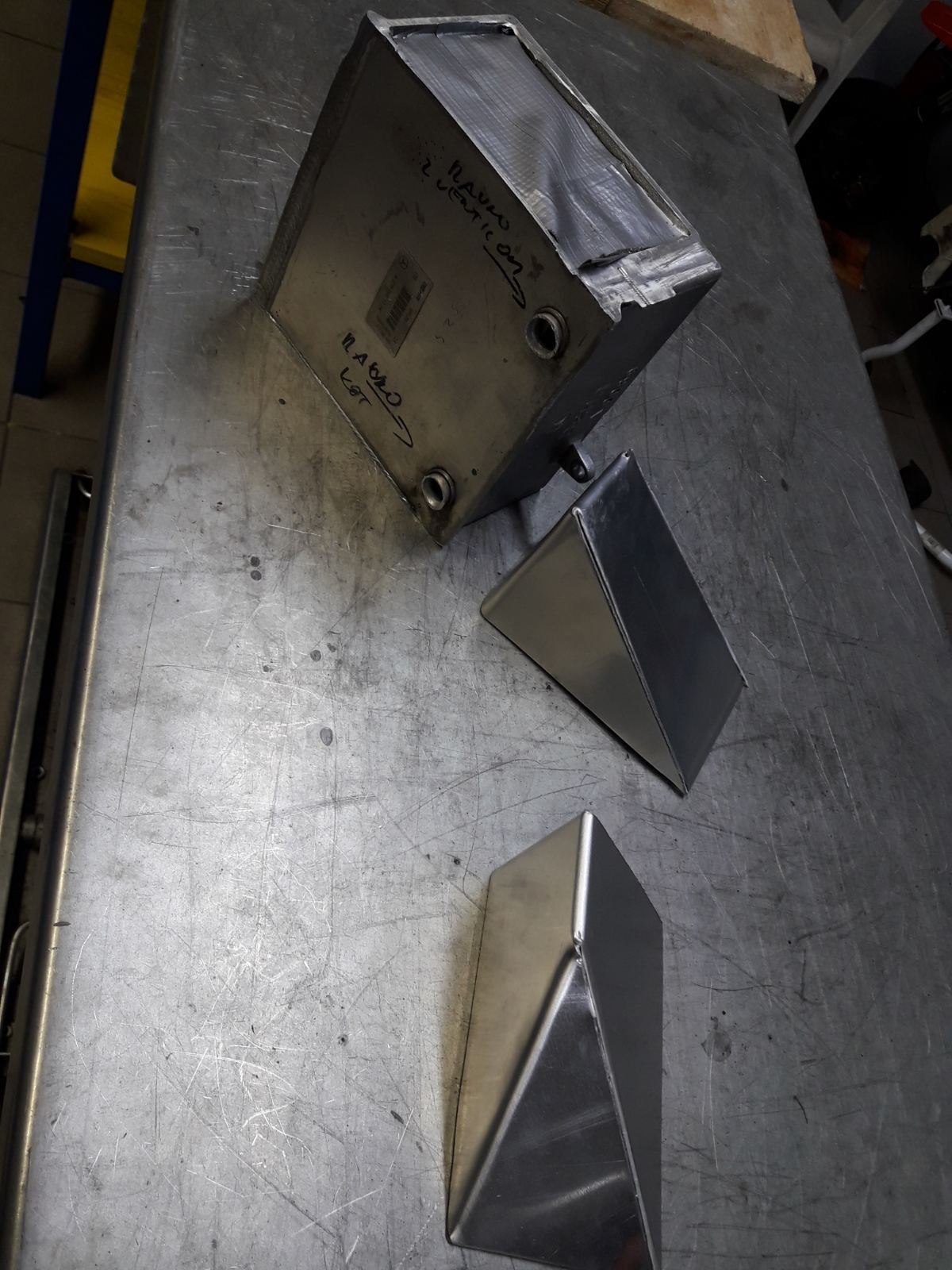

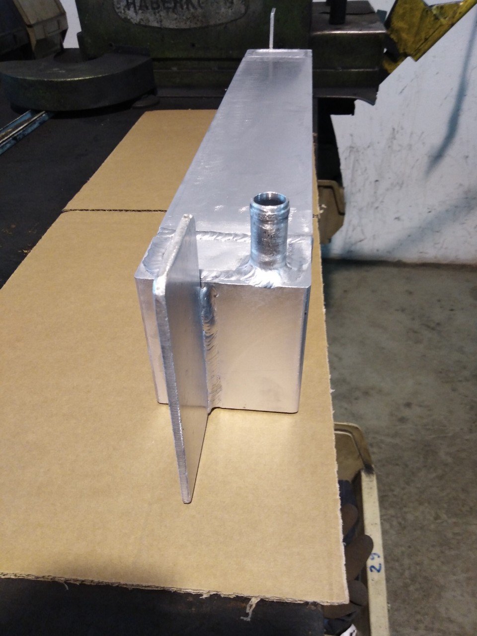

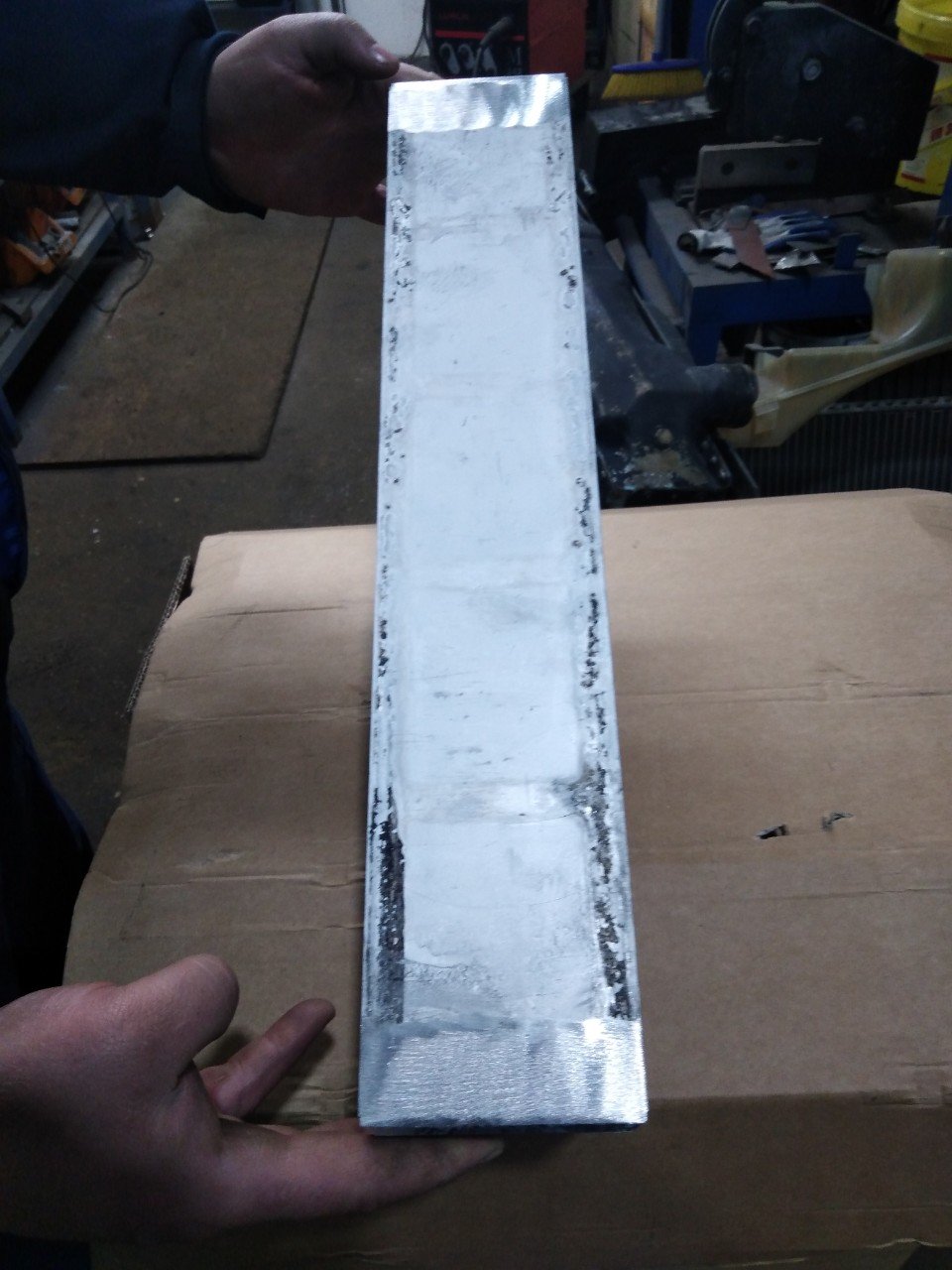

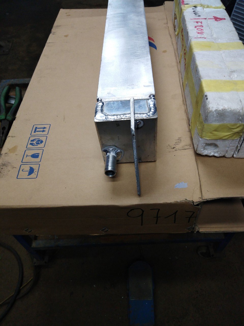

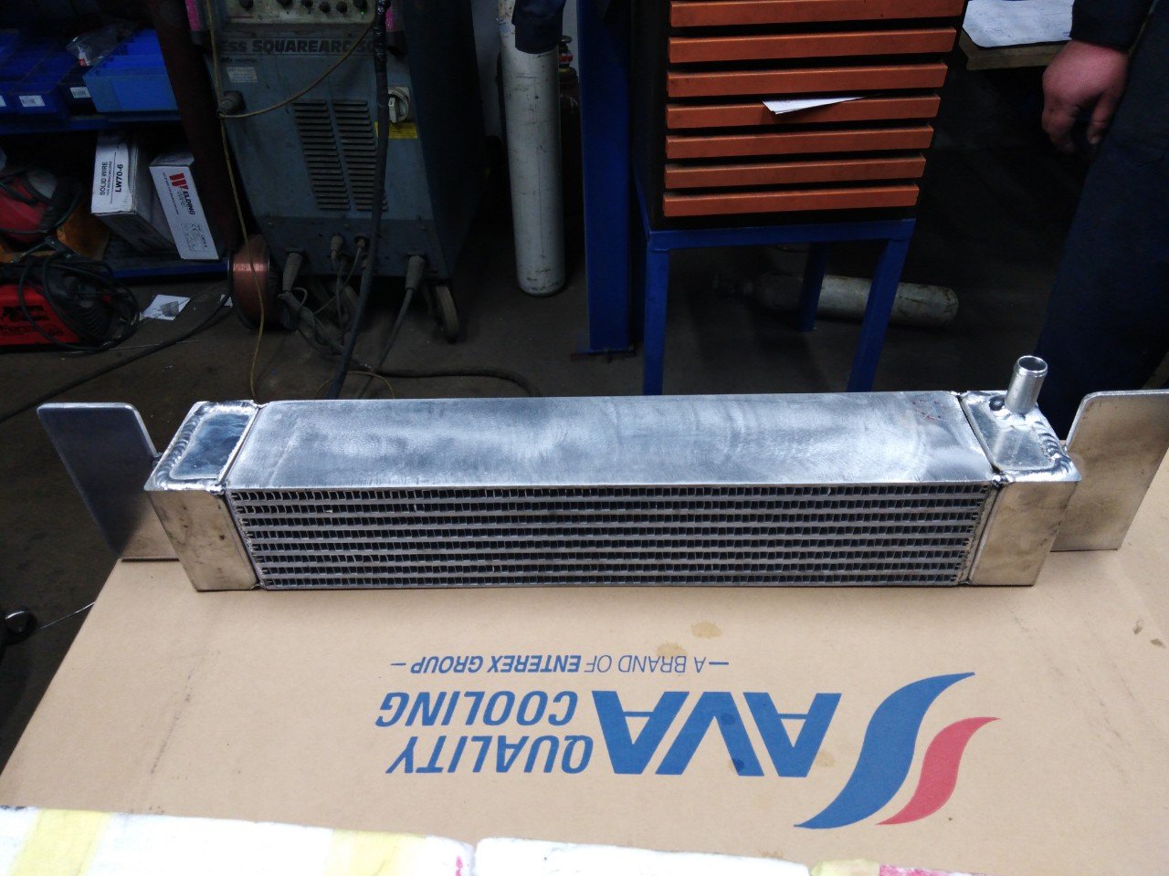

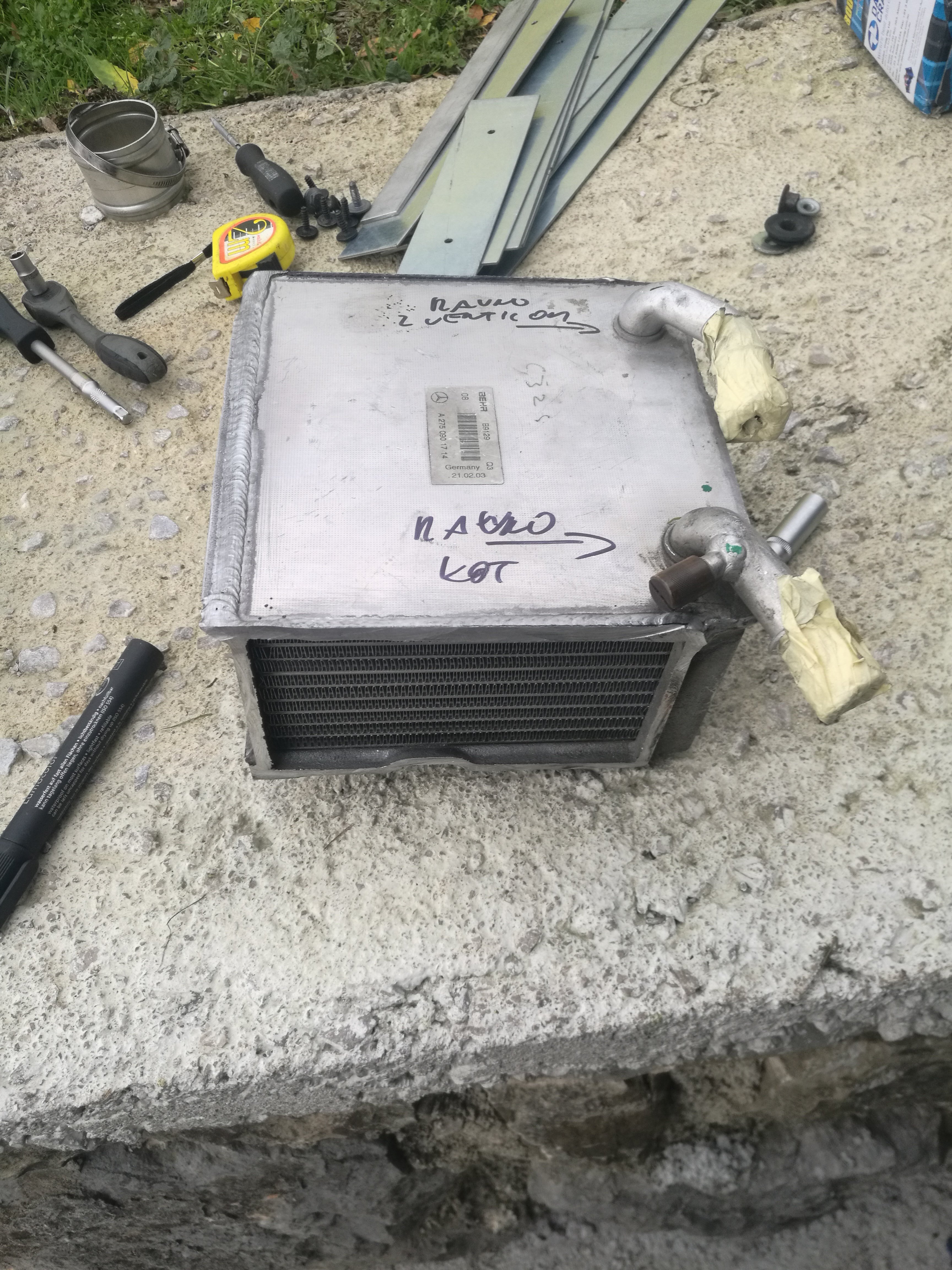

AMG WCAC without endtanks now, CNC milled to full flatness, and time for 3D drawings of endtanks to be the same as OE SMIC. Can't wait for it.

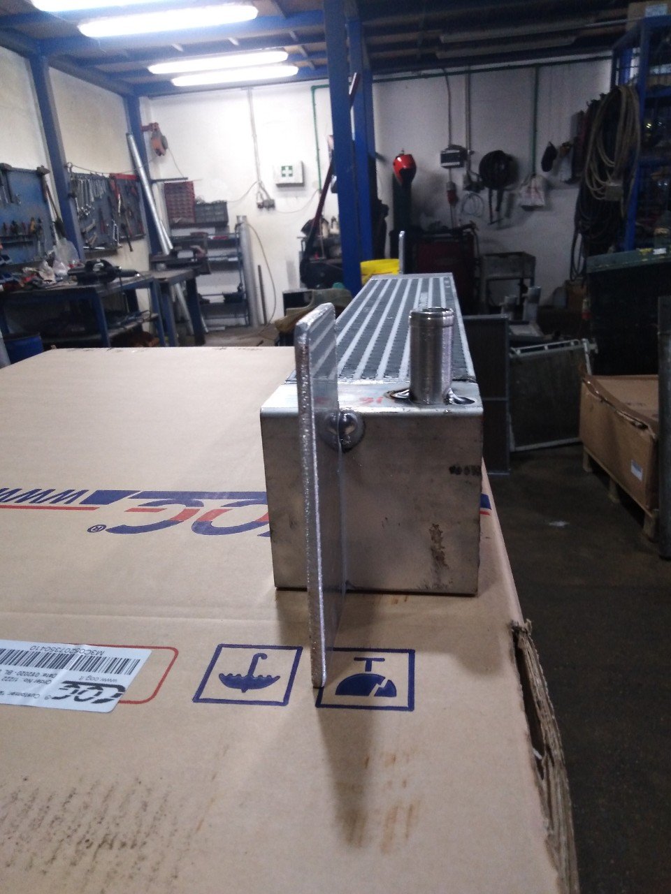

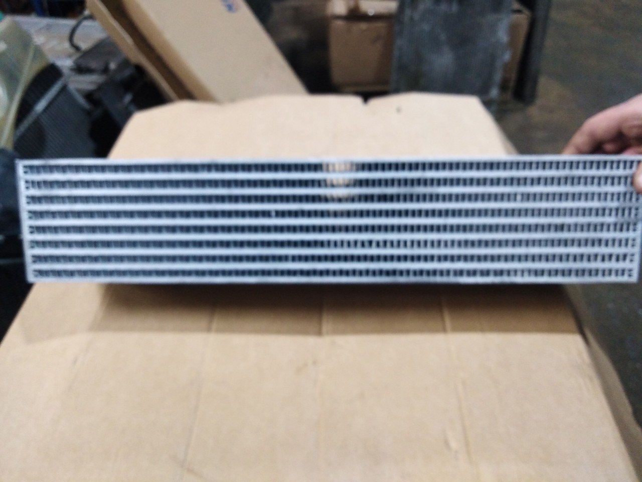

Water cooler core is in proces. 10x10cm and 60cm with endtanks.

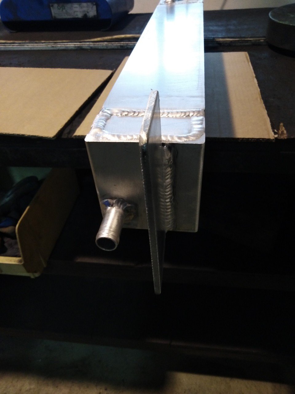

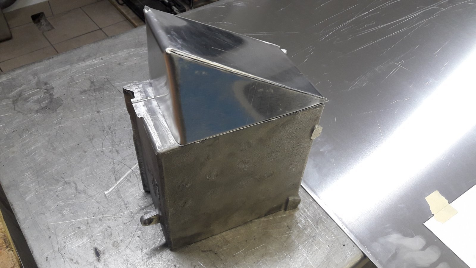

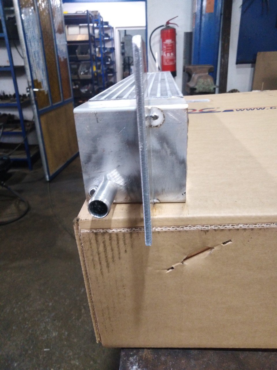

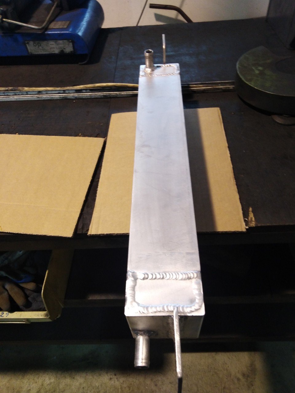

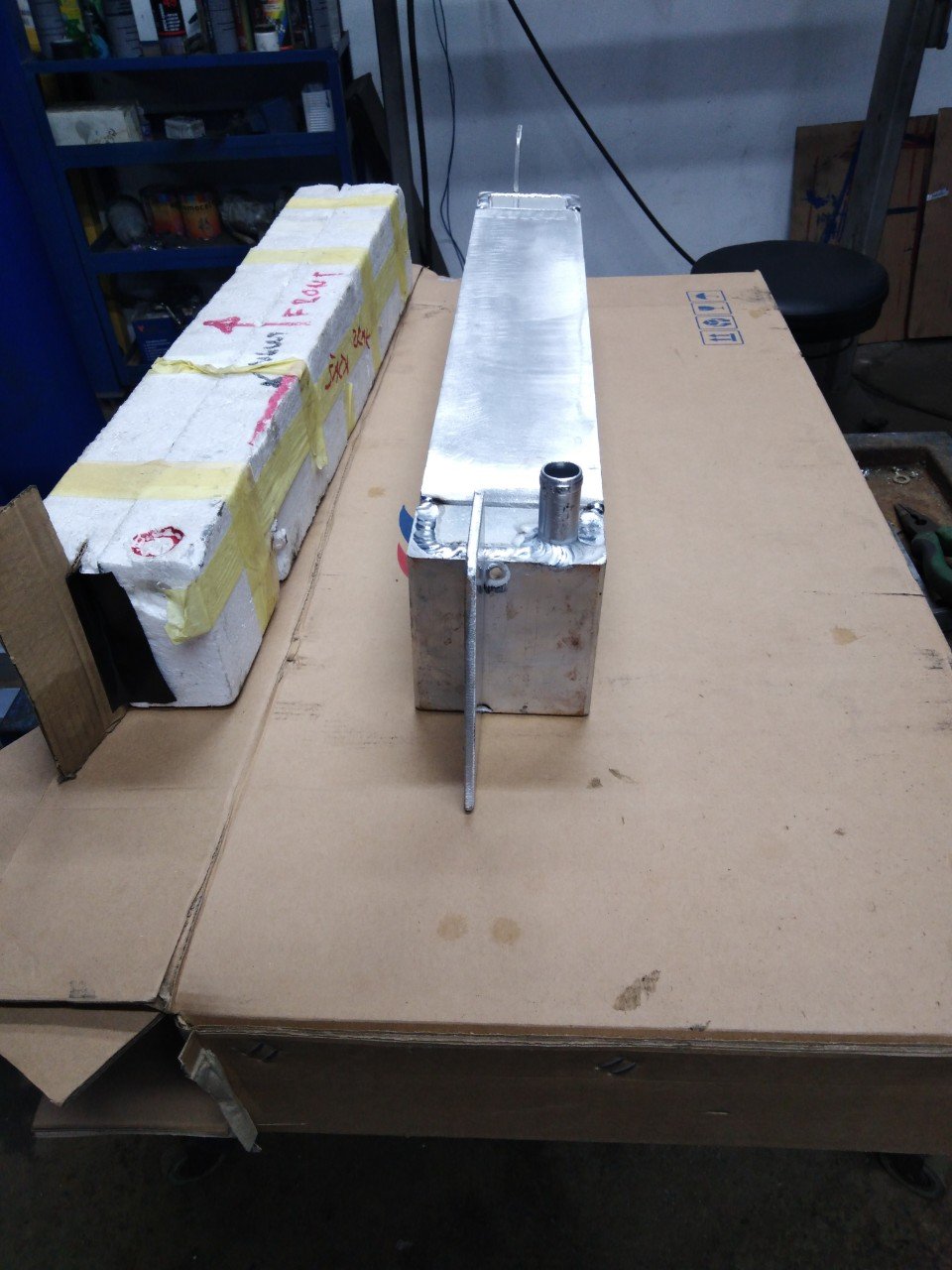

Here is some progress. Endtanks already made and still not welded. If You look carefully core is turned upward-just for checking symetry before final welding.
Edited by davojuri
And final look
And final look
