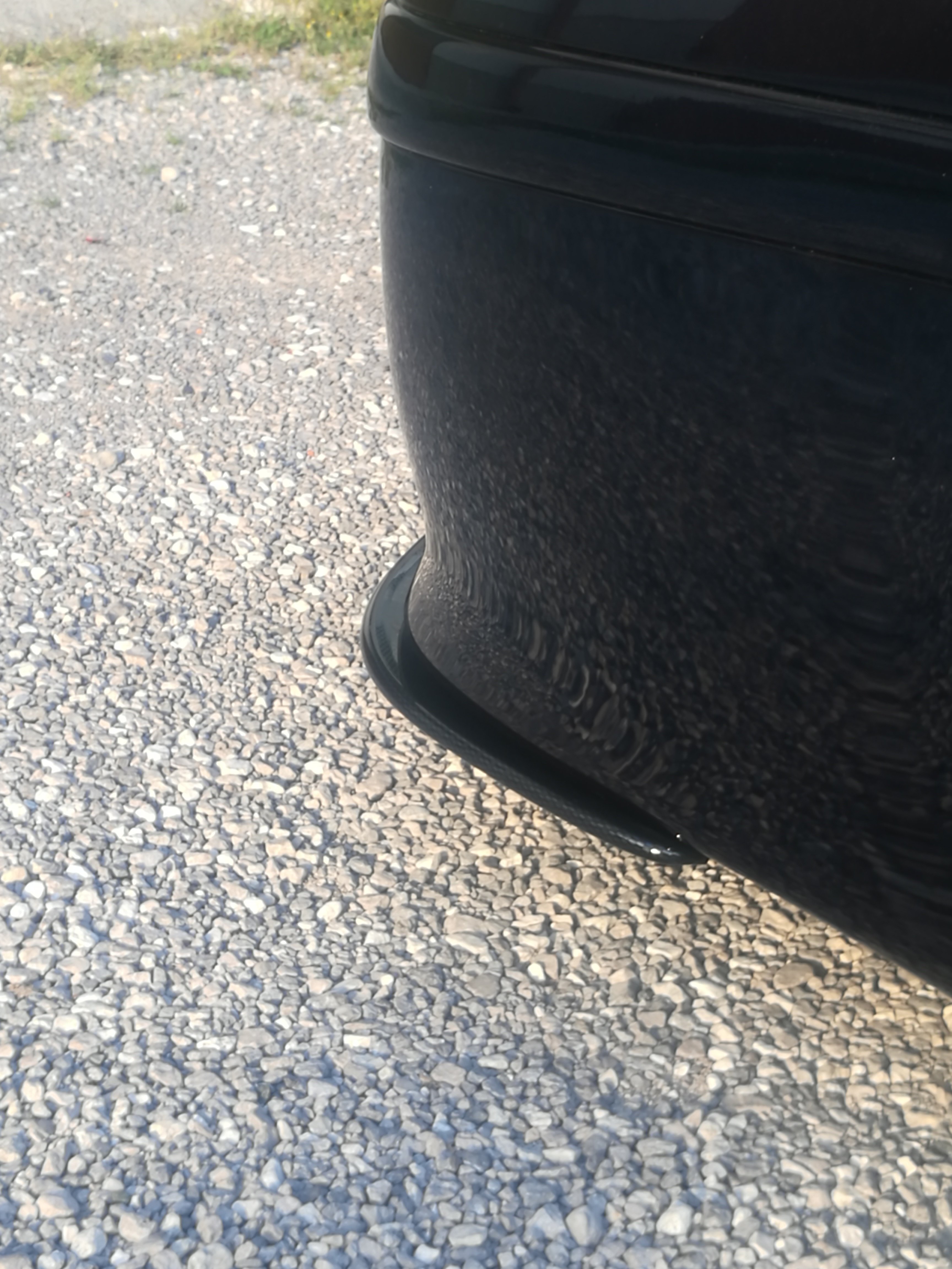

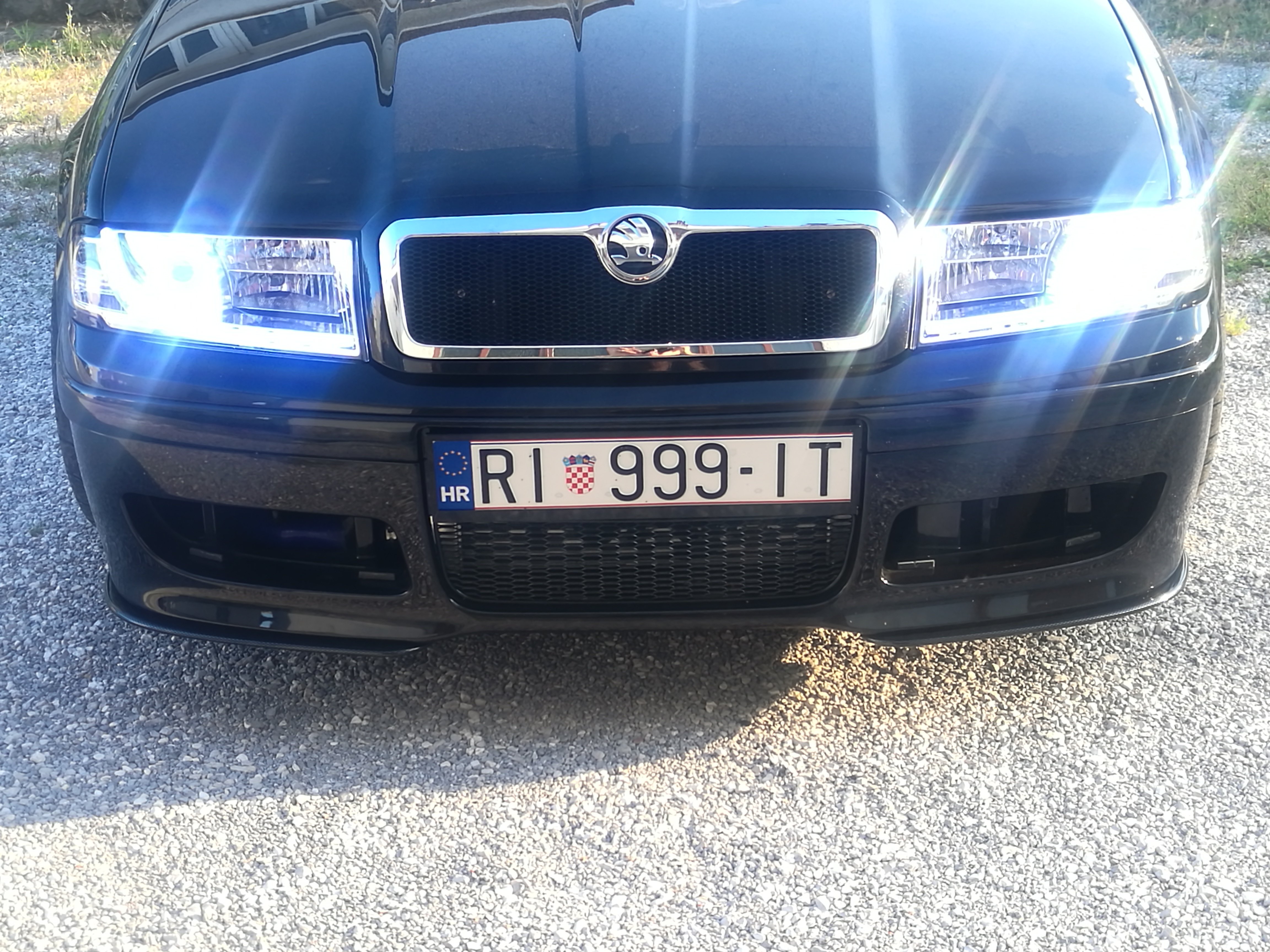

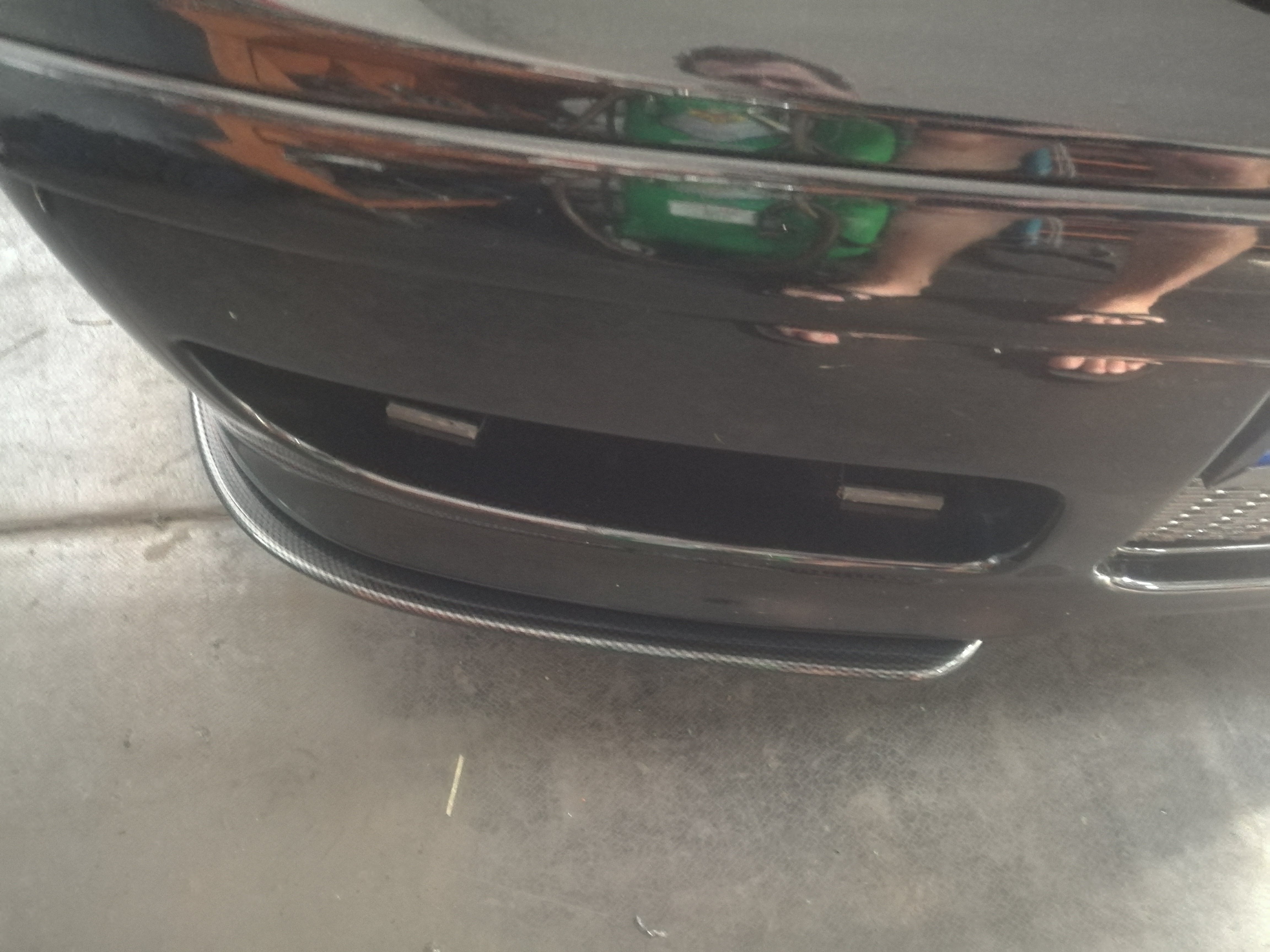

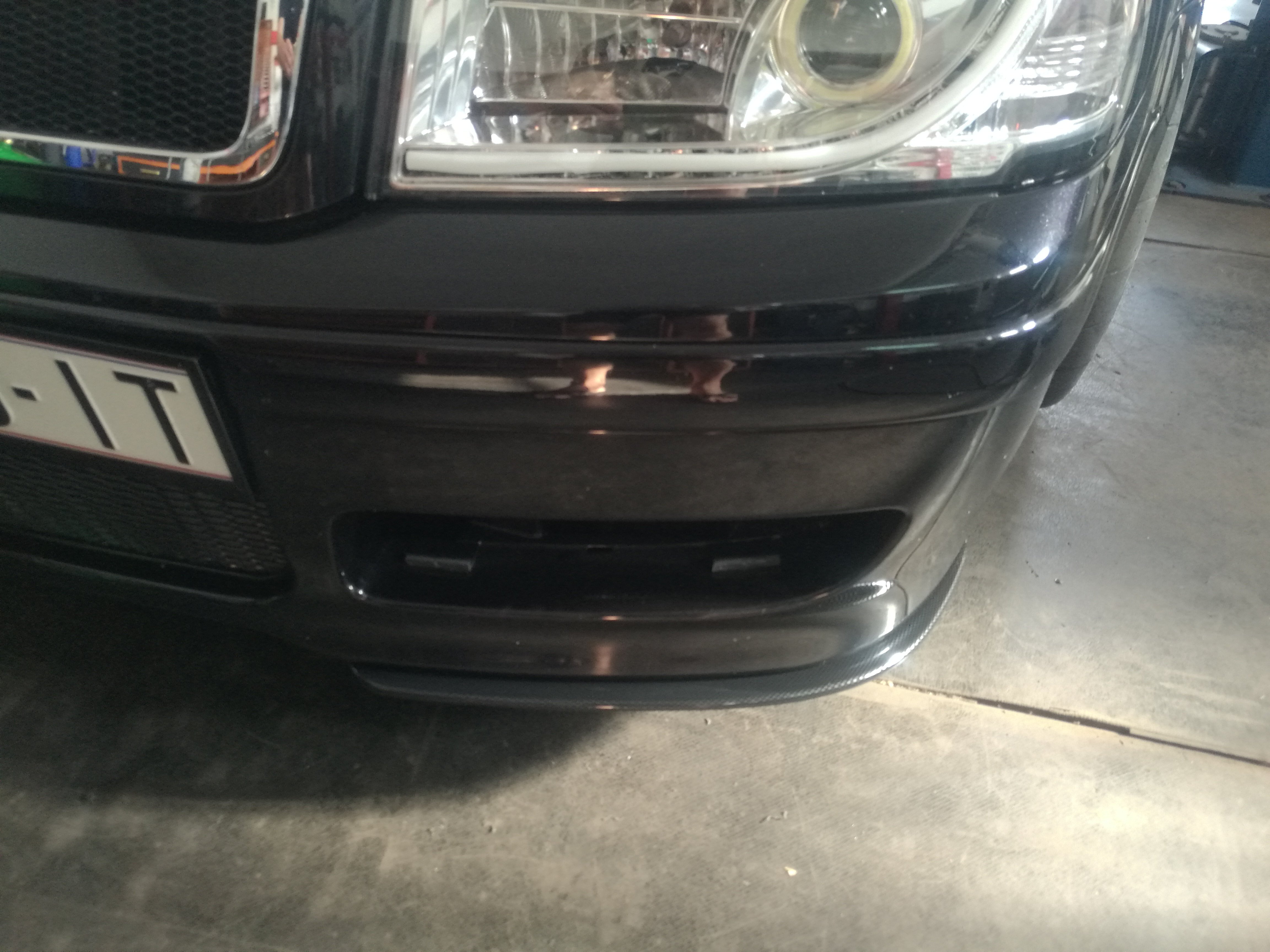

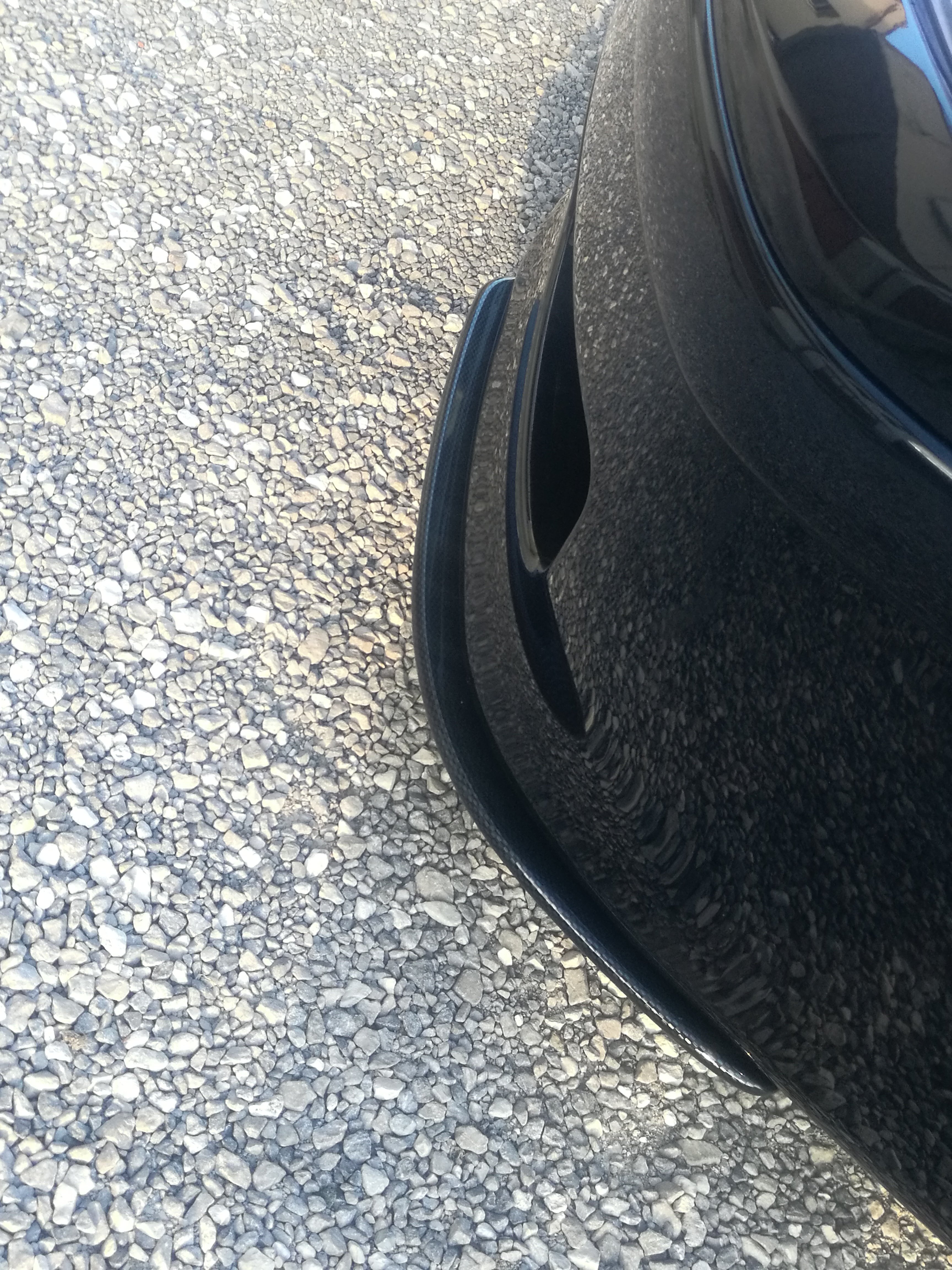

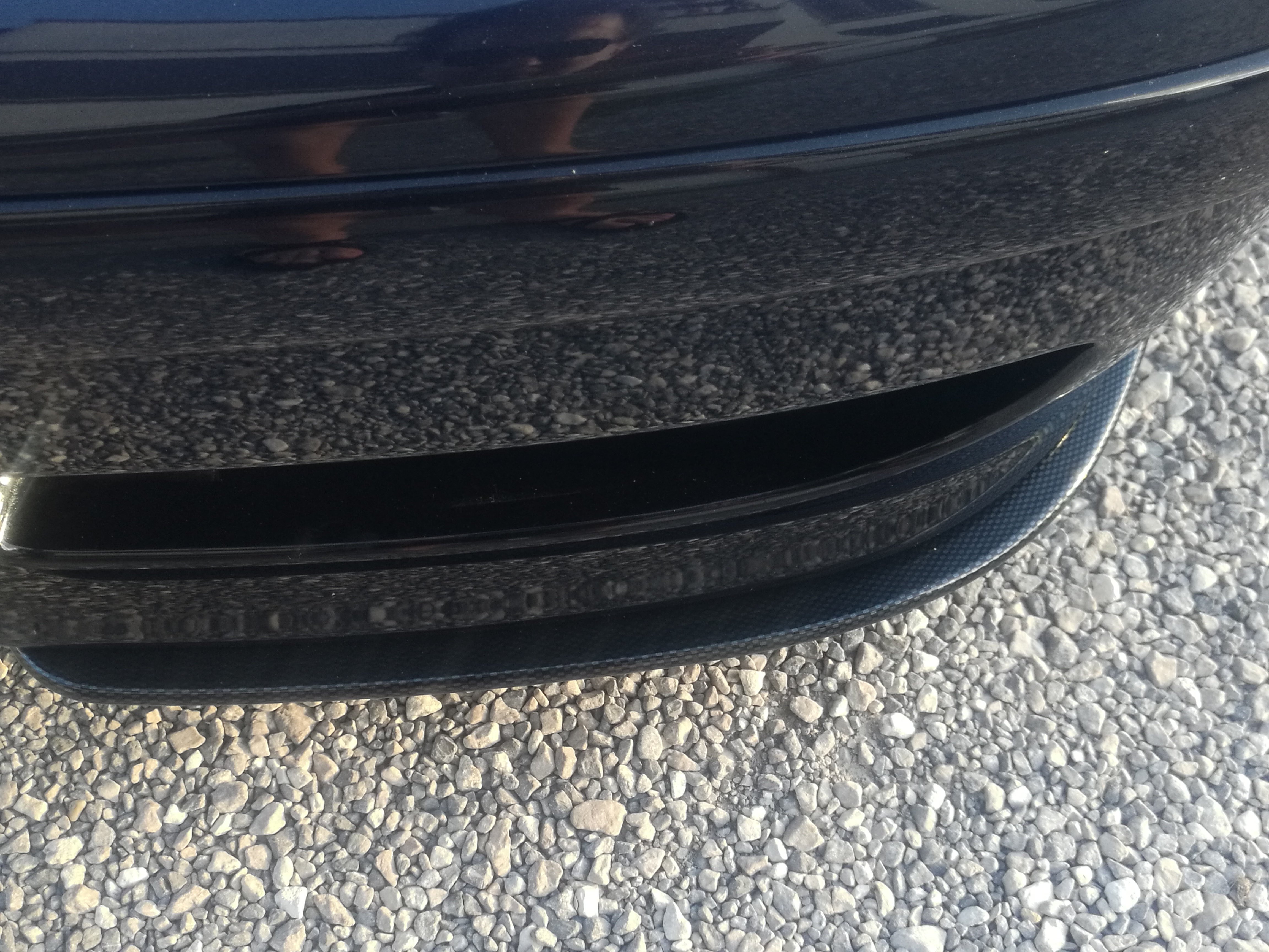

Finally found, bought and installed Milotec front splitters. Alive looks even better. 👍💪
I have these and the black ones :)
What you've said? You have 2 sets installed on the same car or what? As far as I know only these-carbon look were available
Edited by davojuri
On 19/06/2020 at 17:40, davojuri said:
What you've said? You have 2 sets installed on sćthe same car or what? As far as I know only these-carbin look were available
just one set fitted but I have a choice for when I get bored

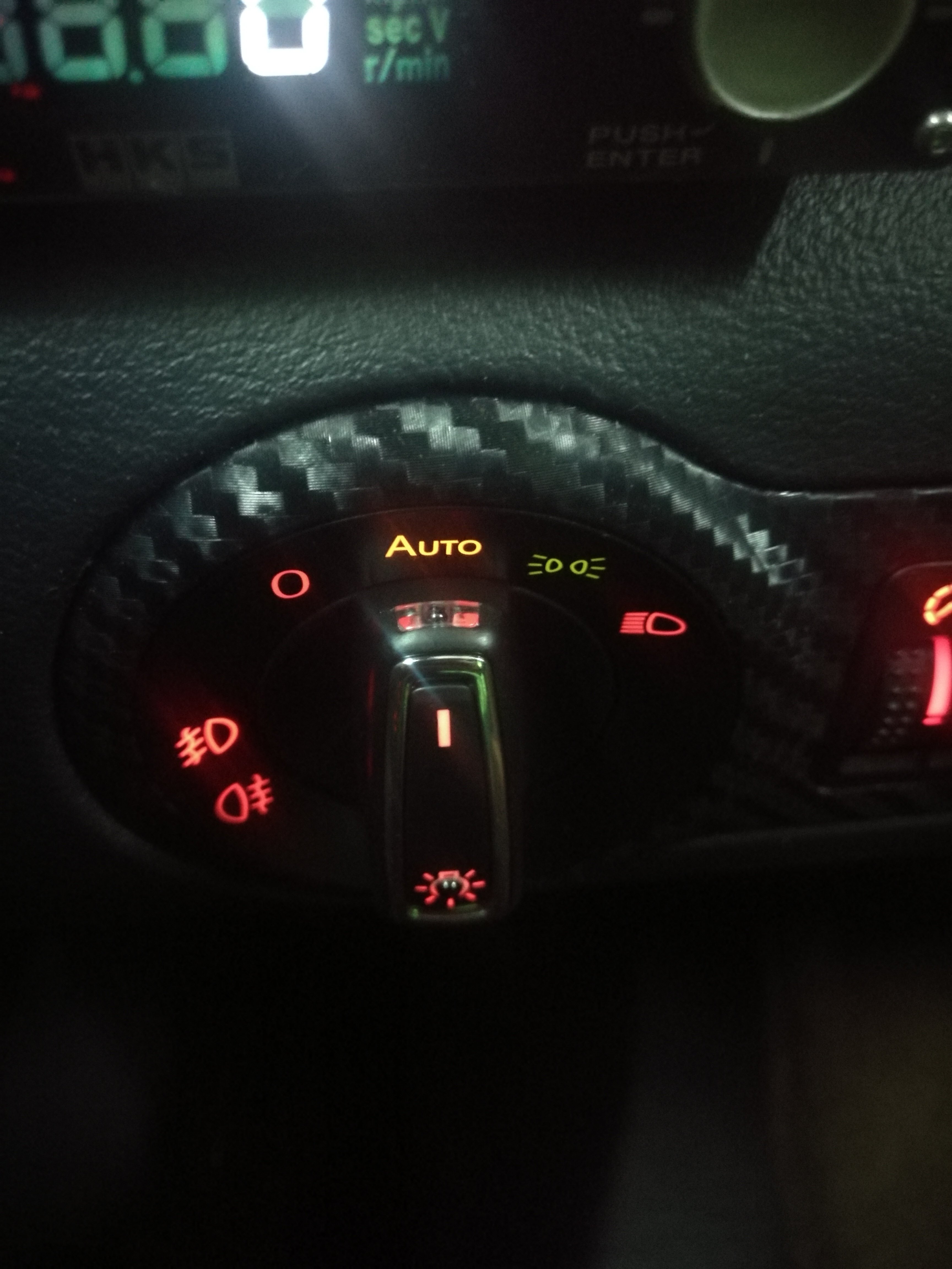

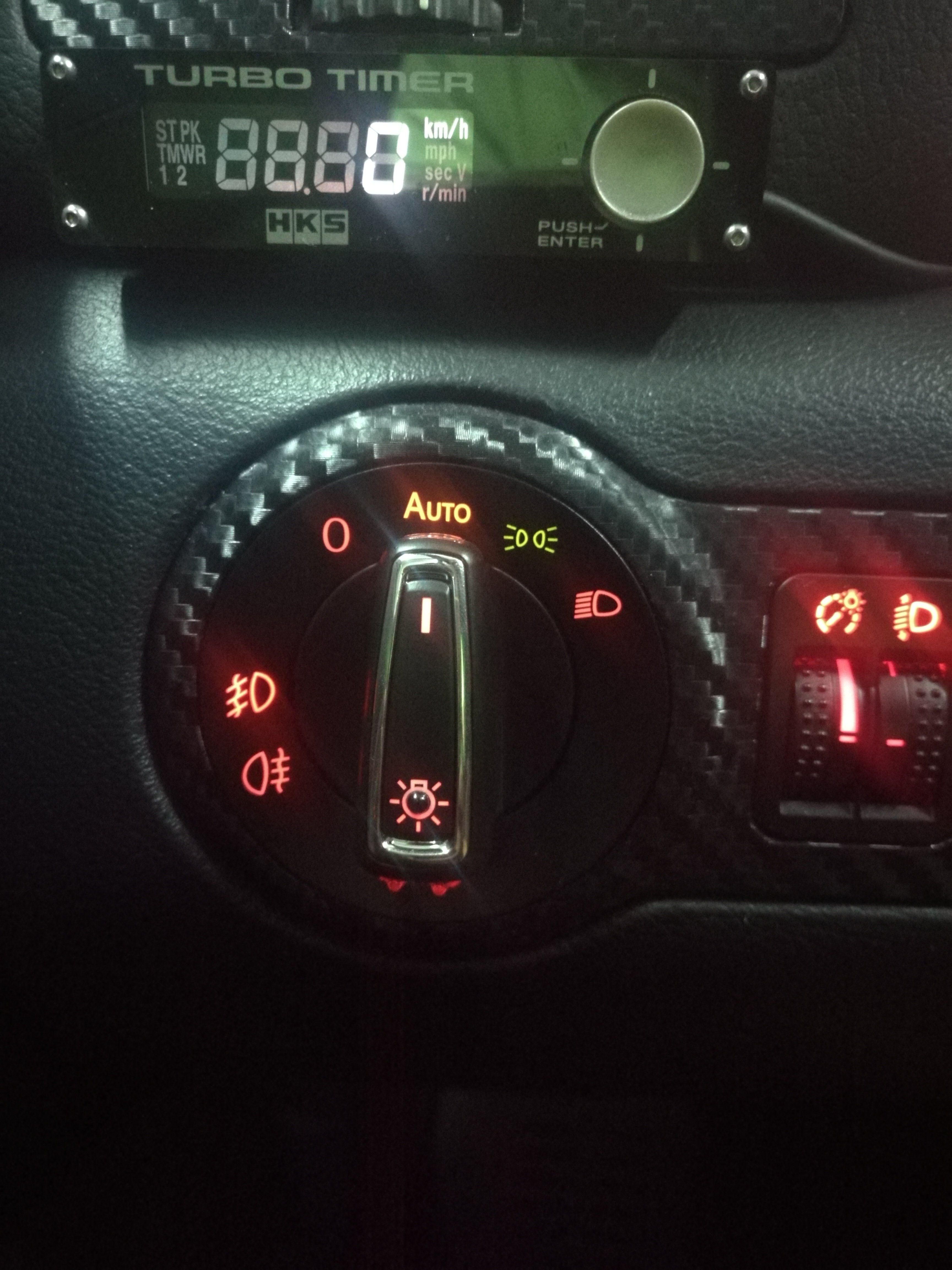

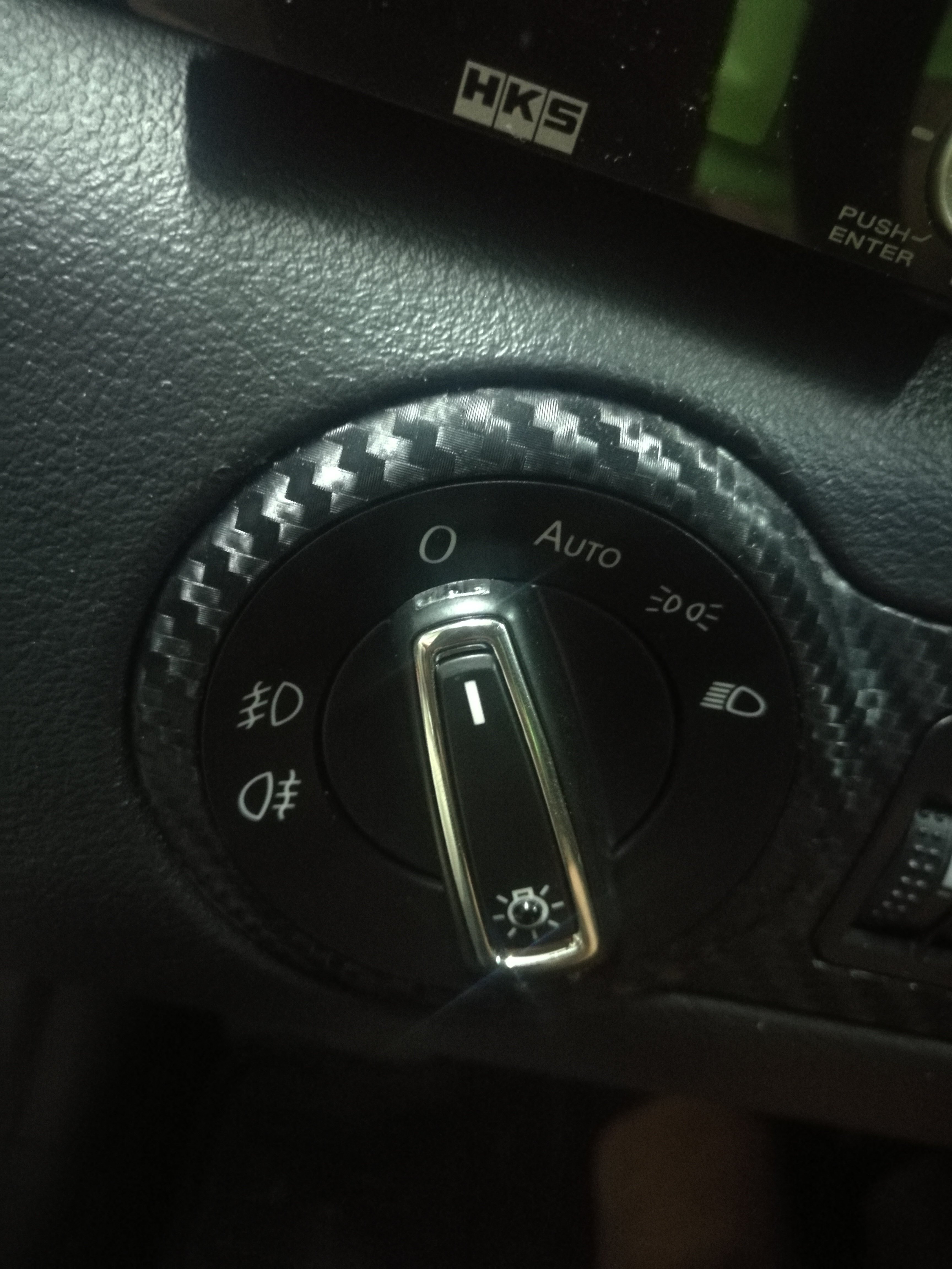

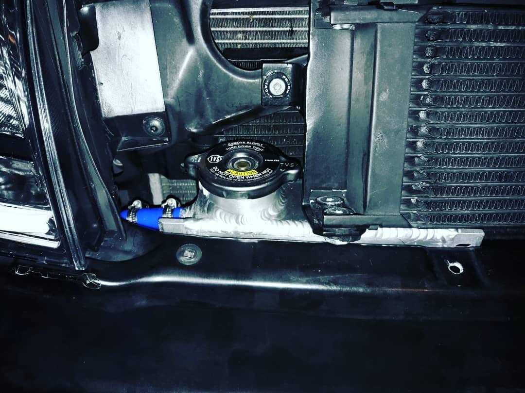

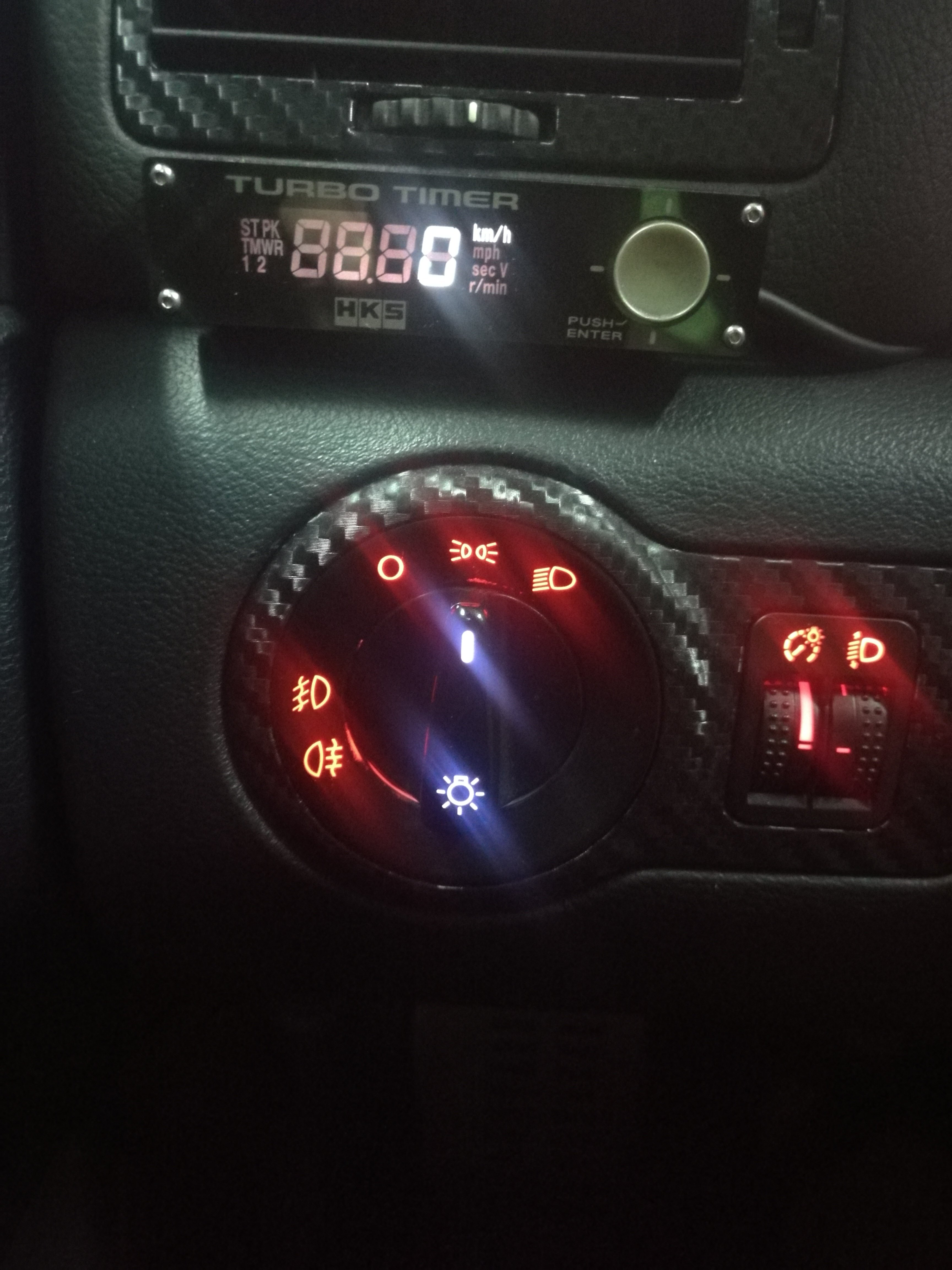

Some New stuff installed.
Light control switch with new style shiny chrome shroud and auto function light. Like it a lot
Edited by davojuri

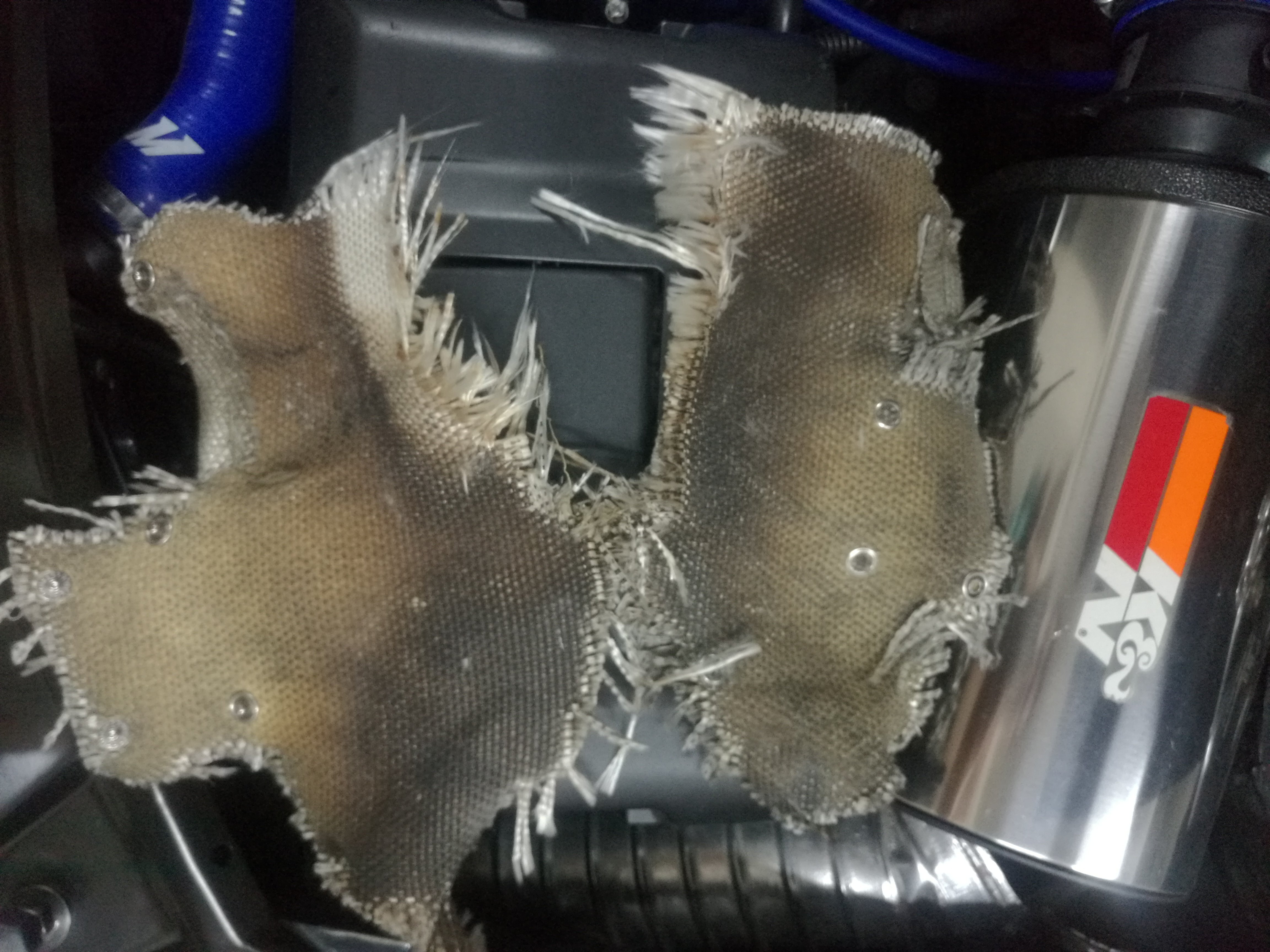

Old stuff out
New stuff in
That suits the engine bay better. :thumbup:
I completely agree. Shame on me

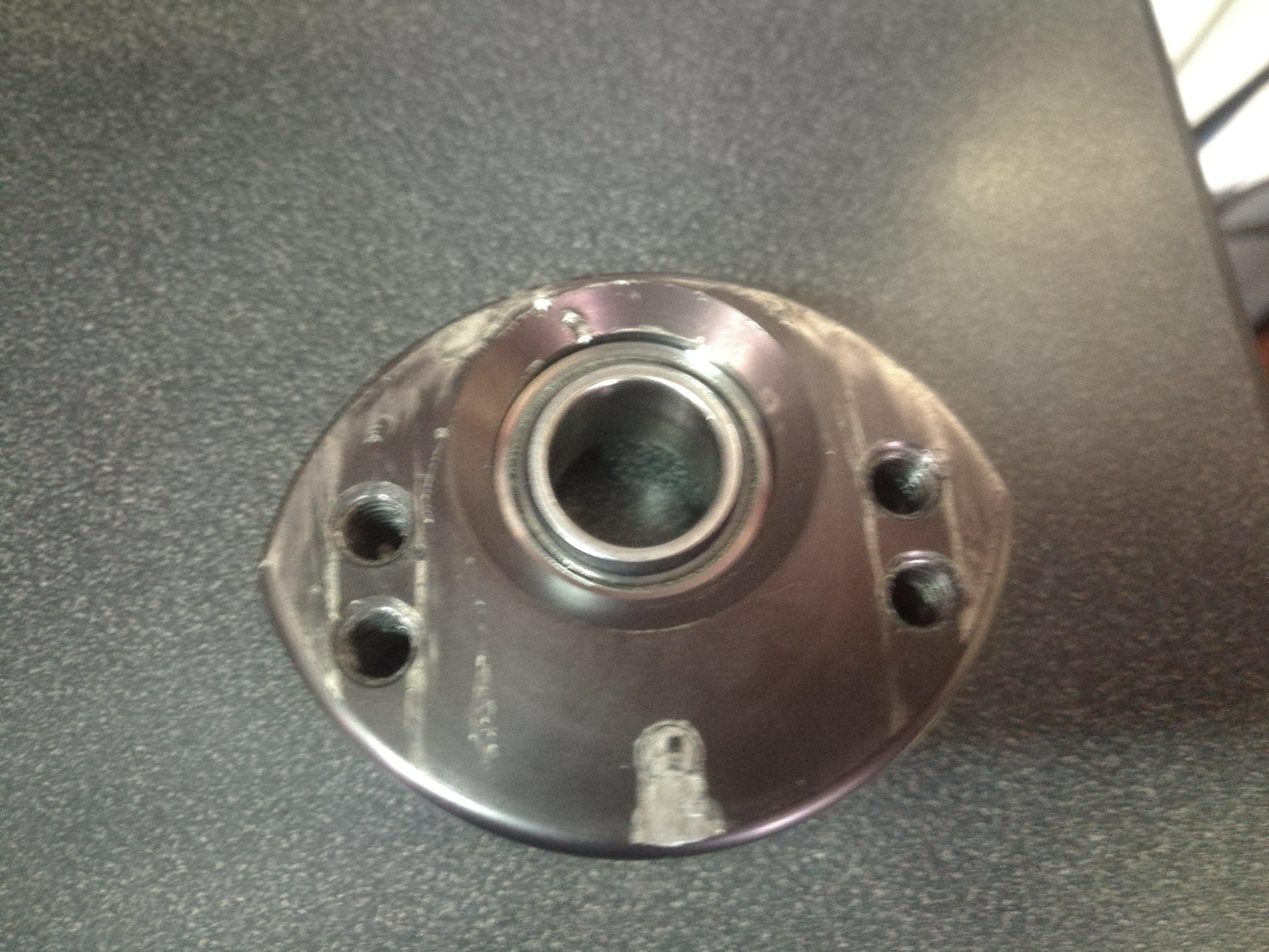

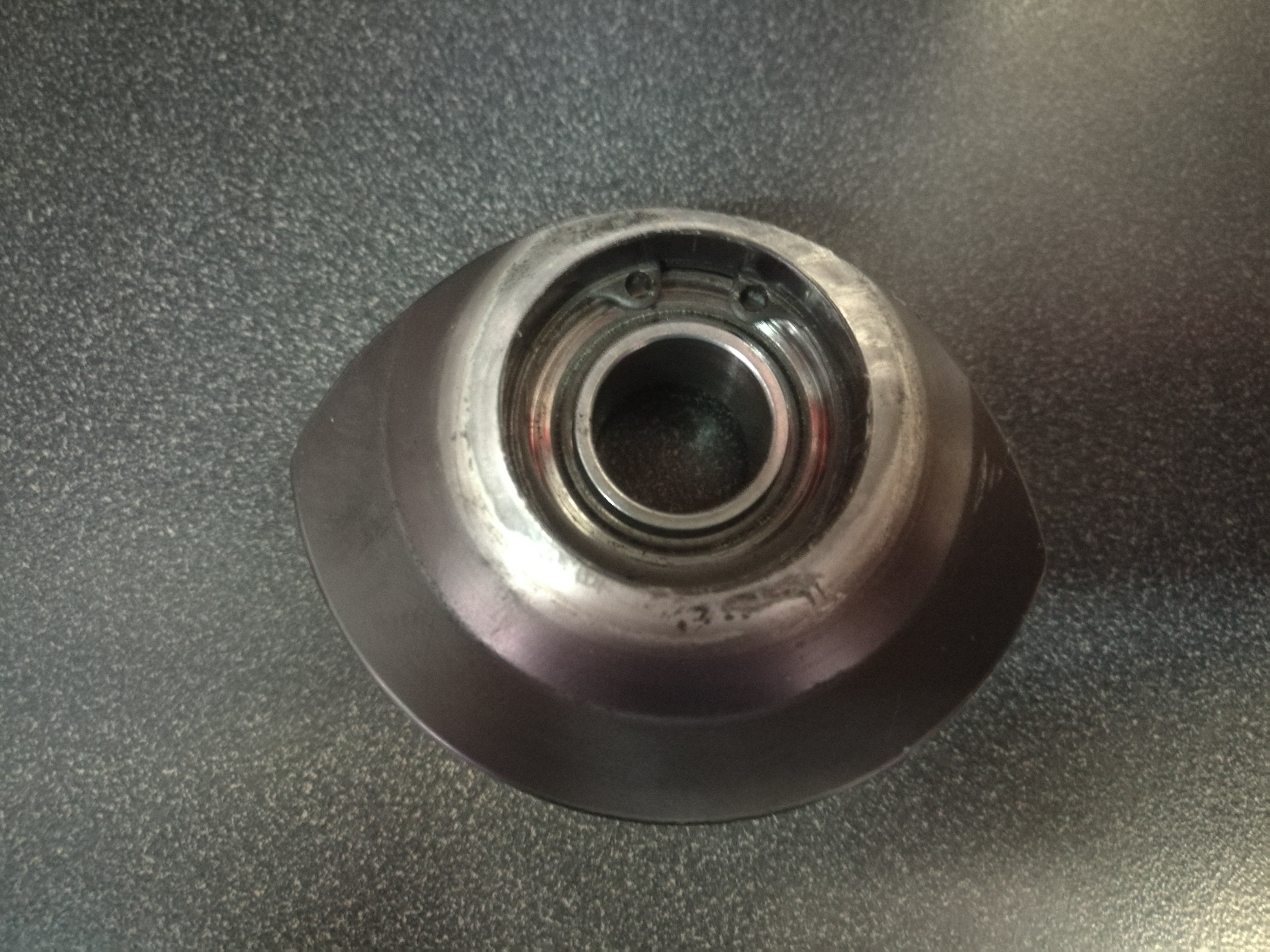

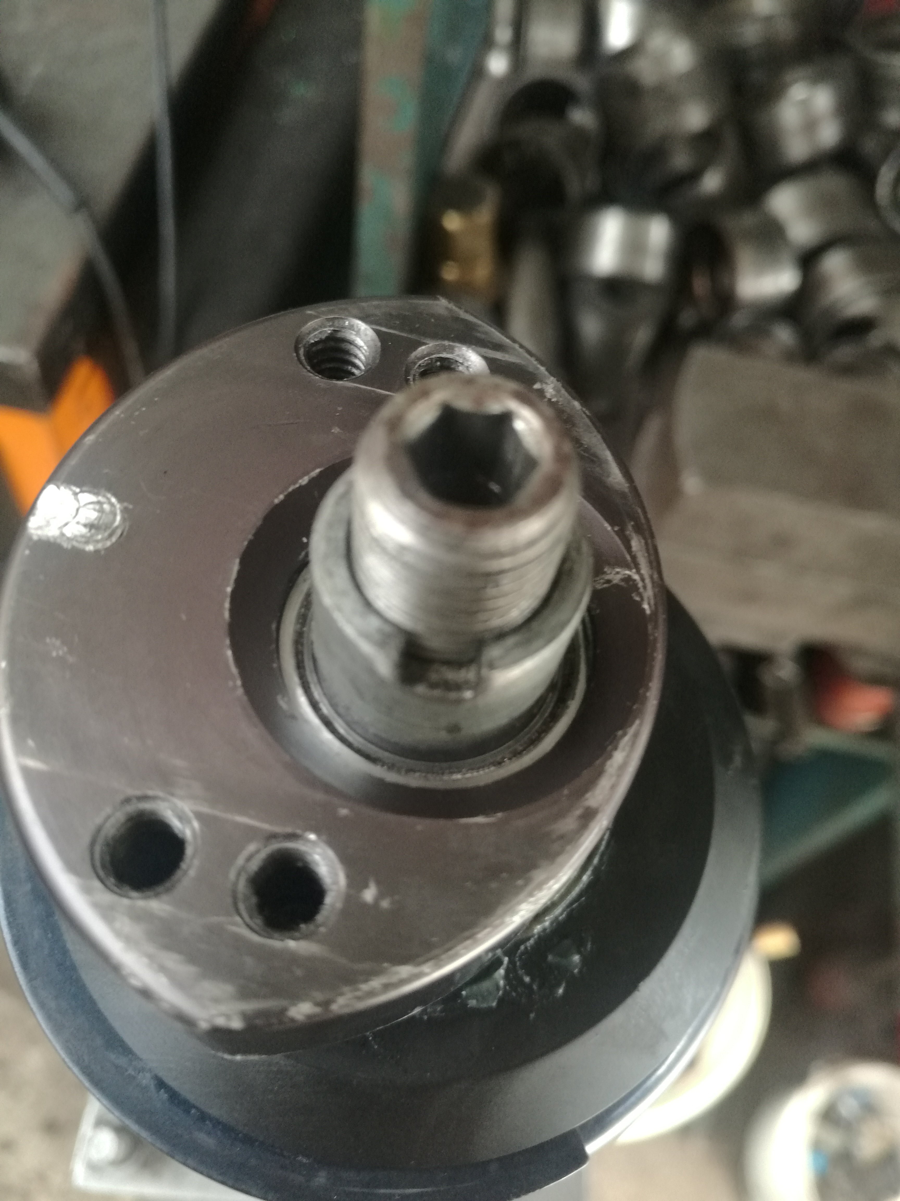

Just installed new Aurora spherical bearings in Ground Control camber plates
fancy B)
Drives like go cart🙂
Edited by davojuri

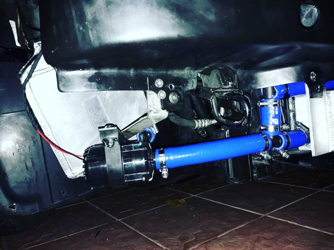

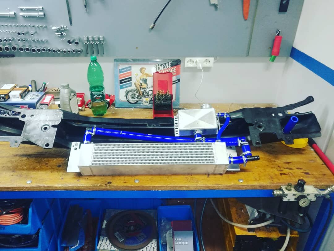

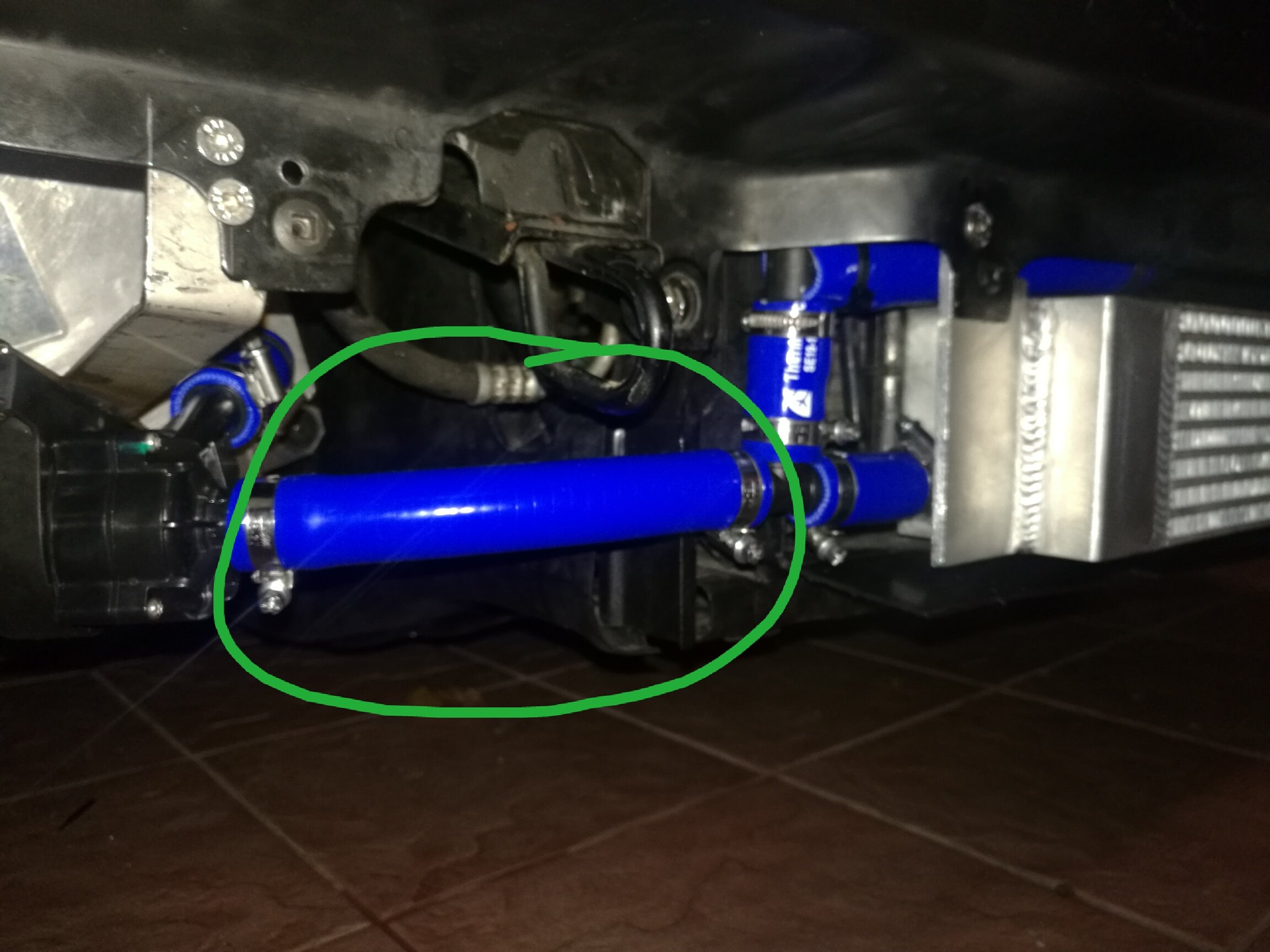

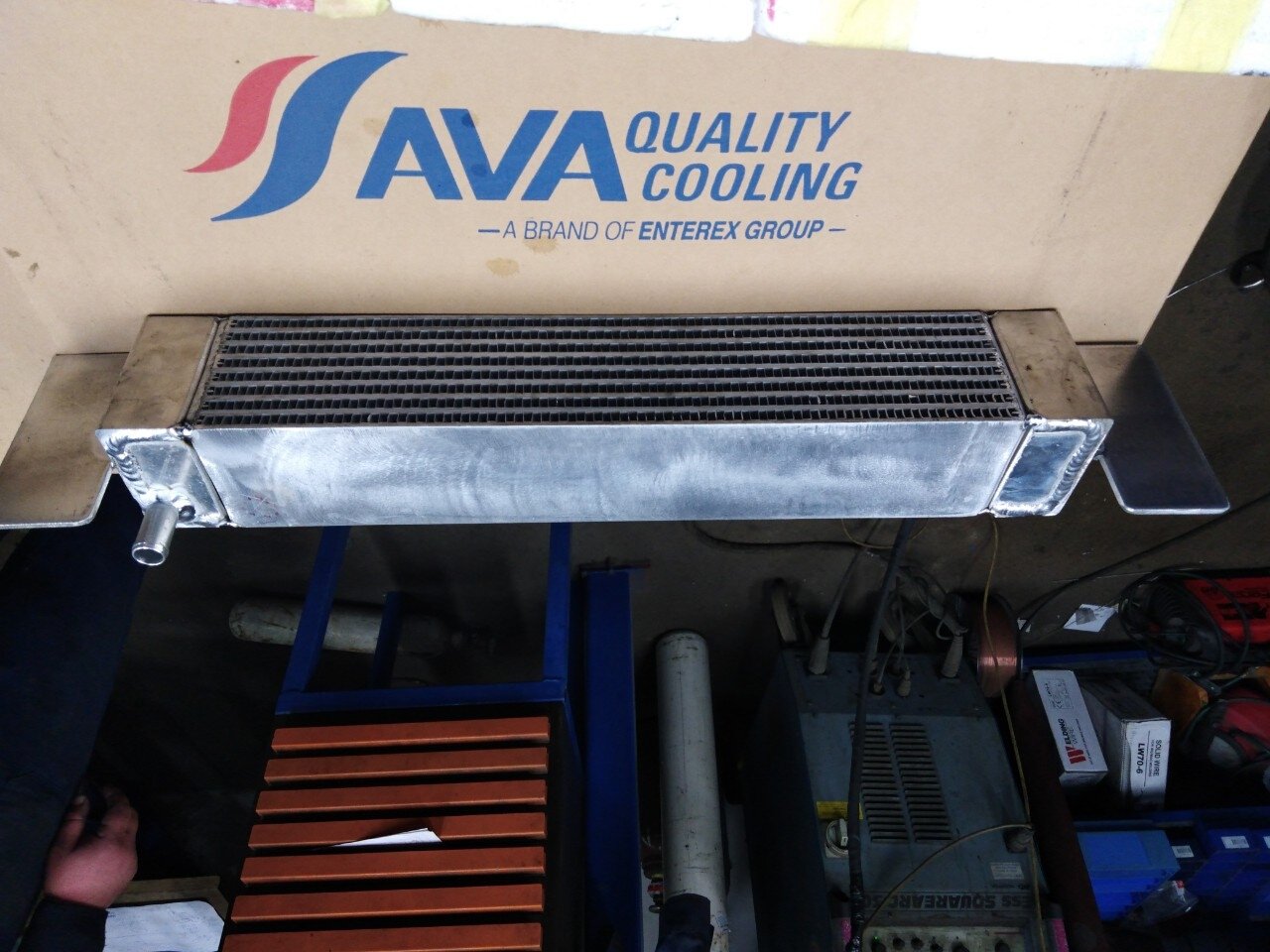

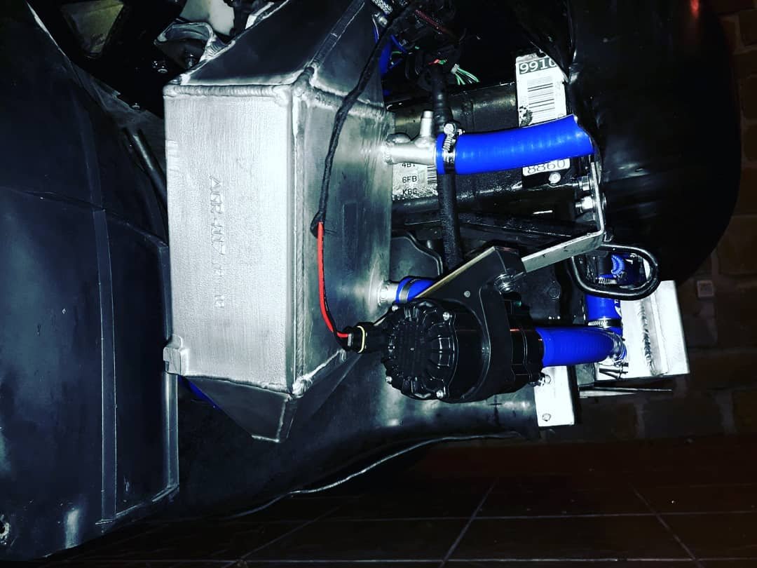

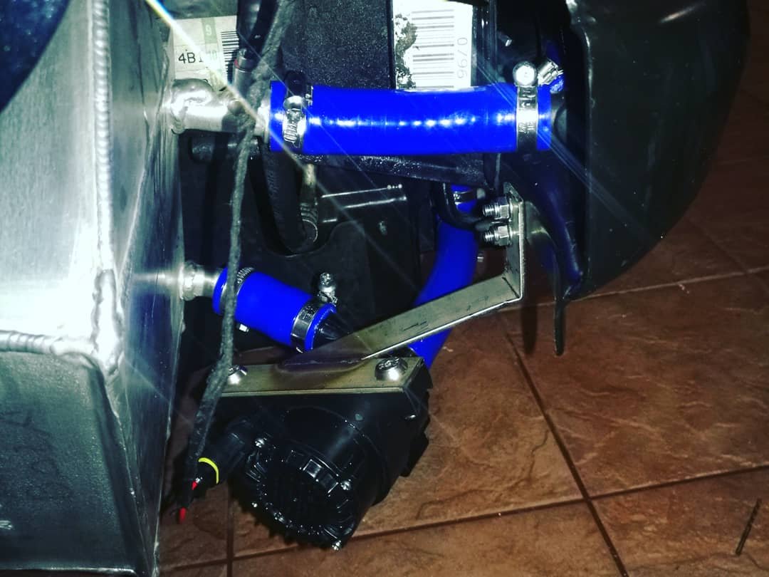

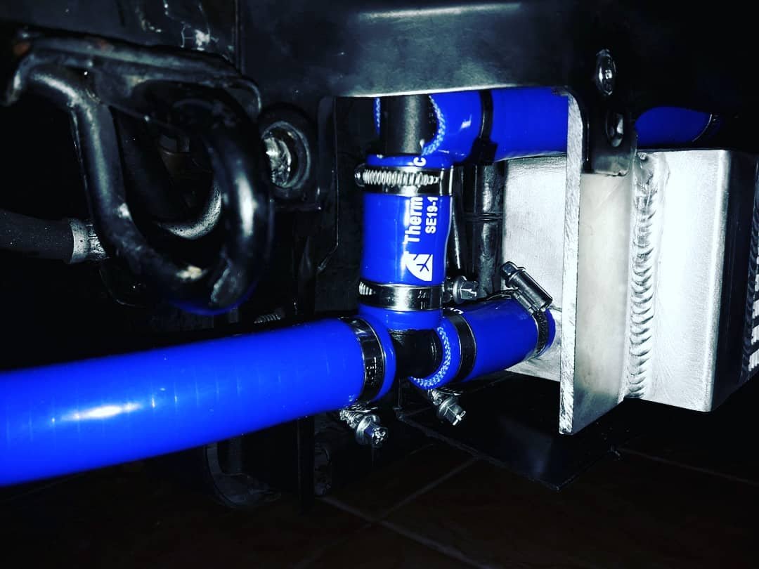

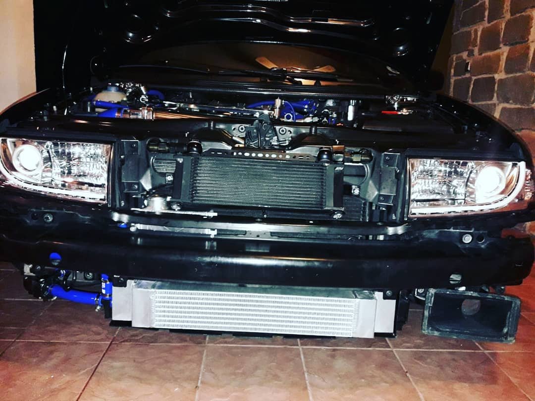

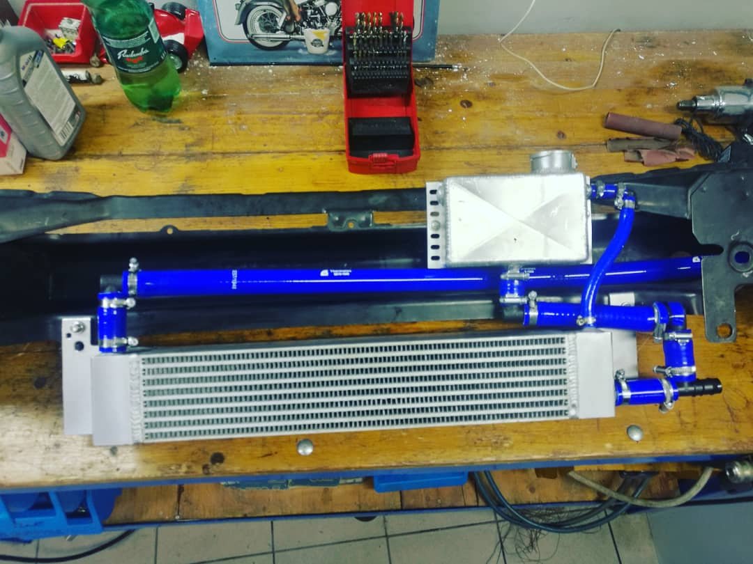

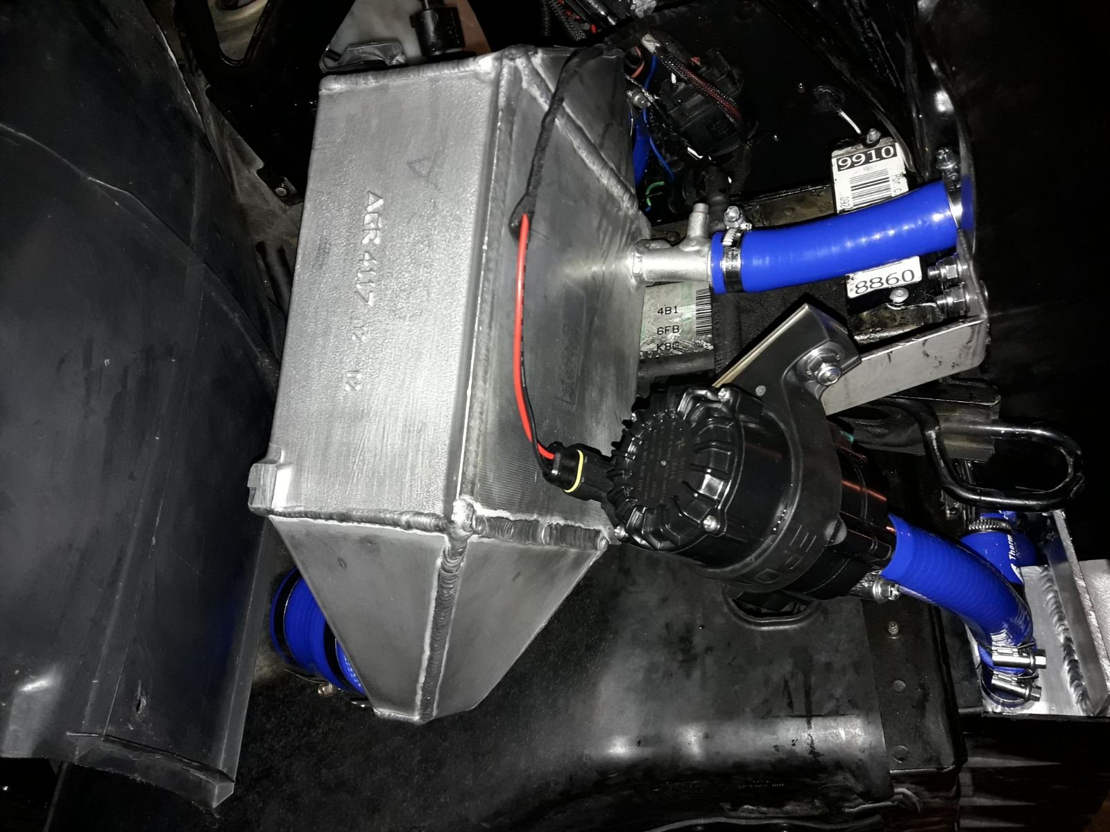

Water cooling system FINALLY DONE.

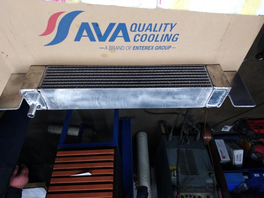

We used core from Mercedes S55 WCAC. We thsn 3D laser scaned OEM SMIC,and made custom endtanks and brackets to be Like OEM plug and play installation-made by @ojomotorsport
Company https://var.hr in Sesvete Croatia made custom water cooler using core from  https://www.cog.it/ according to model I made. We used best in the market water brushless magnetic driven pump Craig Davies EBP25 New revised,stronger and smaller model 27l/min (EBP25 older model for sale-slightly longer and 25l/min), mounted on custom SS bracket, custom fill tank I designed and silicone hoses from Polish company Thermotec. Sleek design and installation-OEM like and bumper went back flawless. Idea is to put water termo sensor after water cooler to control efficiency of cooling. Now going to https://www.rsrmotorsport.com/  for dyno measurement and PBC BOOST CONTROLER installation.
KOSO-Motorcycle-Thermometer-for-0-120-Degree-Centigrade-Universal-Digital-Moto-Water-Temperature-Gauge-with-Sensor.jpg
Edited by davojuri
Who's your dady now💪💪💪💪
THATS EPIC WORK B) look forward to results on this :thumbup:
Now it's time for fine tuning. First I wanted strongest and smallest water pump so I bought Davies Craig EBP25,market leader that flows 27l/min.
I was so happy, than I applied laws of physics and it says that it circles whole coolant amount (approximatelly 2.5 liter without expansion tank) in only 6 seconds!!!!
That mesna probbably it flows to fast, so I ordered new water pump from Bosch that flows 15l/min or 10s for full circle of coolant. Almost hundred percent more time for conduction to take place-direct contact heat dissapation.
Will get it in few days💪💪😉😉😉 so stay tuned
