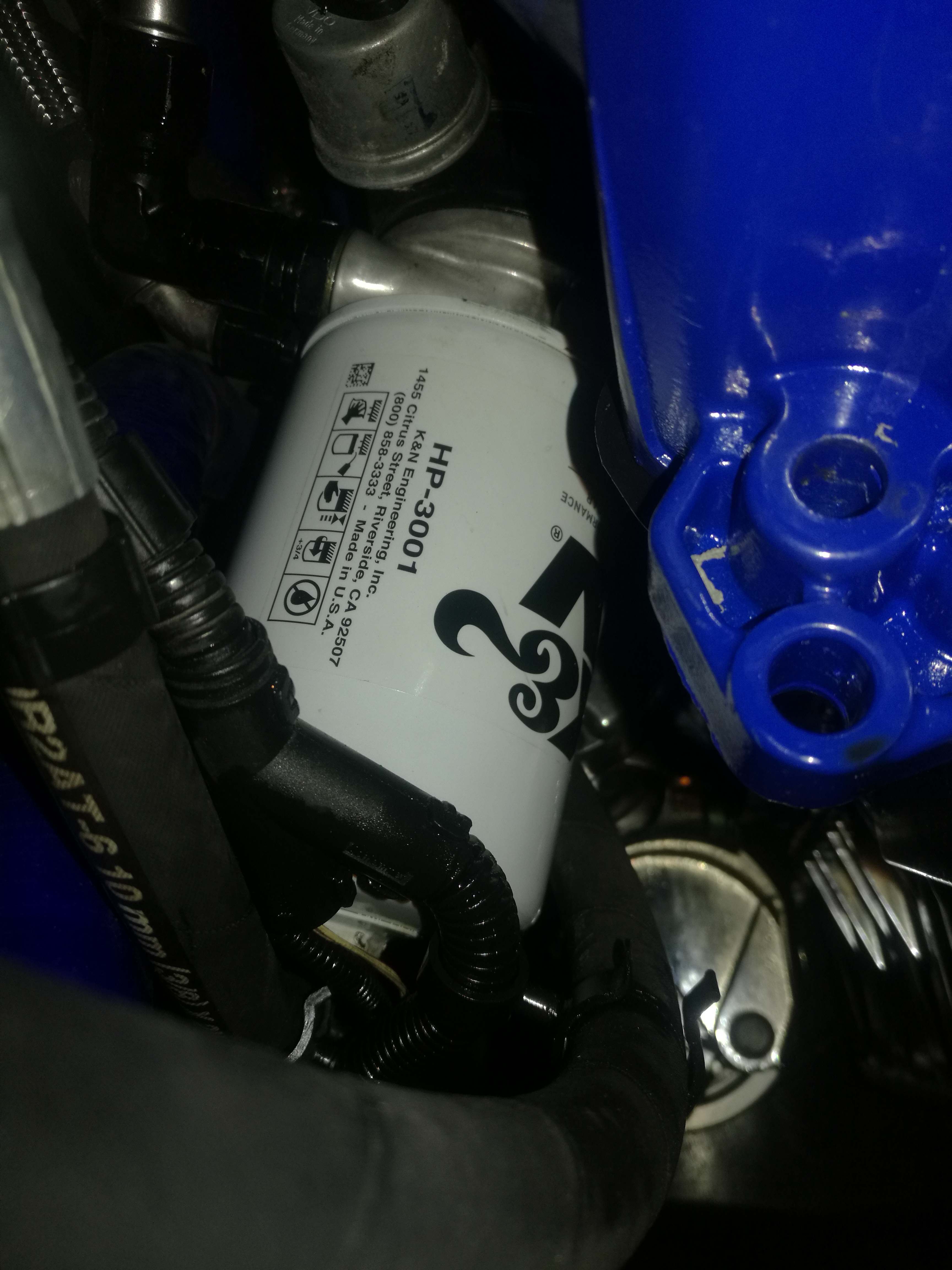

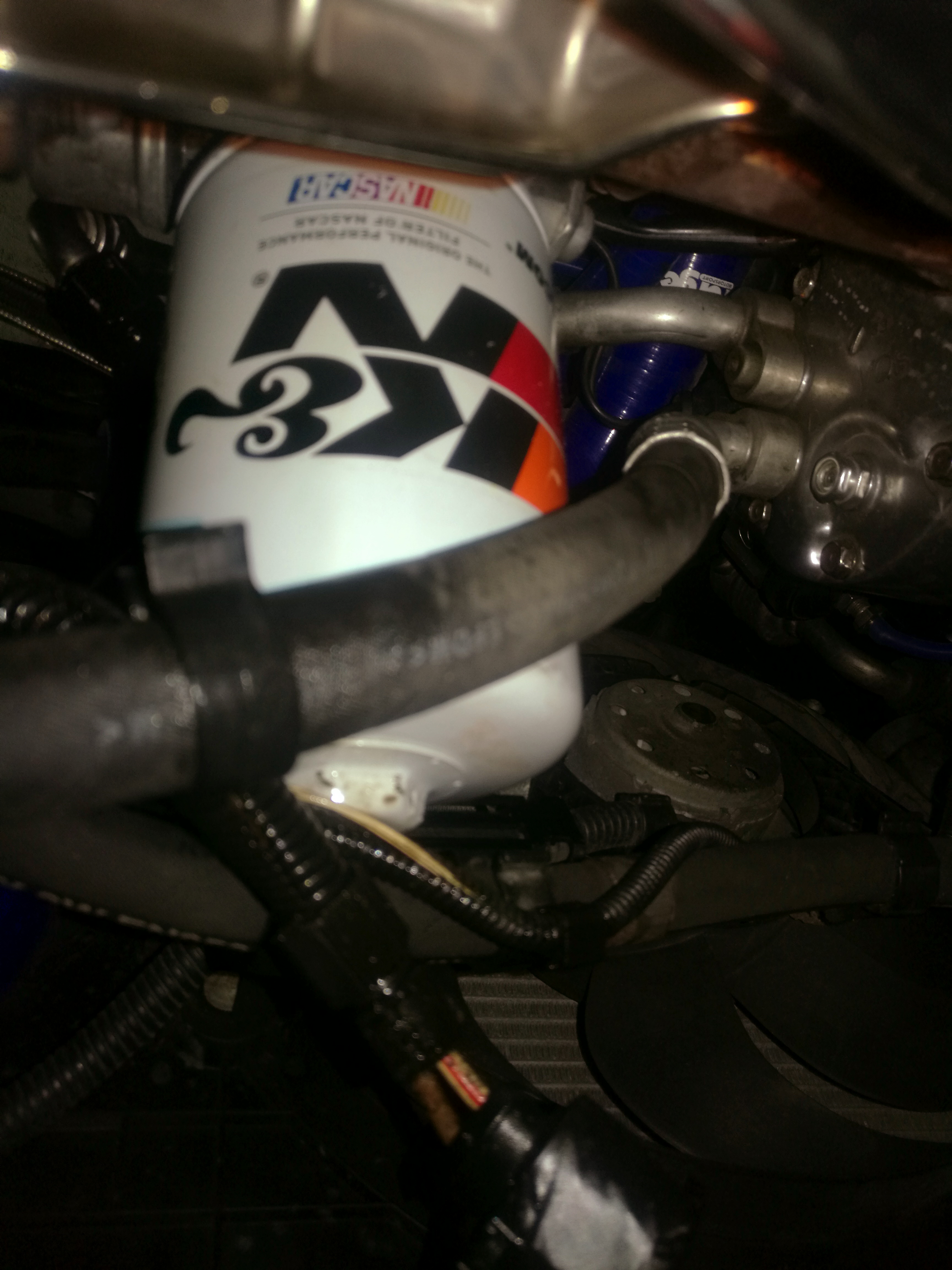

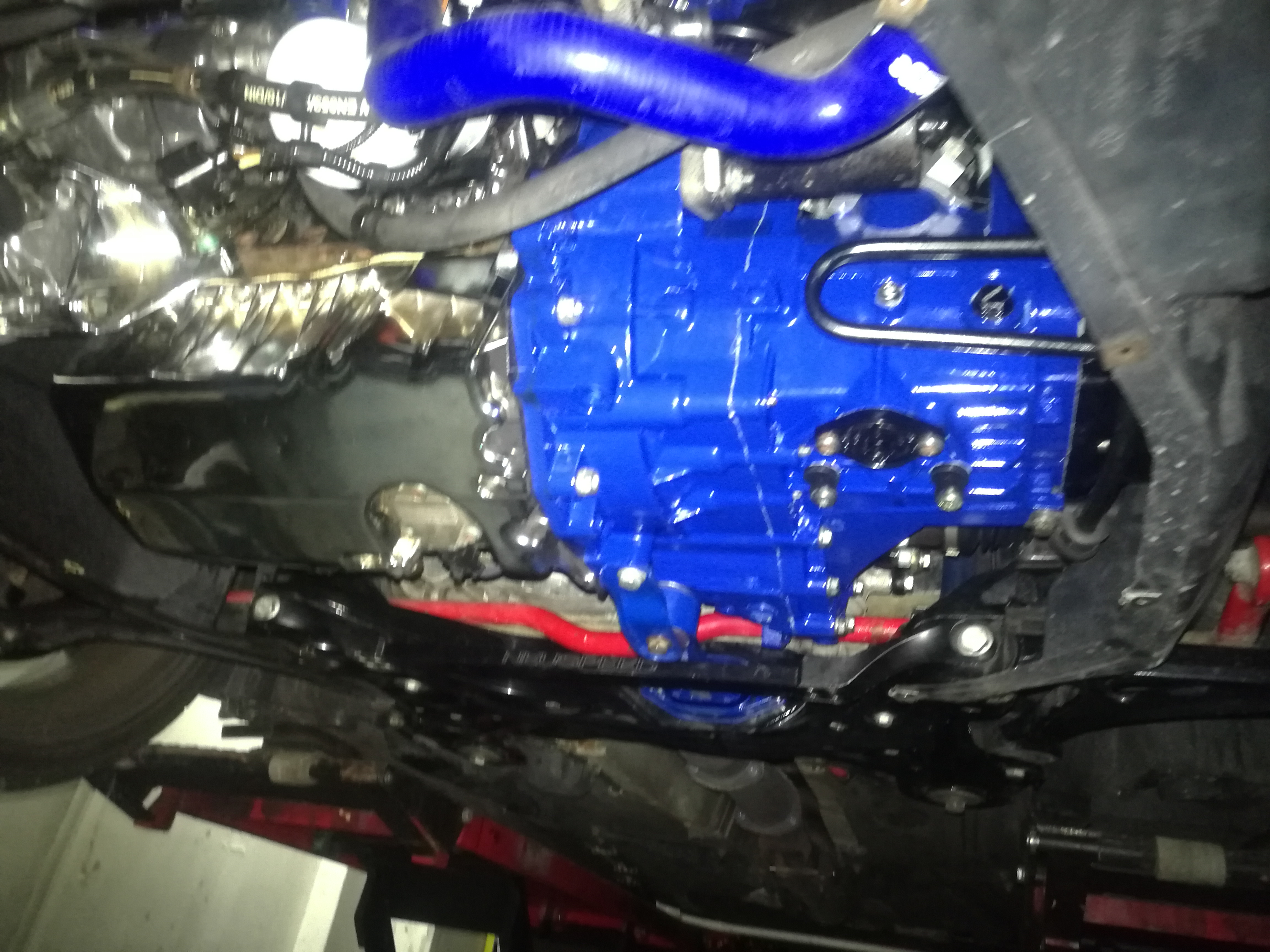

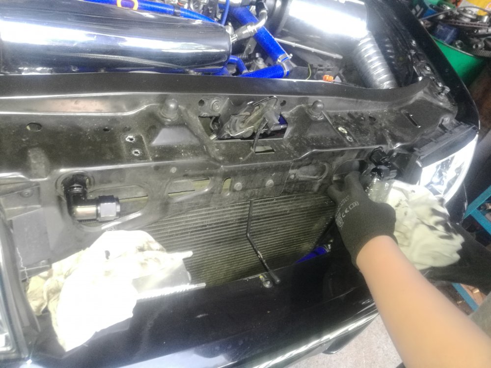

KN HP3001 -extra large size in place.

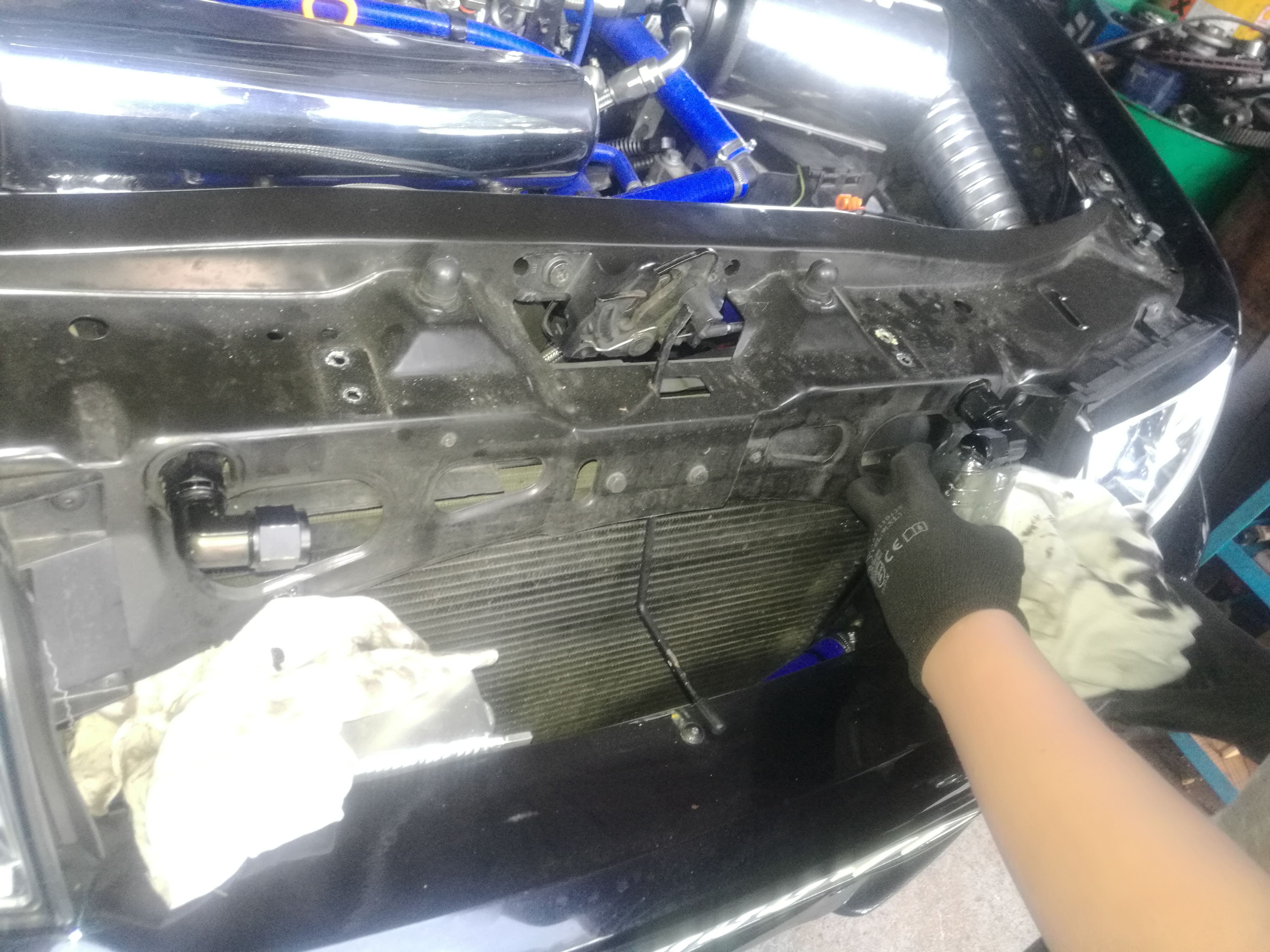

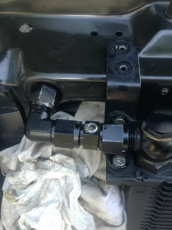

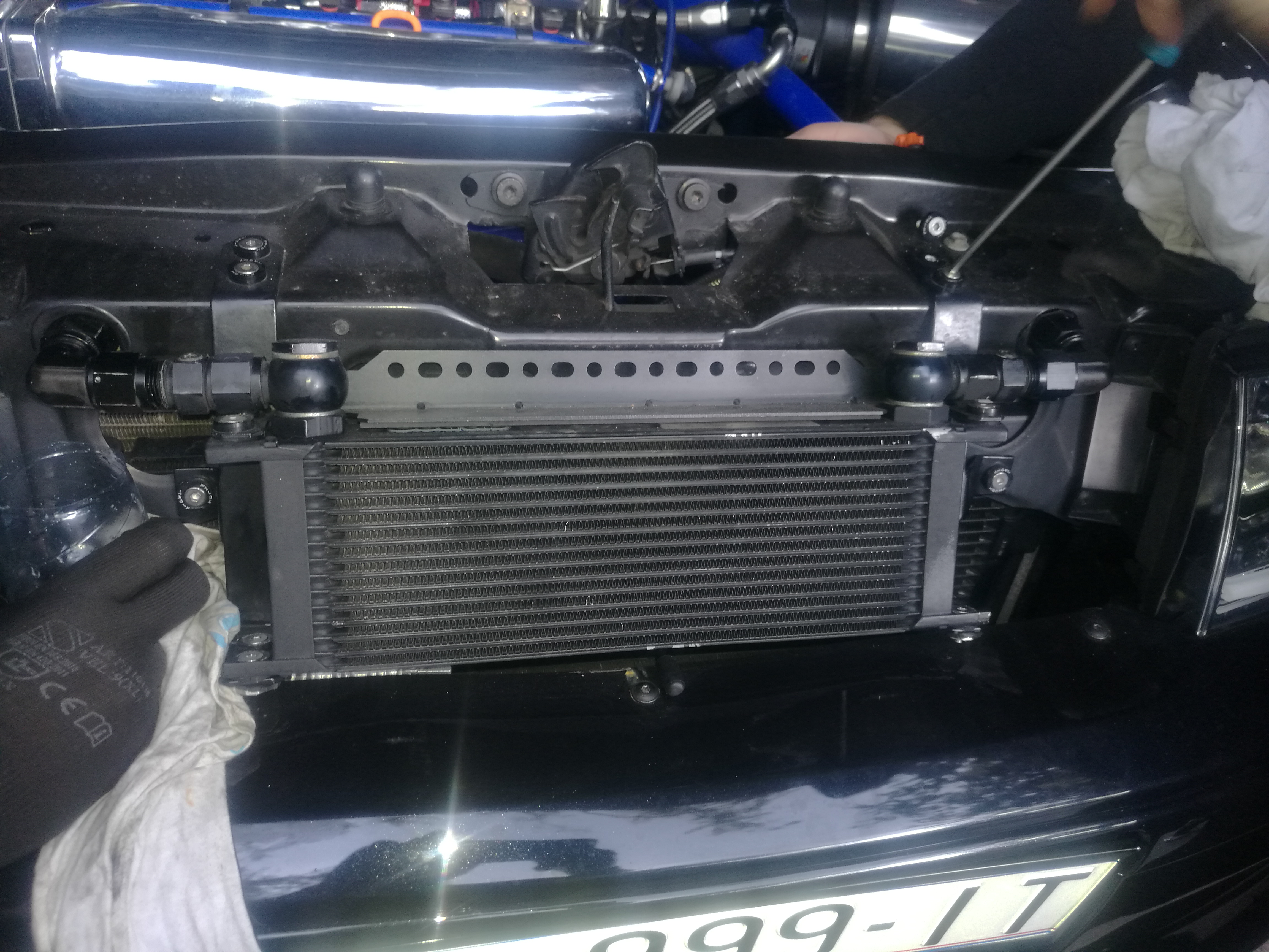

Oil cooler removed and emptied

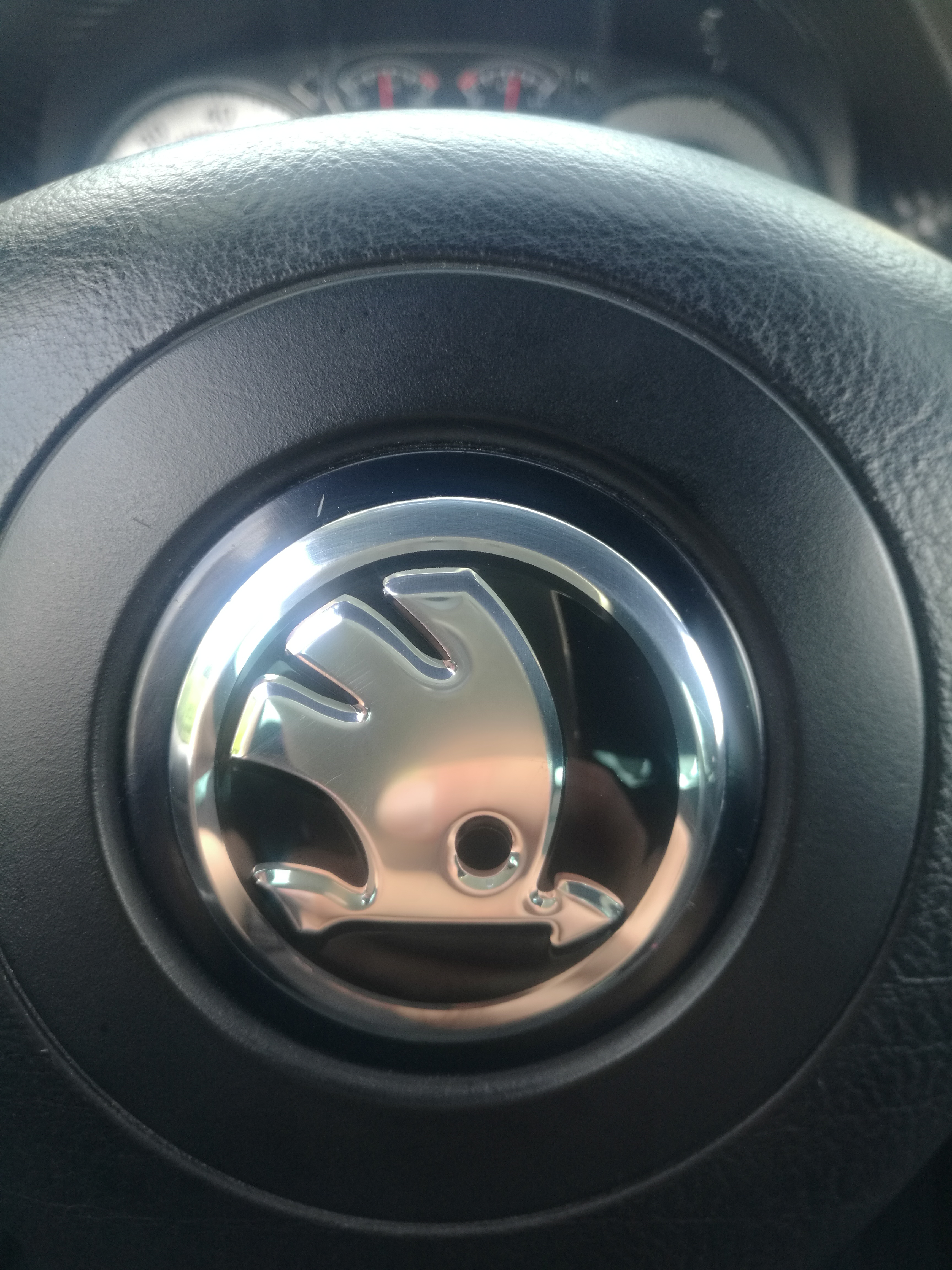

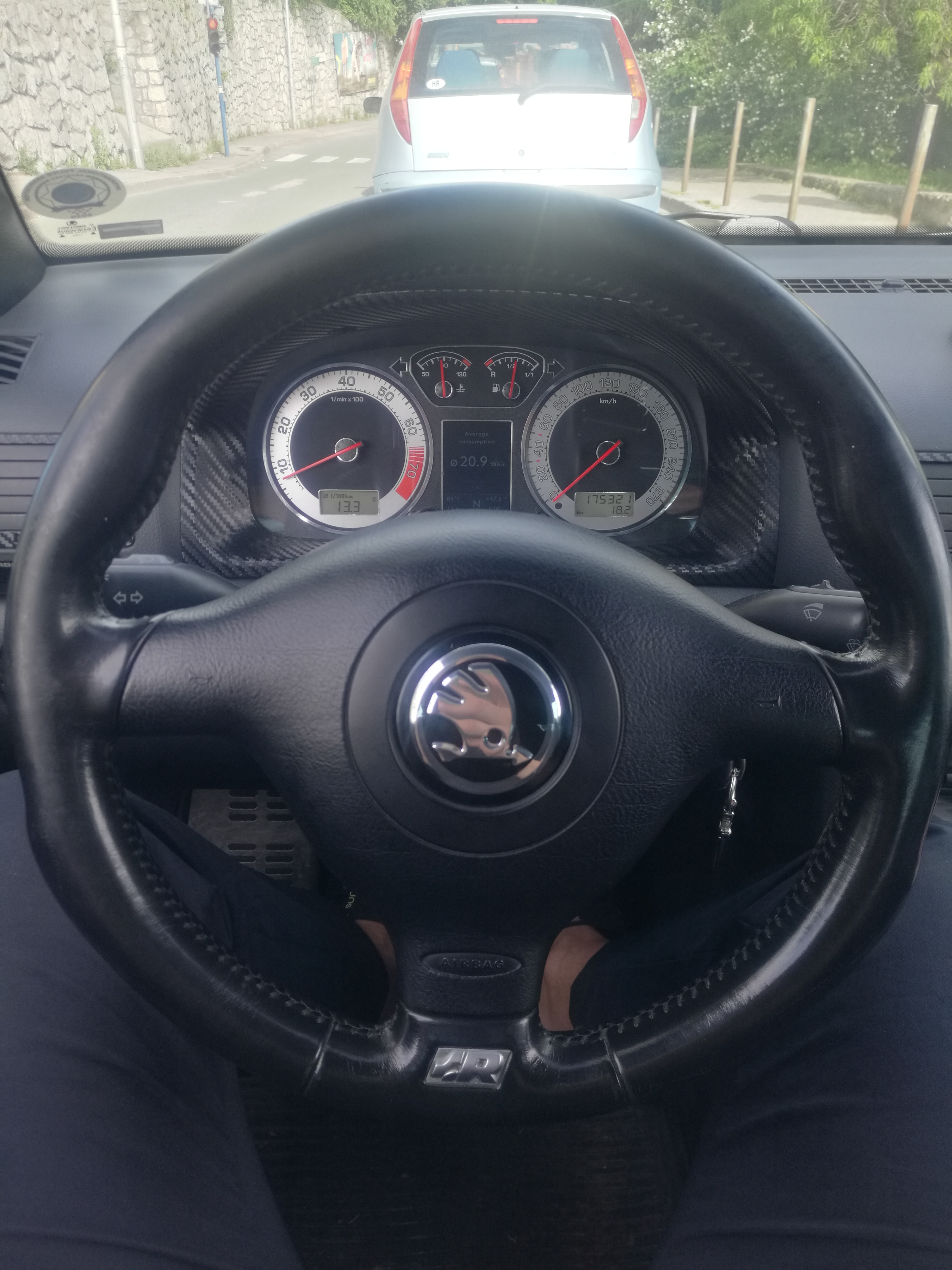

New steering wheel badge

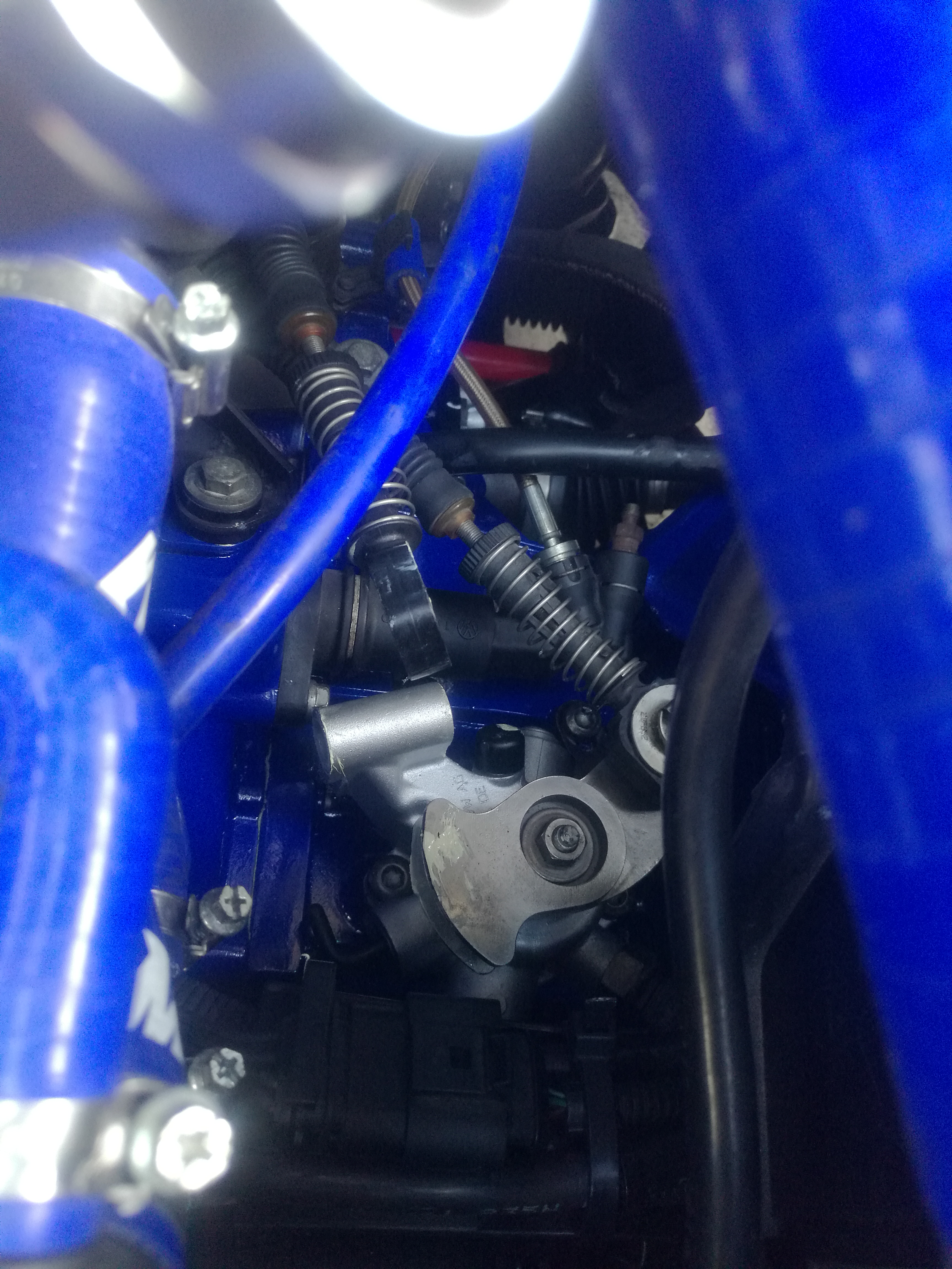

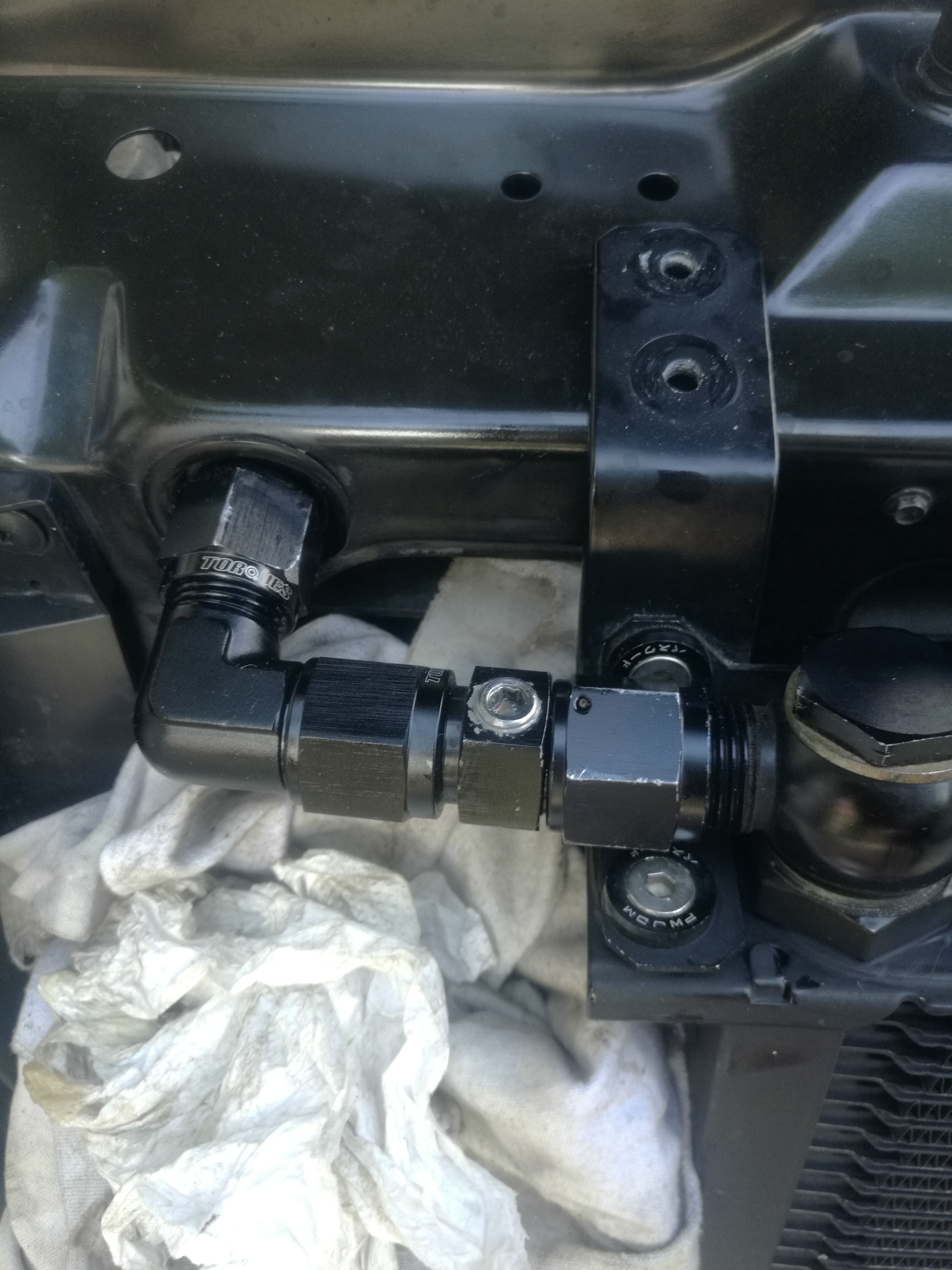

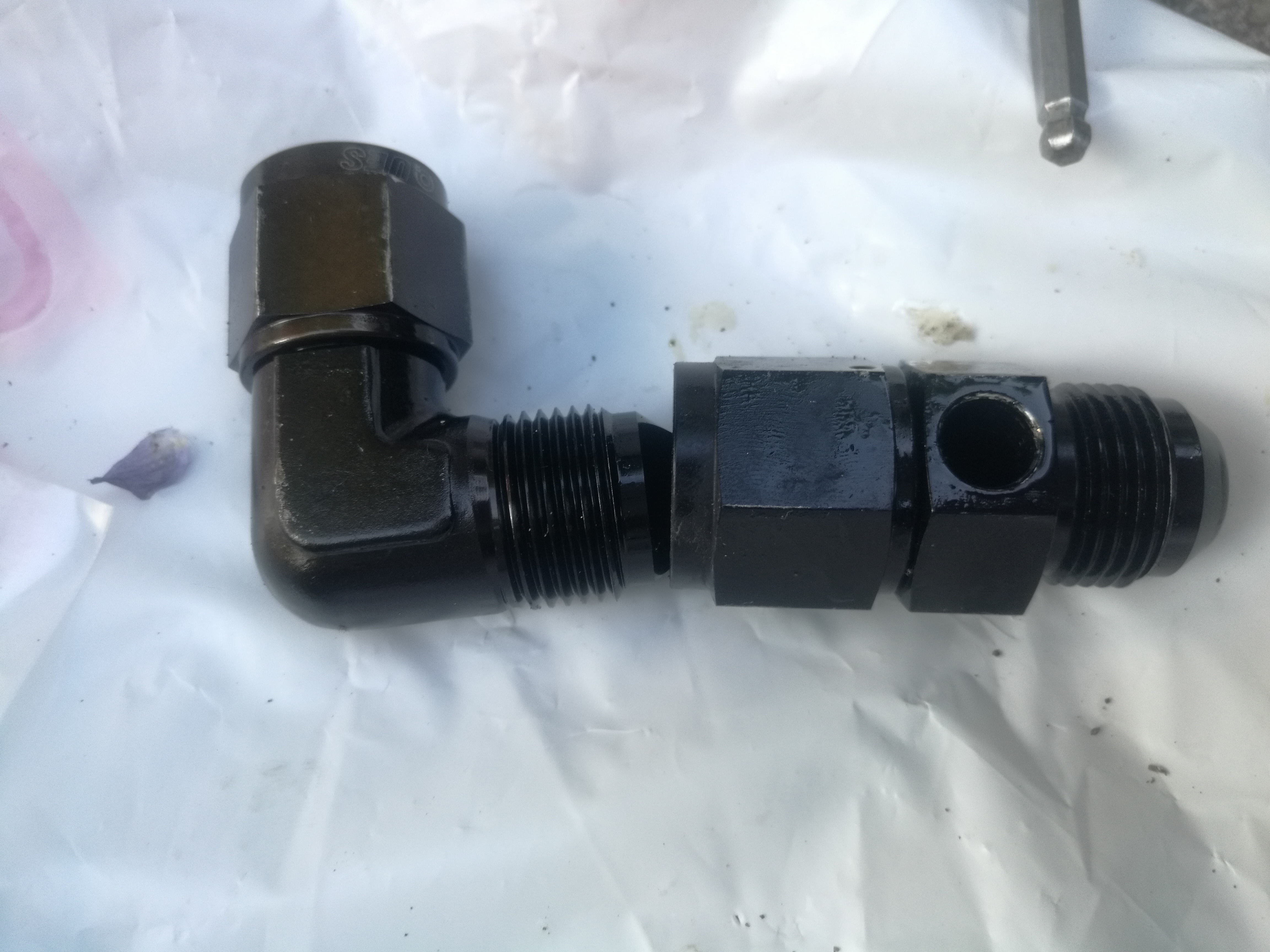

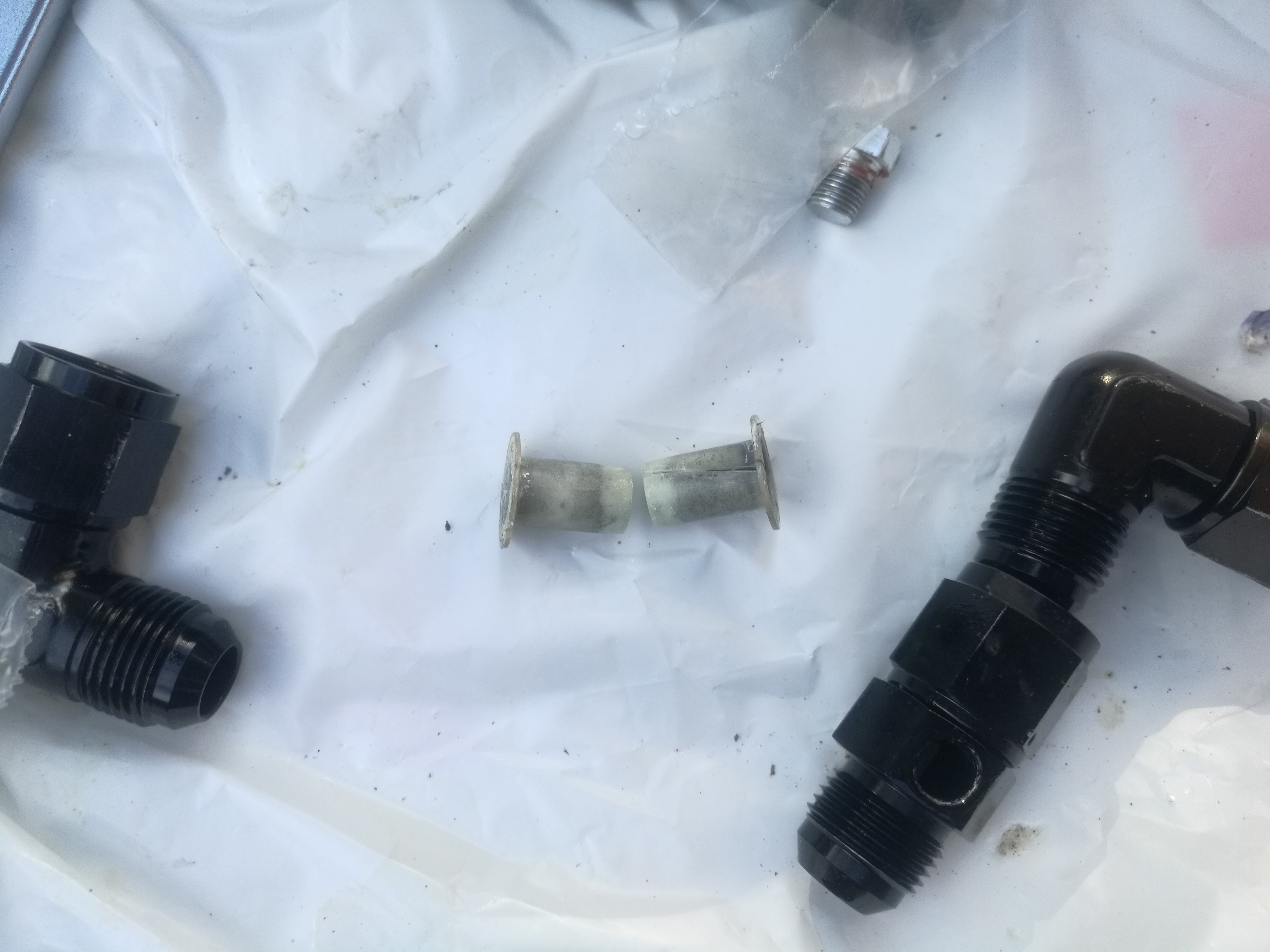

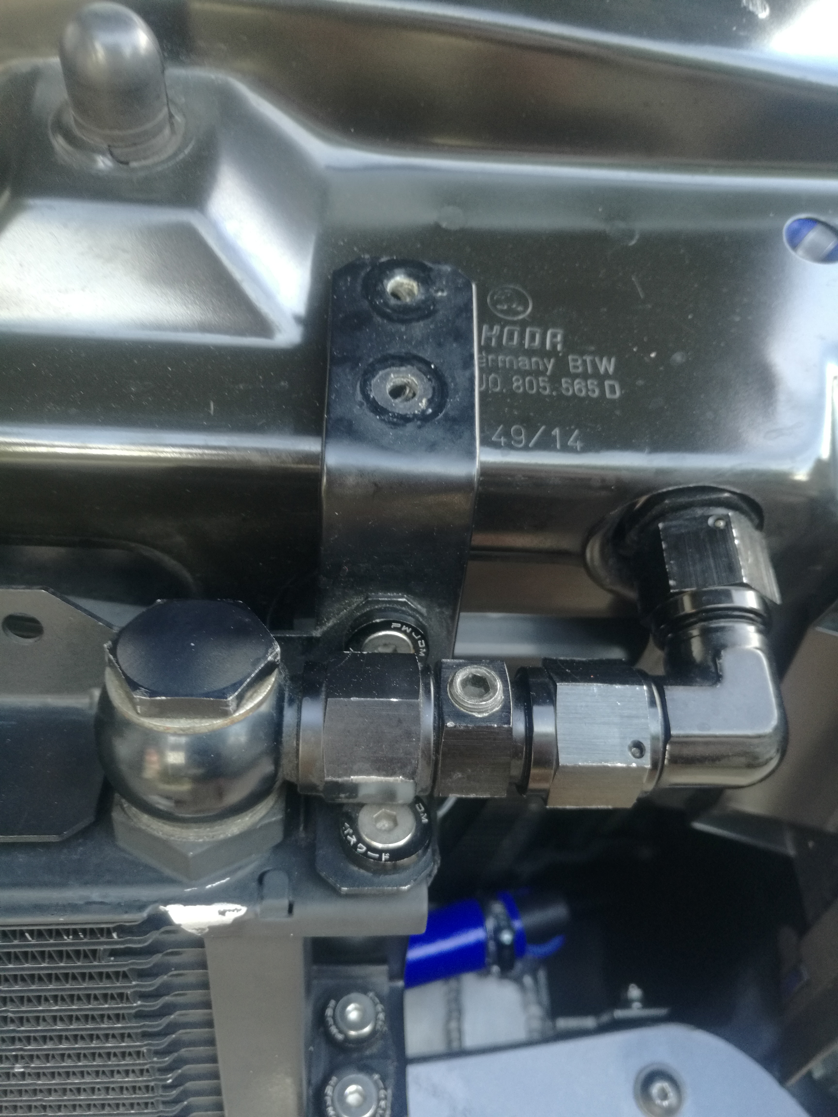

Due to the unexplained oil leak (after removal and cleaning od the Setrab oil cooler) from both 90⁰ AN10 adapters I replaced them With New ones and also on passenger side New male/genske straight adapter with 1/8npt plug (had only one straight adapter). First test rub and no leak for now. Hope it Will stay so🙂
It seems no more leaking😀.

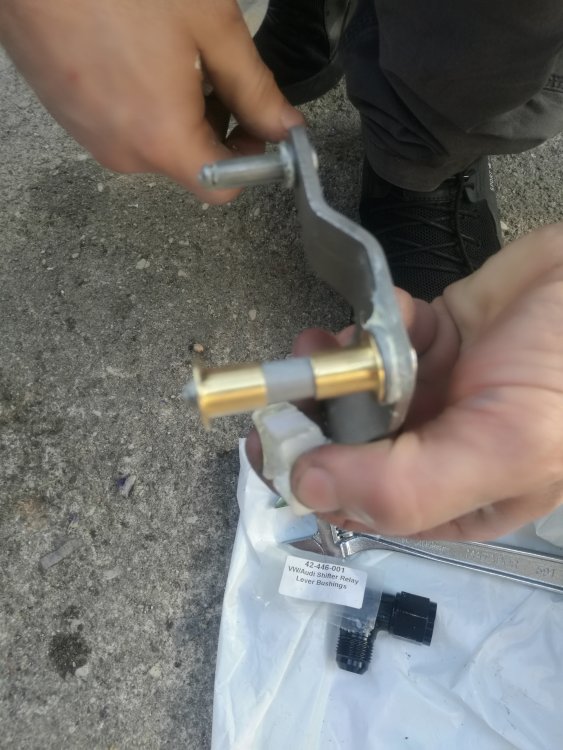

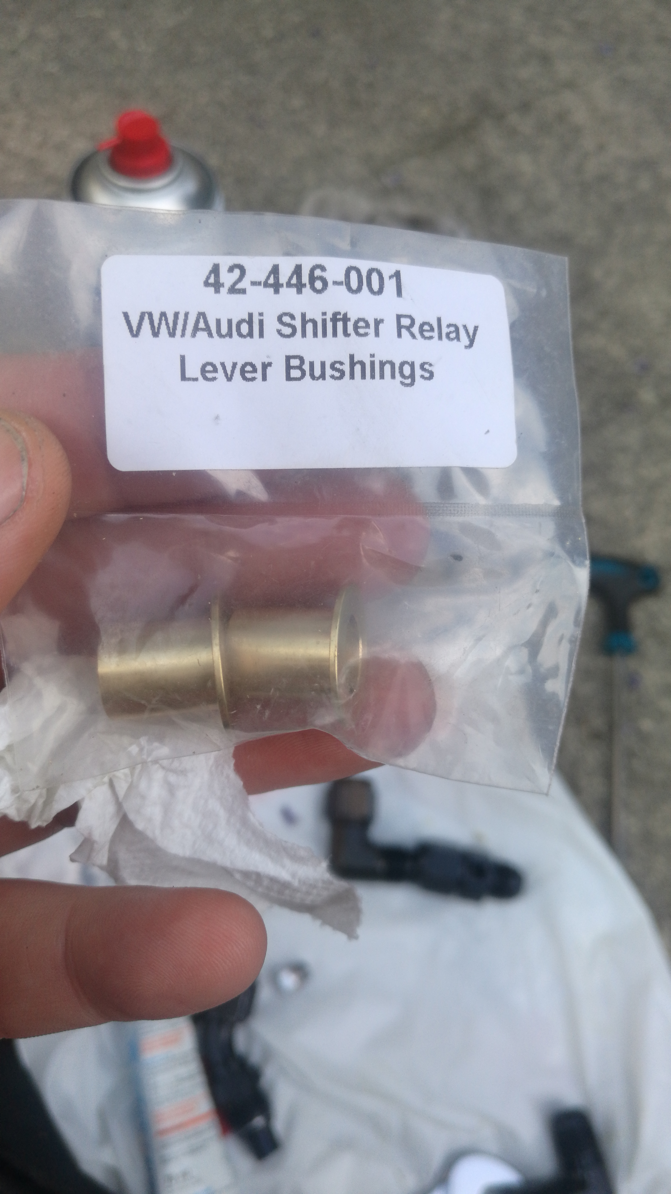

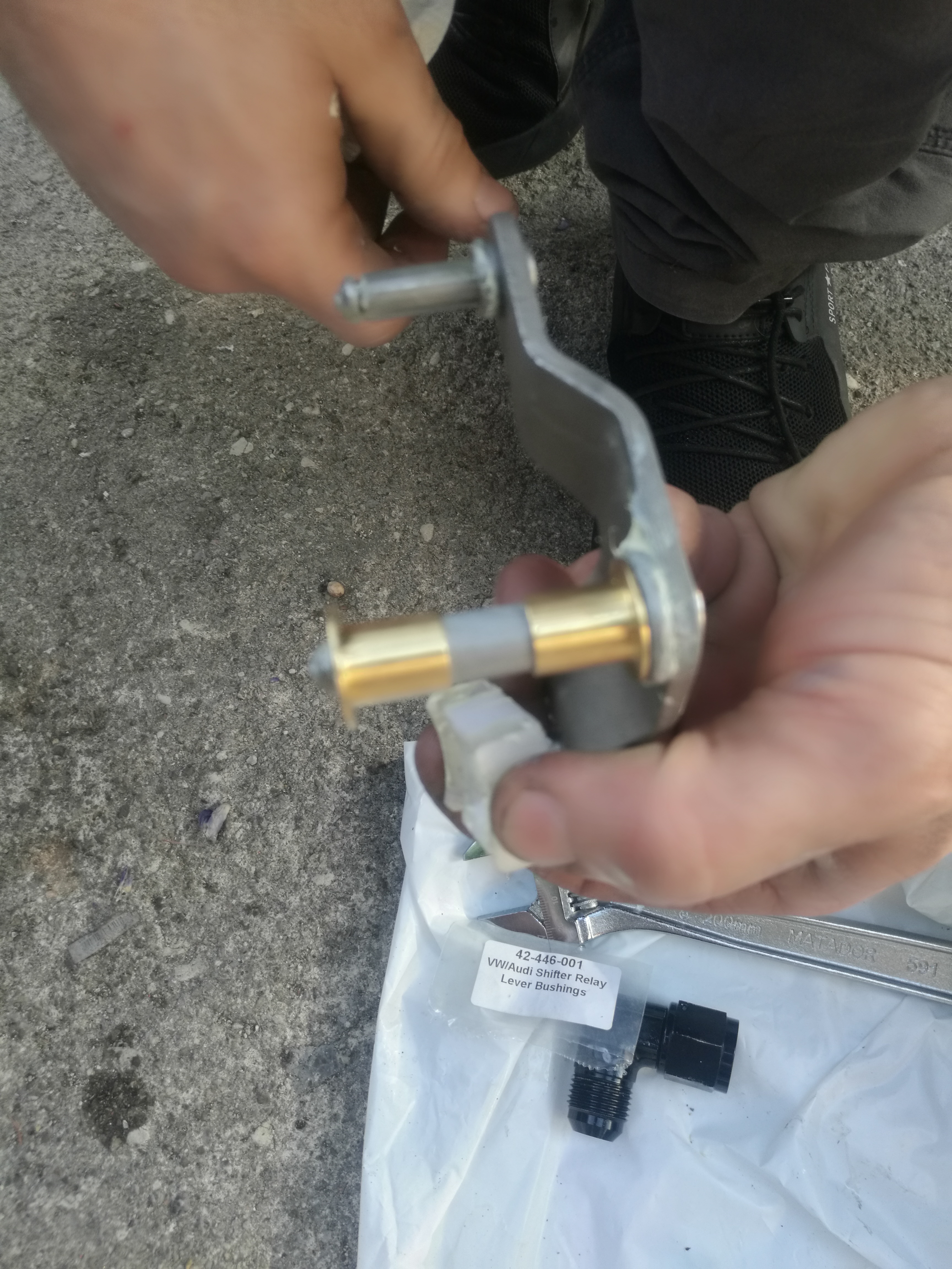

I've installed these bronze bushings on selector from 42DD, and replaced worn plastic ones

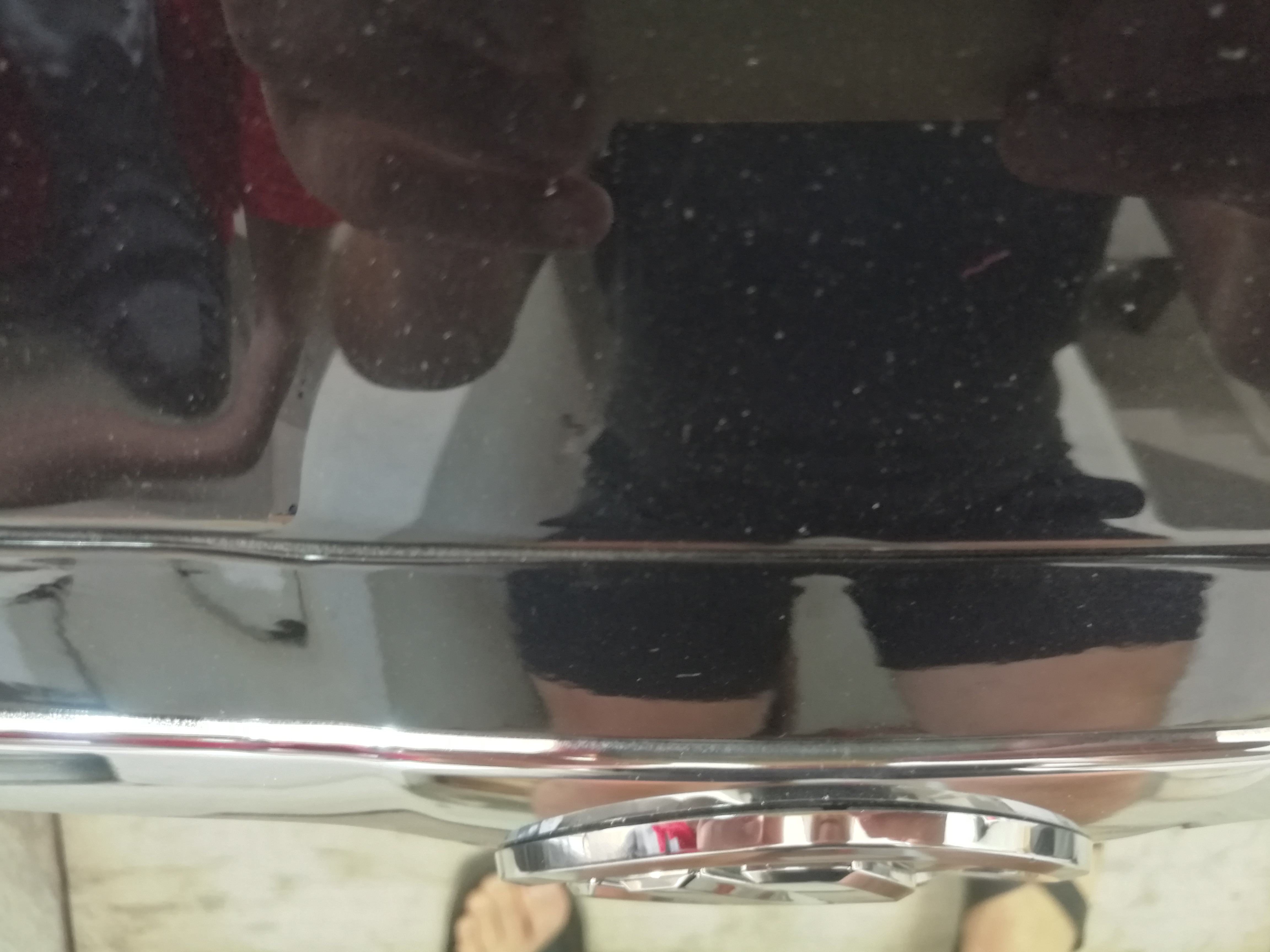

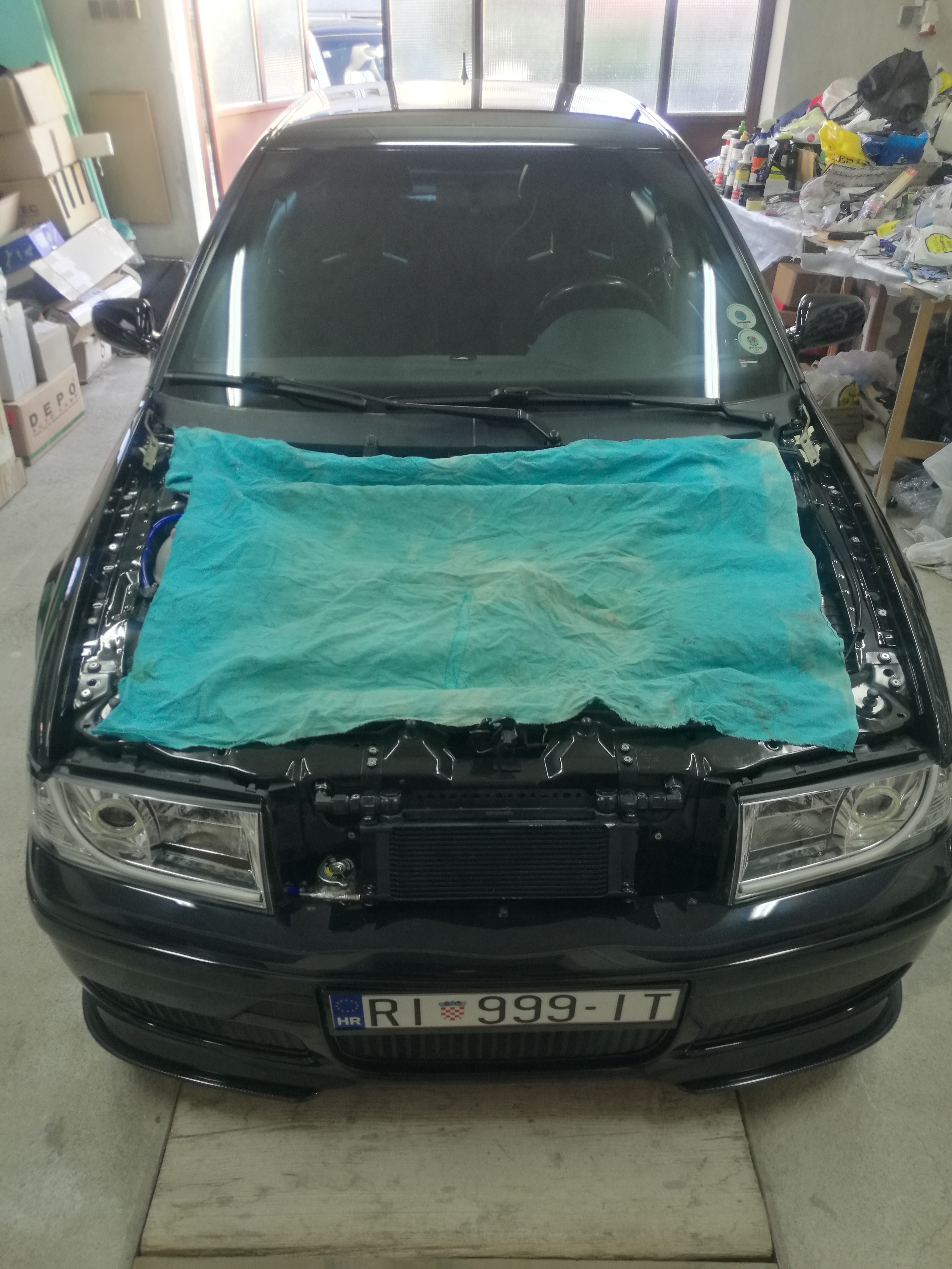

Hood went for repainting, grinding up to Trizact 3000, than polishing with 3M green,yellow and blue paste at the end. Blue sheet is dust protection 😂😂😂😂

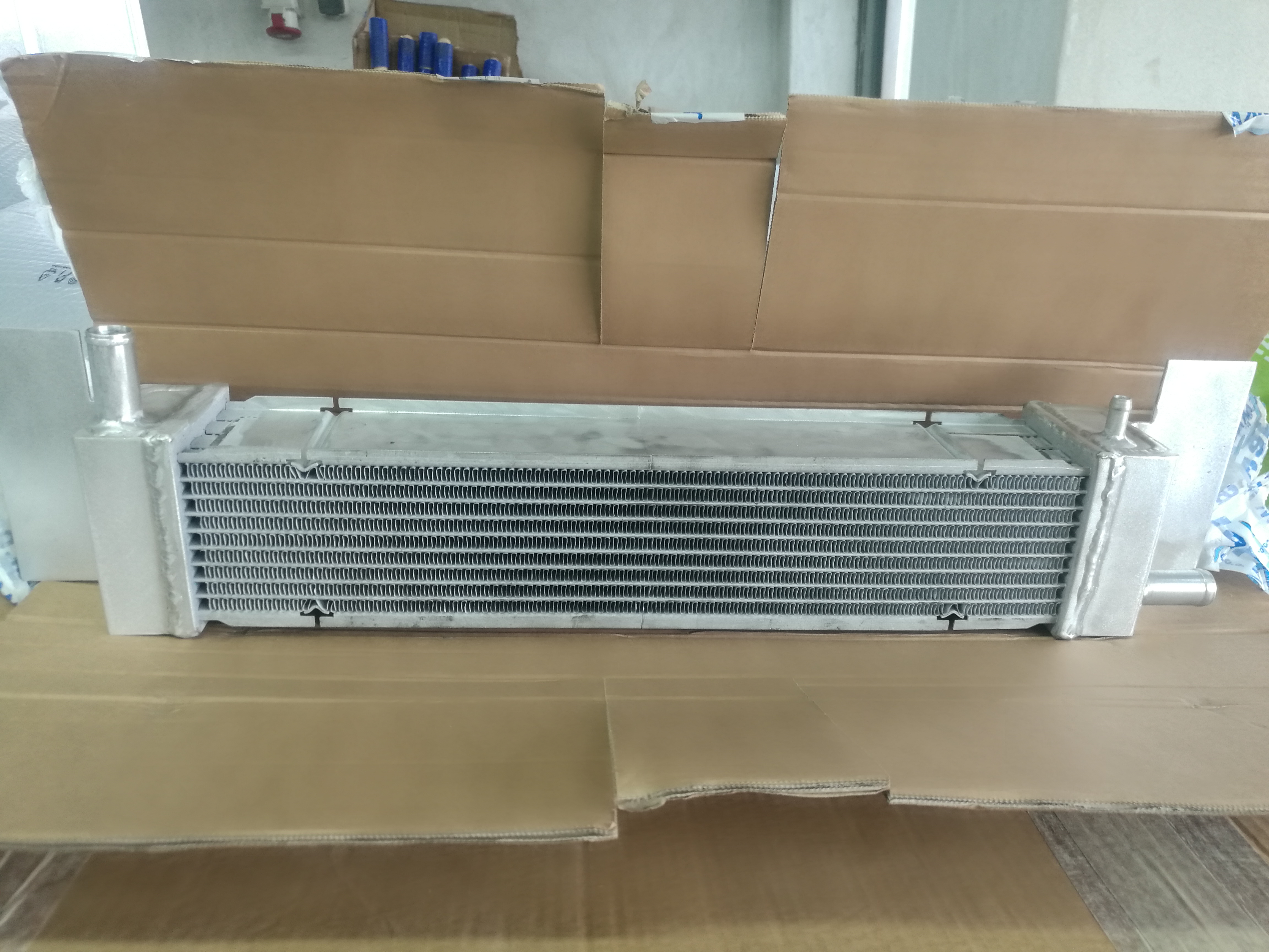

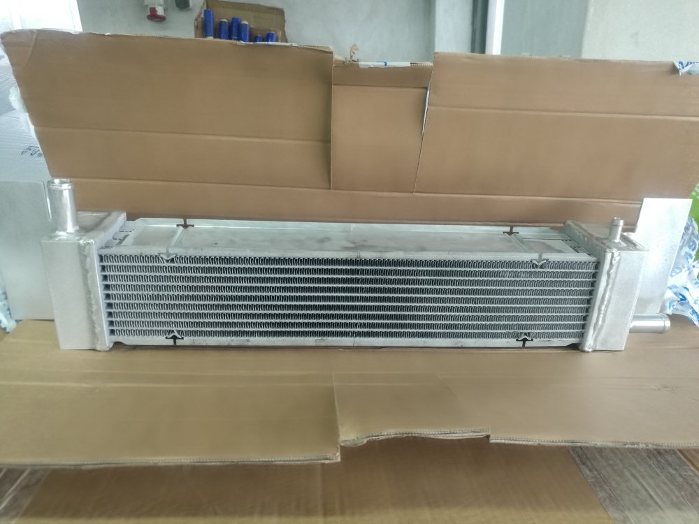

Finally got new water cooler made with tube fin core. Now time forctesting Bosch EBP with bar plate and tube fin cooler and Craig Davies EBP25 with both water cooler and by measuring IAT during full throttle load and water temperature we will see which one is the best combo

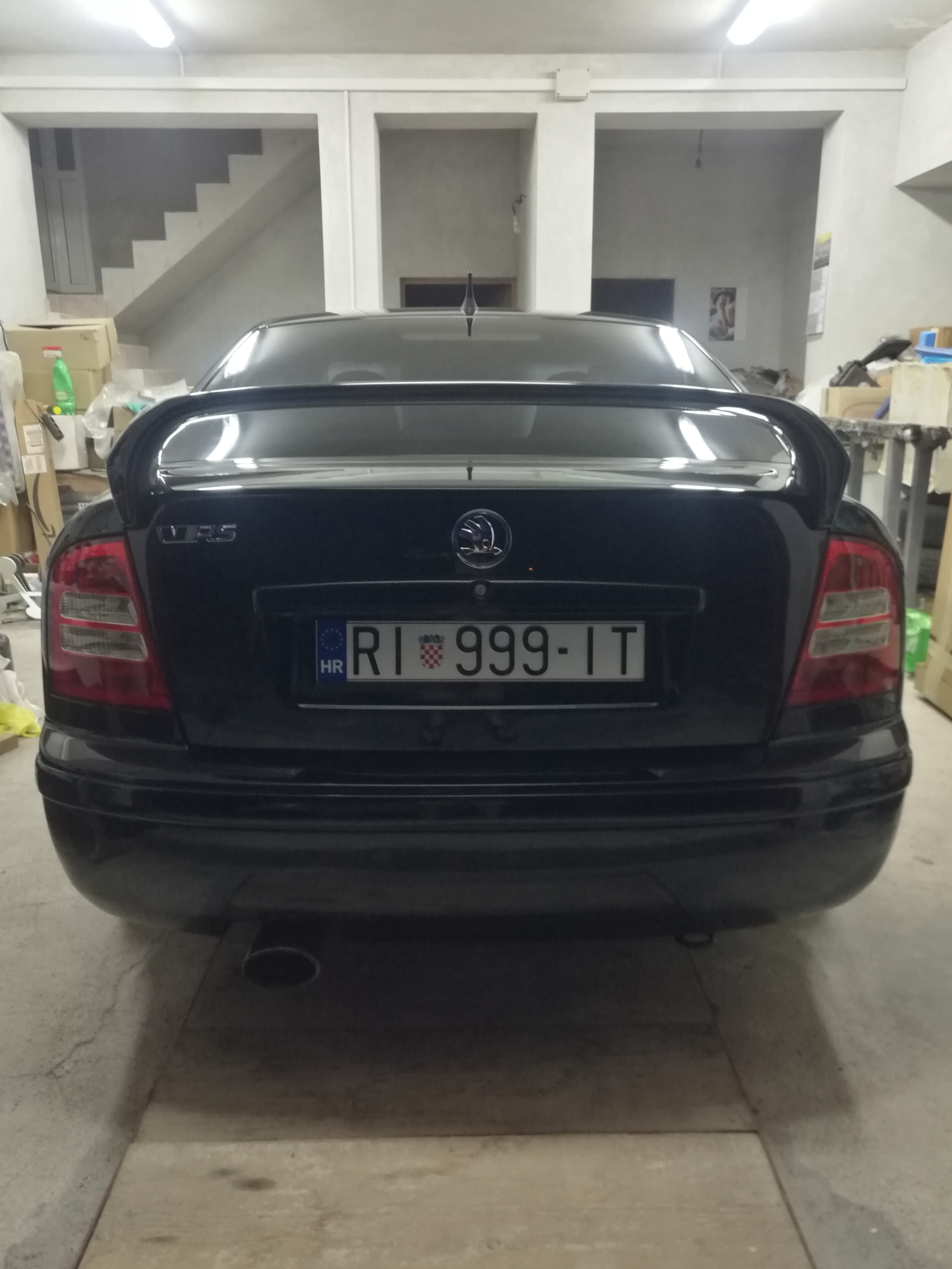

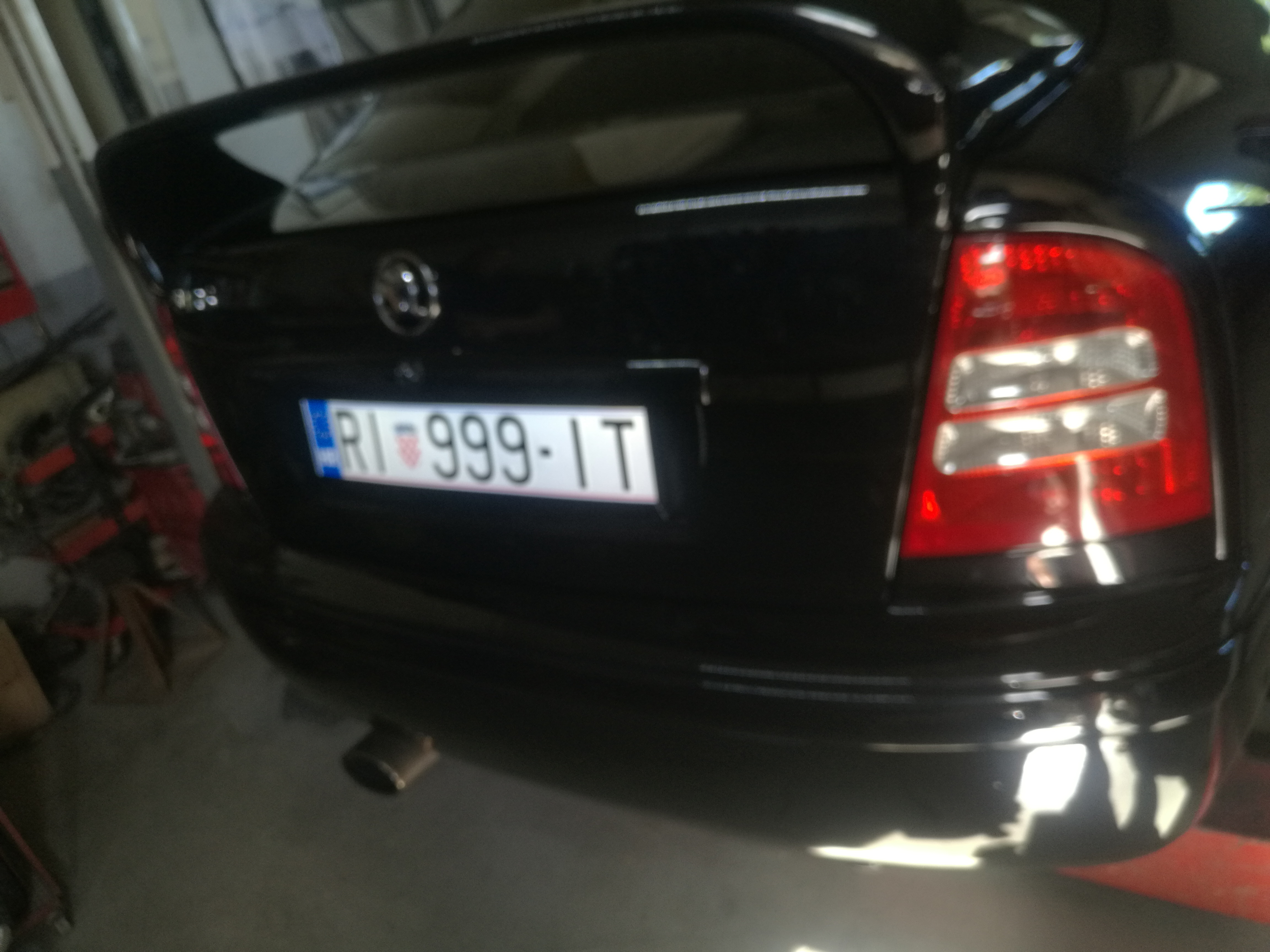

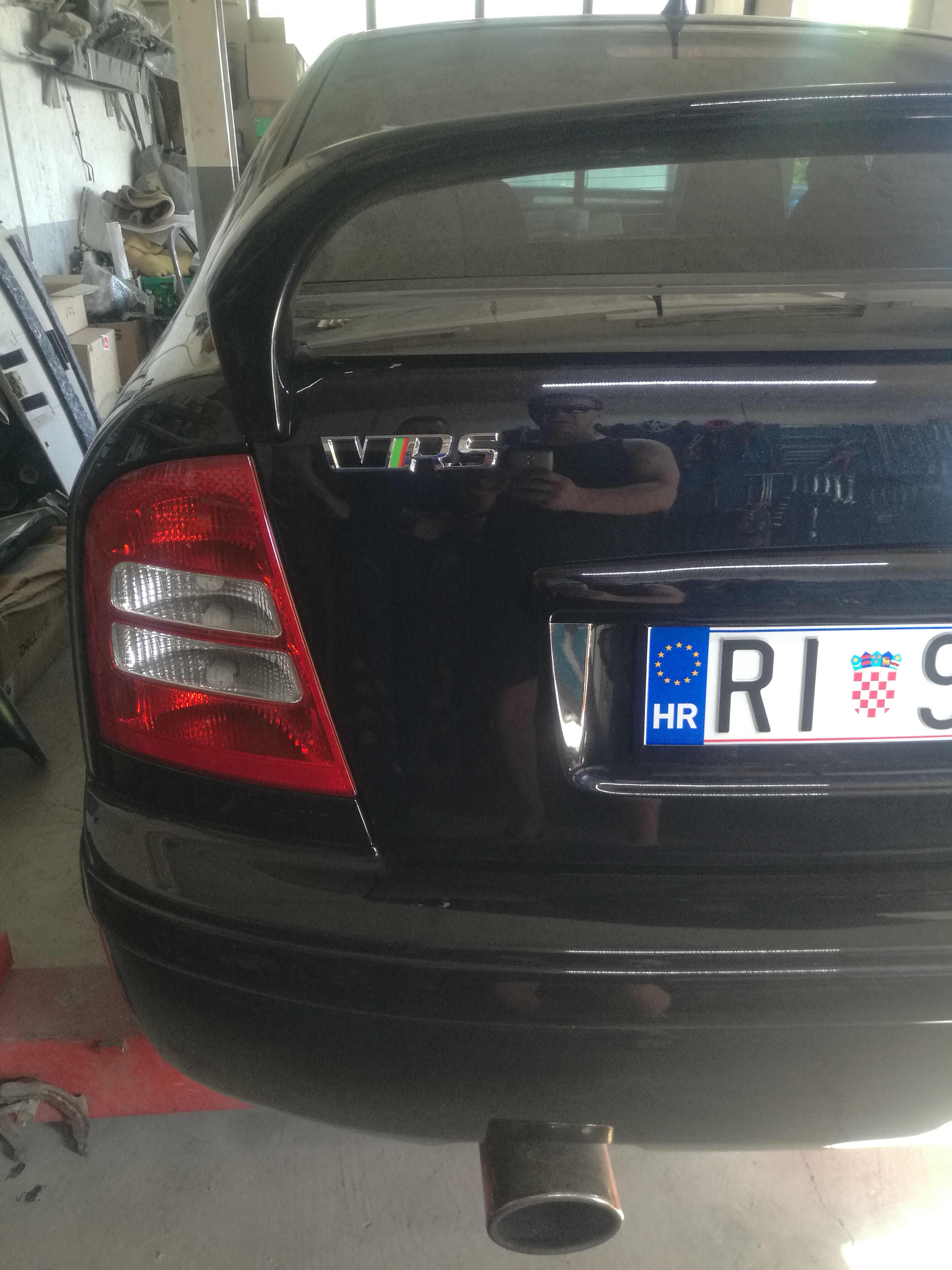

Original rear wing from Croatia Octavia cup car is ready, painted,grinded and polished, ceramic Gtechniq Crystal ultra serum and hydrophobic coating to come before installation.
great find :) i want the mirrors if you ever find someone who makes the wrc style ones or cup
I do6bt I Will. I wasafter WRC carbon kevlar wing,even guys in Czech Republic promissed to do one,but never realised that. WRC style is much nicer to me
First impression od the original Octavia Cup car rear wing is
SIMPLY AMAZING
SIMPLY AMAZING
need a full rear view too , also what rear disc conversion did you fit?
330mm Audi quattro discs and adapters for OEM calipers
like that a lot , i'm trying to find someone to collect me some bits and post from cz
That's Great plan. Originally I wanted original kevlar carbon WRC wing
that would've been cool

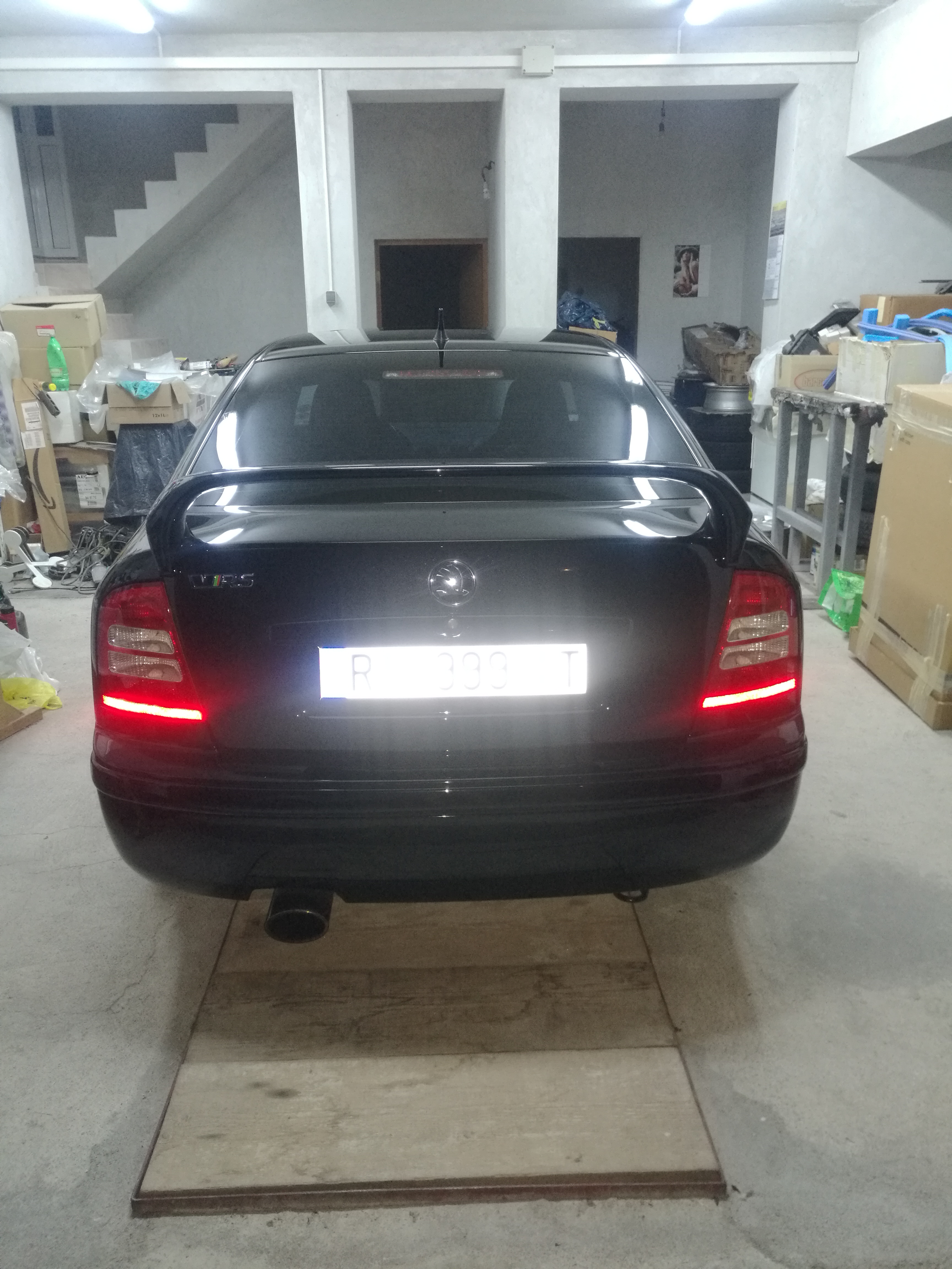

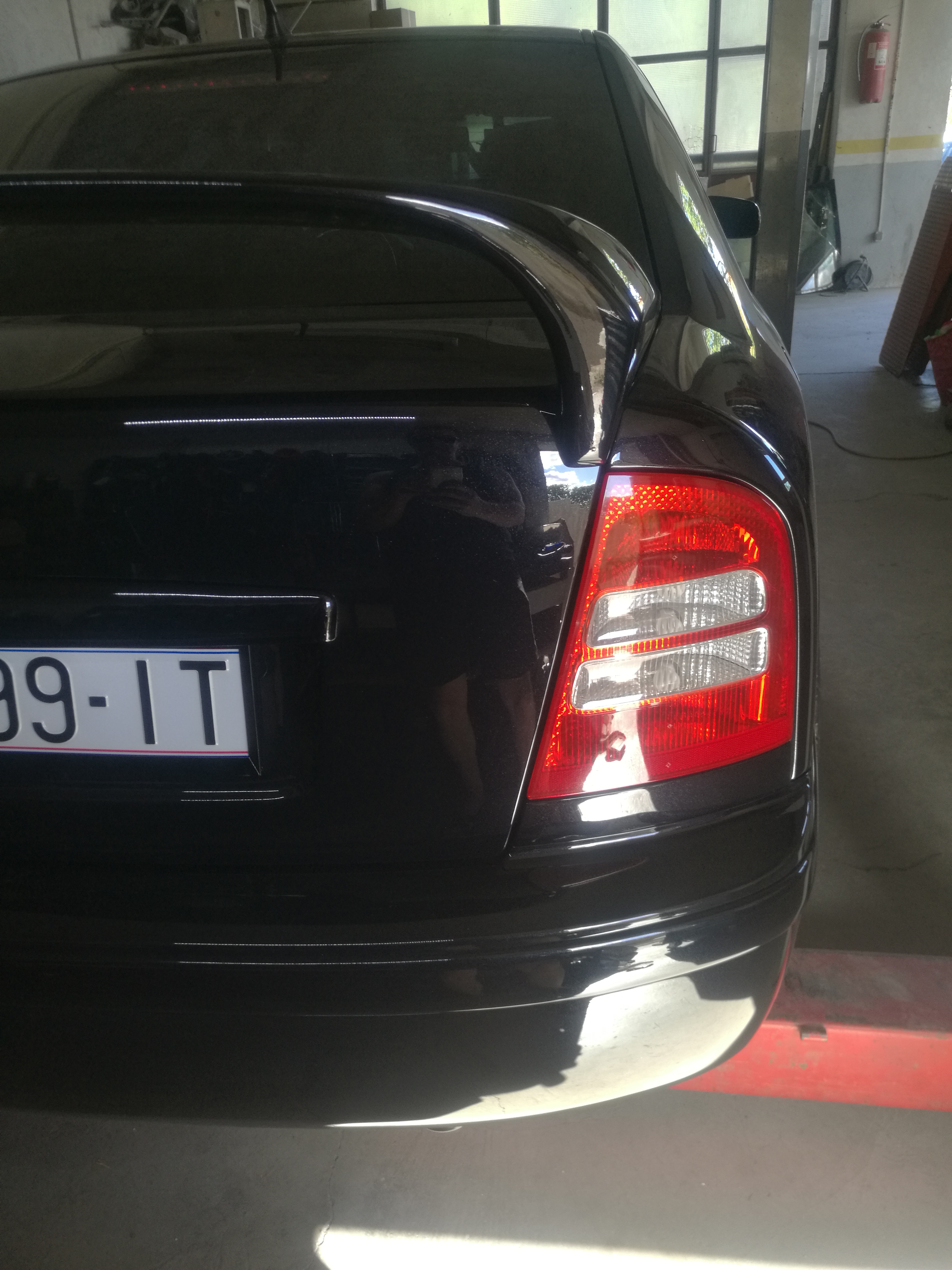

Full rear wiev of new rear wing
Edited by davojuri

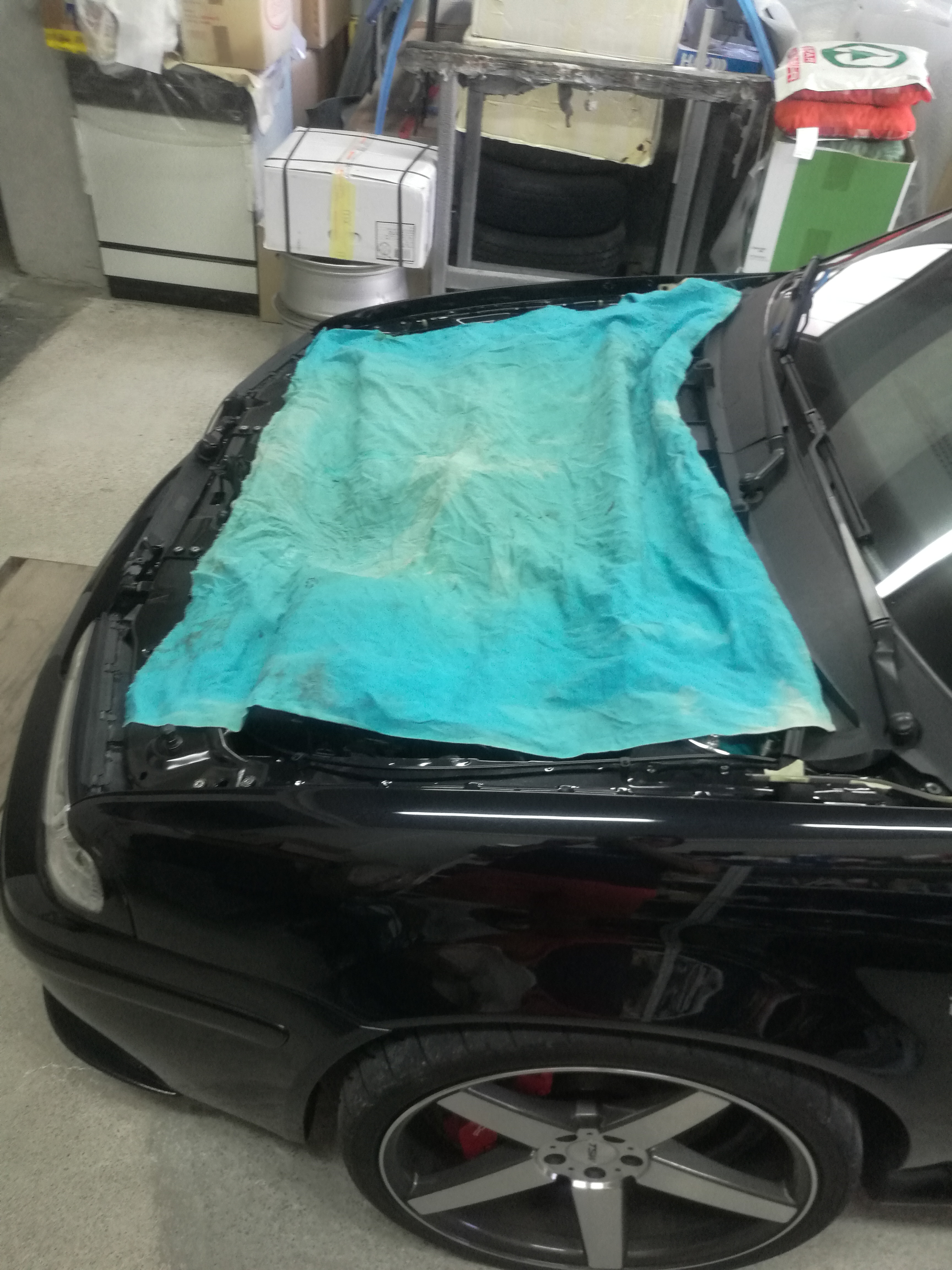

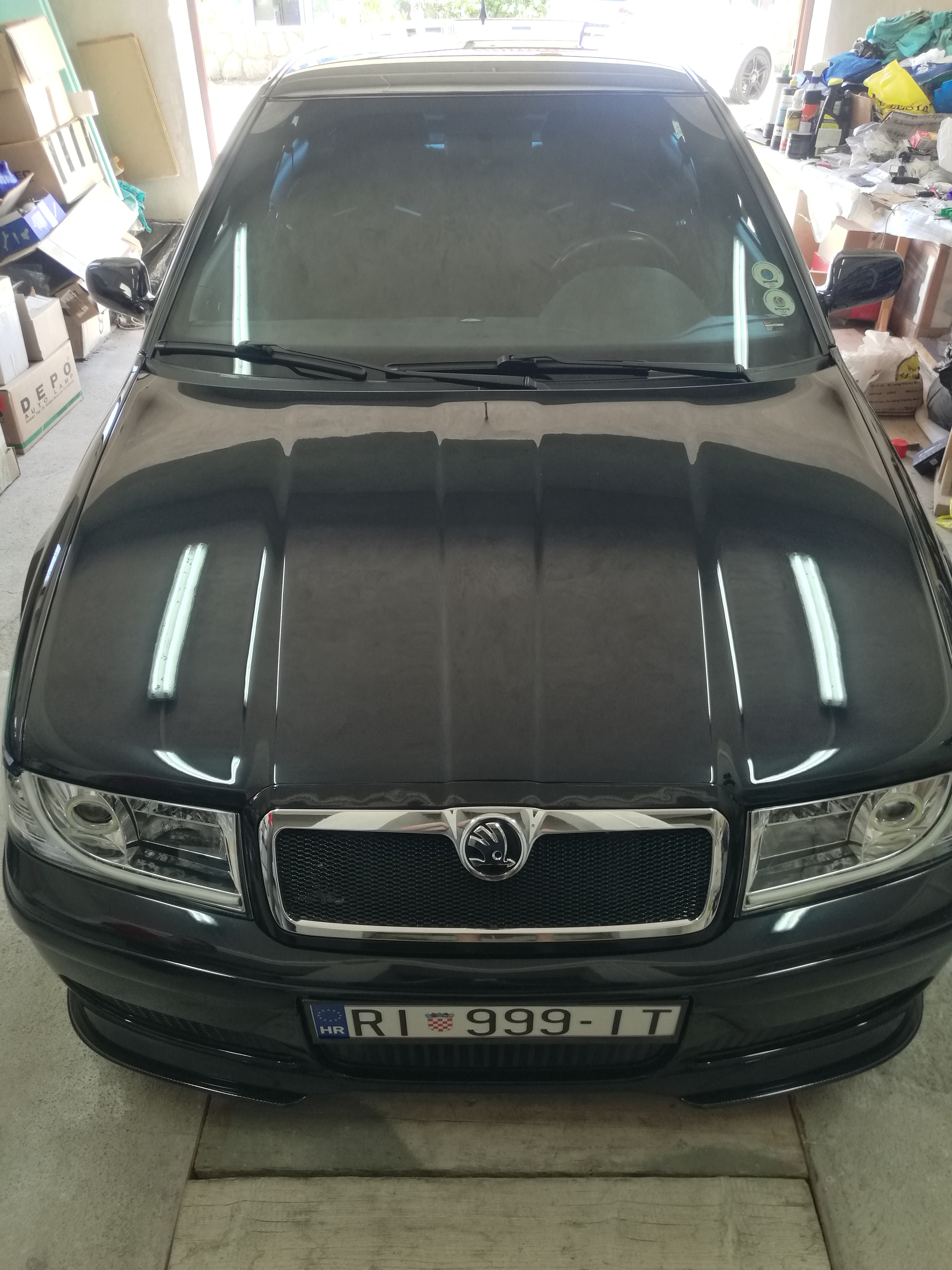

Hood has came back from painting, grinding up to Trizact 3000, polishing with 3M green, yellow and blue paste.
Small trick I used to avoid damage od newly painted hood from the grille which has mesh instead of rigid OEM insert meaning when You lift the hood over the grille You flex it and it scratches the painting on the hood so we did put double sided Wurth adhesive tape-narrow one 4mm apprpximatelly, to act as a damper, aside the fact that I don't lift hood over the grille but directly holding the hood lateraly from the grille
