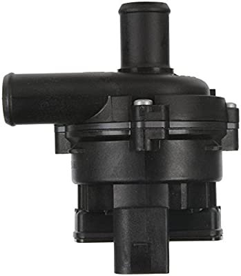

Now it's time for fine tuning. First I wanted strongest and smallest water pump so I bought Davies Craig EBP25,market leader that flows 27l/min.
I was so happy, than I applied laws of physics and it says that it circles whole coolant amount (approximatelly 2.5 liter without expansion tank) in only 6 seconds!!!!
That mesna probbably it flows to fast, so I ordered new water pump from Bosch that flows 15l/min or 10s for full circle of coolant. Almost hundred percent more time for conduction to take place-direct contact heat dissapation.
Will get it in few days💪💪😉😉😉 so stay tuned

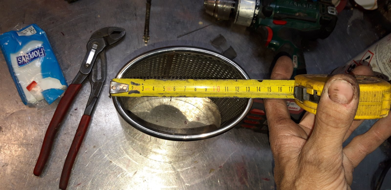

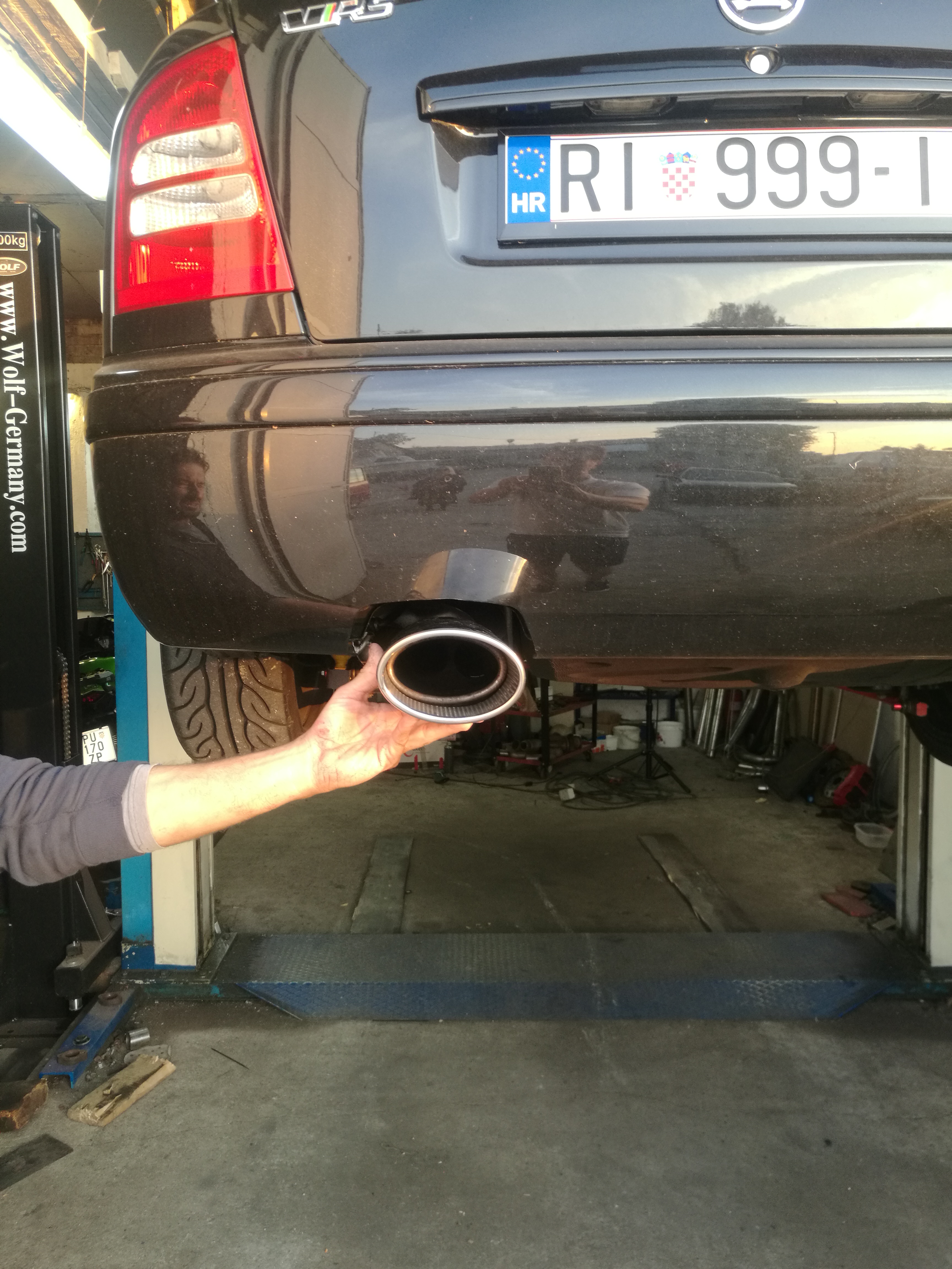

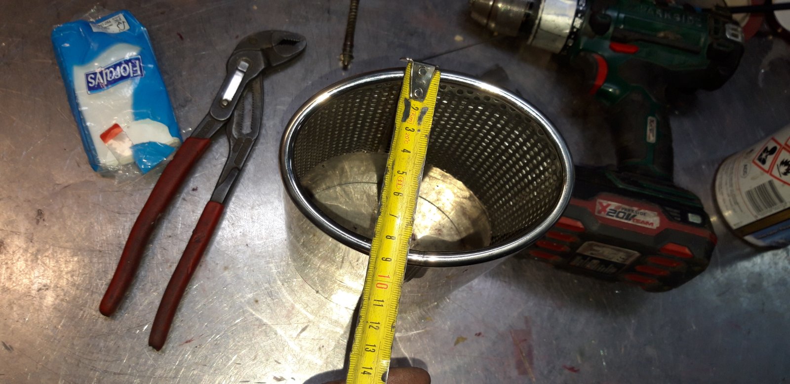

Made same arrangements for custom cat bact v-banded 3" exhaust.
This is the tip I found very nice and suitsble for my sleeper look-similar to original metal series endtips of earlier RS4 and 6.
Do you Like it?
Just for perfect fine tuning. I already bought Bosch water pump 15l/min and New water cooler With tube fin core is ordered. Than when water temp sensor is installed we will test both pumps with both water cooler under heavy load.

like this a lot , your missing out on the mk1 vrs forum :(

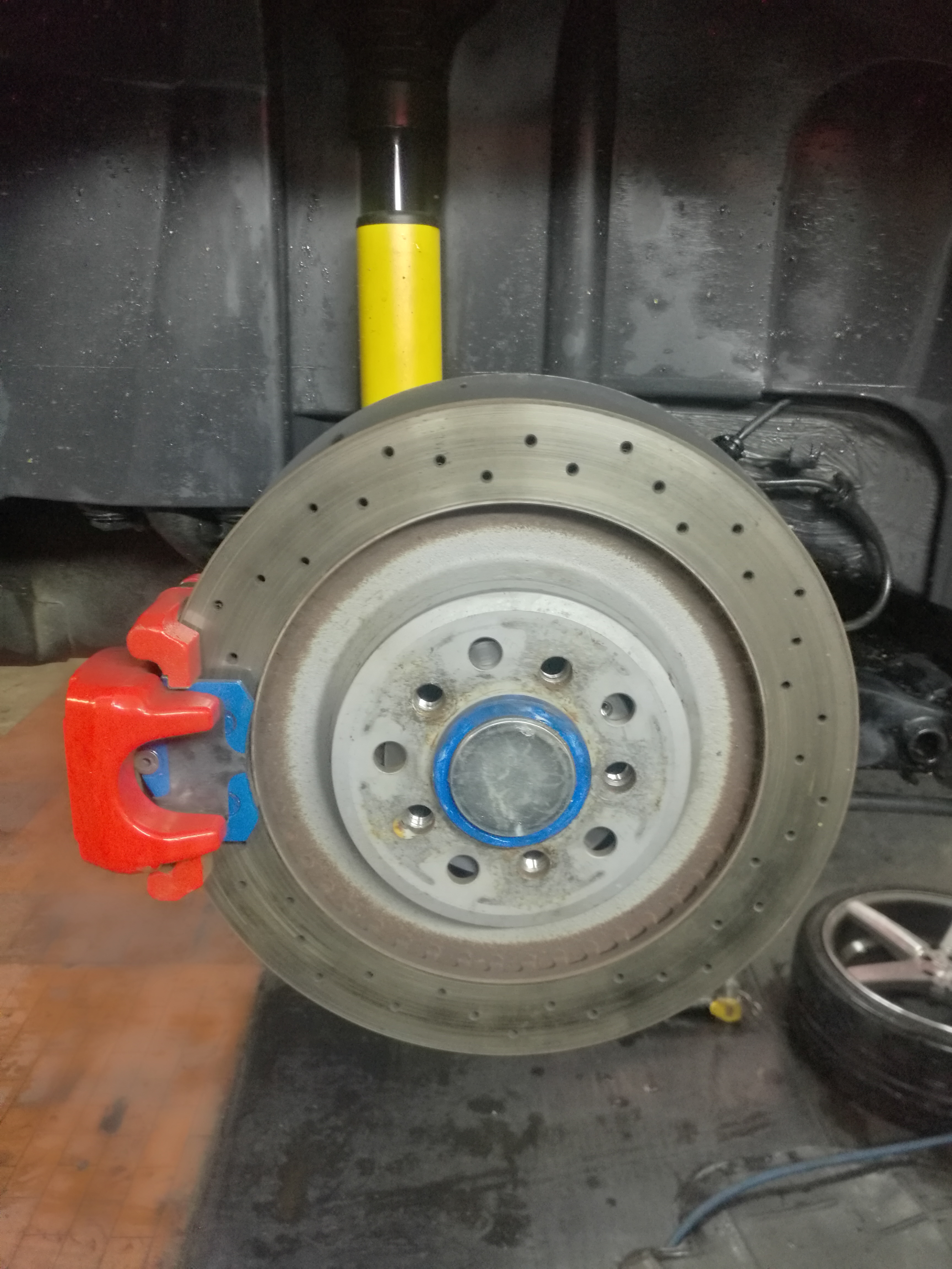

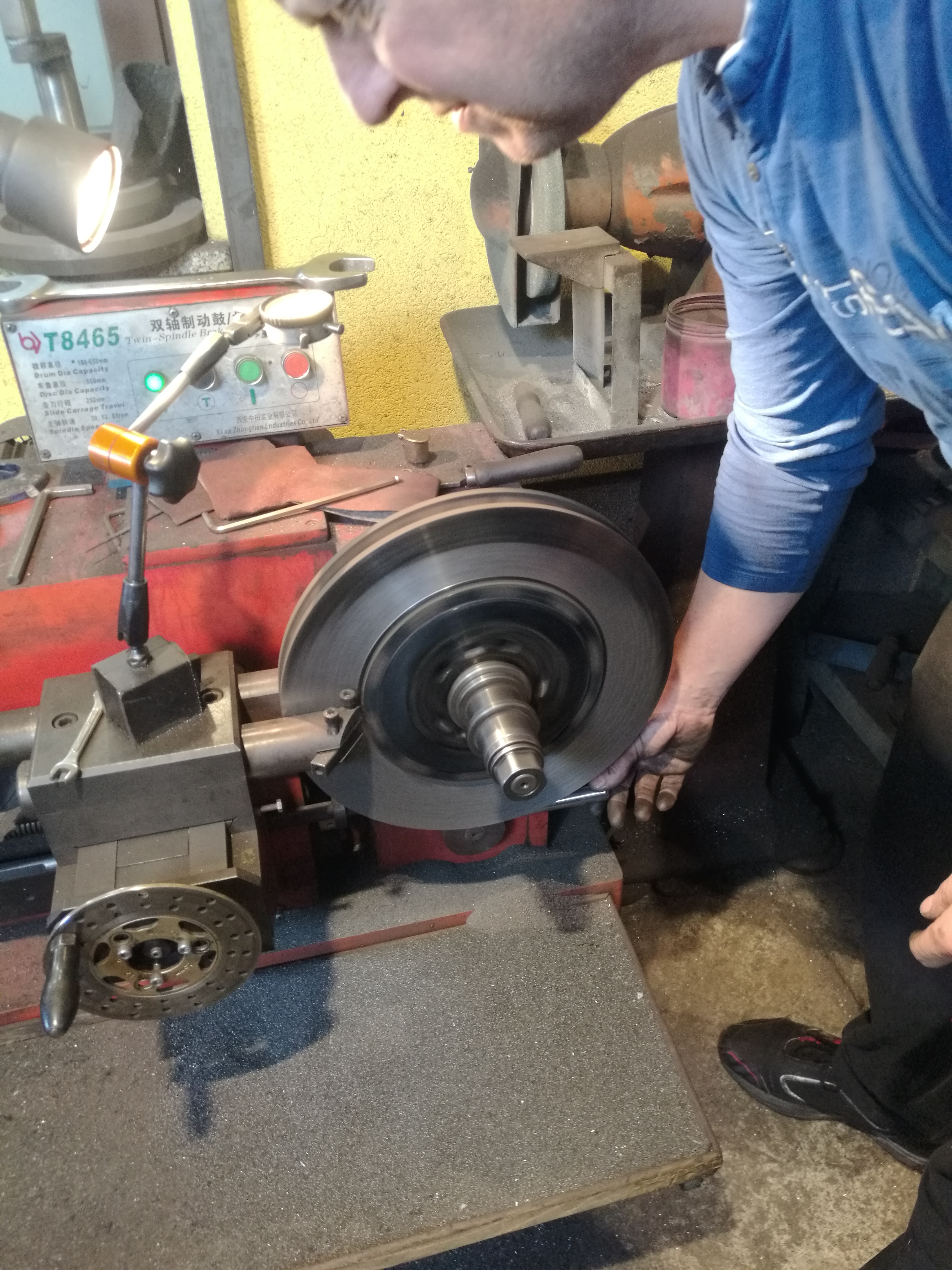

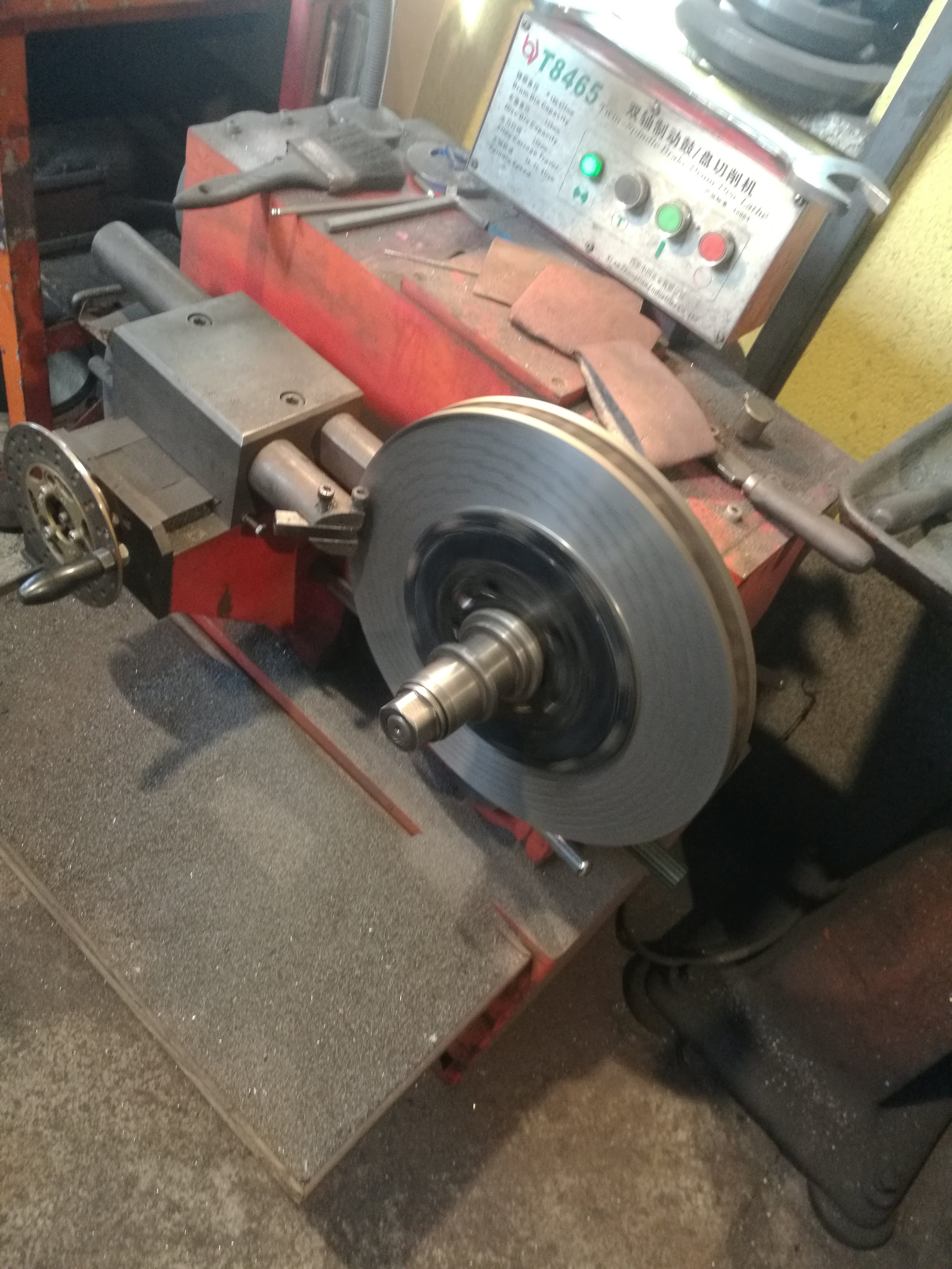

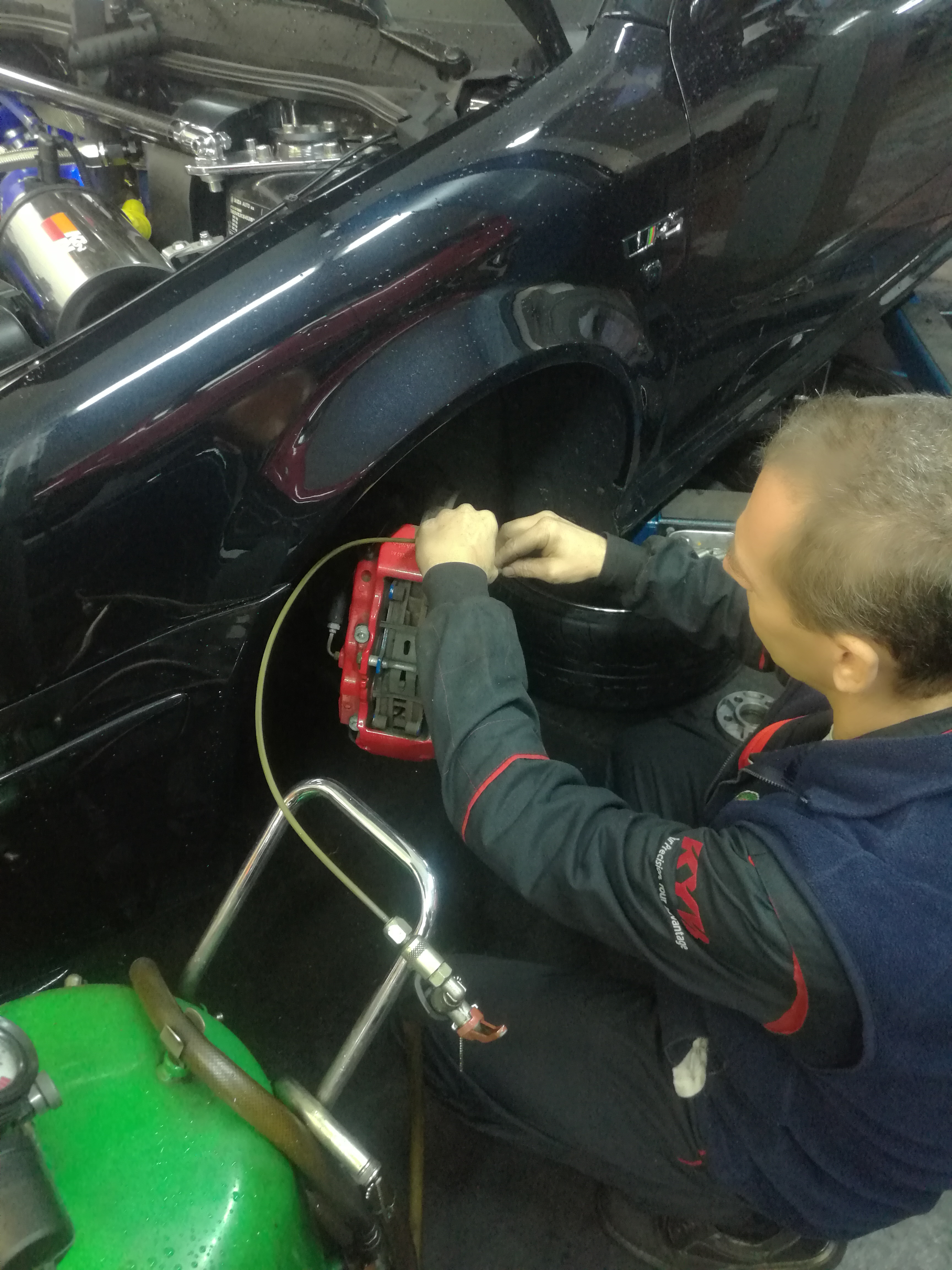

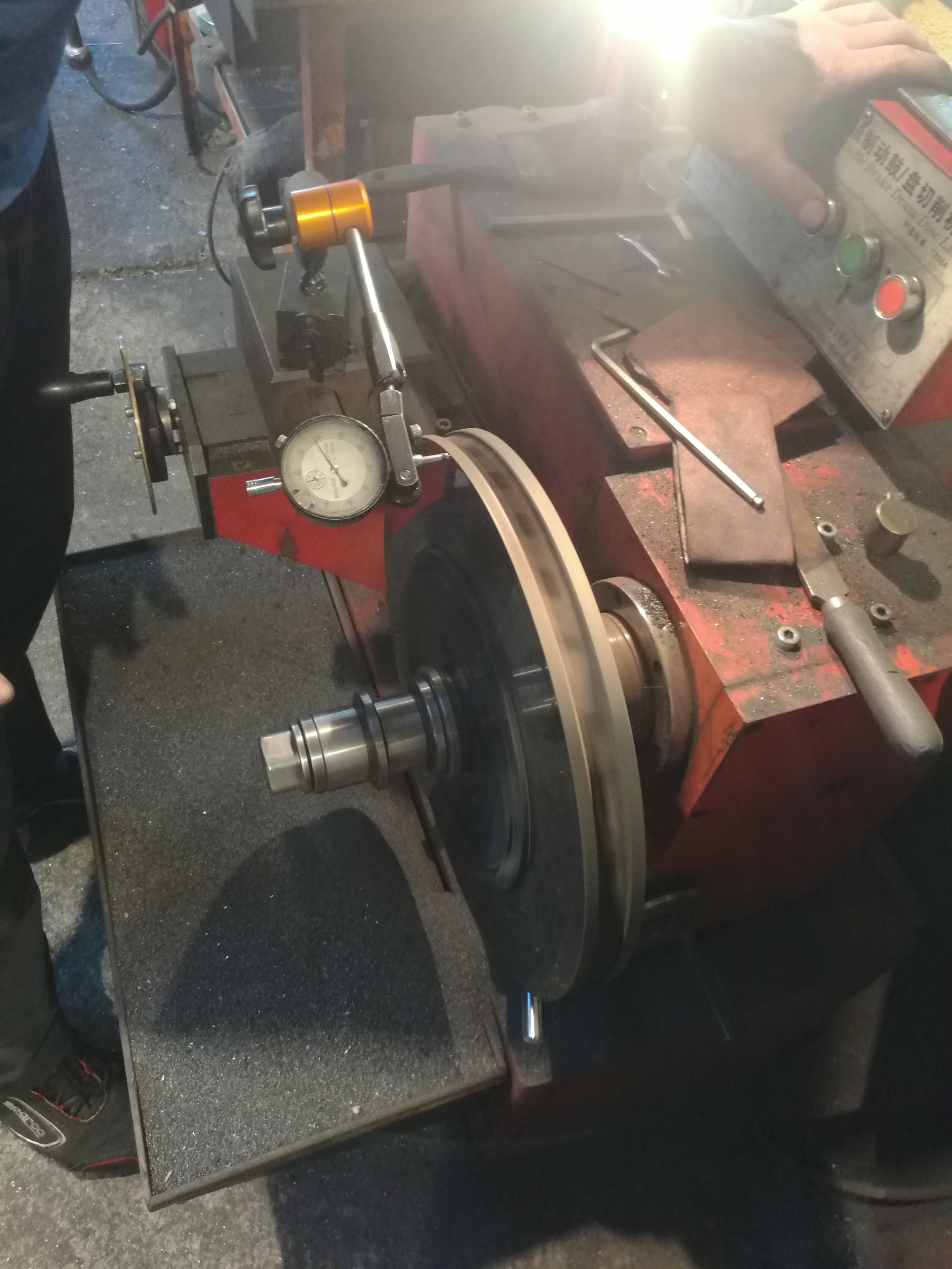

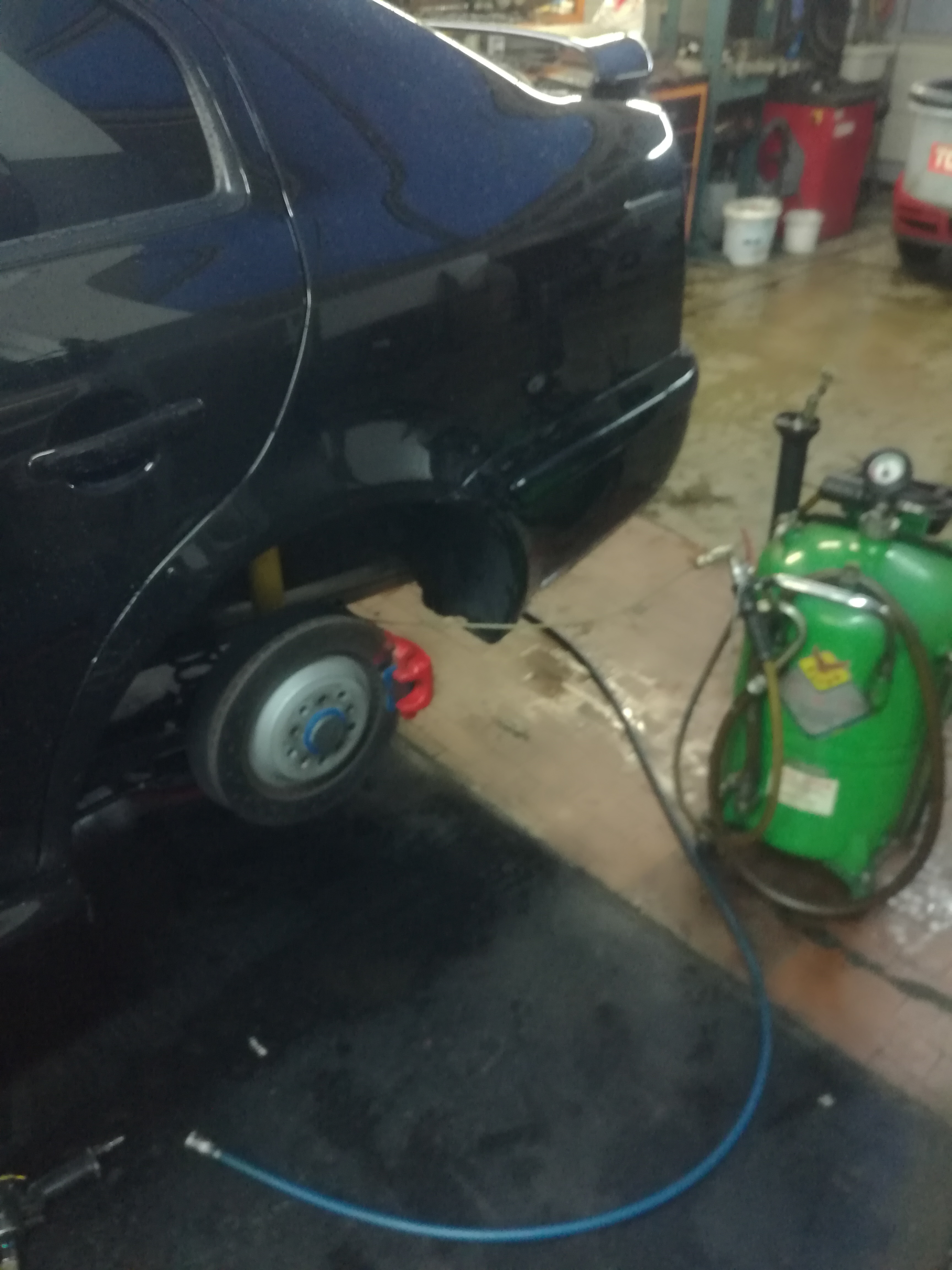

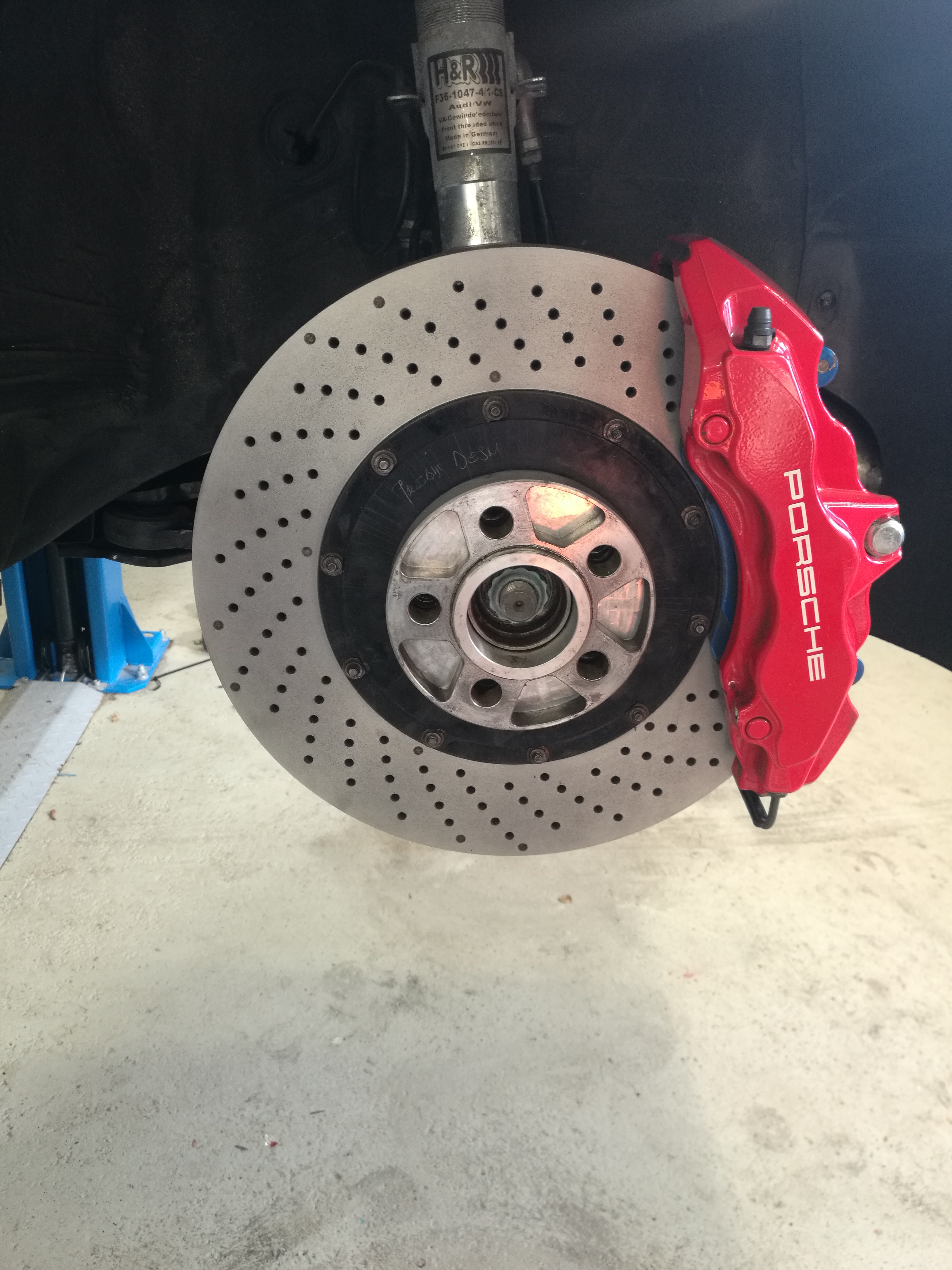

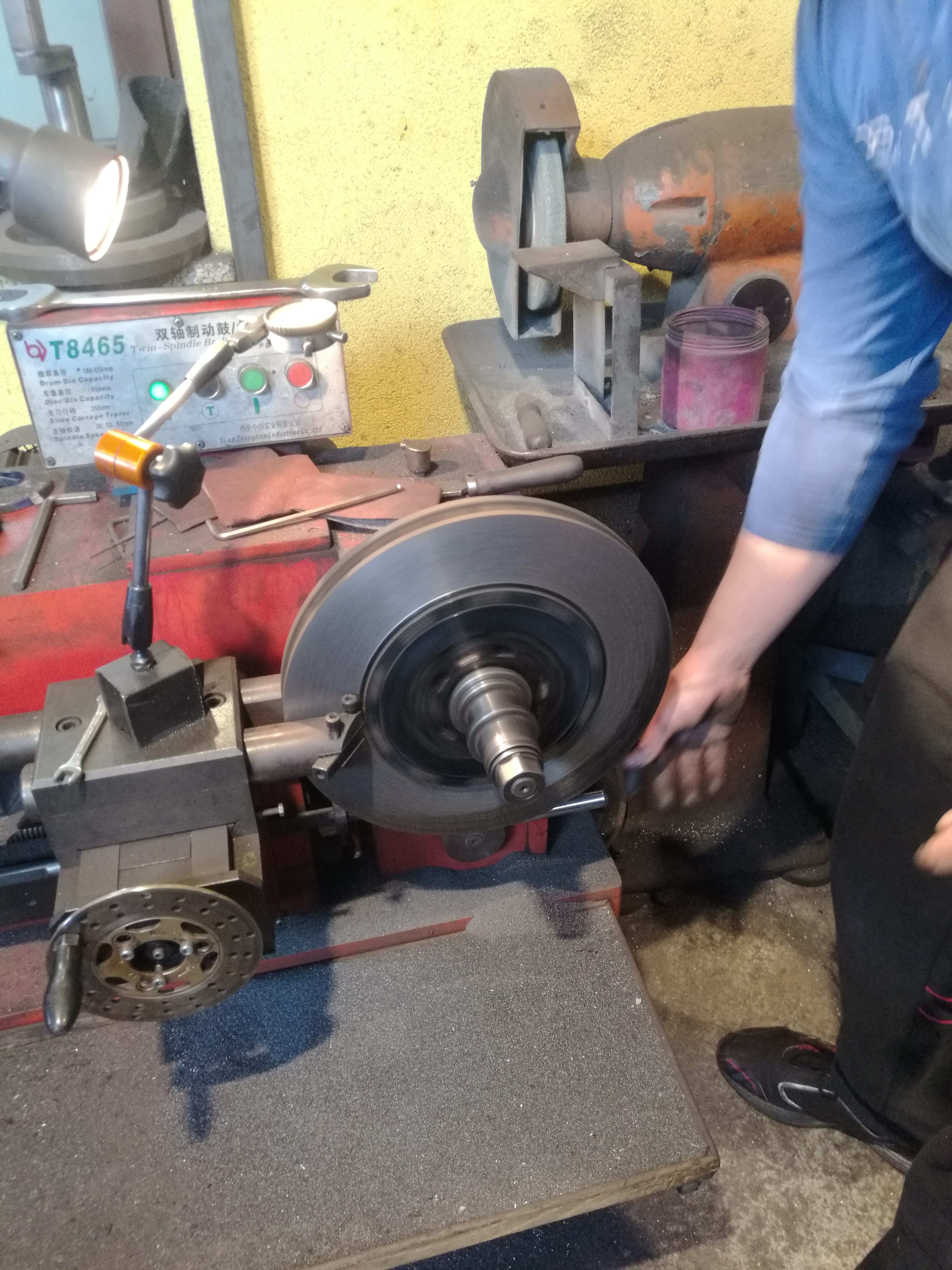

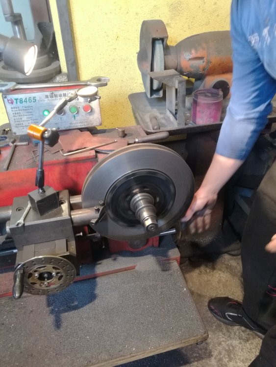

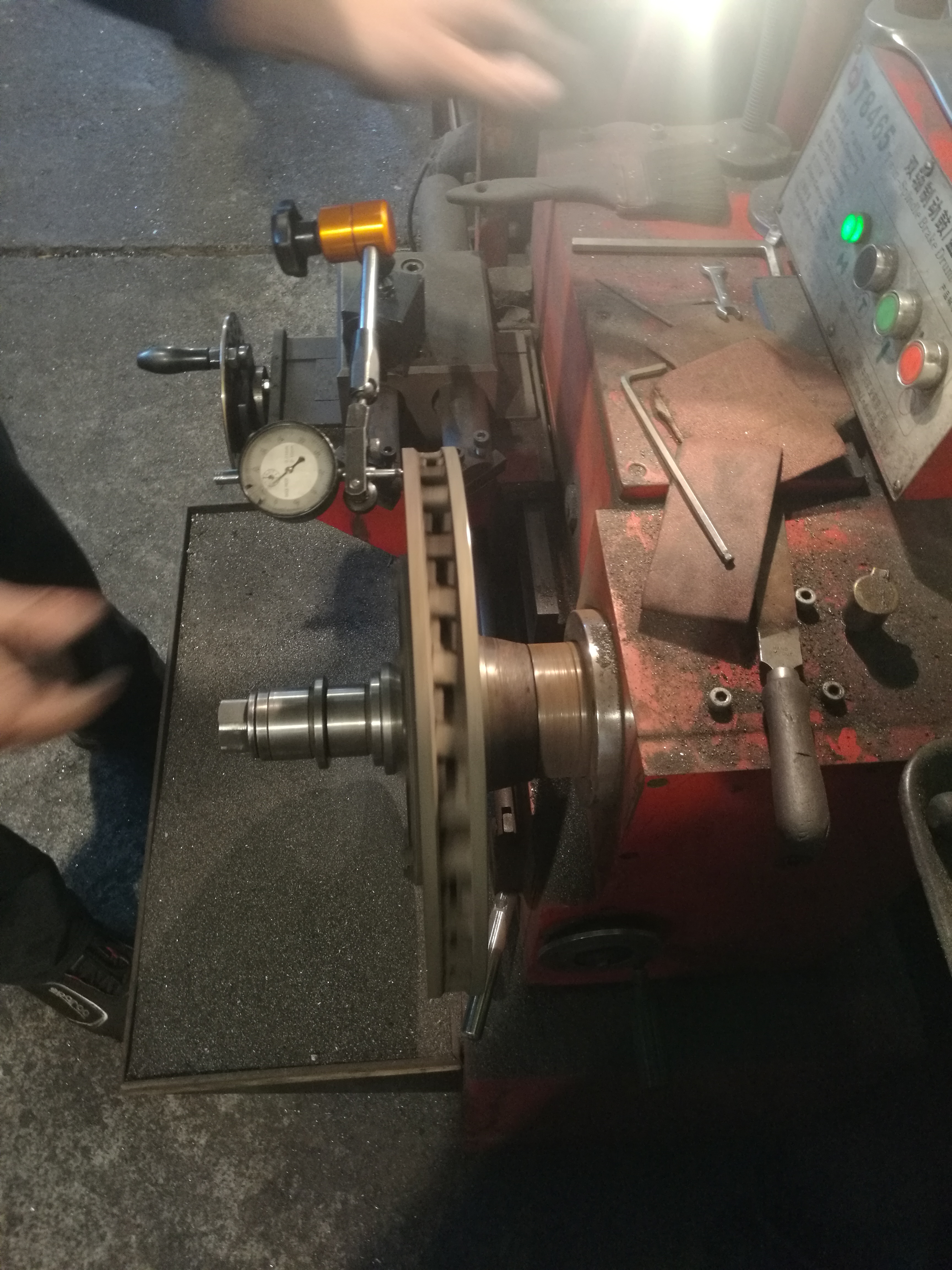

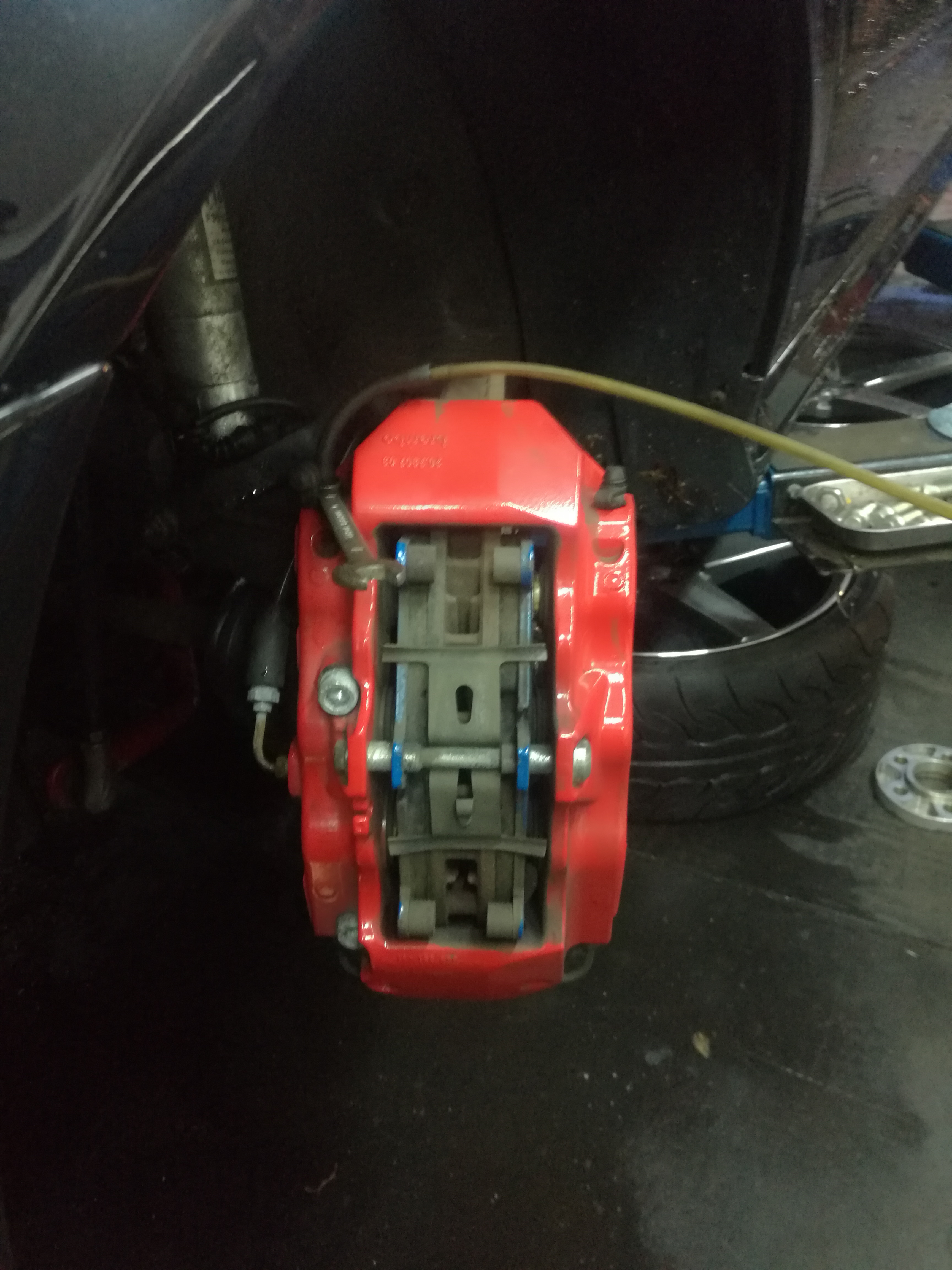

Still had some vibrations with braking, despite the fact I had no collision or damage to the wheels or drivetrain. I took my 2 pieces 350x34mm discs to workshop http://www.ttm-strojna-obrada.hr/ and checked both. We removed 0,12mm from the right side, the one I suffered accident 6 years ago, and I thought left one must be perfect, but have removed 0,5mm on the left one which was curvy on naked eye even. Now there is absolutely no vibrations felt and still left to repeat braking on procedure according to Pagid racing.
Edited by john999boy
Assisted with translation.
love this brake set up
Espetially when they work as they are ment to like now💪💪💪👍👍👍
Edited by davojuri

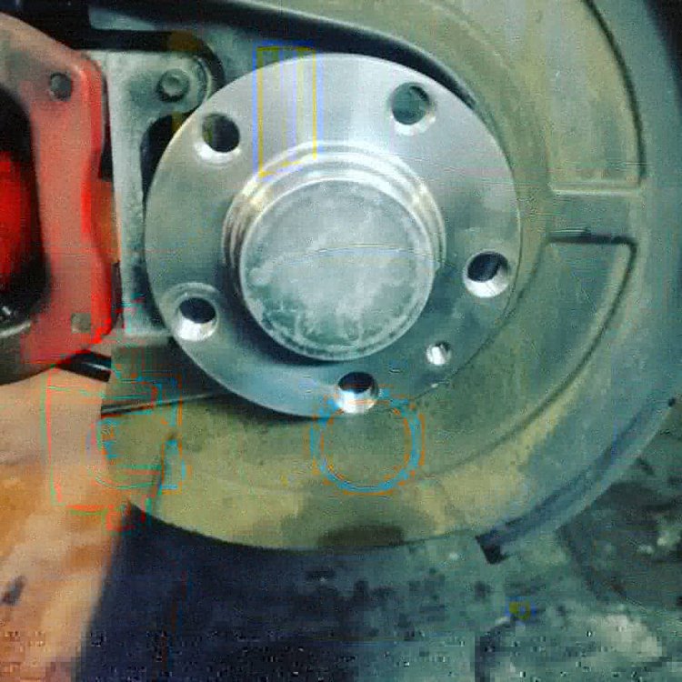

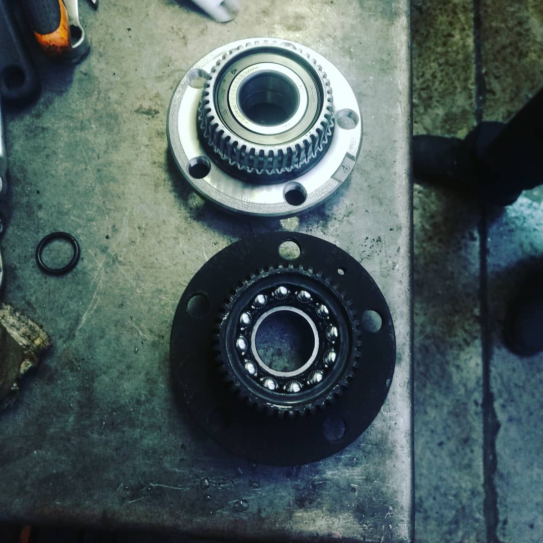

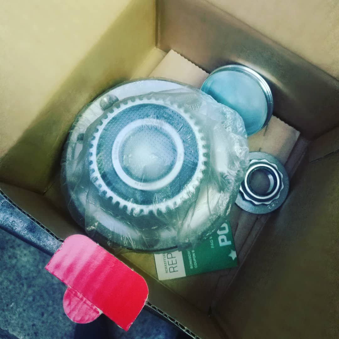

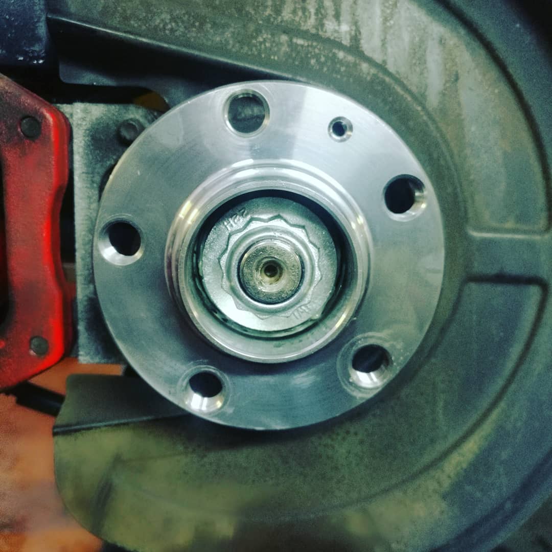

New FAG rear right wheel bearing
Edited by davojuri

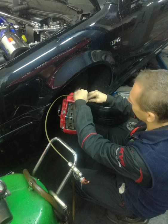

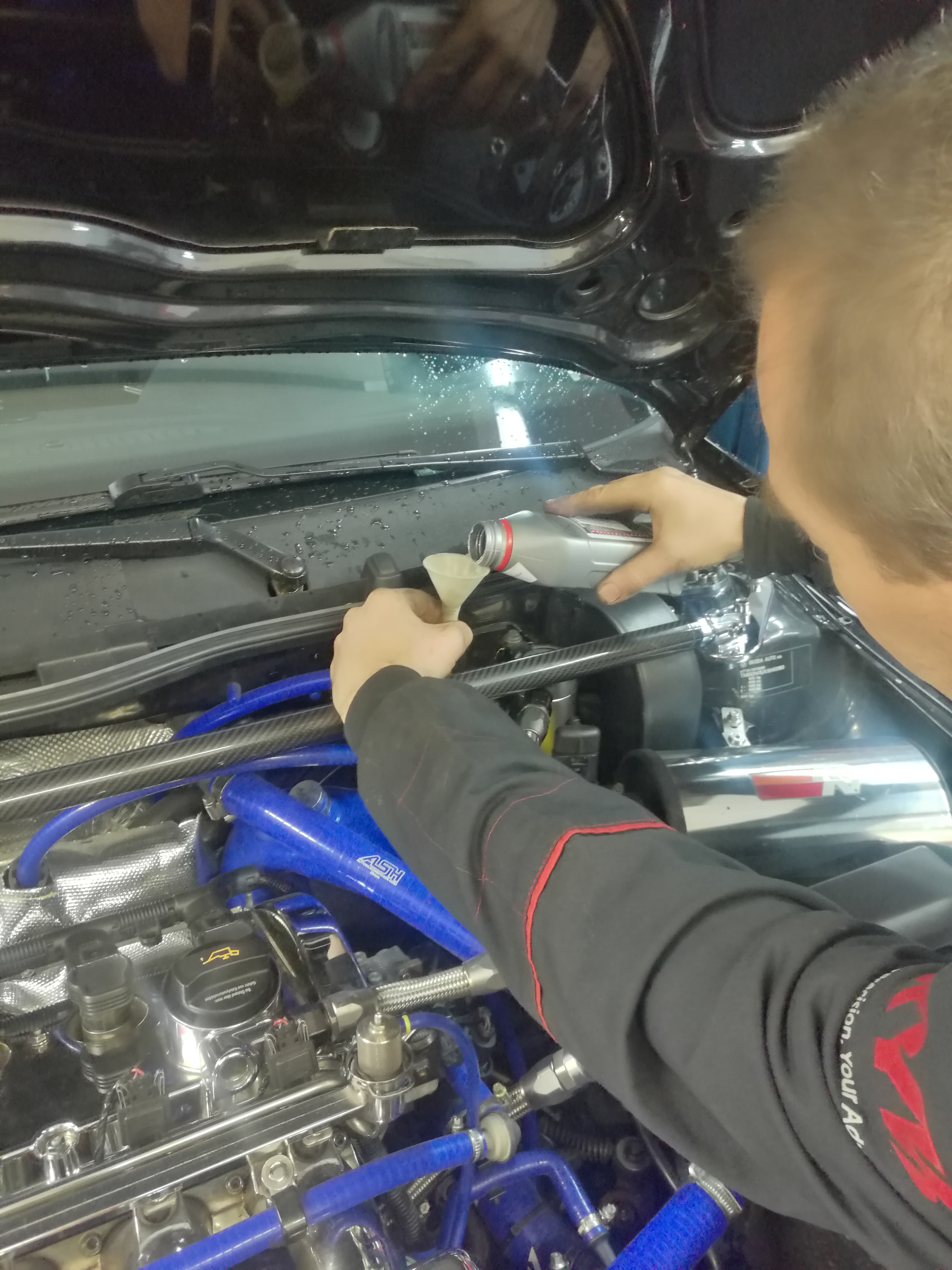

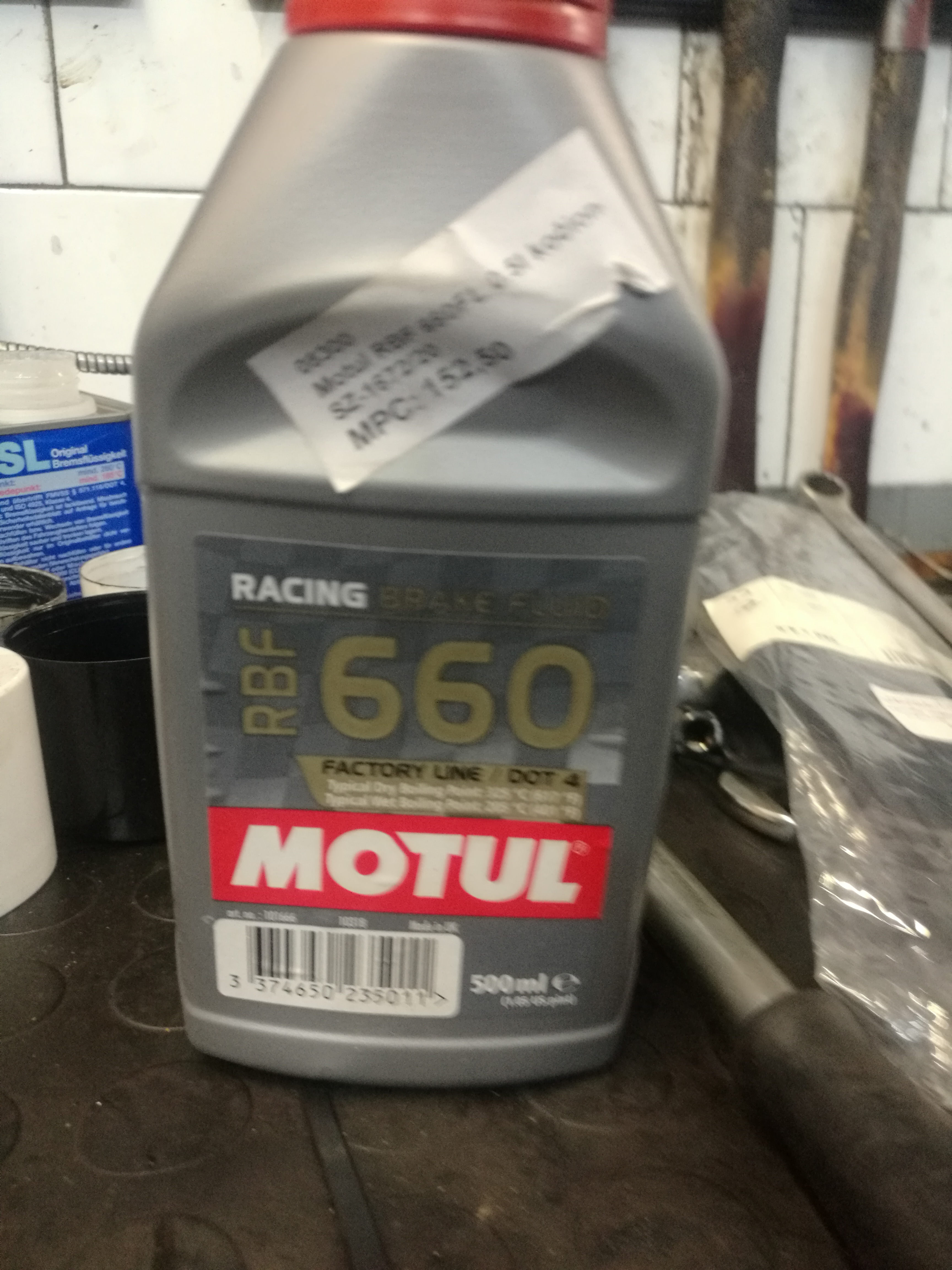

Fresh brake juice- Motul RBF660

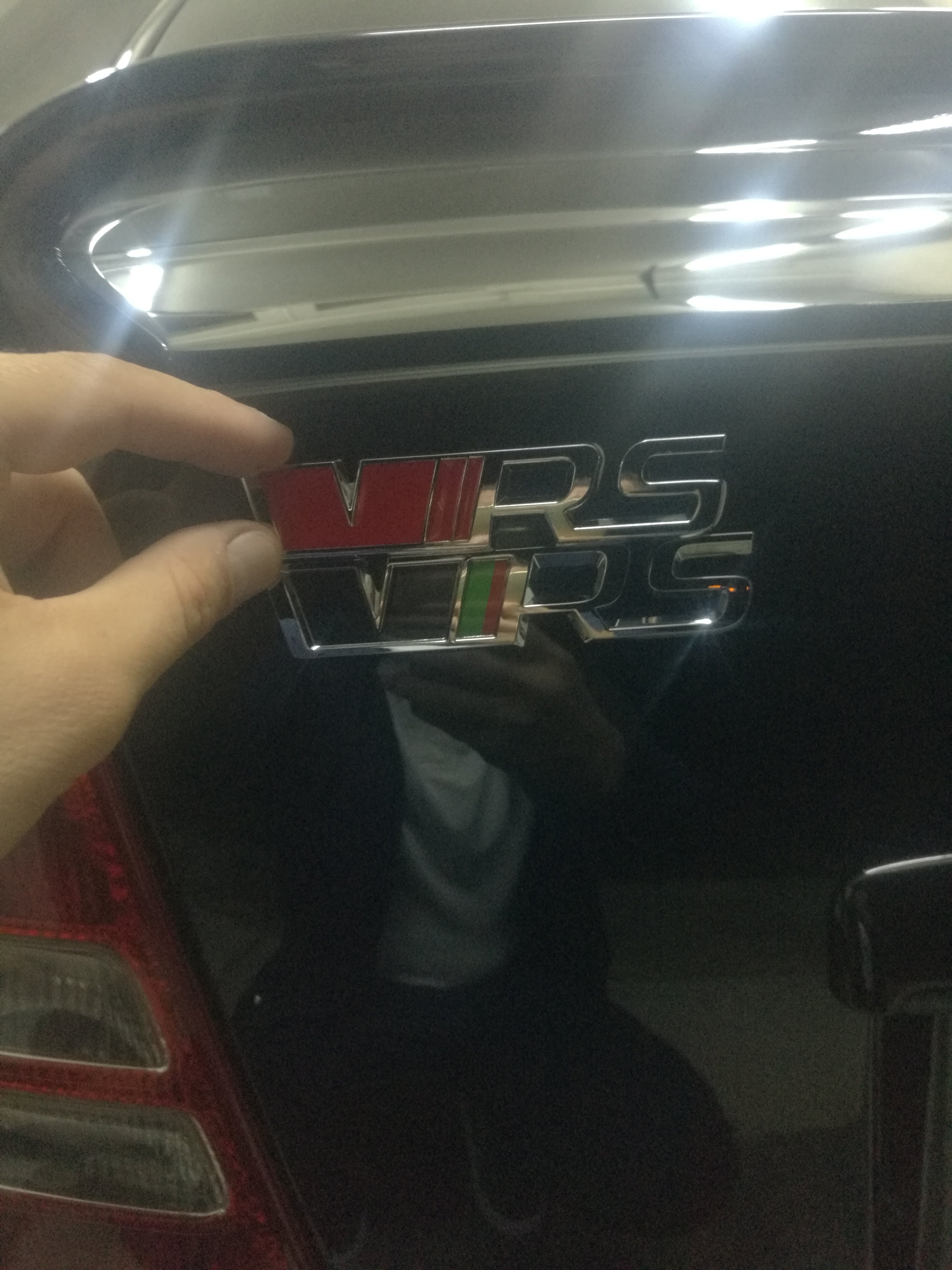

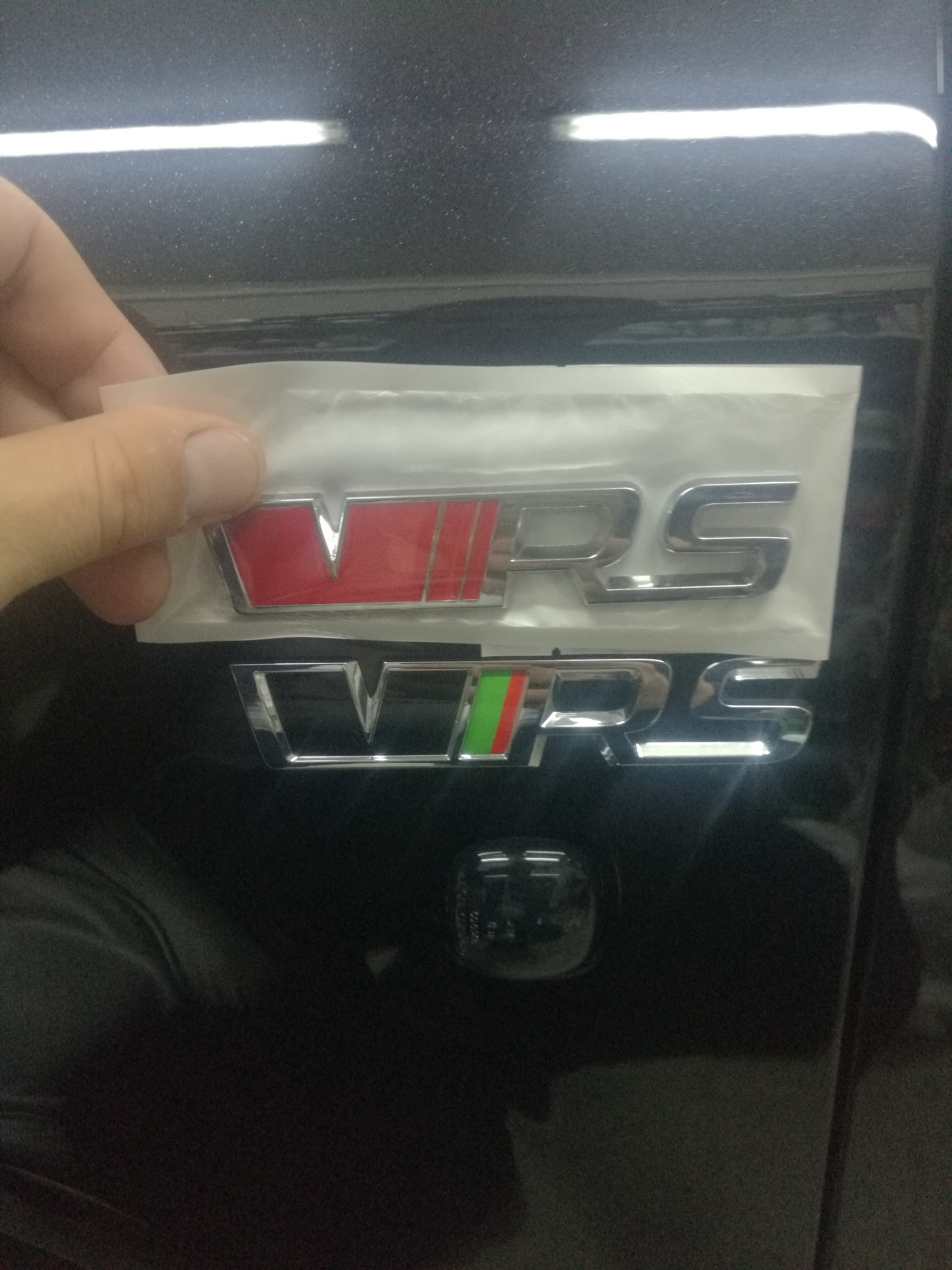

On 22/10/2020 at 08:50, davojuri said:
New or old one?

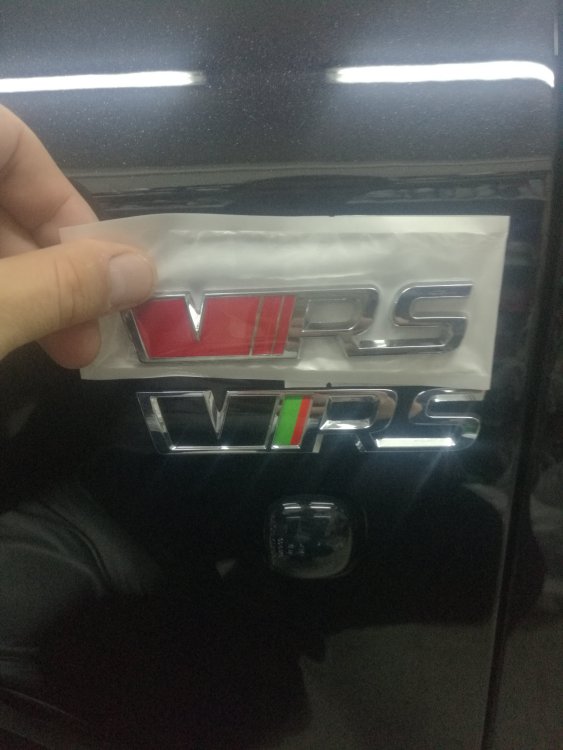

What do You think?
You should go with "Classic" or something else sleeper-alike ;)
On 02/08/2020 at 11:44, davojuri said:
I completely agree. Shame on me

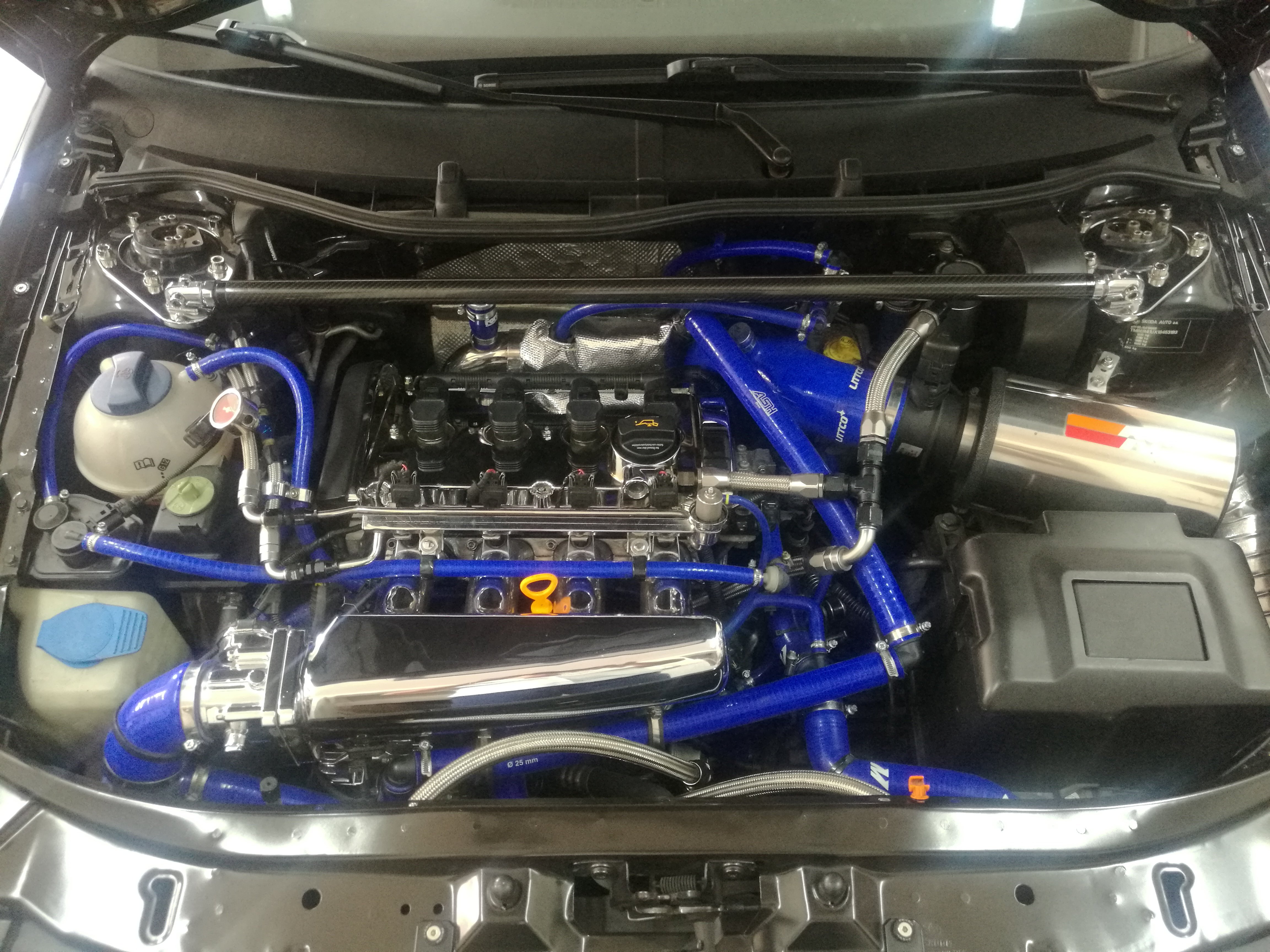

Here are final installed pics
Way betterrrrrrrr😀😀😀😀

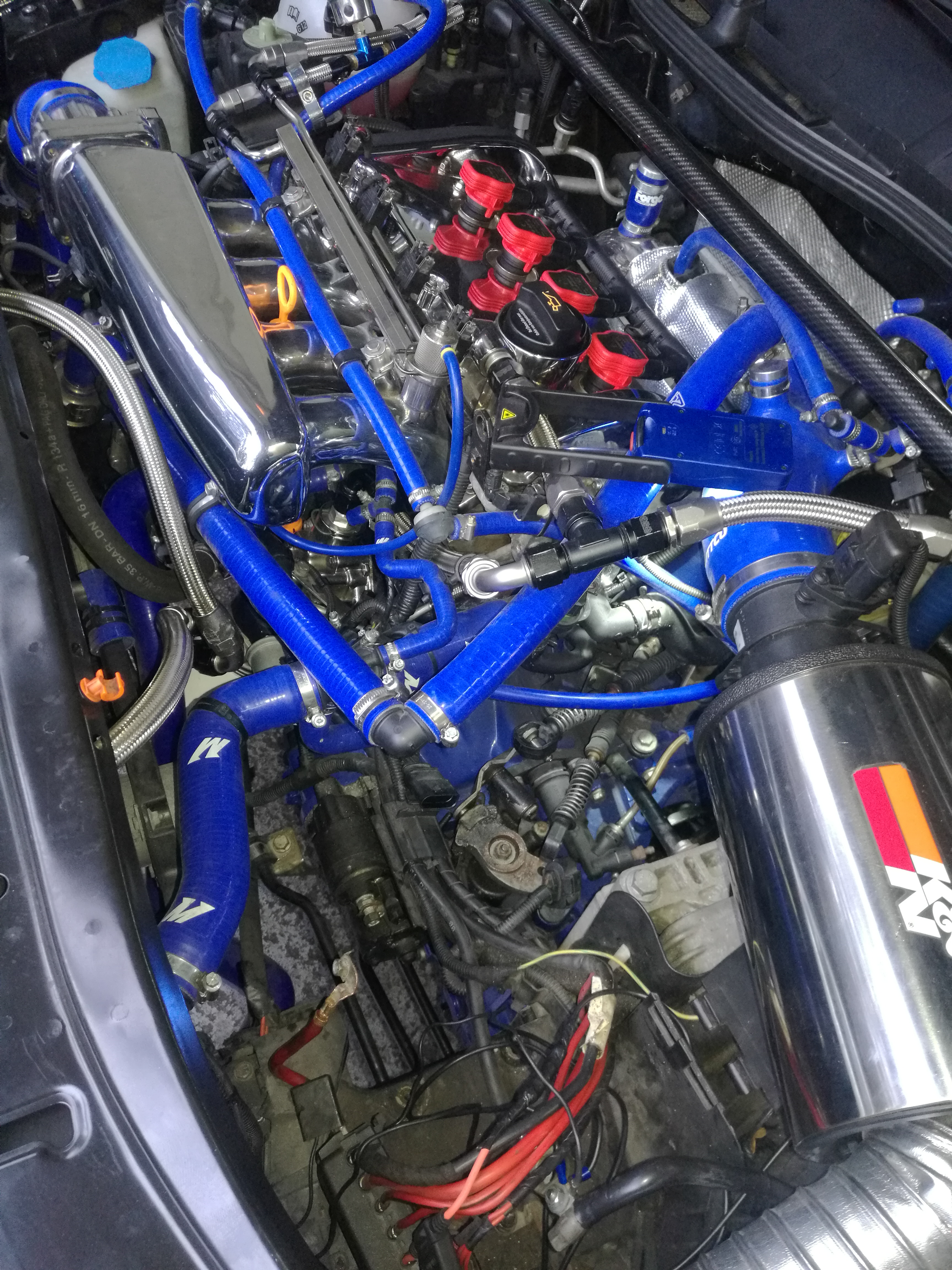

Dude that's one impressive engine bay - is your original post updated with all current mods, or where could I find this? (there's over 30 pages and I just stubmled upon here).
I could drop by Rijeka to meet firsthand and compare with my 1.8T :D How is the reliability? I'm struggling with the "little princess" nature of the engine.

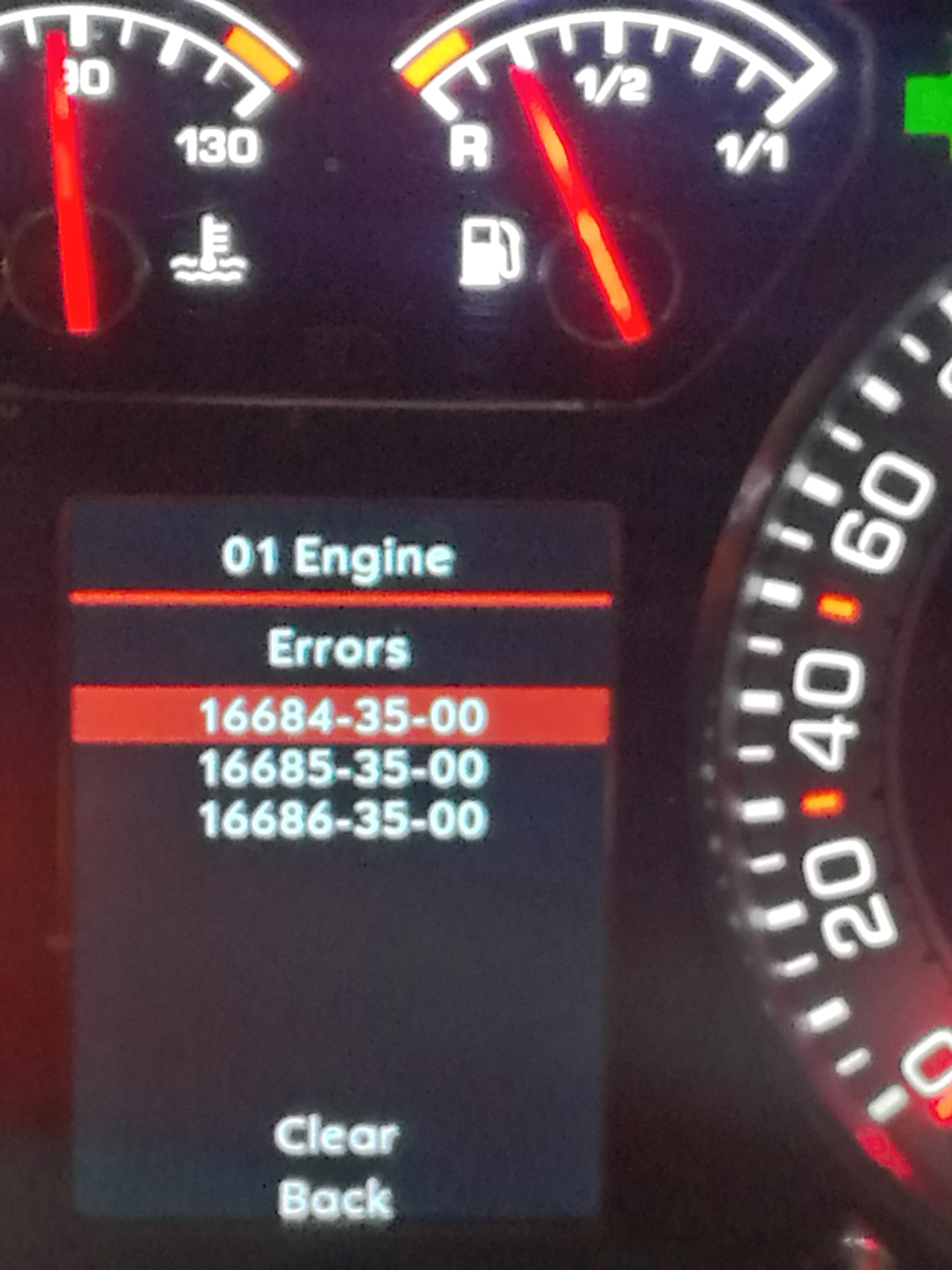

You're most welcome. Mine works perfect. Had two issues-misfire on cylinder 3. I bought used Okada plasma Projecta coils from NZ and that one burned out on highway-replaced them With old OEM ones,last revision-started throwing error again a week or two ago. Replaced Denso IK20TT (from 3.2019) for NGK IRIDIUM BKR7EIX-11 gaped from 1,1mm to 0,75 as bdger5 suggests. But it wasn't that. We couldn't unbolt sprk on cylinder 3...some small plastic bits from burned coil  were left. Now flawles-no error. I even ordered OEM R8 coil adapterd and looked around for R8 coil 06E 995 115 G-latest revission. Now i hawe only left to correct wheel hoops s on beggining-probably my rear dogbone mount is gone-has more than 10 years of abuse. So I ordered Superpro one from uk to pair it with front superpro one-best design on market compared to others which deform due to the poor design.
Ofcourse all new bolts are ready.

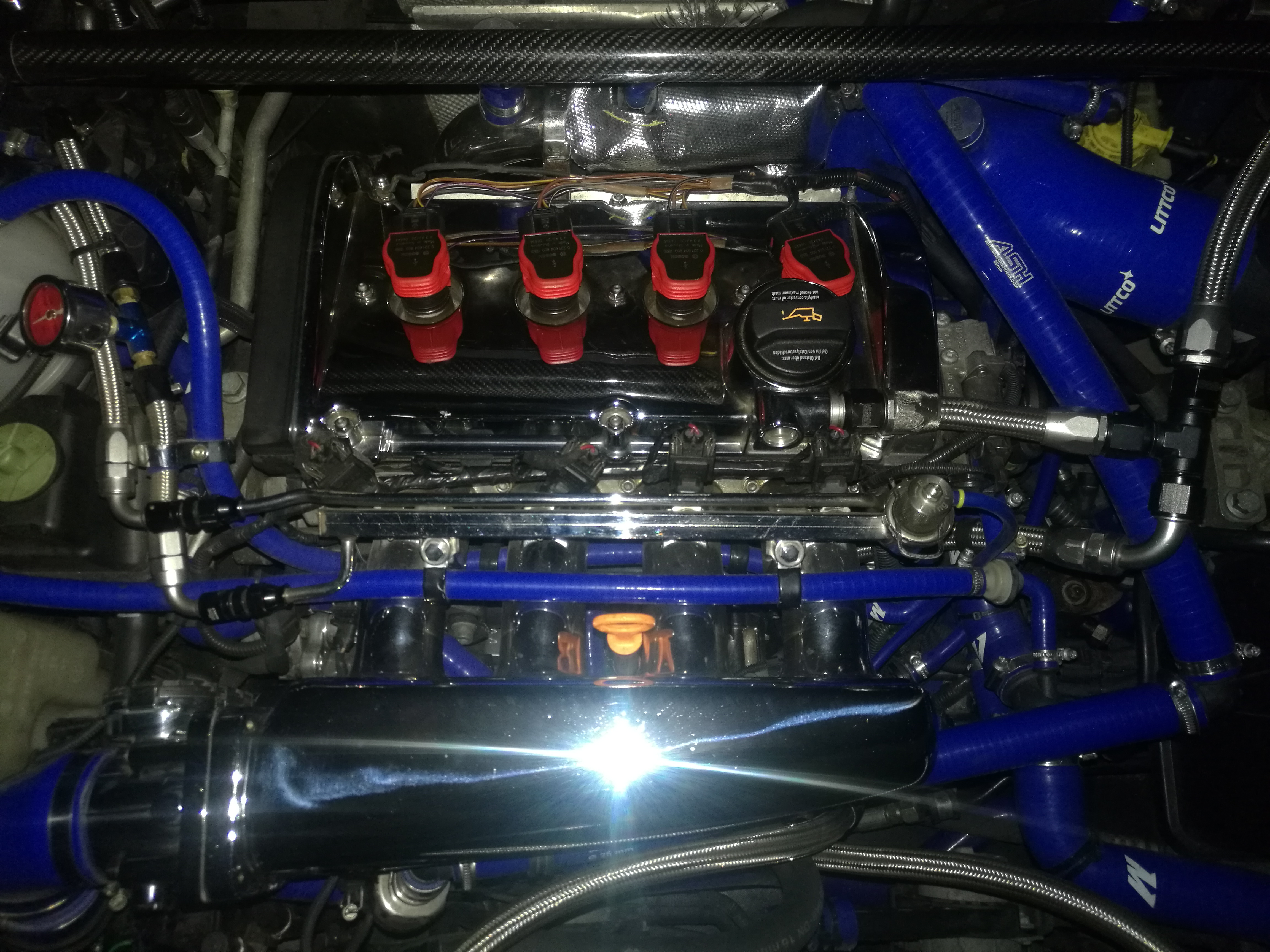

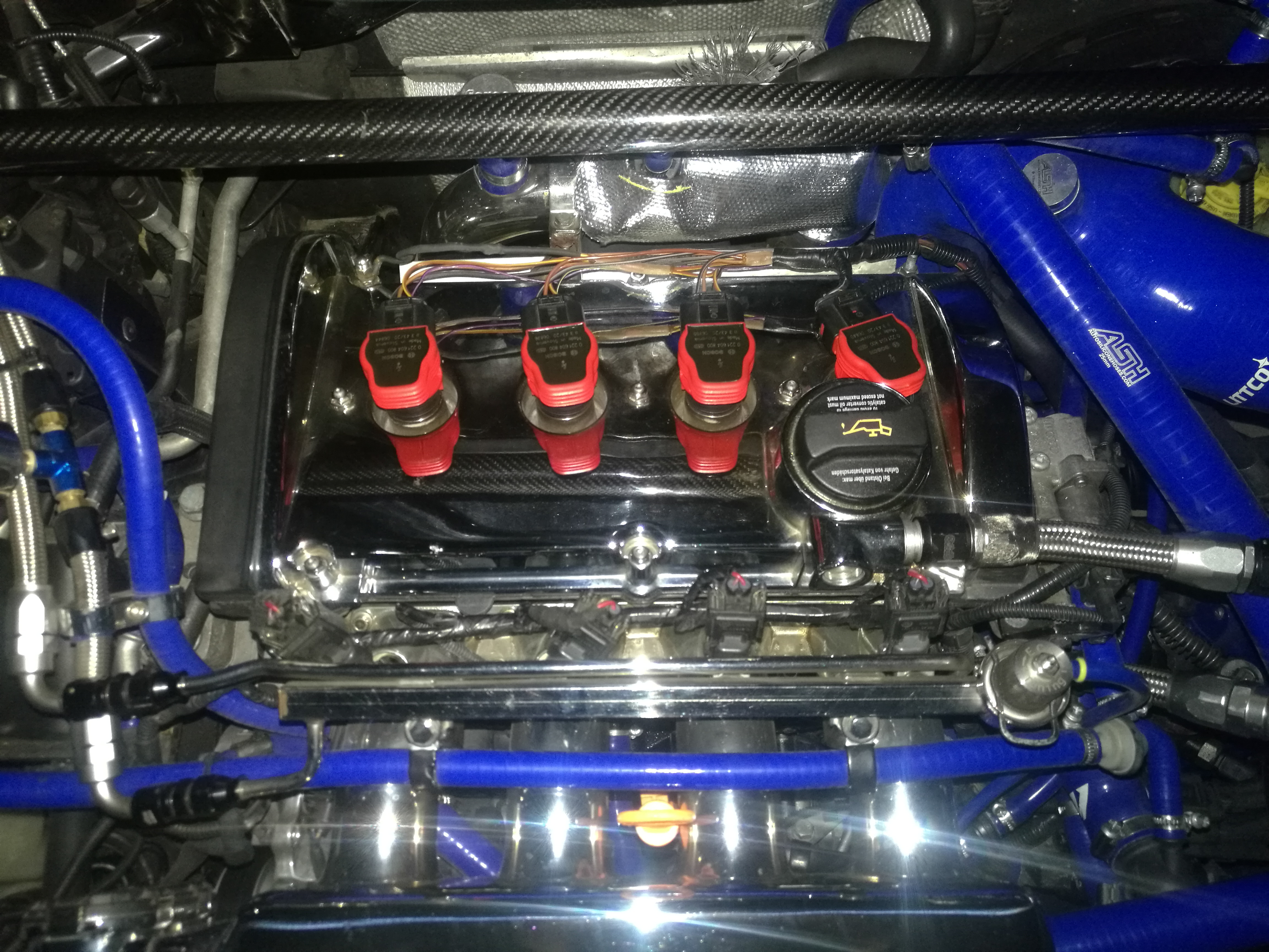

That's the same annoying misfire issues I had, also cyl 3 and 4. After my remap to 210hp, two original coils failed, fitted new BERU ones, they physically broke after one (1!) day, fitted then the NGK R8 ones and misfire went away - you should have went with NGK immediately. Didn't sleep for a month with these sheeiat coil packs failing all the time.
I also have the exact same spark plugs Denso IK20TT, those are for LPG cars! Why did you go with them? I still have very very rarely a misfire under load - I suspect these sparkplugs. Will fit the NGK's you mention once I get the time.
Didn't catch the part - your octavia is 4x4??? From my 1.5 years of finding the right 1.8t, only one 4x4 popped up, it was perfect on the ad, in reality it was the worst 1.8t I've ever seen, so sad, I even had the money on me but it wasn't worth even 500€, car for parts/junkyard.

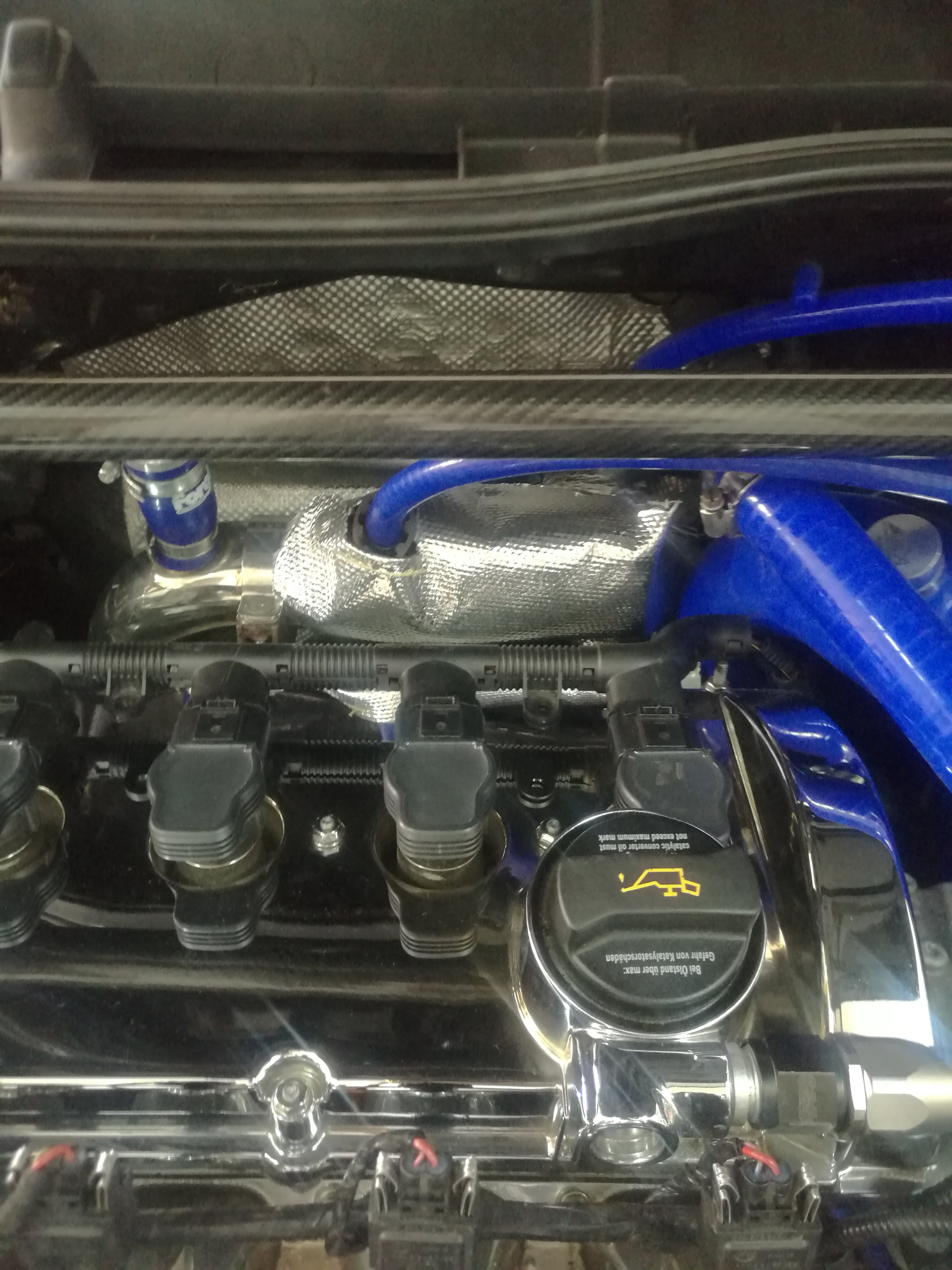

After New Spar plugs NGK BKR7EIX-11 IRIDIUM I still fit misfires on cylinder 1 and 2.
Now Just Got New Bosch coil plugs for Audi R8 latest revision 06E 905 115 G Didn't drive much but for now it seems problem solved. Will test more in upcoming dys to be sure. Hope that's iz. Badger5 reccomends that coil also.
bay looks epic and i love the display :)
Yes,thanks nam. Still left to grind a little cylinder coil 4 to stay in Line With other coils,and to Mount back tfsi wire plastic cover so they are not so ugly exposed.
But yesss I Like it more and more With time pass. Definitelly my choice of engine bay With all the respect to all other tastes

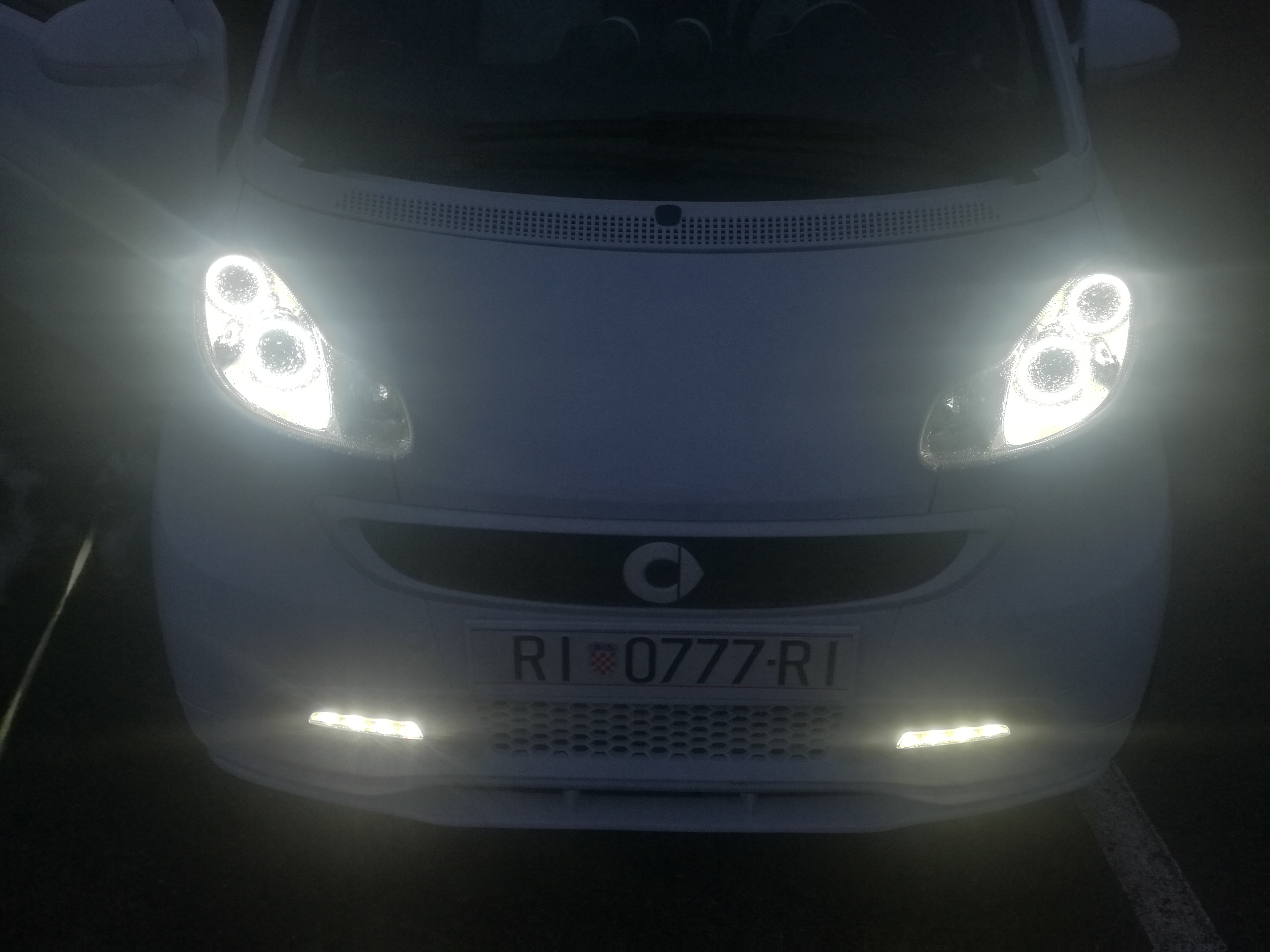

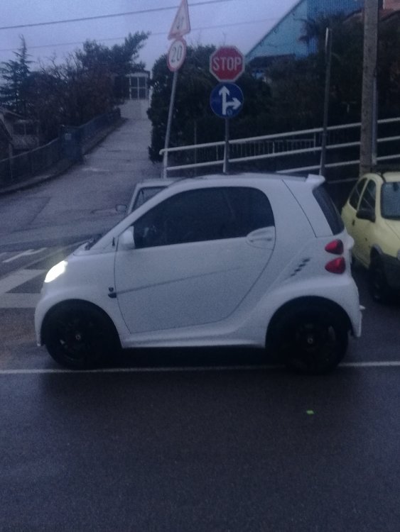

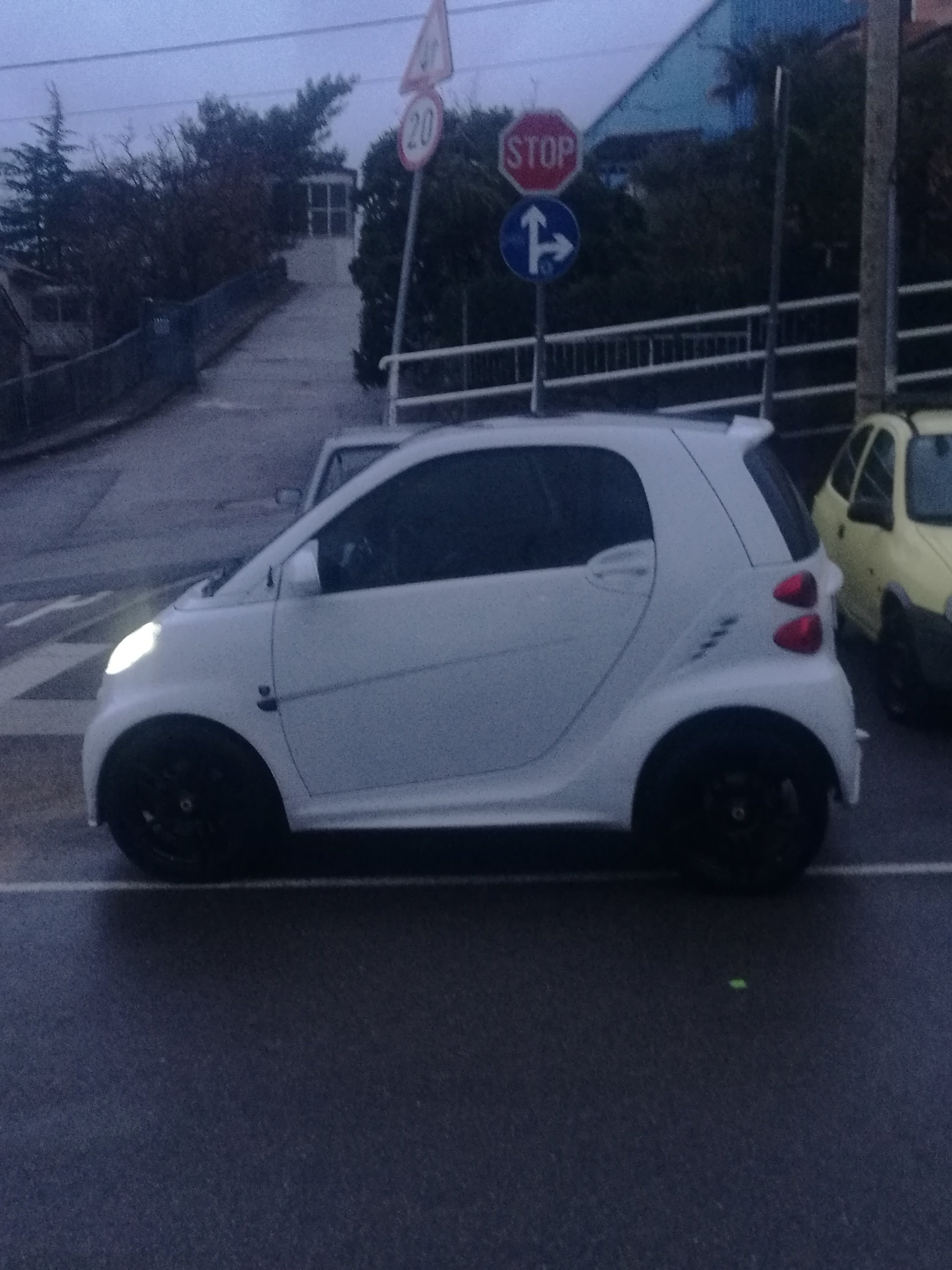

Just got my Smart 451 headlights finally done,  and all the black parts on the side and above rear window painted in white together with real carbon front spoiler. Top!
That's also heavy moddified car to. More to come-145-180hp!!!

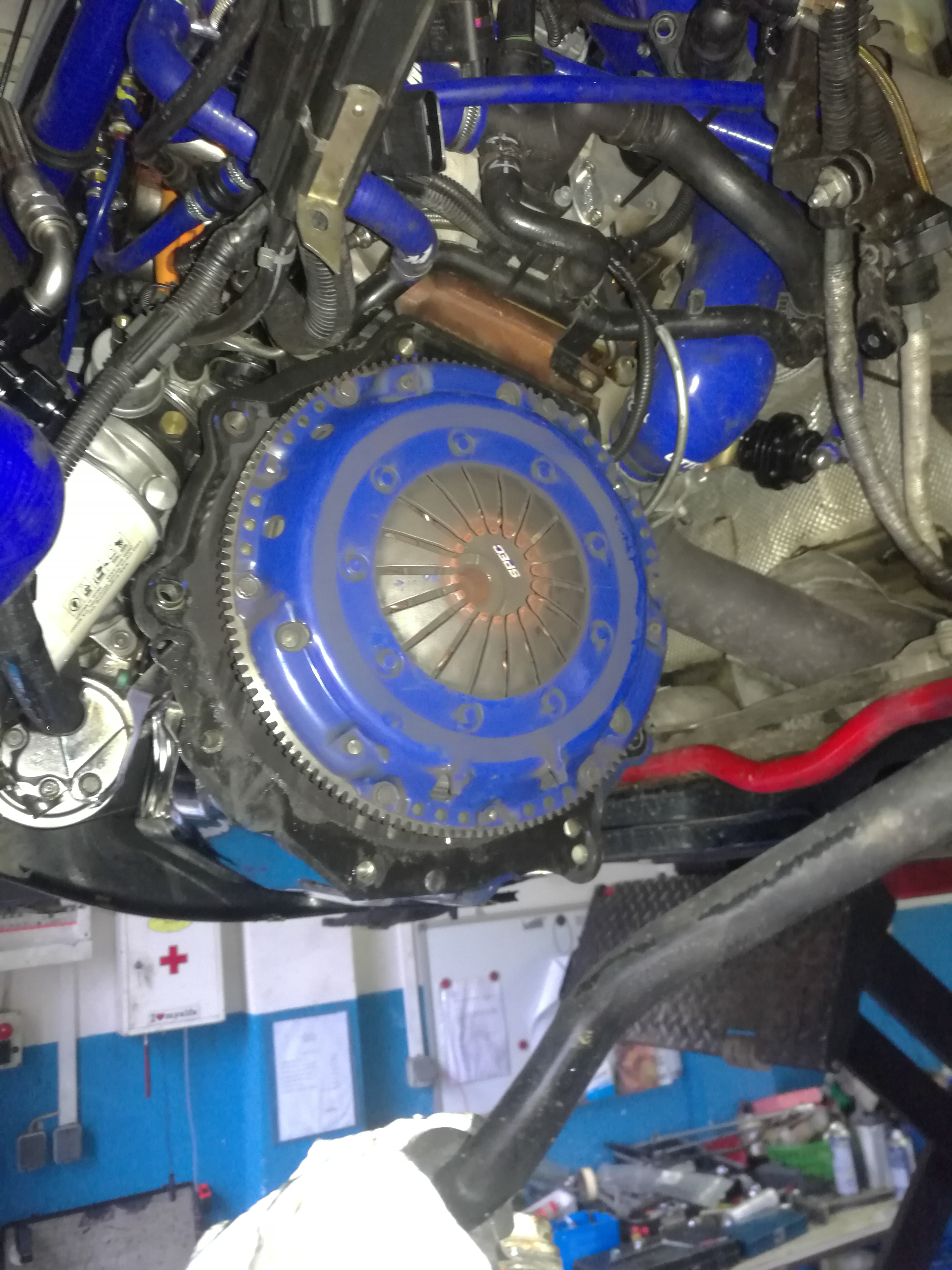

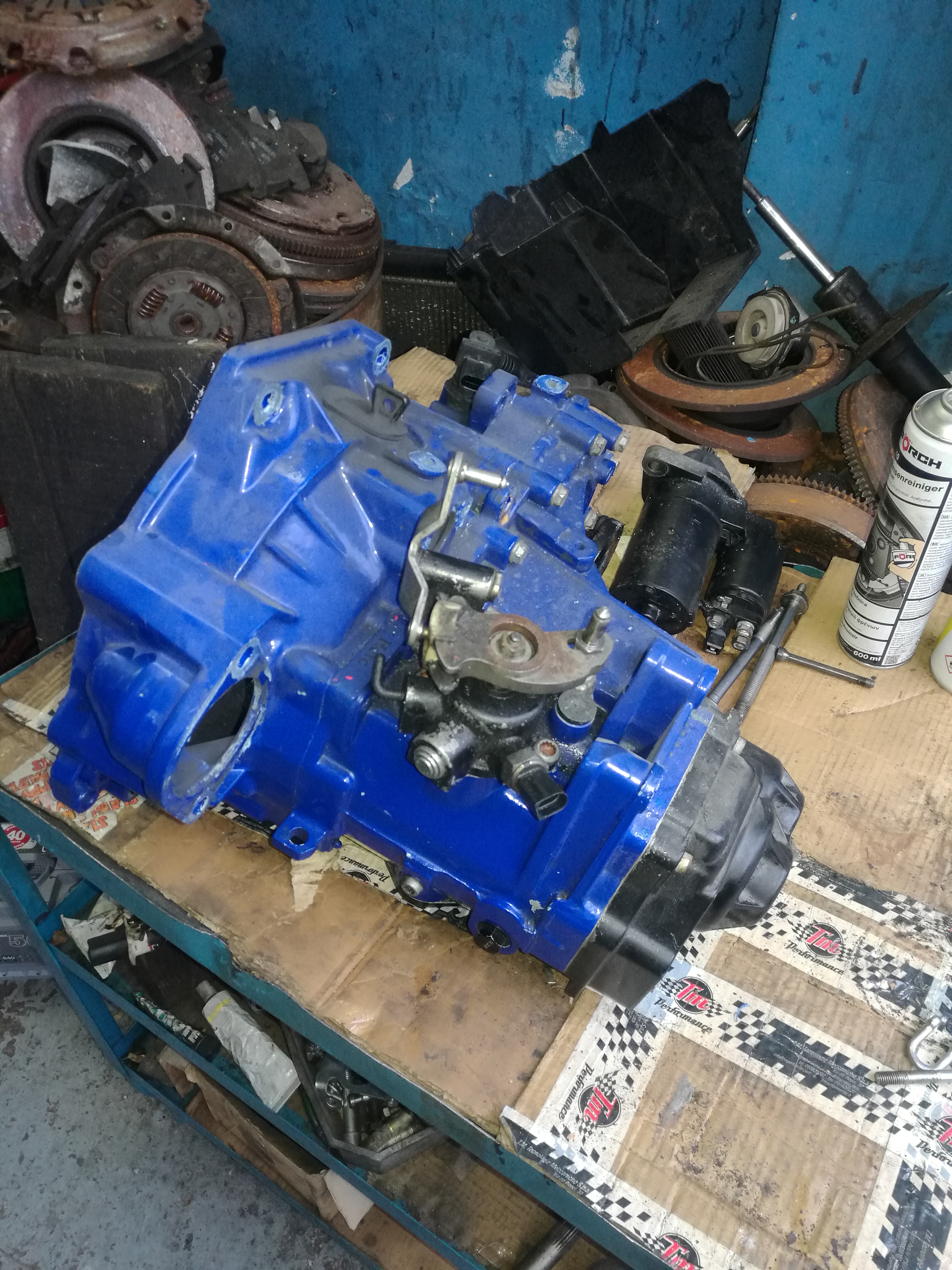

Due to the vibrations and rpm increase  while vibrating during throttle I remowed gearbox and clutch-time for new SPECSV363F STAGE 3+, flywheel resurface and gearbox overhaul while taken of. Clutch has more than 10y and gearbox has been last time serviced 2013 when changing also 1st and 2nd for custom ones as 3-6 already were. More detailed update to come, espetially how to resurface flywheel in proper way-meaning friction plate surface together with ring gear to pressure plate surface, and not only friction plate contact surface as my custom gearbox mechanic did than. Now I gattered exact proportions-height of both surfaces from factory so I can exactly replicate it.
Edited by davojuri
