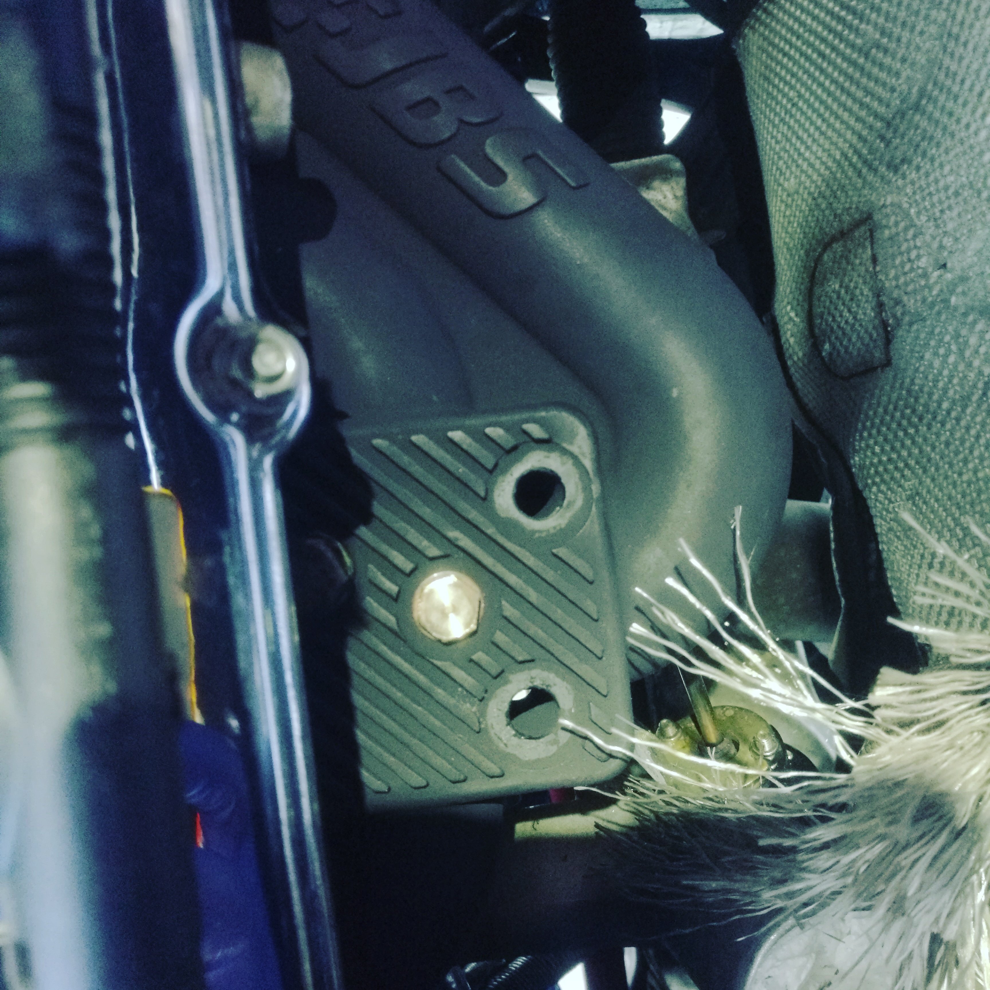

JBS AUTO DESIGN manifold ceramic coating redone and provision for egt probe made

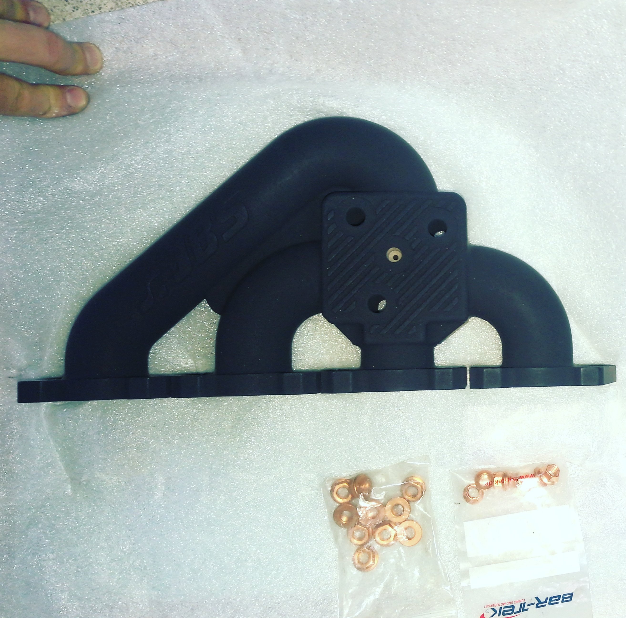

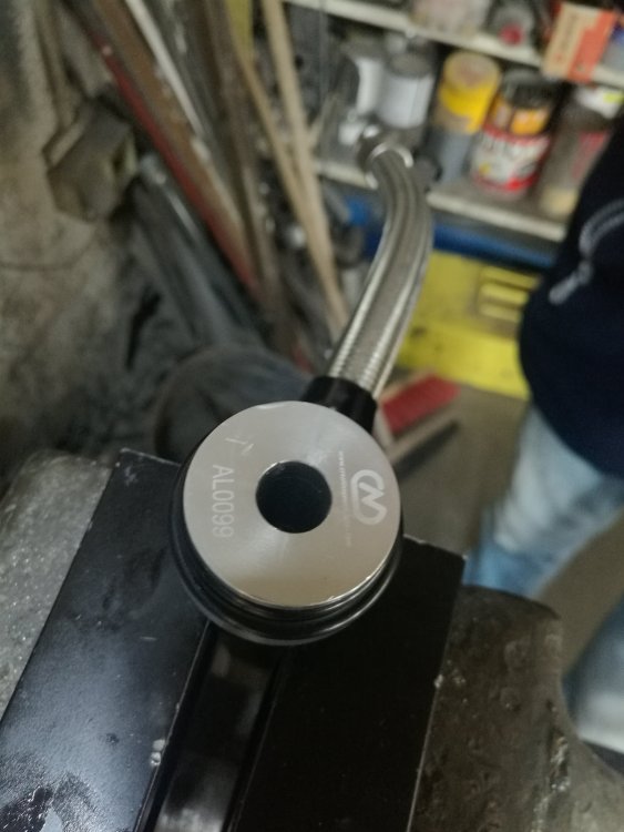

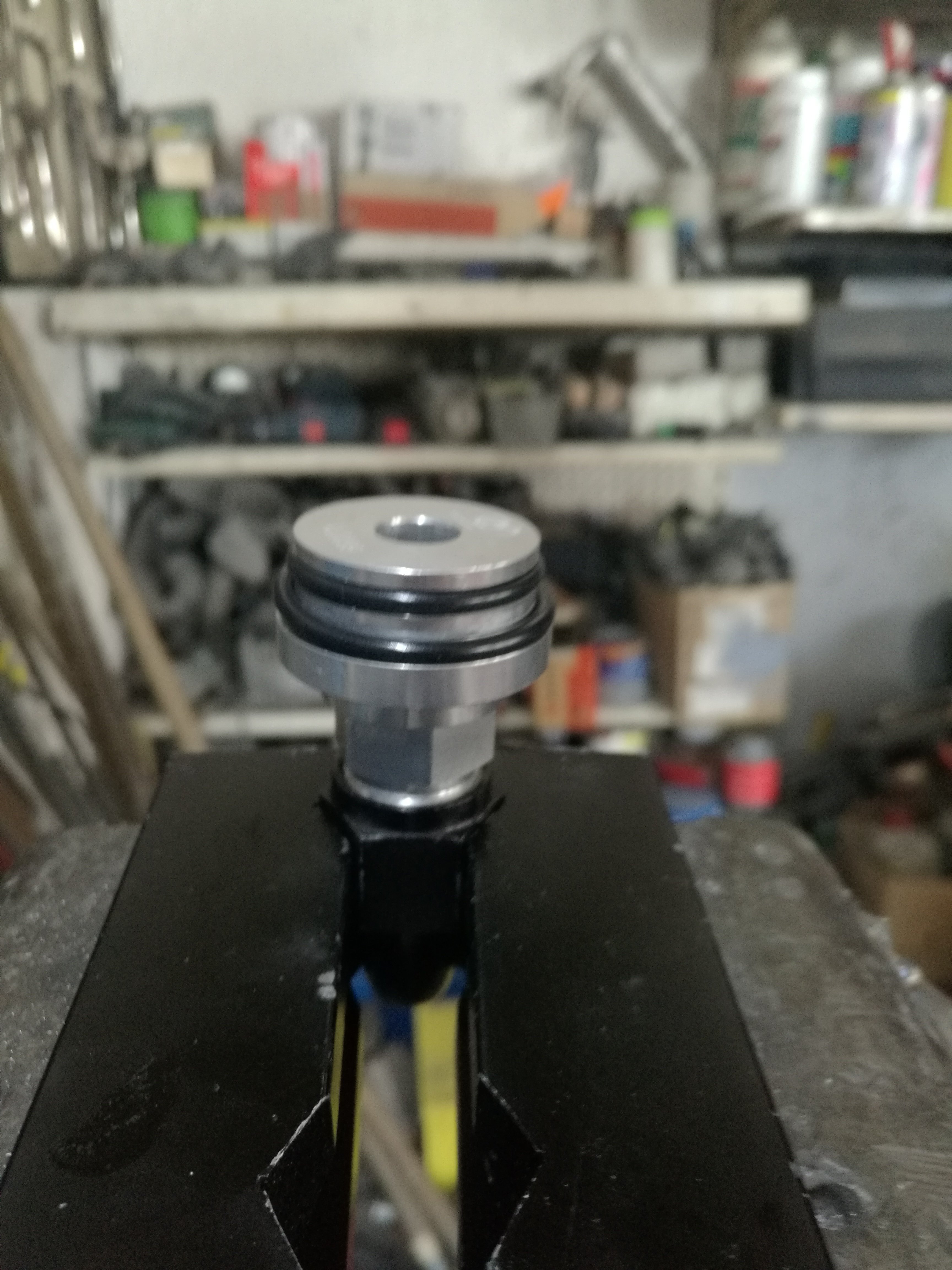

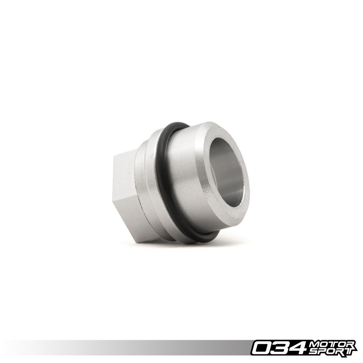

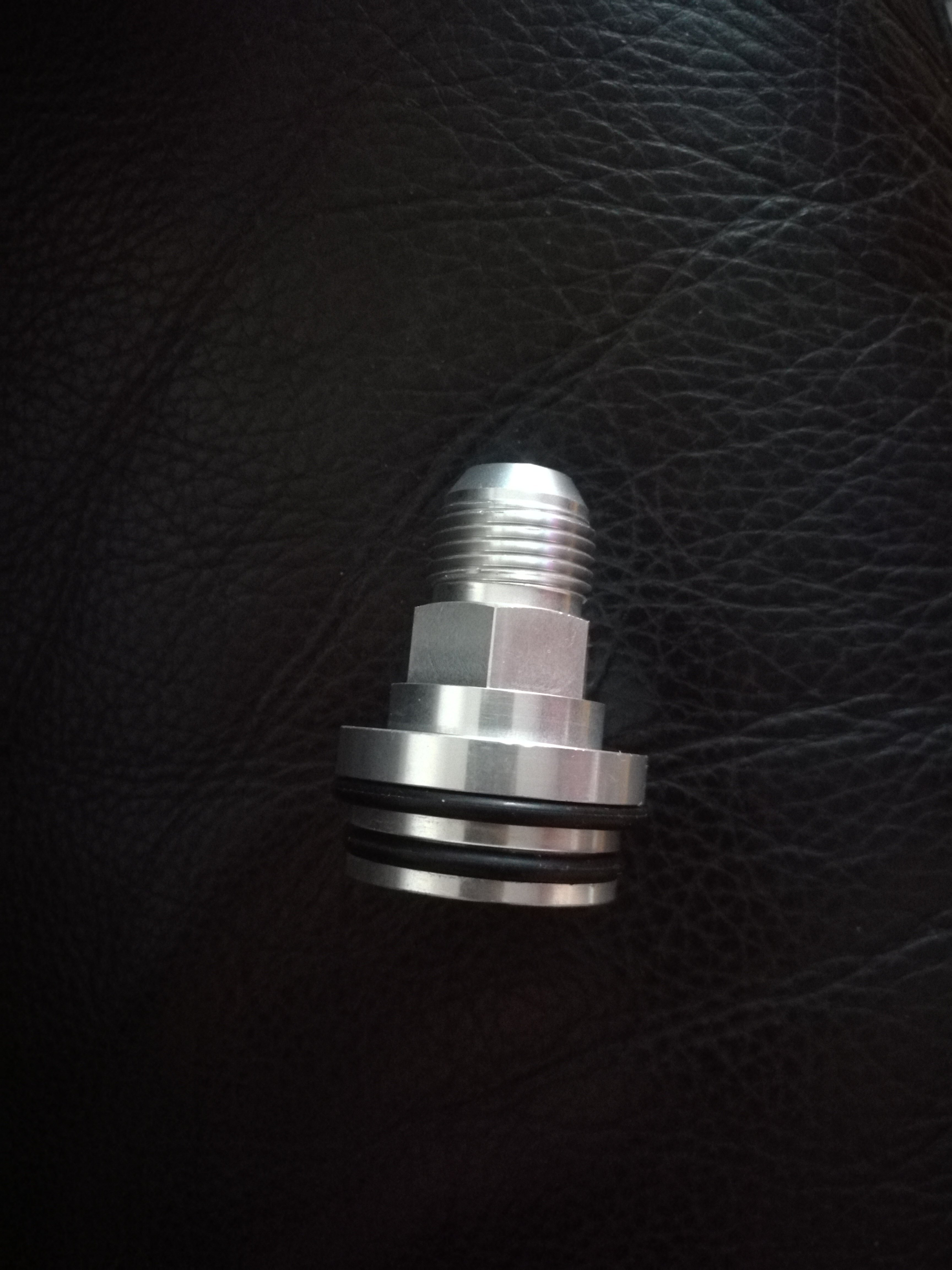

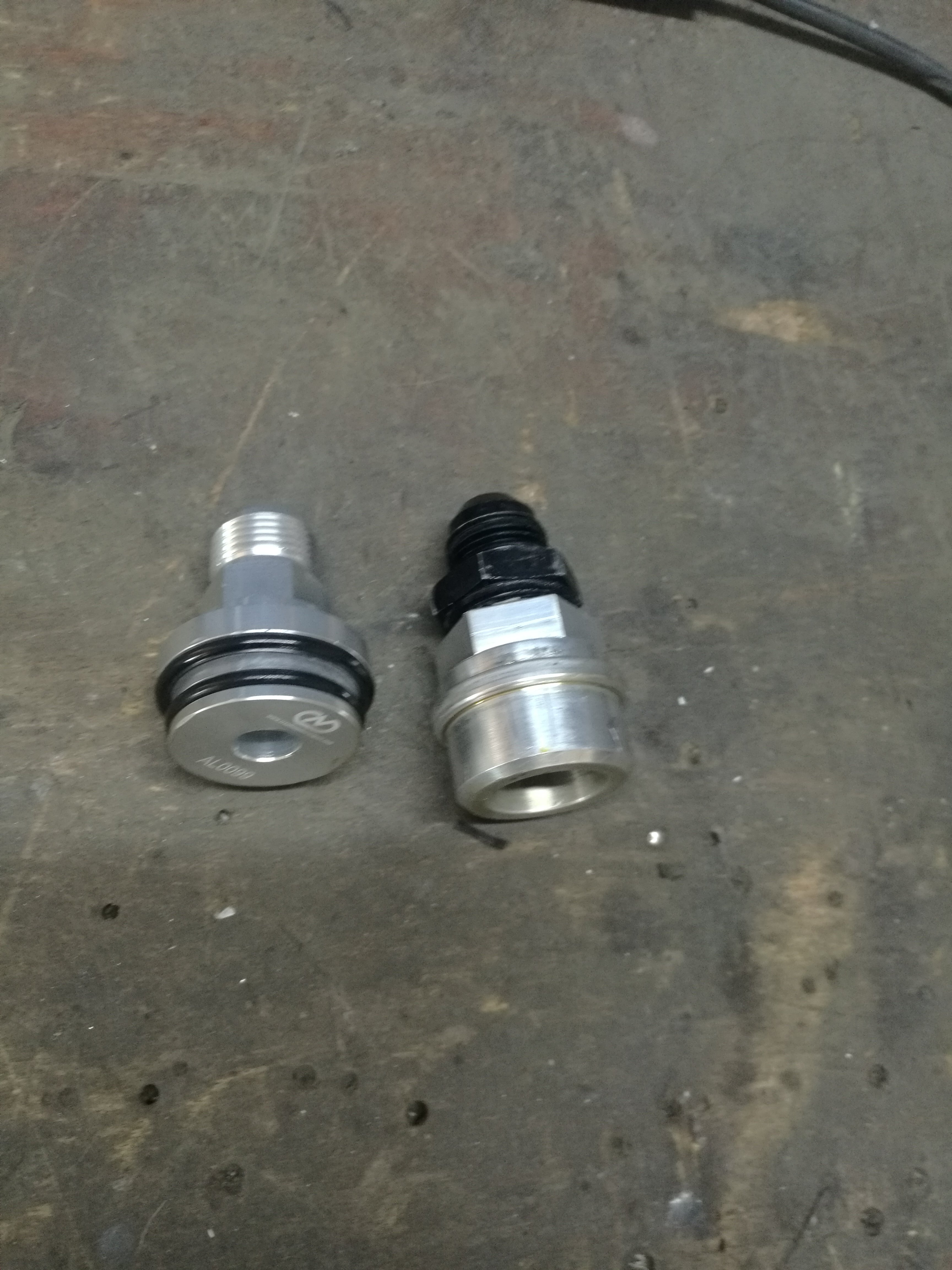

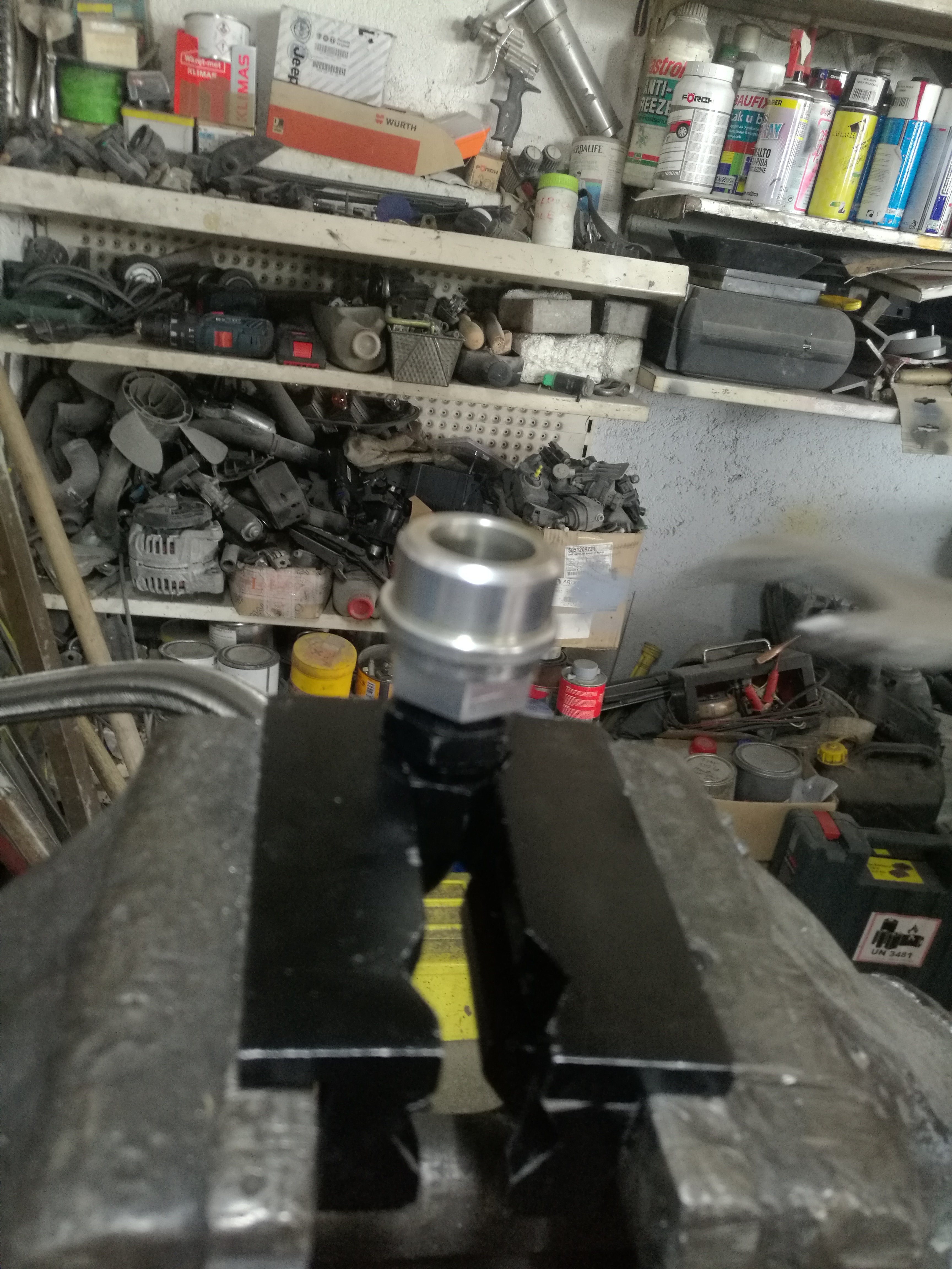

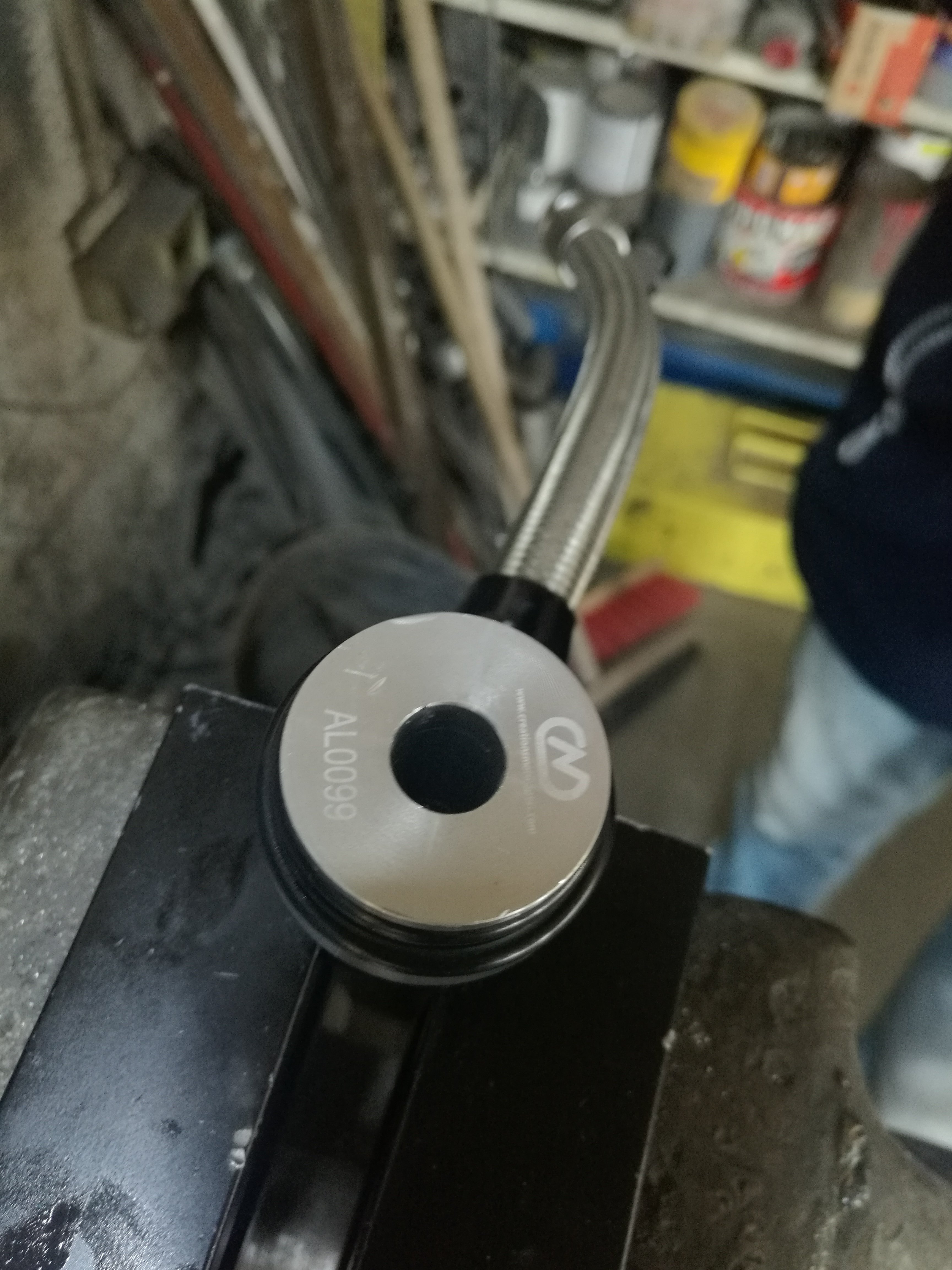

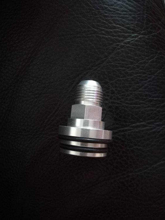

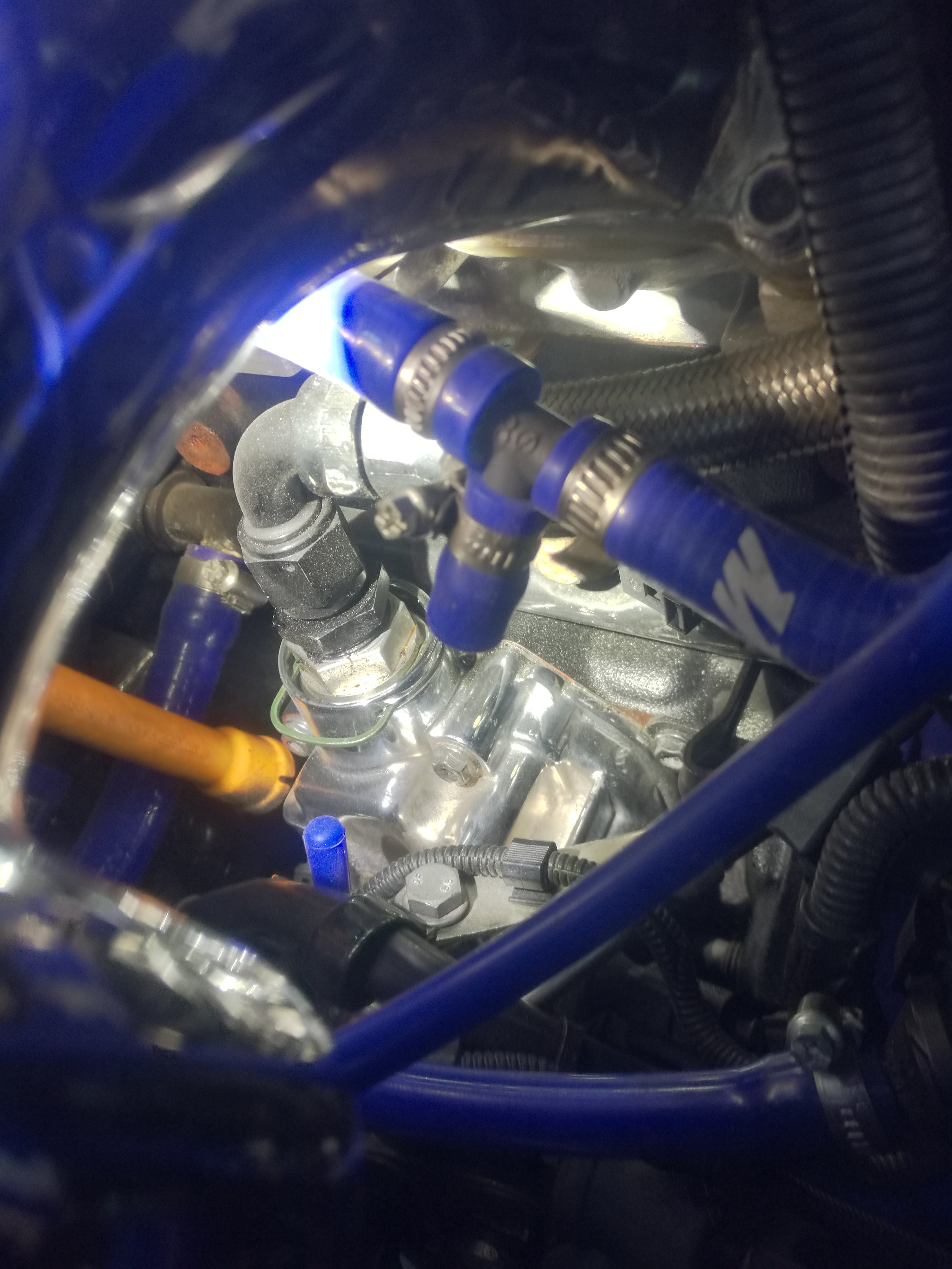

Time to replace old 034motorsport block breather which used only one OE ring and has to use male adapter to AN...this new one is in fact CM motorsport copy of forge motorsport one, but half the price. Only one piece and one connection to AN fitting, no need for male to male adapter. Most important is that the shaft itself has also O ring not only one on top.
034motorsport-block-breather-adapter-audi-volkswagen-18t-billet-aluminum-threaded-npt-mkiv-8n-8l-034-101-5001-1.jpg
Edited by davojuri
Old block breather is out and new one is in😂
In place

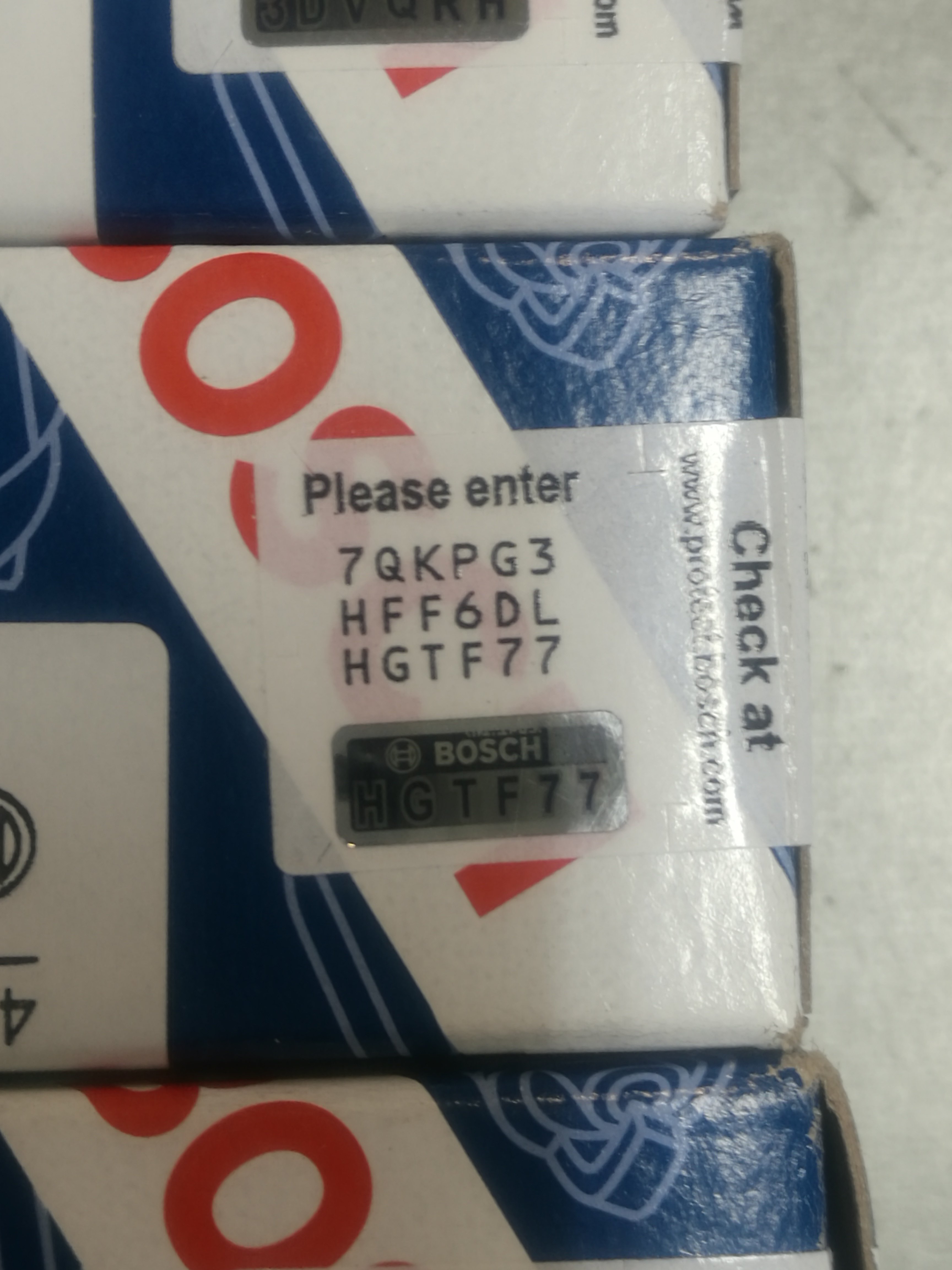

On 03/10/2018 at 19:45, davojuri said:
Here are the injectors

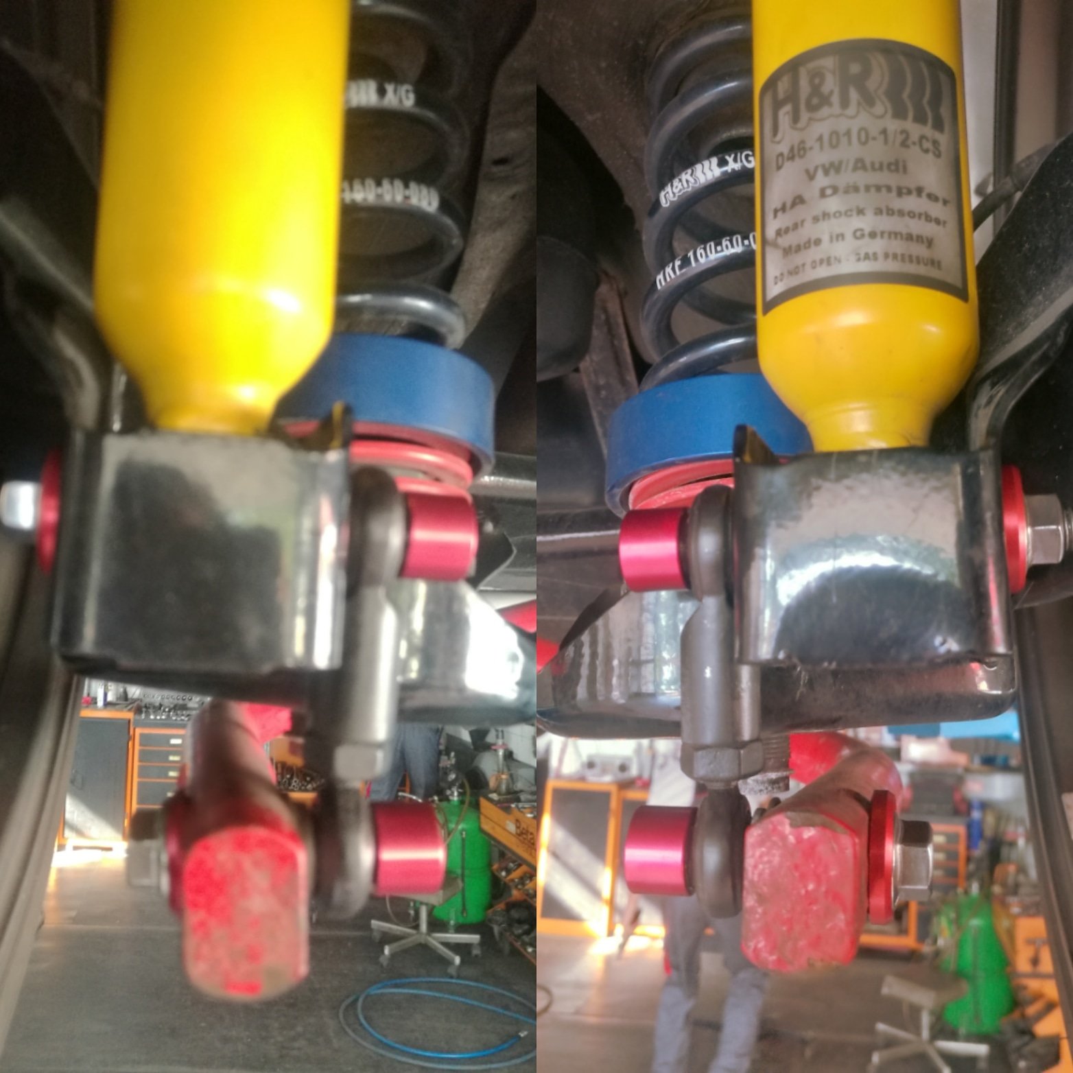

Some bolts and flanged serrated nuts red washers update for sway bar endlinks

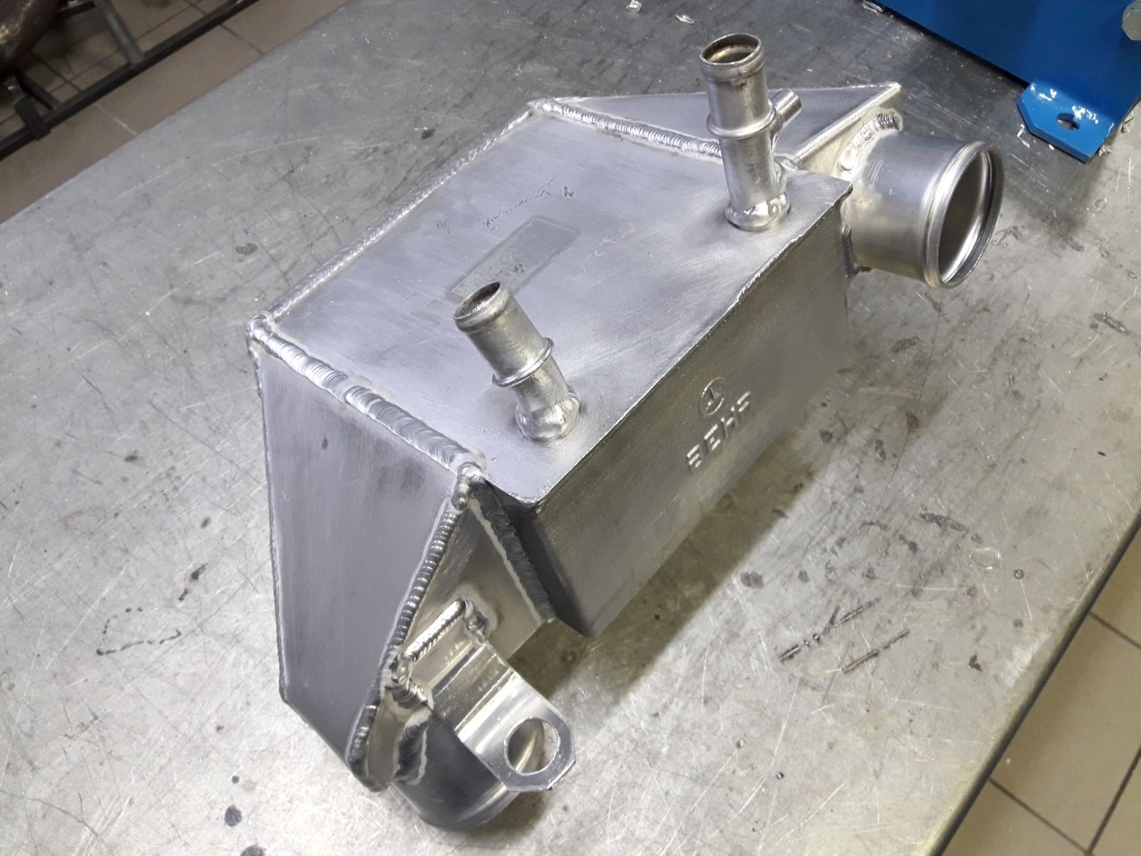

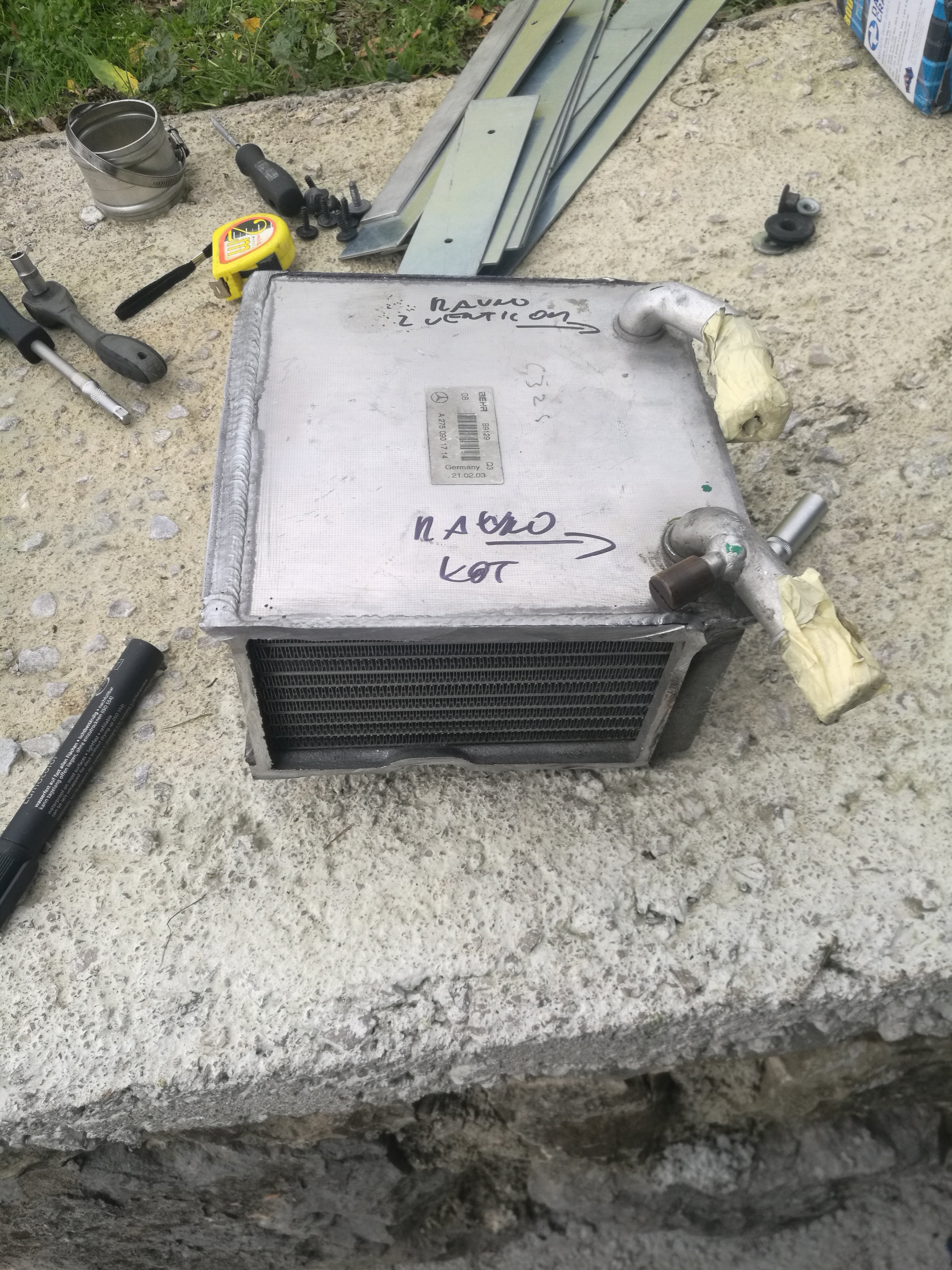

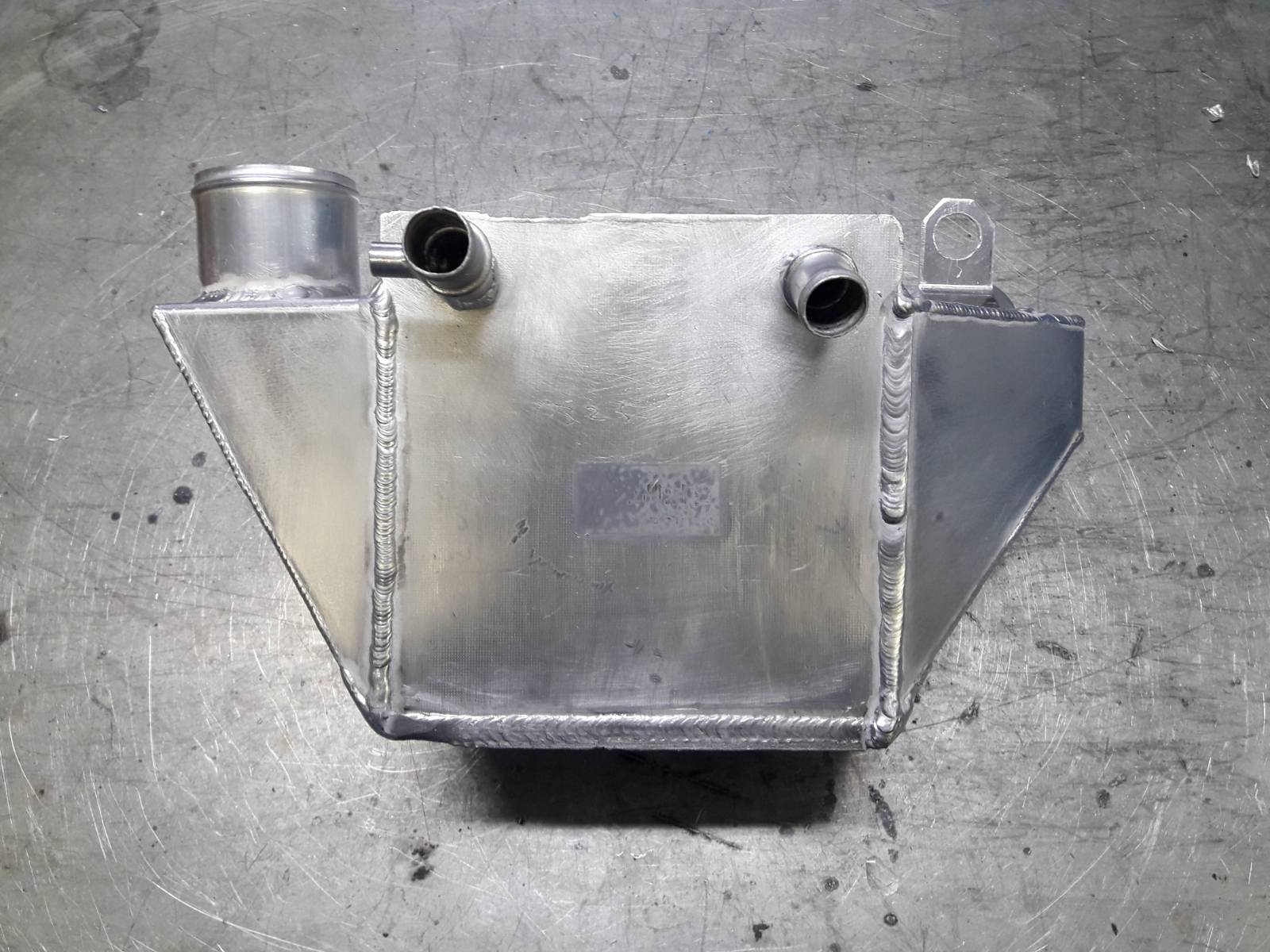

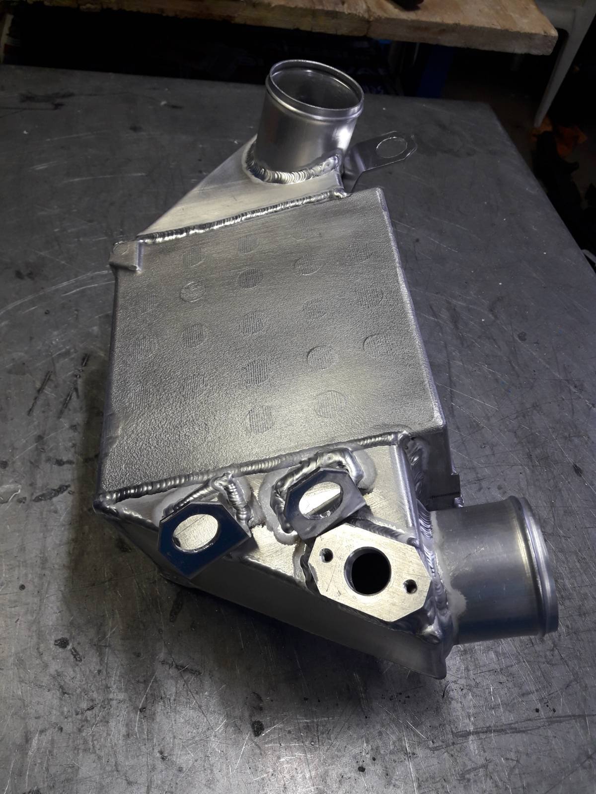

Custom WATER charged air cooler finally done. Core is from AMG S55, and endtanks are made according to the 3D scan of OEM SMIC. Can't wait to put it all together
Made by #ojomotorsport
