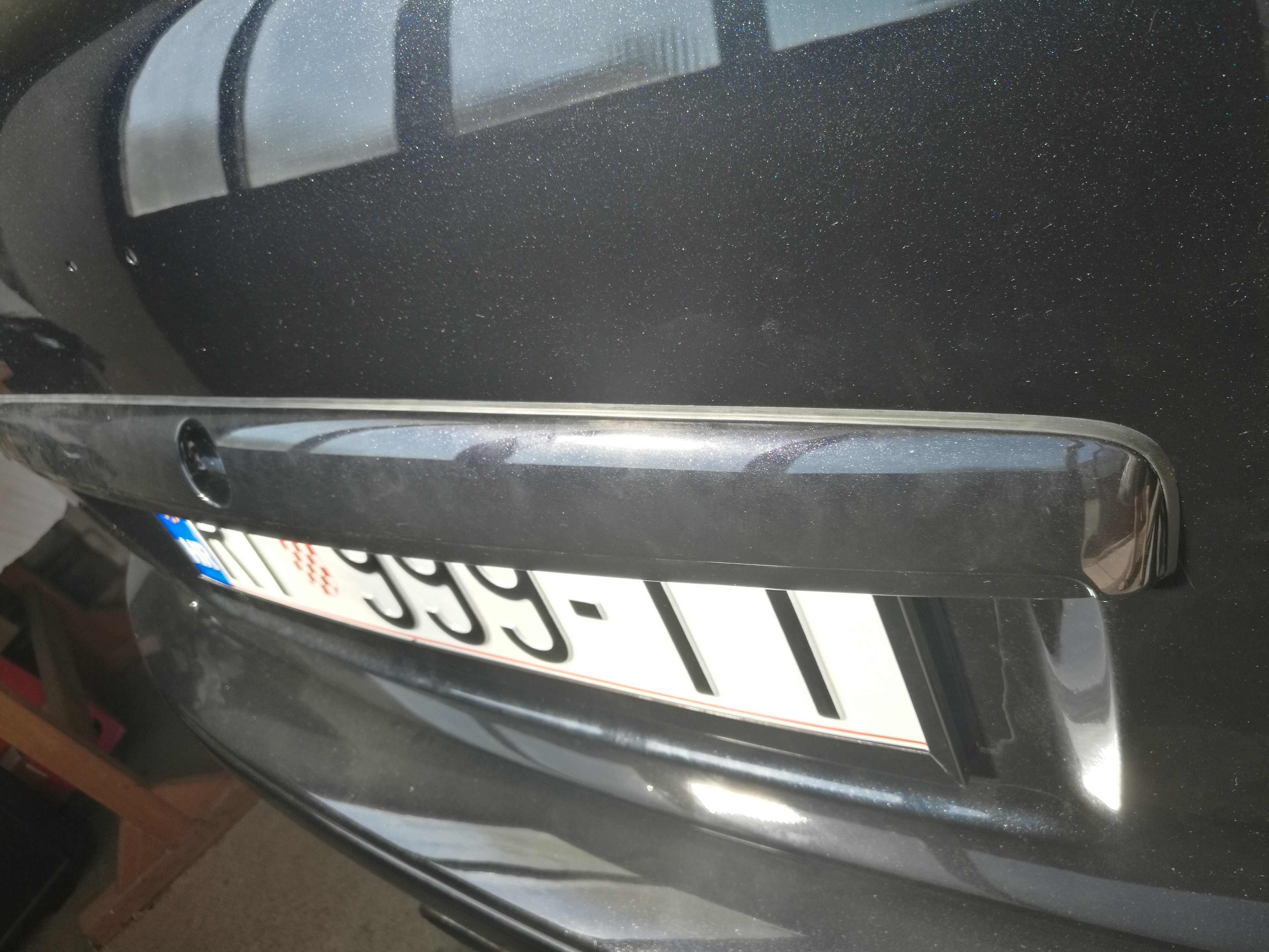

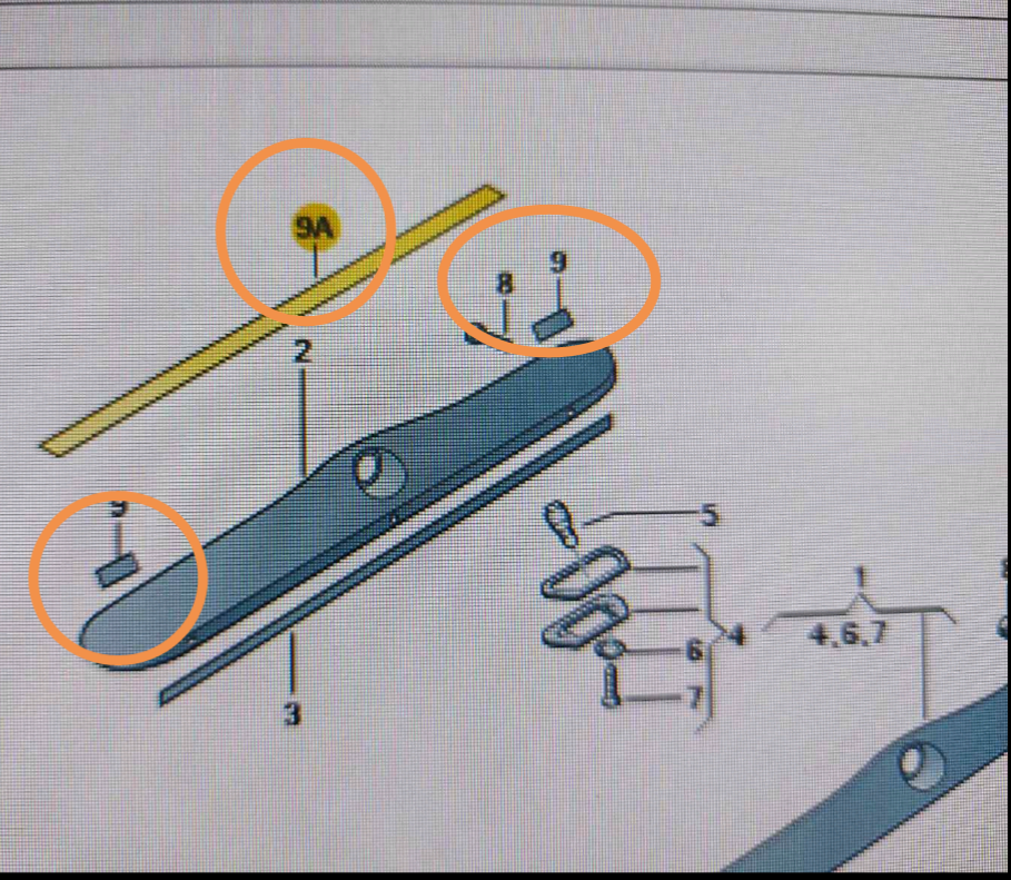

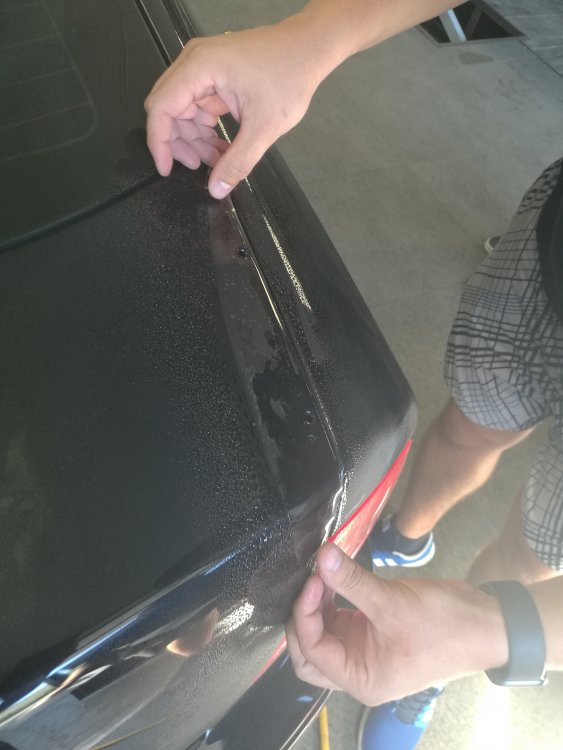

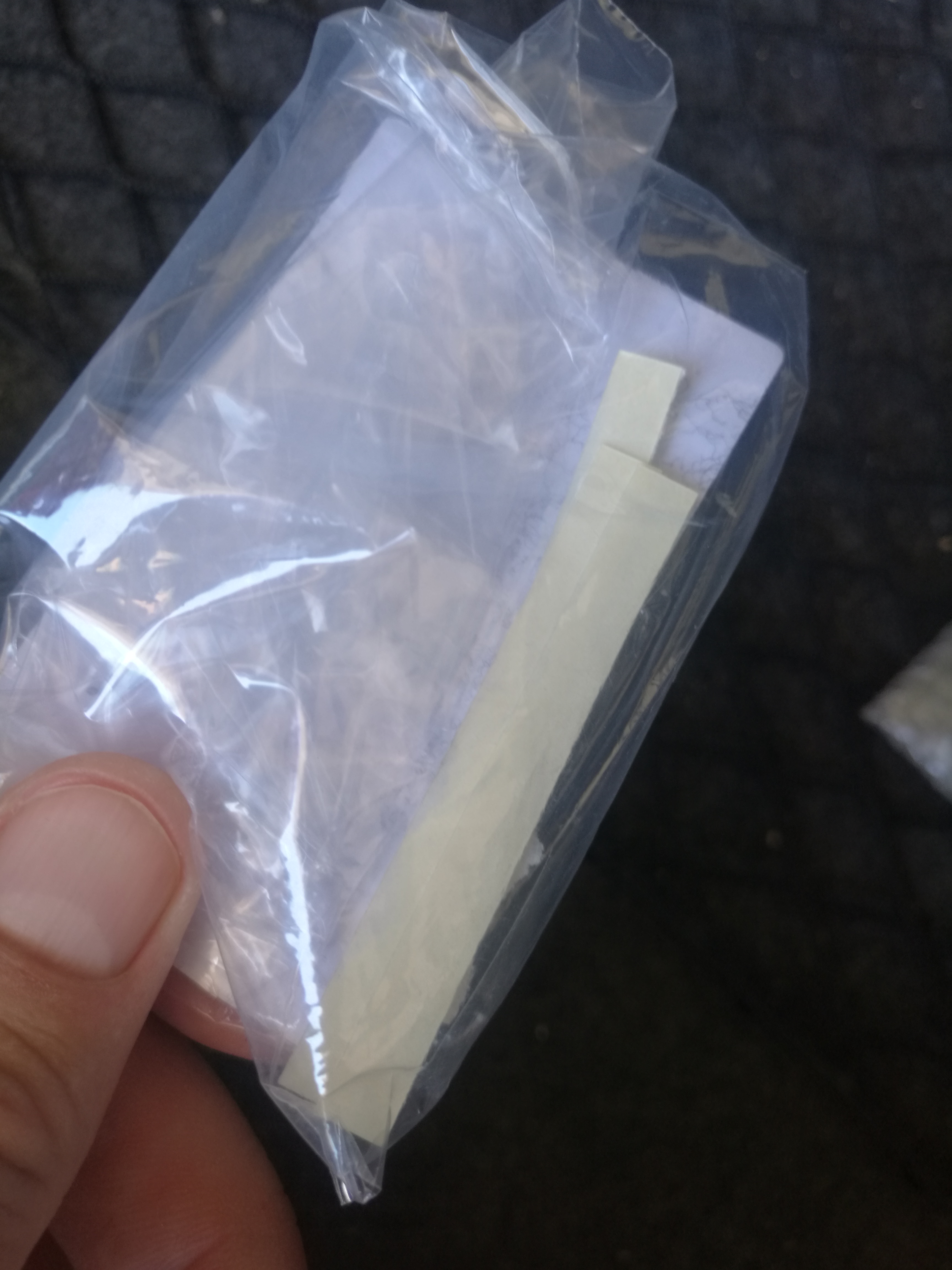

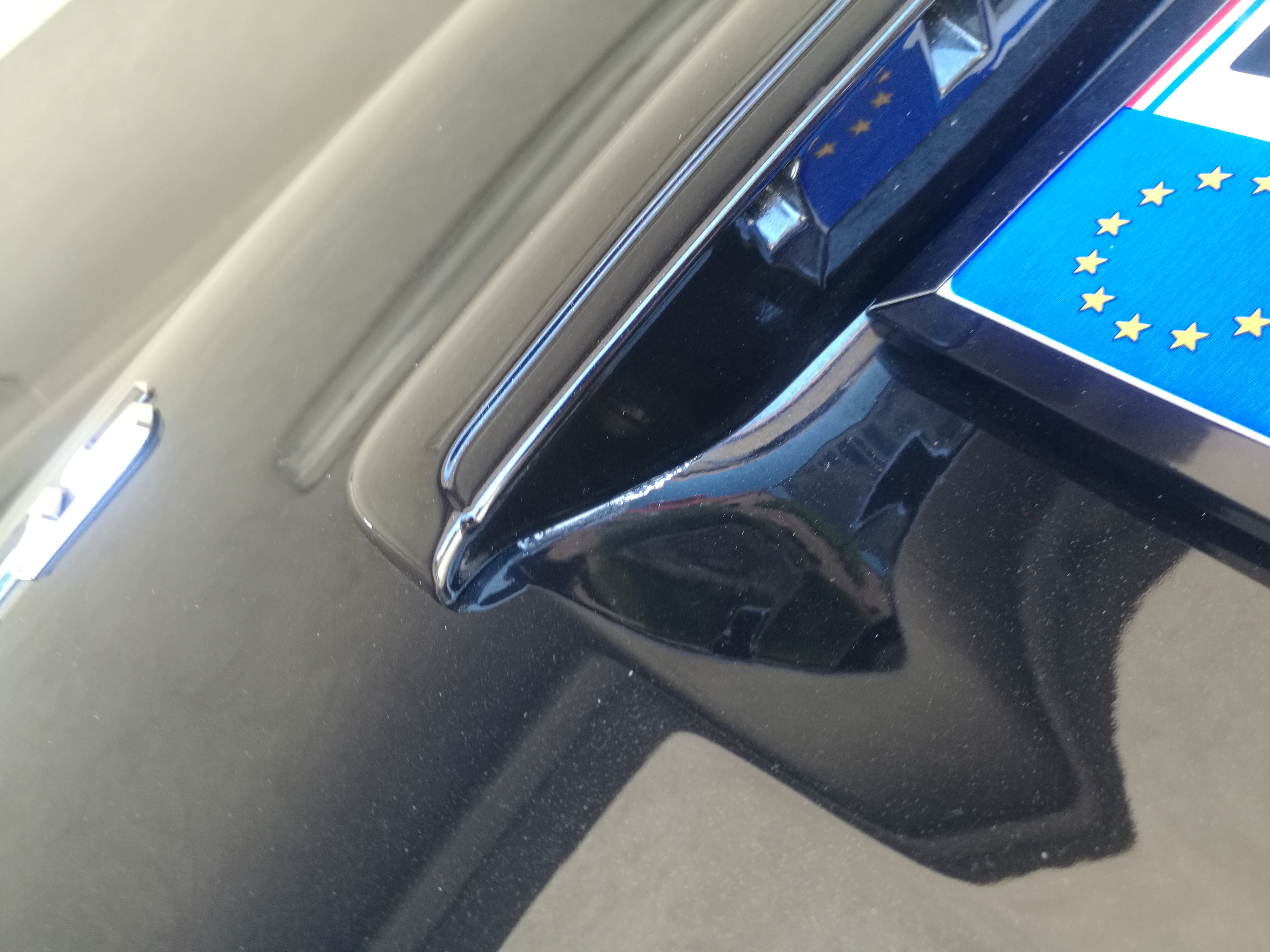

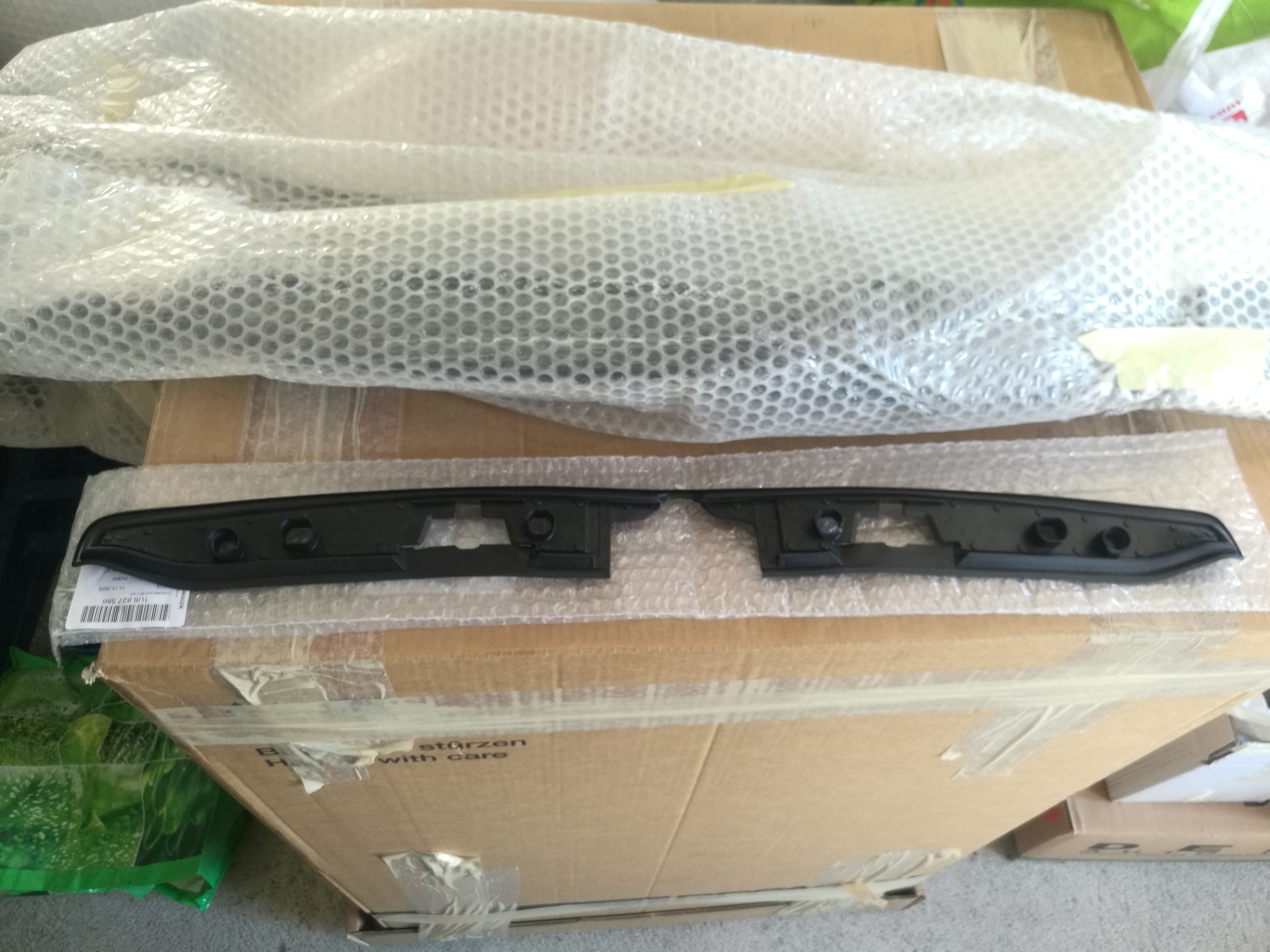

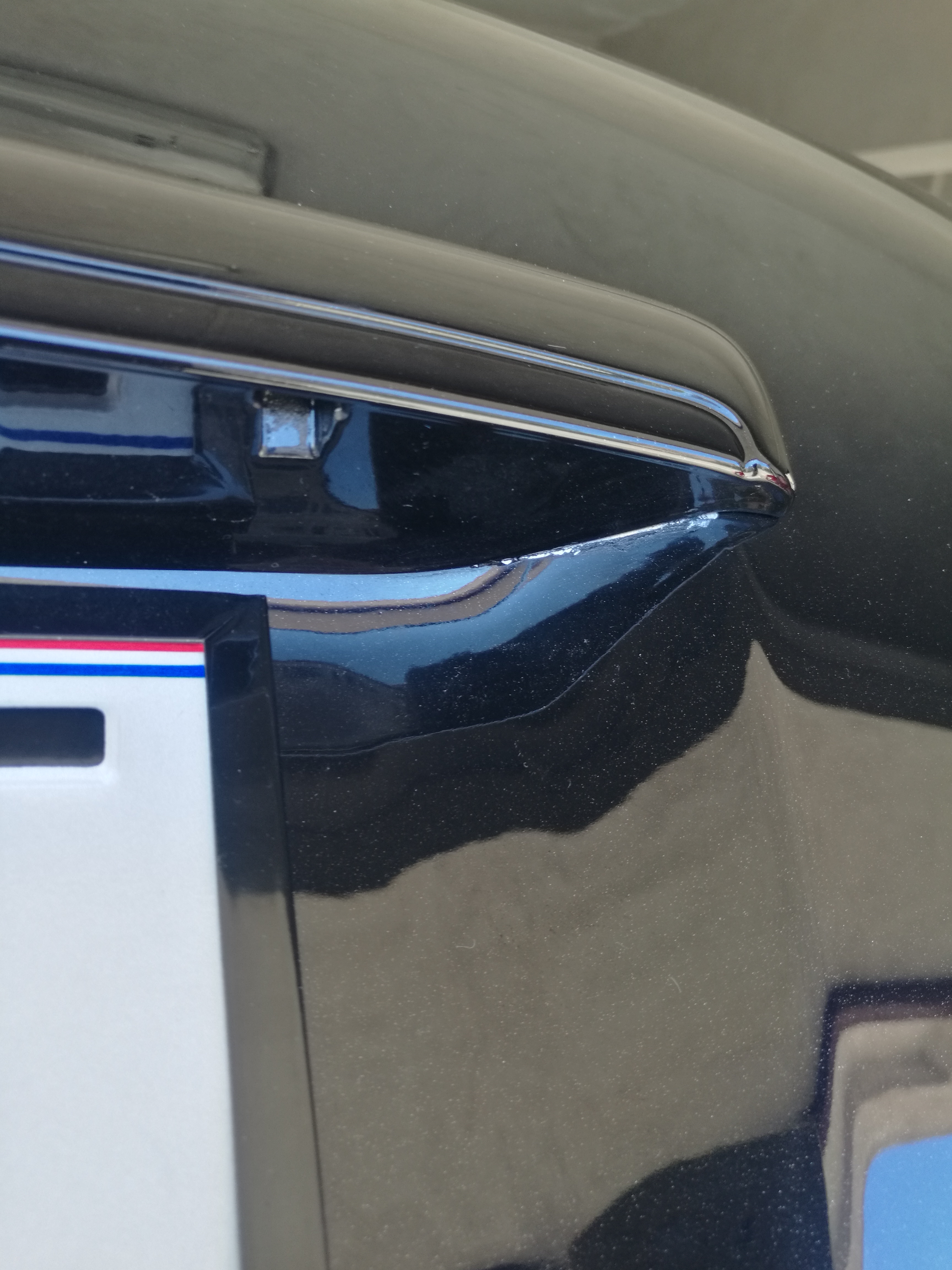

Same thing happens in the back-trunk. There is a bracket With hadle and lock for it. When You lift the trunk holding it it also scratches the paint. Look at the pictures. Old factory bracket had small strip of sponge at the upper border. I thought about that and wantet to put also double sided tape and paint protection film at the bottom pressure points. But as I went to Porsche dealer in ETKA they offer protective strip-looks like old sponge strip and two small strips od PPF. Today I picked it up and it is real upgrade -full ruber insulation and two small PPF strips to go where it had damaged paint. Great OEM upgrade. I reccommend it to everyone.

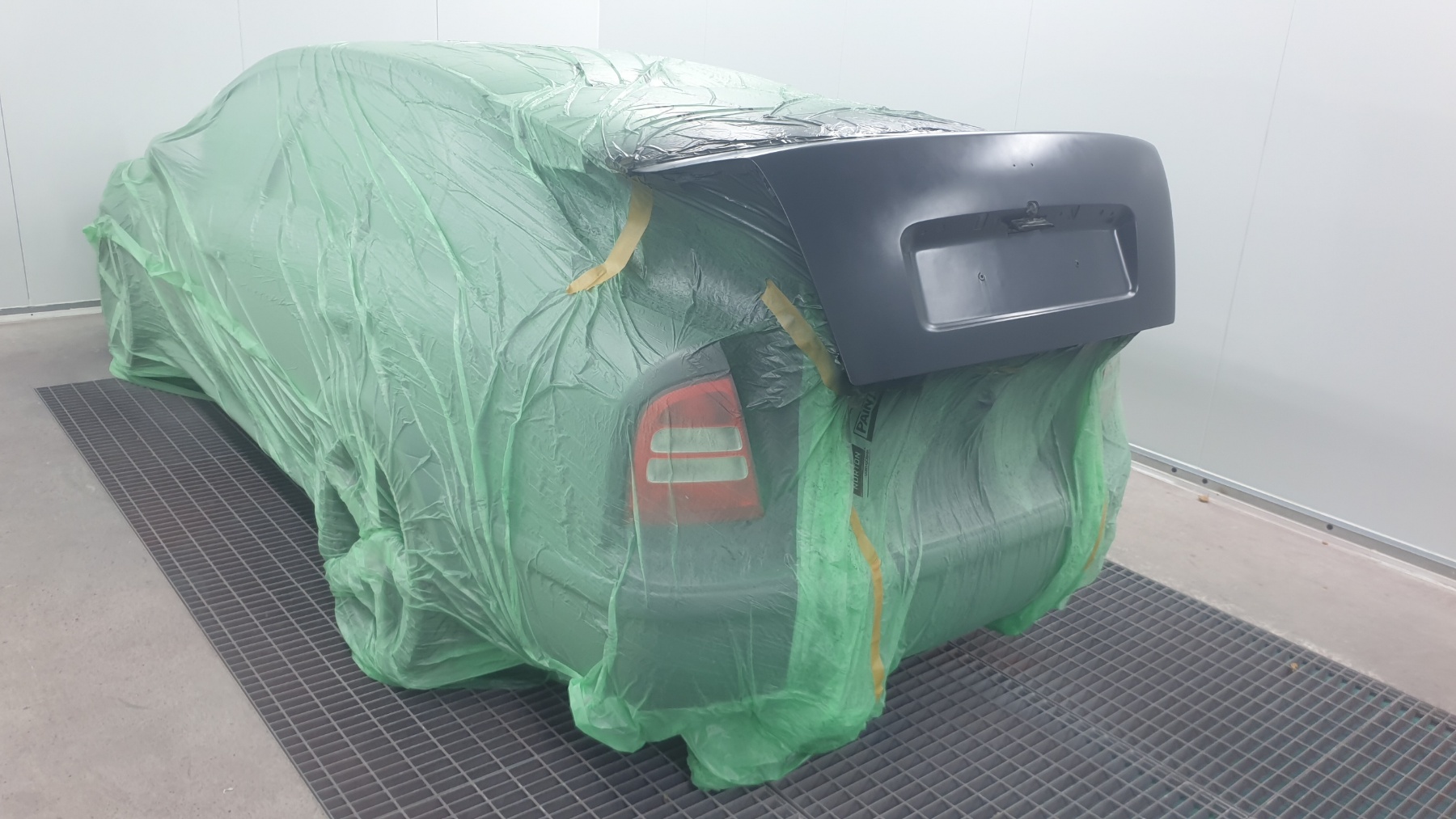

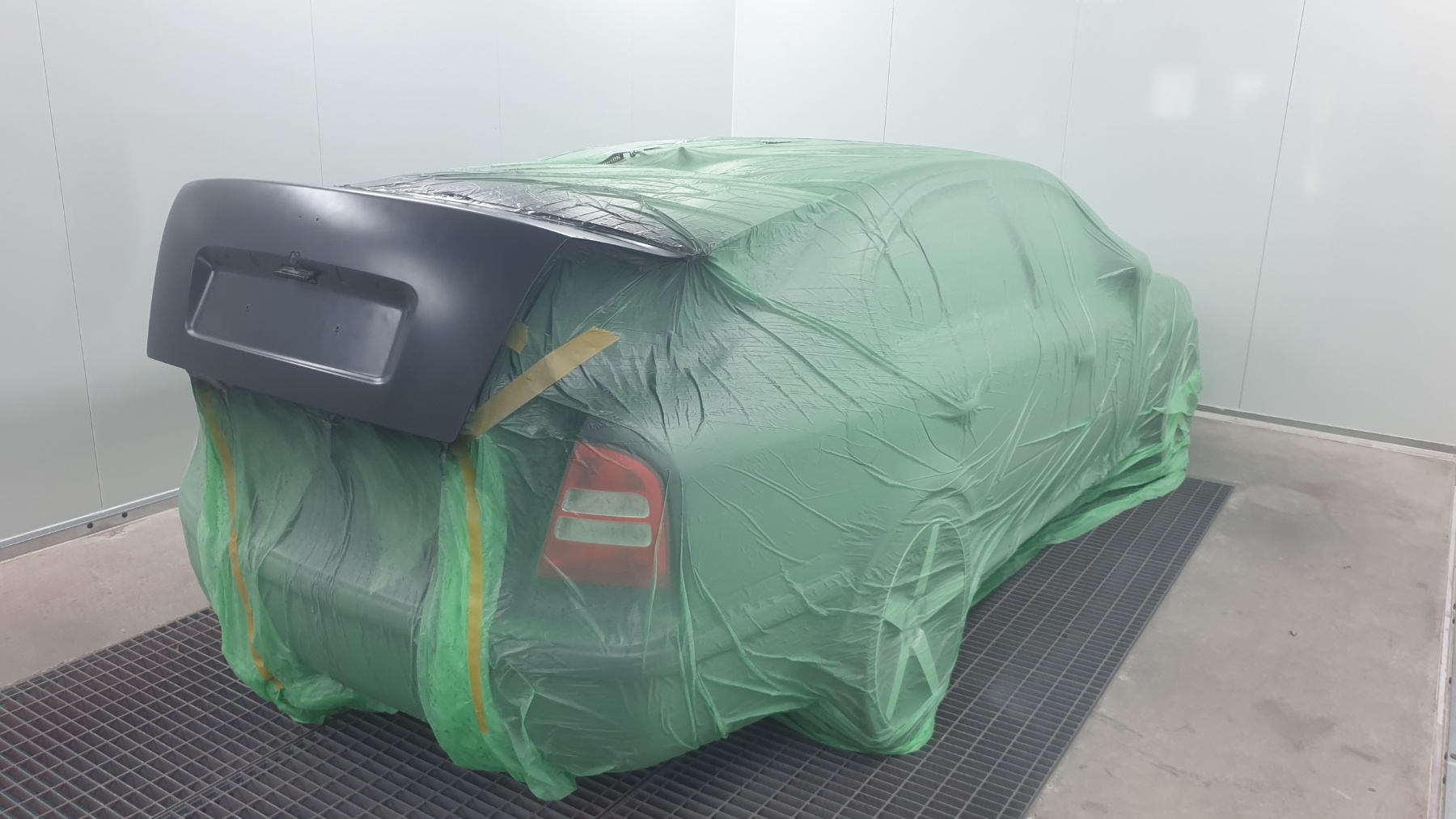

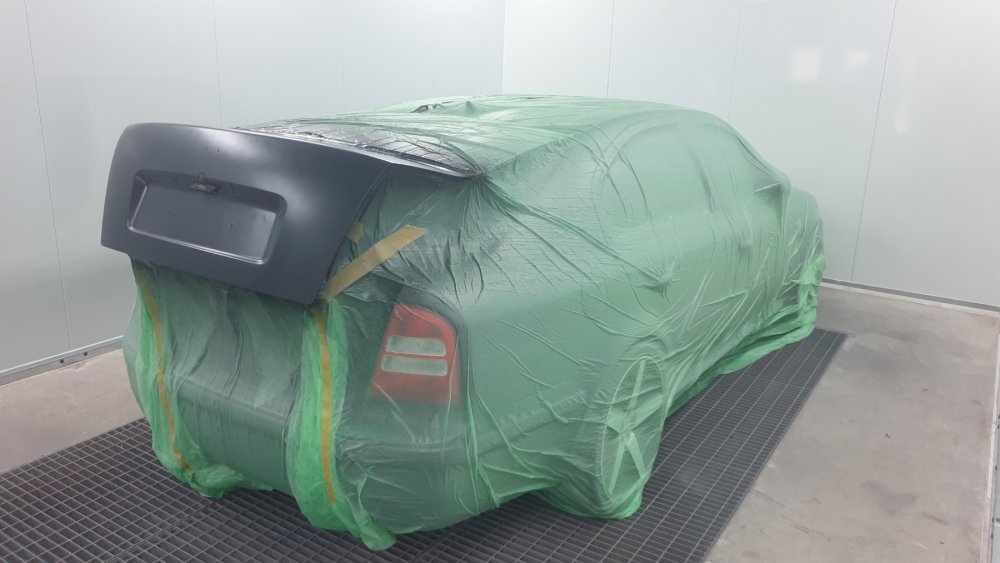

Now only trunk left for painting-tomorrow Will drove car to the paint shop-finally has hood so I can drive it. But we removed new rear wing and will let paint to settle and cure for at least one month before installation to avoid new laque compression and bubbles formation. Looks bald without any rear wing☹️☹️☹️☹️

bonnet looks well and good hint on the grille
i have this and takes a little work to fit but works

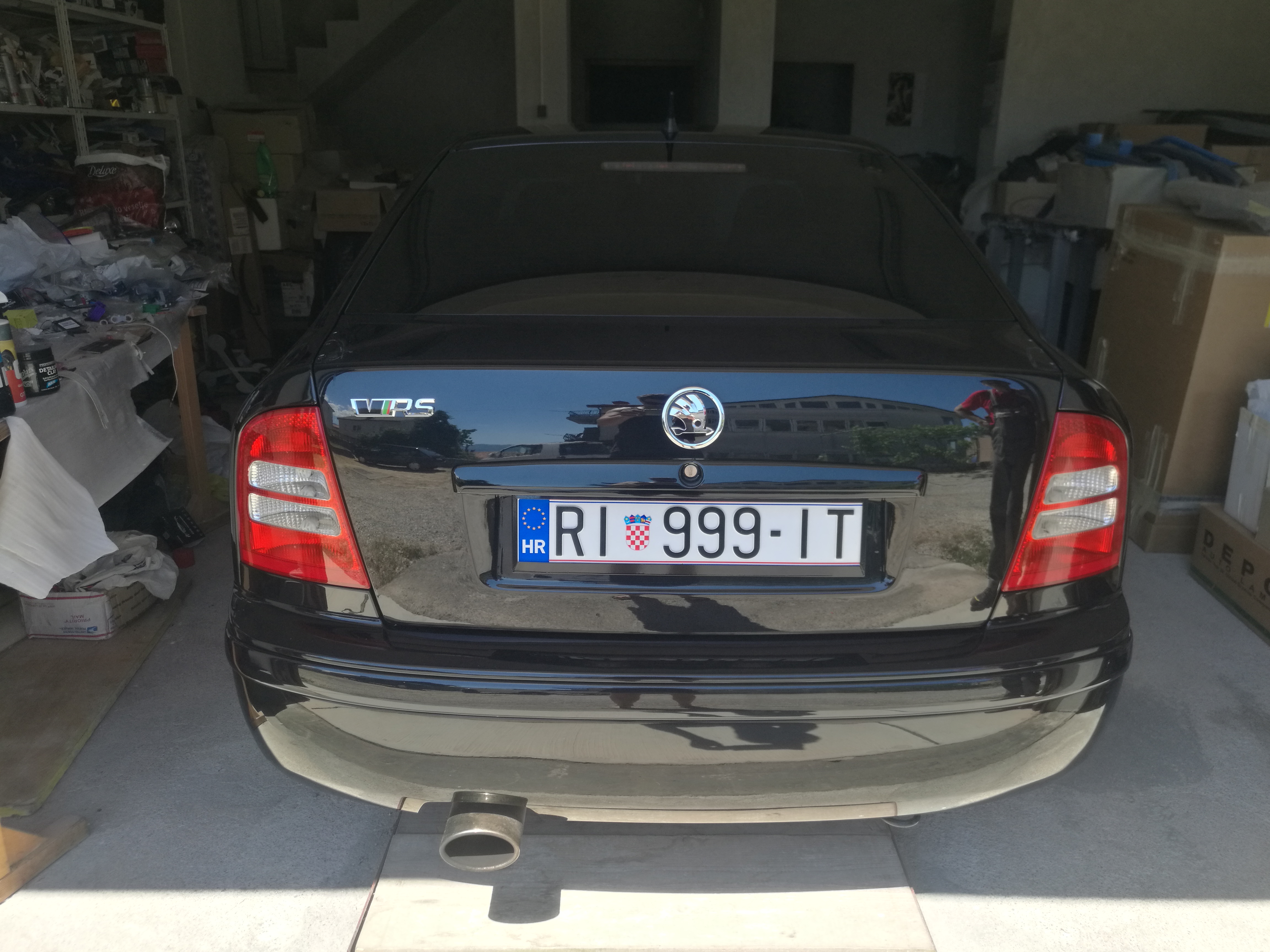

Finally got W8 LED light in black

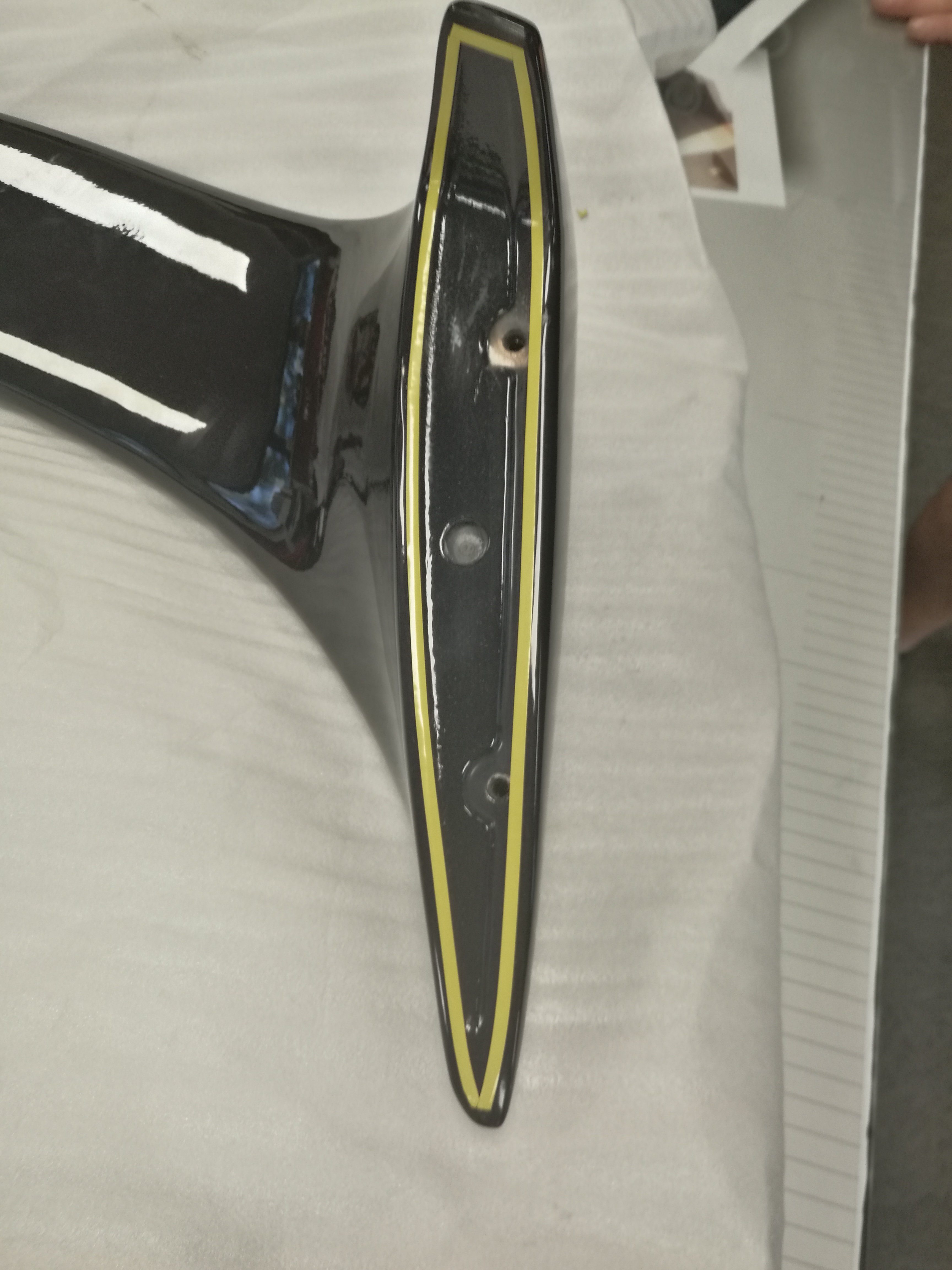

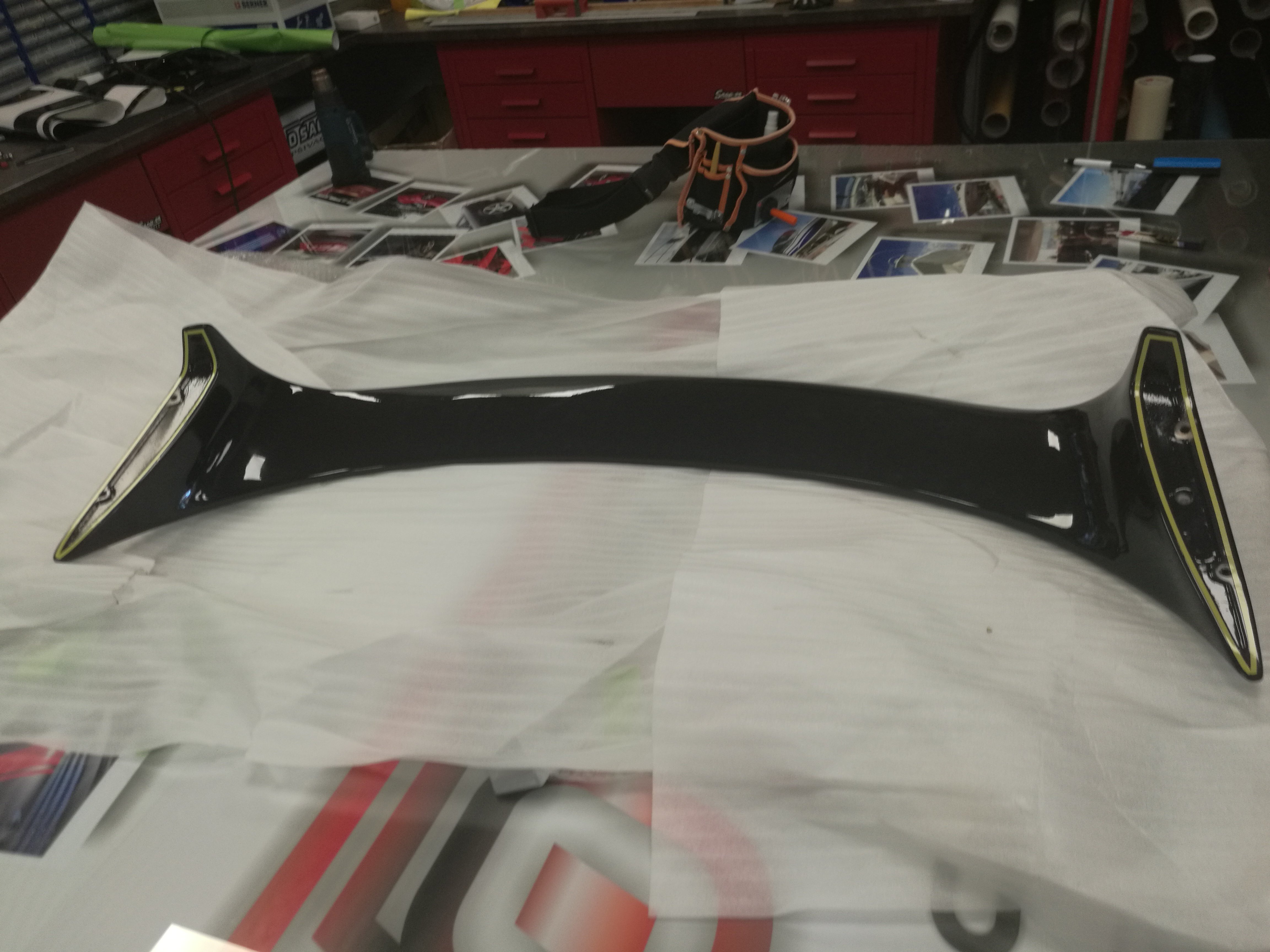

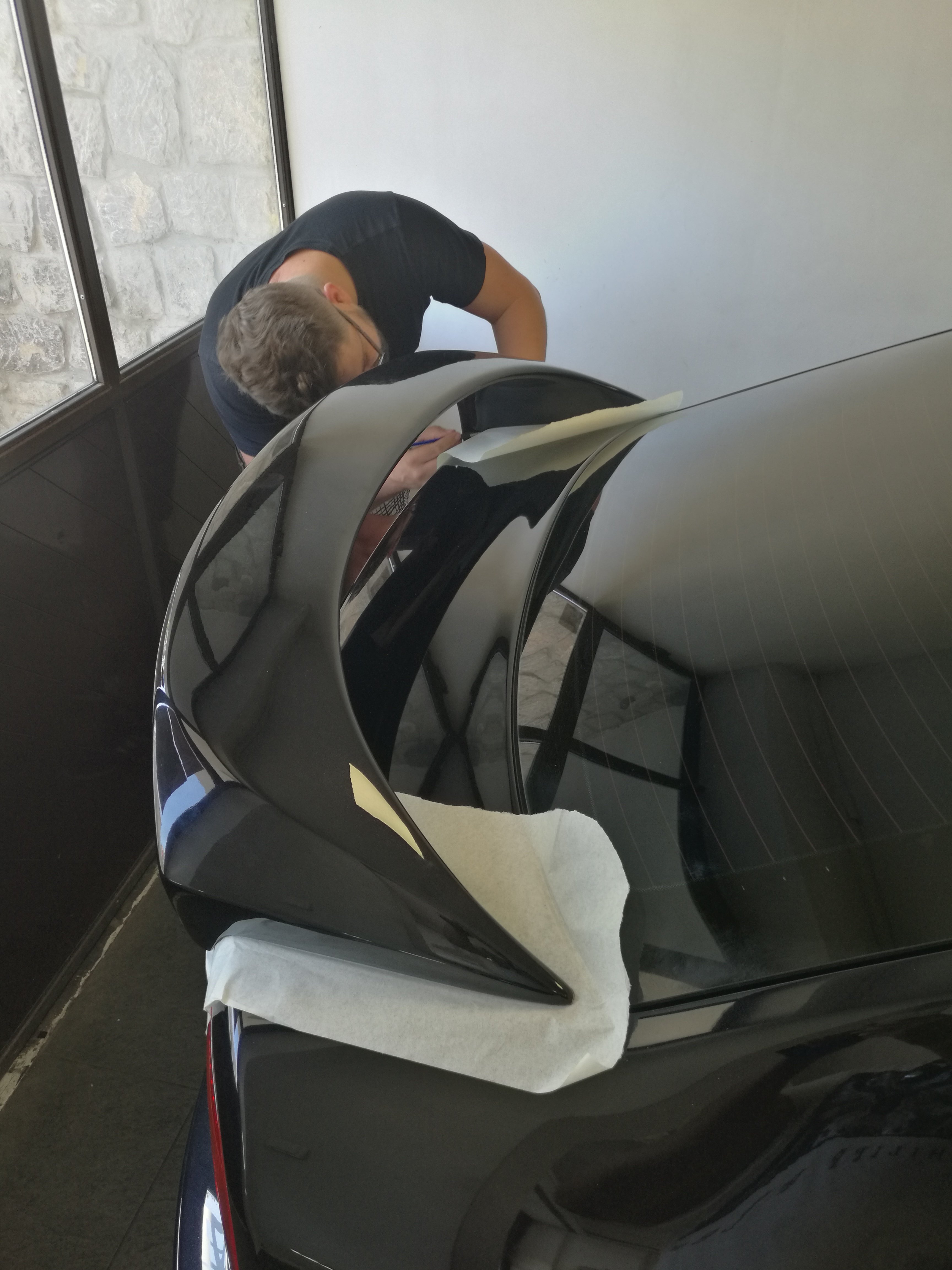

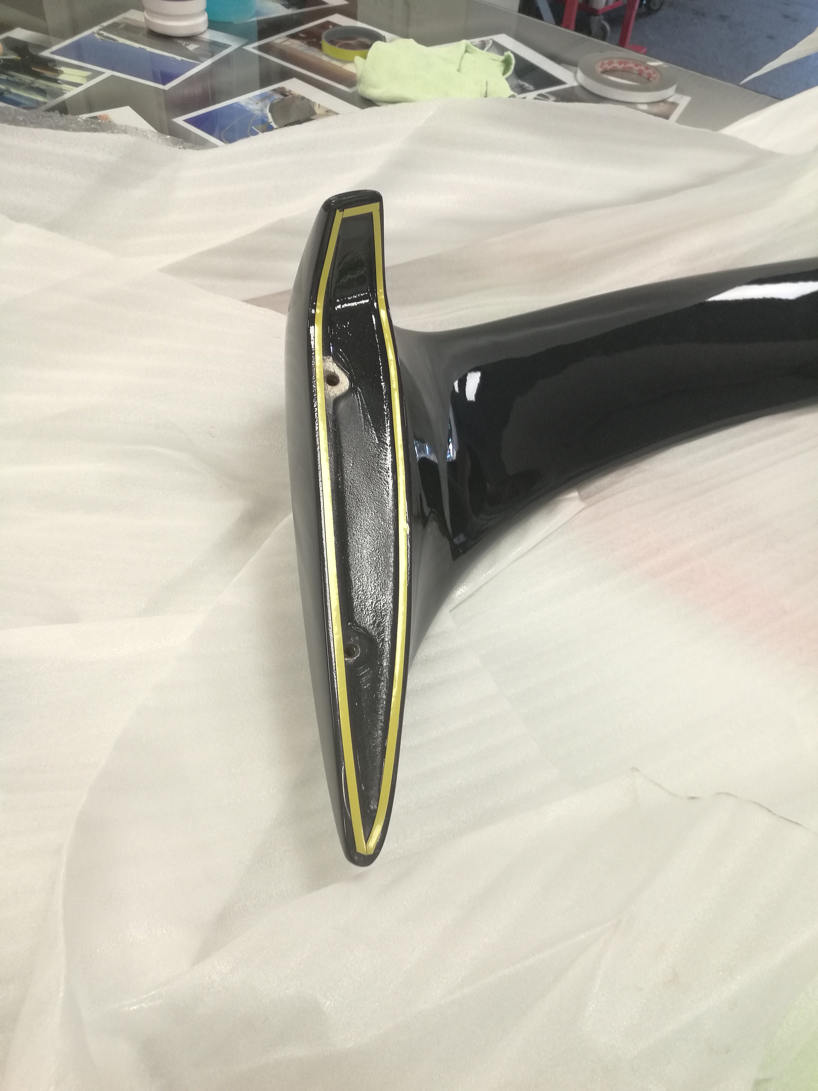

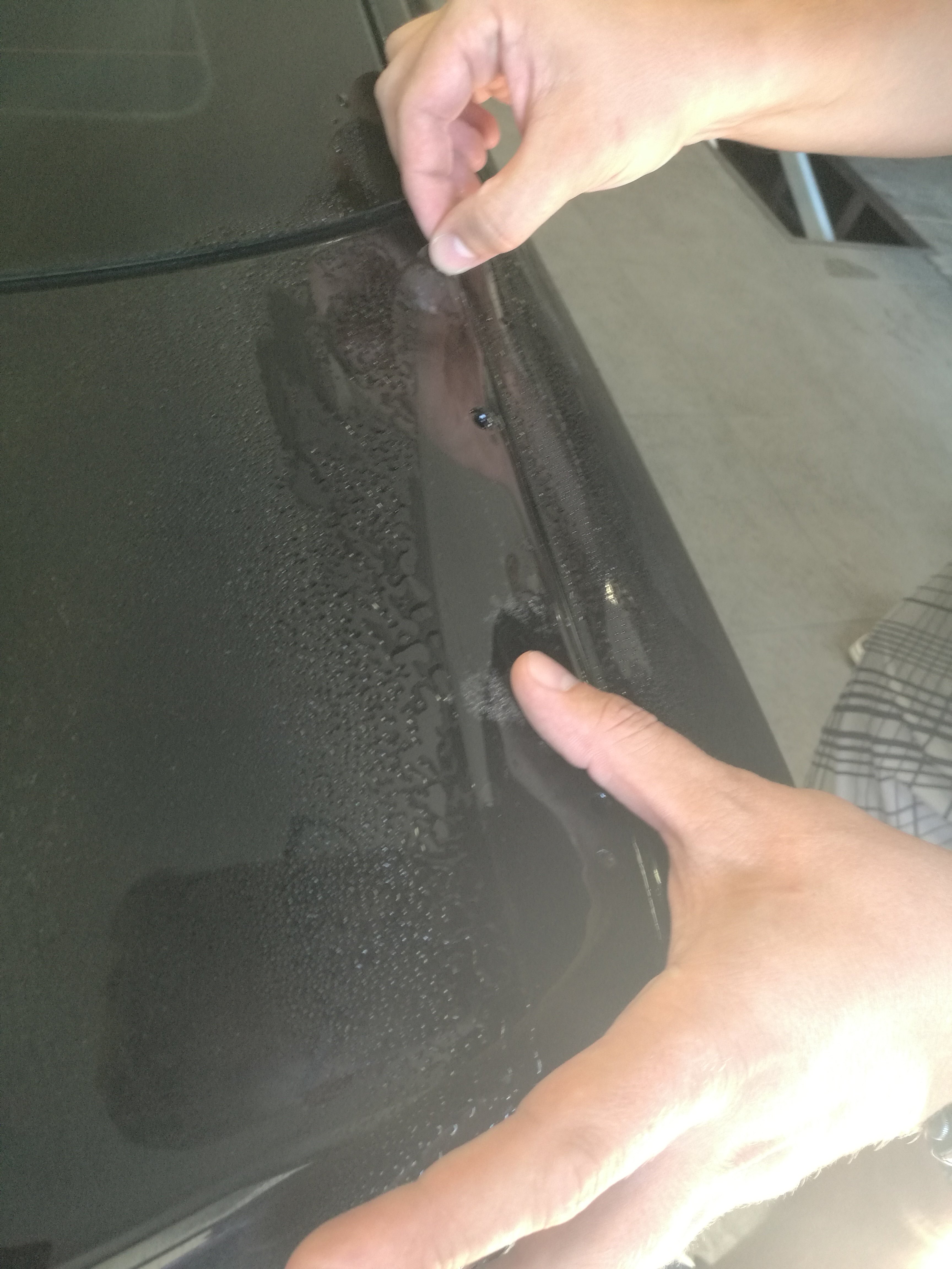

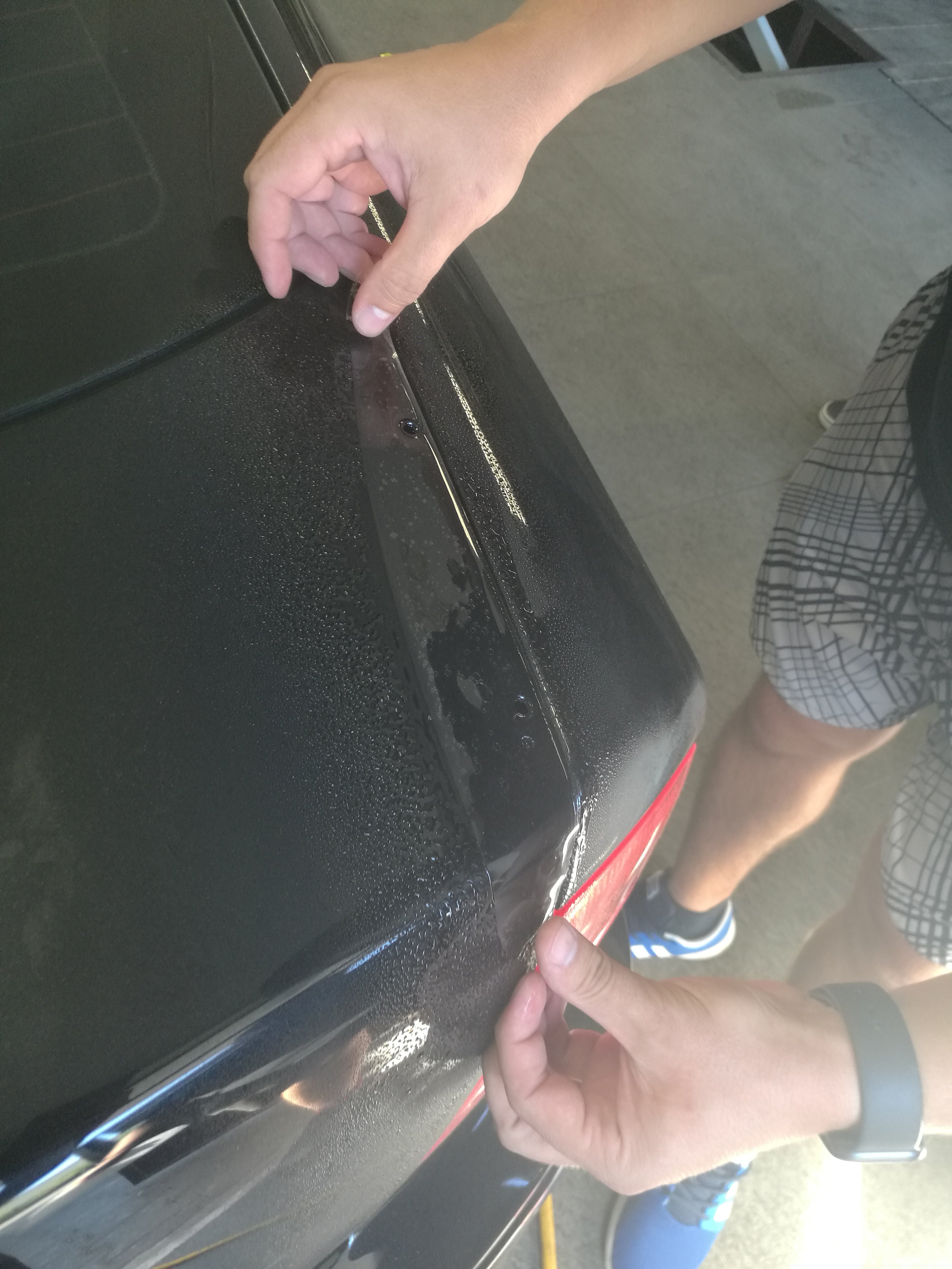

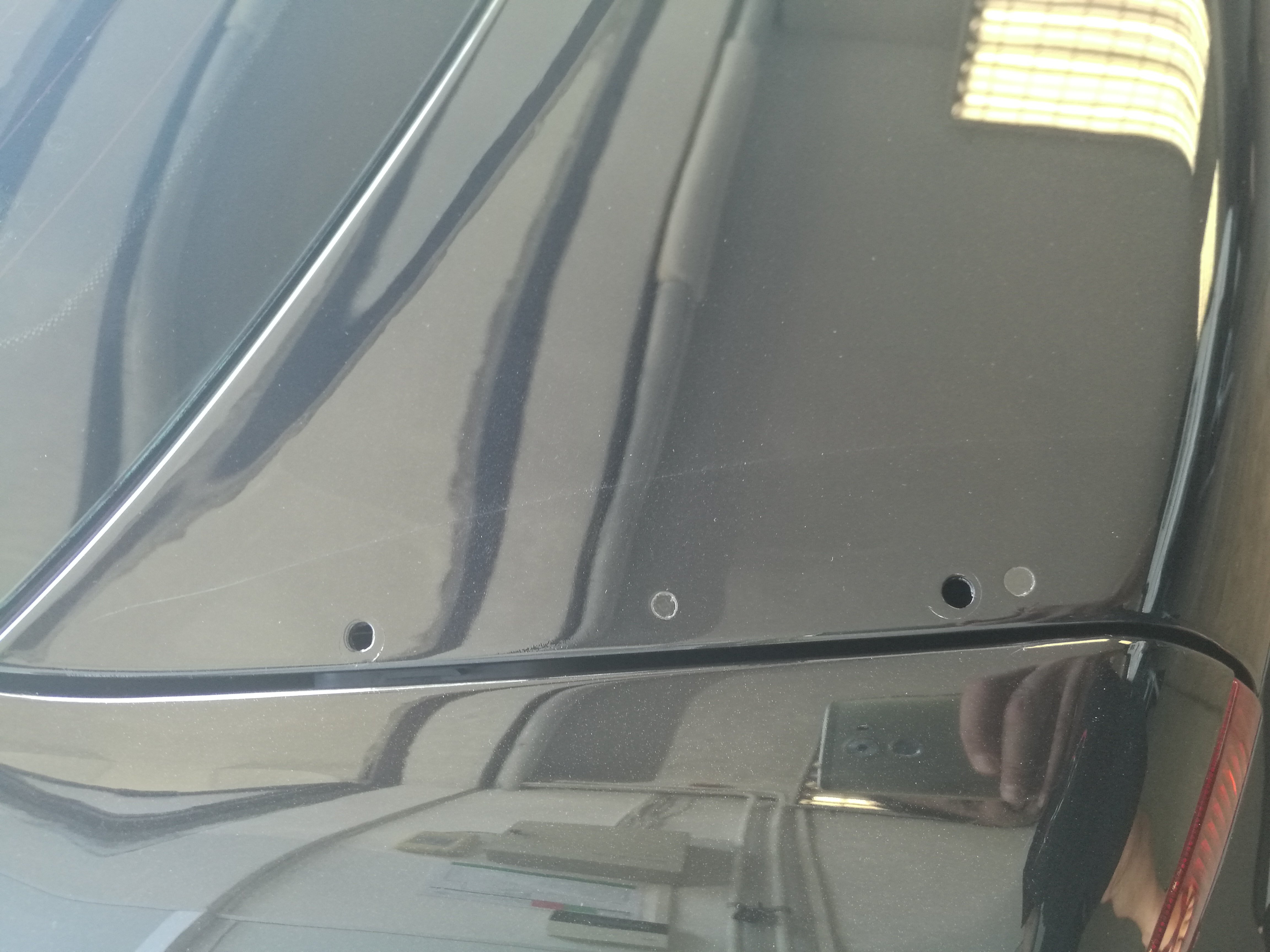

Let me explain in detsils process of rear Wings installation.
I first removed heads of all 4 M6 bolts and made Spikes where there. I pressed the spoiler in place so the Spikes marked drilling points (Spikes where turned in minimally protruding). Drilled first 3mm,6mm and finally 7mm.

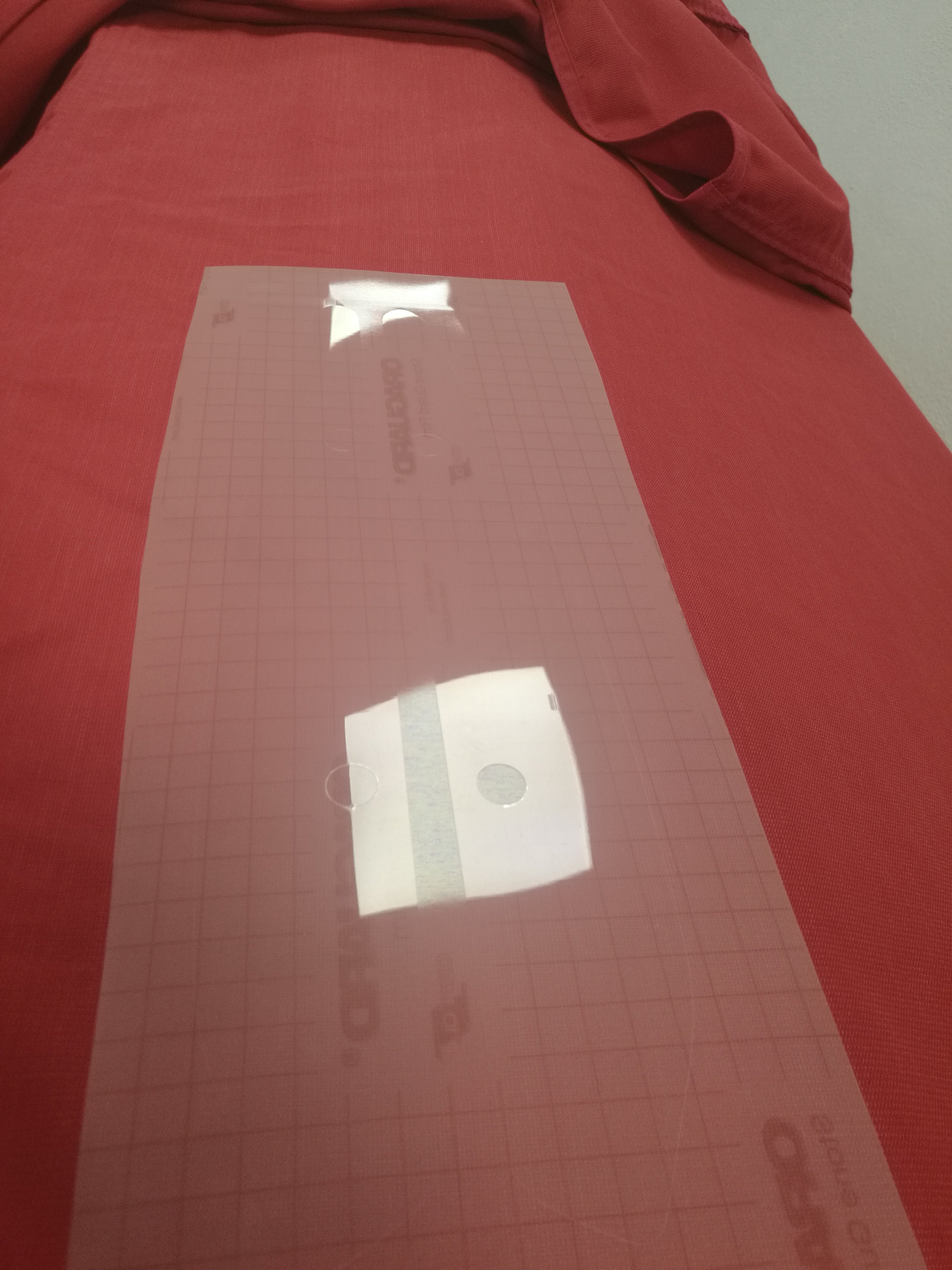

Than we draw spoiler template on paper in place to get template for PPF. That drawing was scanned in A3 and than machine cut on 150micron PPF, it was placed in place and left to dry for several days. After that we did put double sided Wurth tape on the base of rear wing to gain amortisation,and sprayed With water mixed With baby shampoo to alow sliding od double sided Rape over PPF without distorsion of PPF before final Titanium bolt tighteming.
Using PPF and double sided adhesive tape paint wont ne damaged after spoiler removal in future😇😇😇😇
Also installed updated trunk bracket With Rubber insullation all around instead of old one with tinny sponge strip at the top causing that bracket to cut through the paint at lower lateral edges. That's proper factory upgrade
is this painted or oe?
Painted. Oe is only grey or beige
i thought that , looks good , what colour led or just oe
Red led indicators and white led light

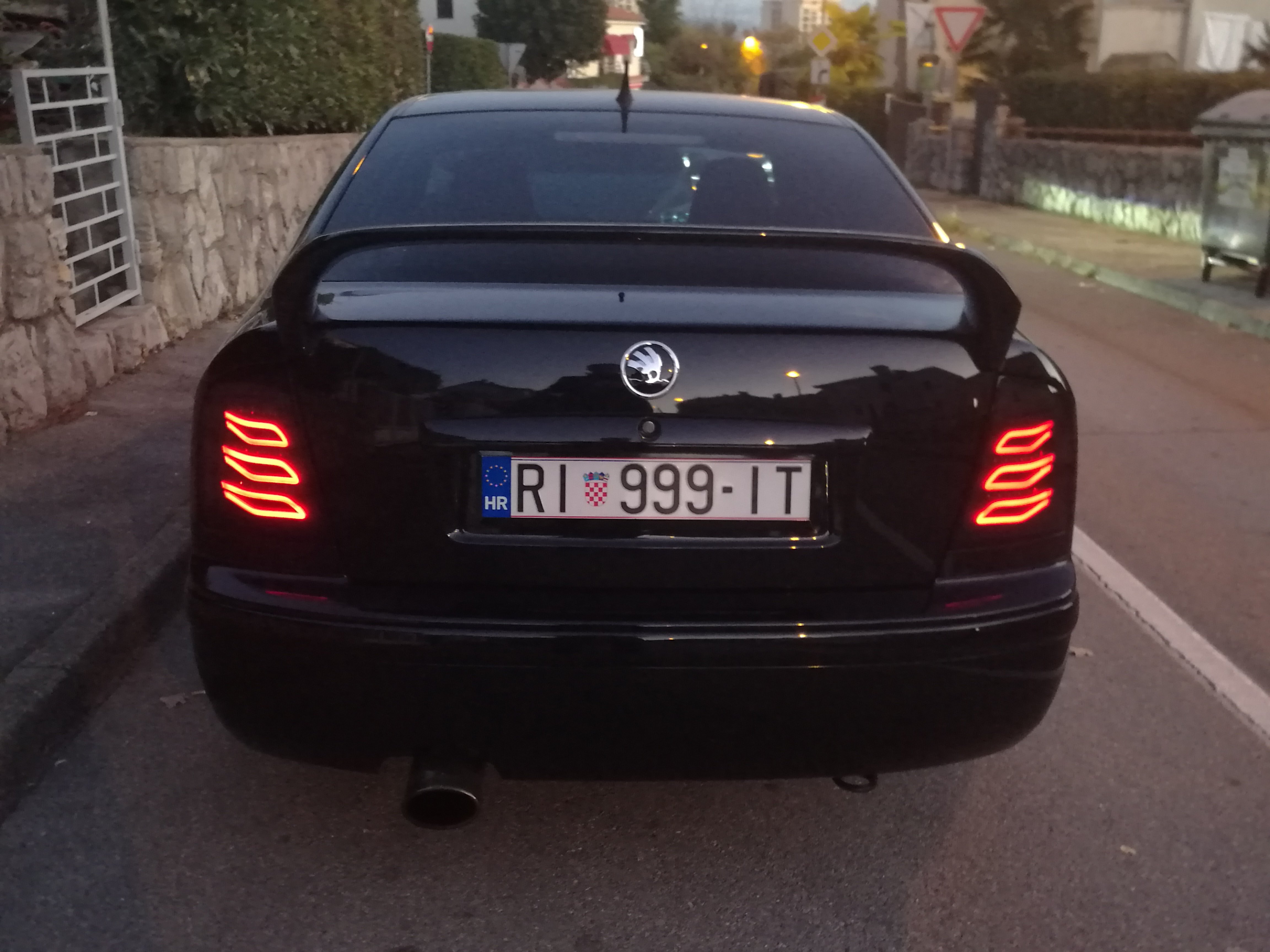

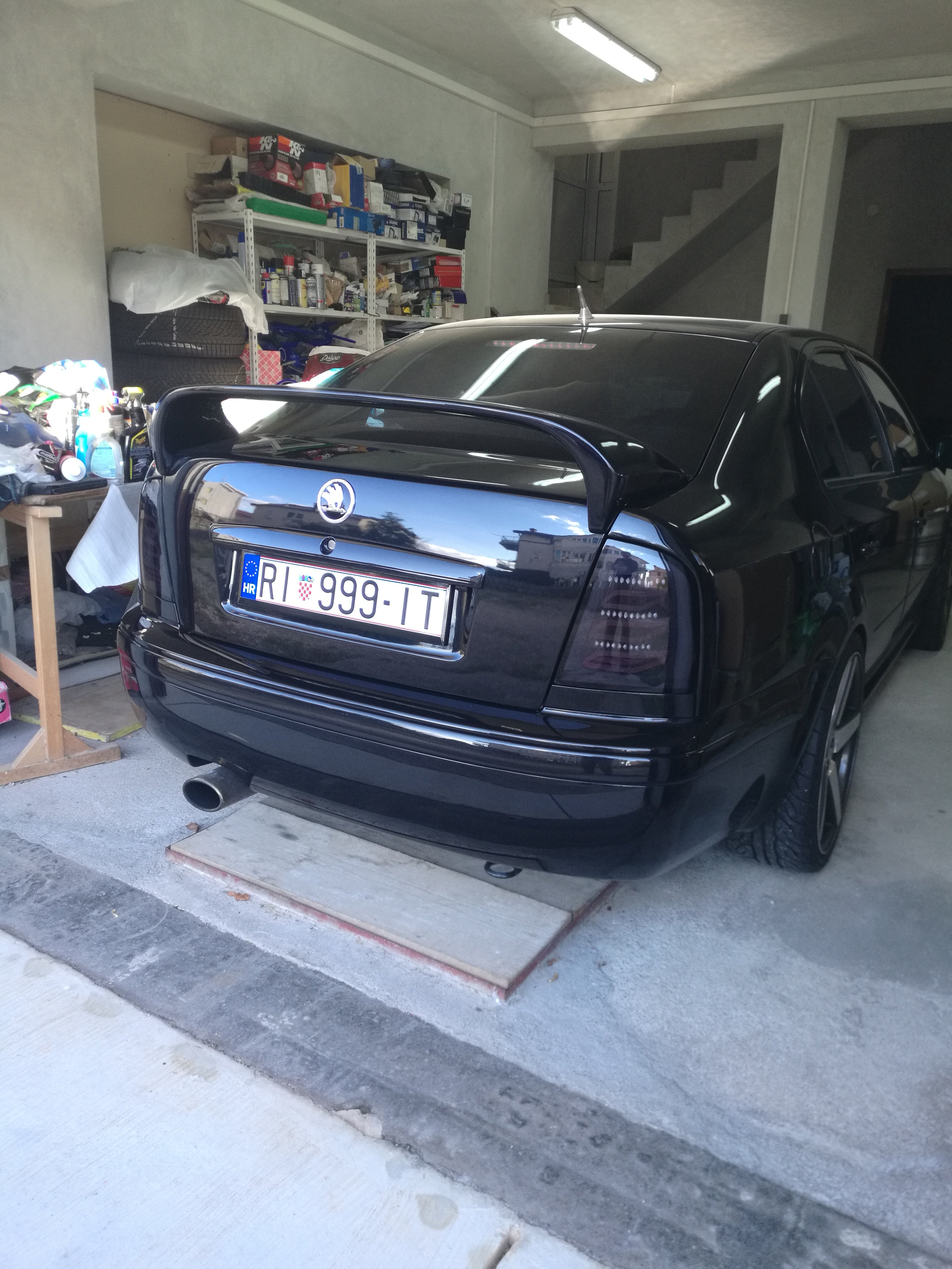

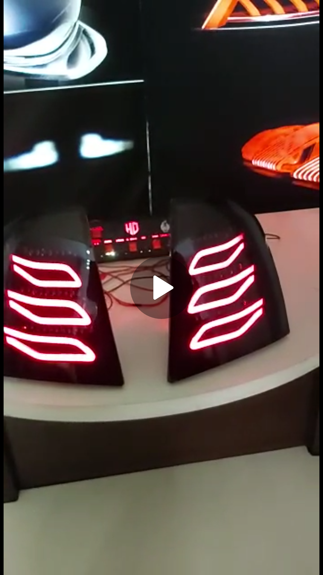

My brand New led tail lights made in Turkey, Istanbul
Some more pics after installation.
What do You think?

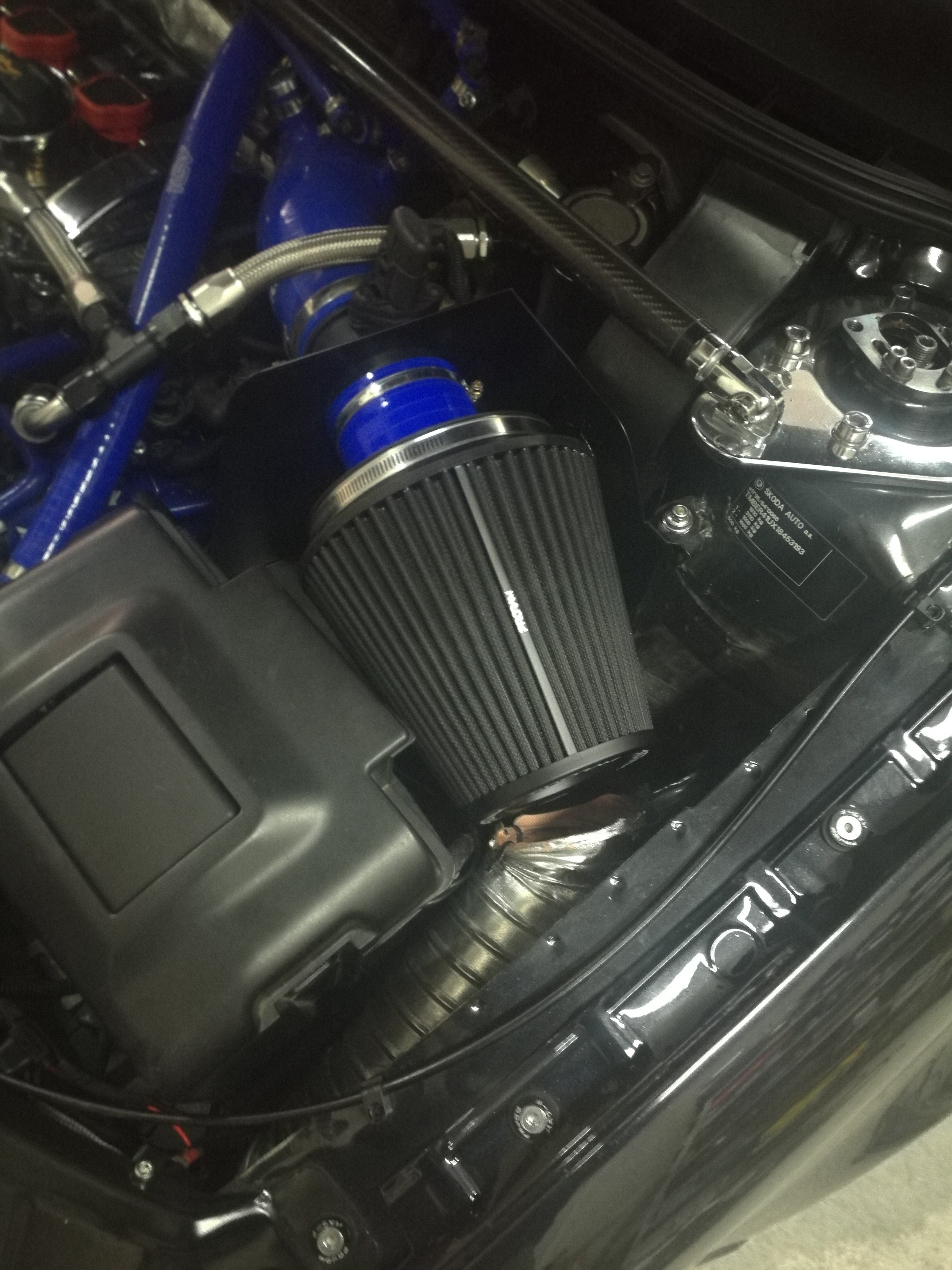

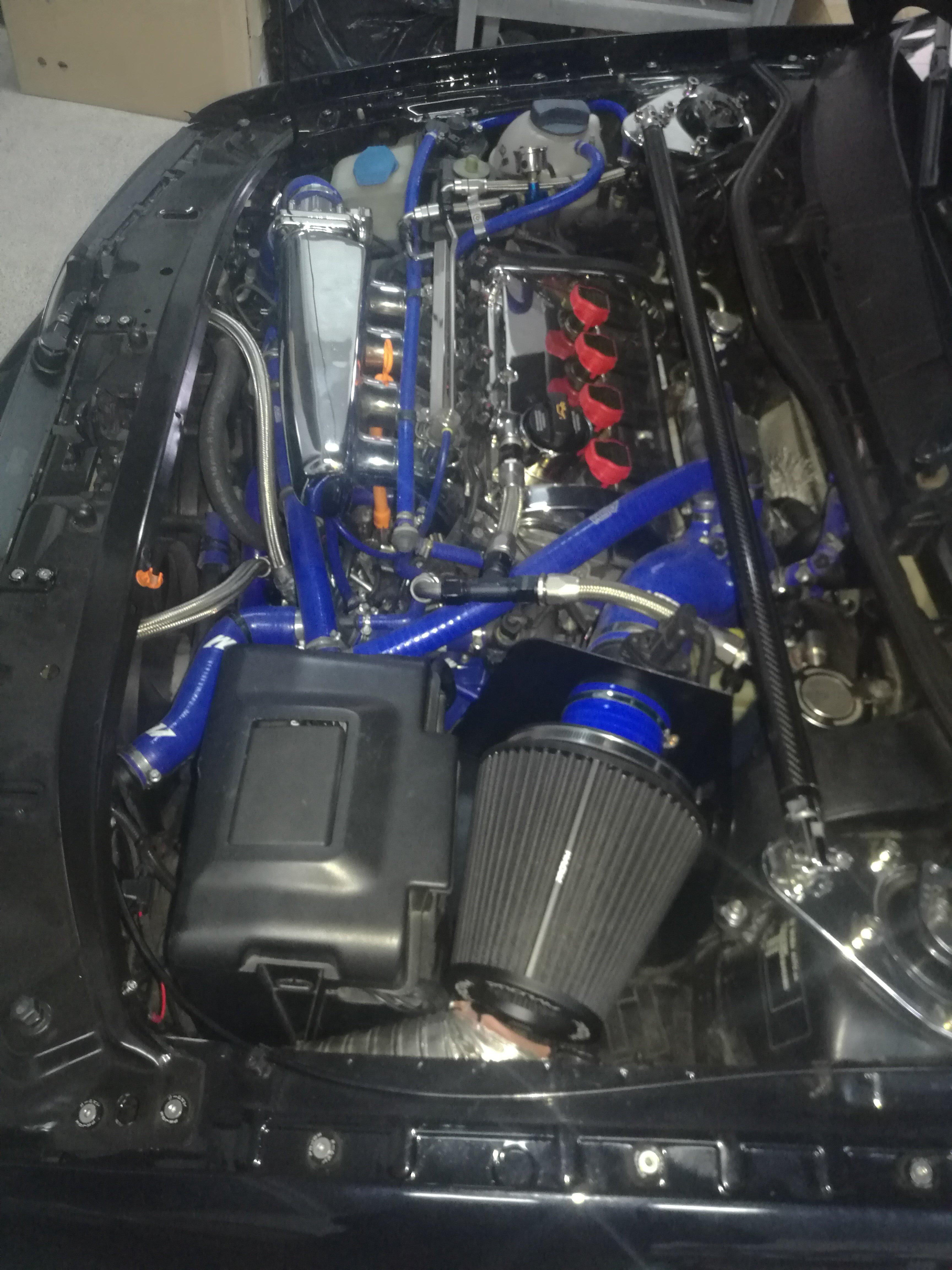

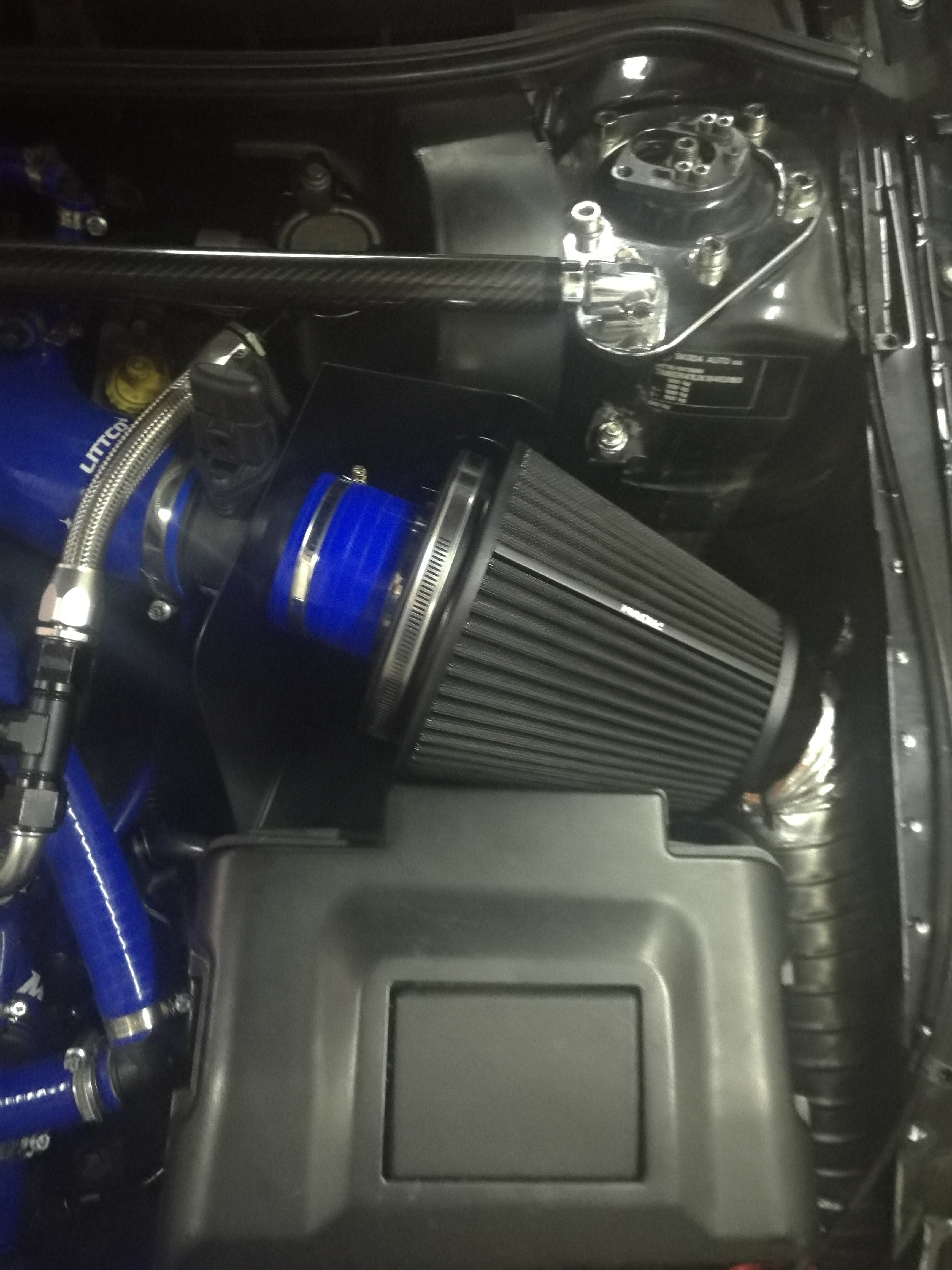

Finally Ramair Pro Ram L 80mm air filter arriwed. Waiting still for Cloud9customs Heat Shield.
Can't wait to test it
Edited by davojuri
On 07/04/2022 at 16:30, davojuri said:
Finally Ramair Pro Ram L 80mm sir filter arriwed. Waiting still for Cloud9customs Heat Shield.
pics when fitted  :)
Finally installed😁😁😁😁😁
Man You can hear it

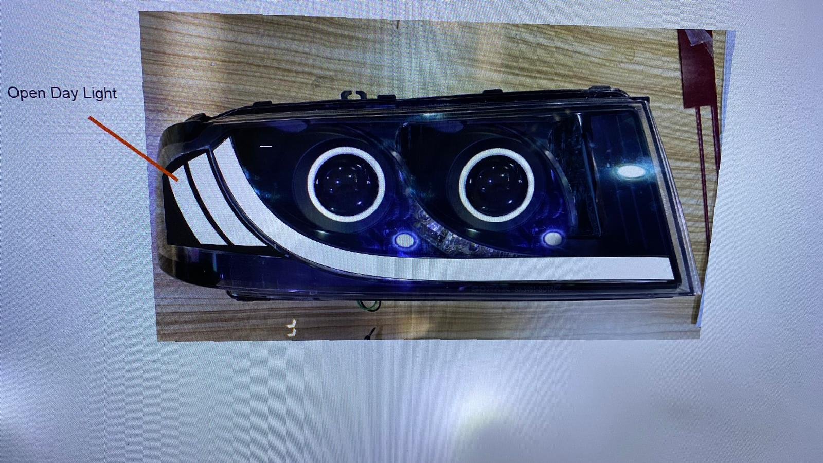

Now when custom tailights are done something new is commung for the headlights

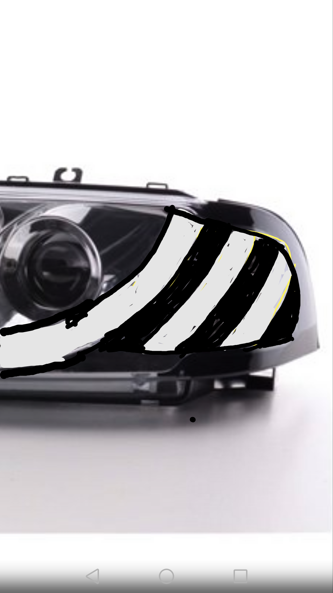

Custom biled projector 6000k for low/hight, custom morimoto shroud and led projektor 60000K for fog light, Morimoto halo led ring on both 6000K, full led strip 6000k for DRL and several small led strips for DRL and turn signal
That's how I corrected their drawing -elongated strips and added triangle at the end
Edited by davojuri
And this is how I draw it.
Which one do You Like most?

Sbeak prewiev od new Sonar aftermarket headlights with led strips, bi led high low bean projector and additional projector with Morimoto mini gattling gun shroud for fog led light. Stil two halo led rings from Morimoto Profile to be installed. All glossy black. Stunning!!!!
