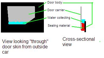

Having fixed (bodged) mine myself, it looks to me as though there's an issue with either the seal design and/or the sealing material. If you'll excuse the poor-quality and only vaguely-accurate diagram:
The door carrier is designed such that there is a section where water tends to collect. Because the water collects in direct contact with the seal, it means that the sealing material is constantly immersed when it rains. When I was sorting out my door, it seemed that the seal was made of neoprene or similar, which while being very spongy and thus ideal for making a seal airtight, it isn't actually waterproof so is completely useless at keeping water out! A little gutter spot-welded to the carrier just above where the seal sits would prevent the sealing material being constantly immersed, otherwise a rubber seal like around the inside edge of the door opening would keep the water out. Why it isn't done like that, I can't even guess!!!
