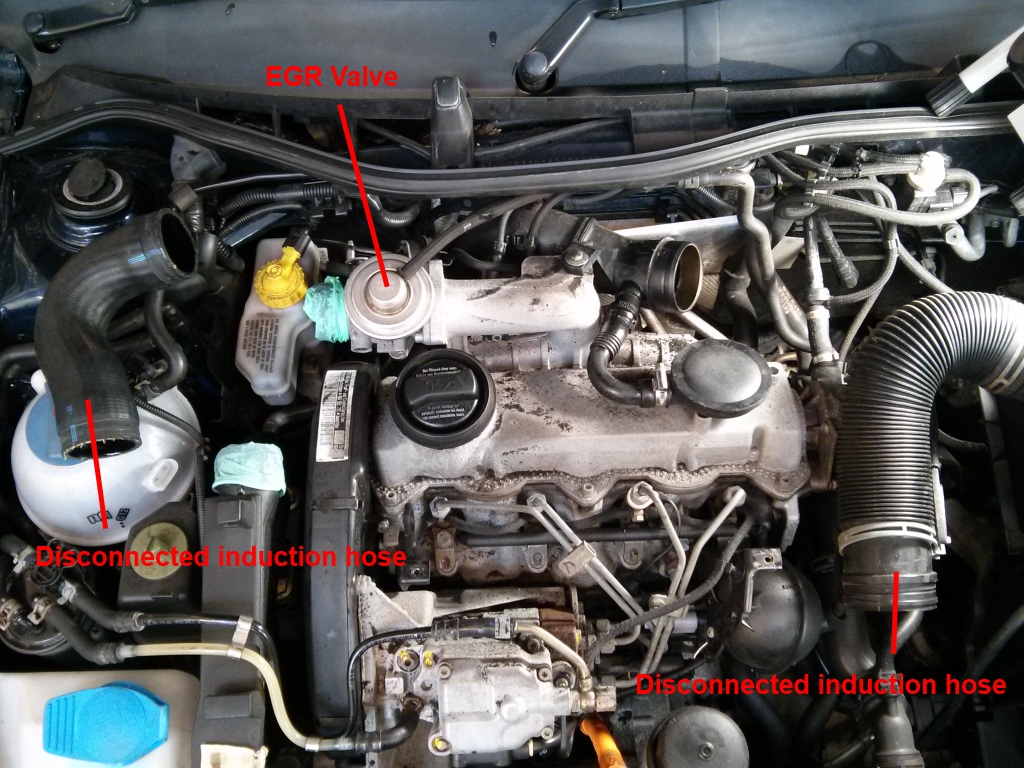

Just done this. I took some photos that might be handy for others.
This was done on an Octavia Mk1 Estate 1.9TDi 110 ASV (I think that's all the model info!)
This first picture show what was disconnected to get to the EGR Valve pipe that needs to be removed.
The left induction pipe I removed completely. The right induction pipe I just disconnected one end.
Both use simple spring clips - they're quite strong so you really need mole grips to get them off.
Once the left-hand induction pipe has been removed, you get access to the top hex bolts securing the EGR  Valve -> Turbo pipe. The bolts require a 6mm hex key.
Don't forget to cover the open induction pipes so you don't get rubbish in them. I use disposable latex gloves.

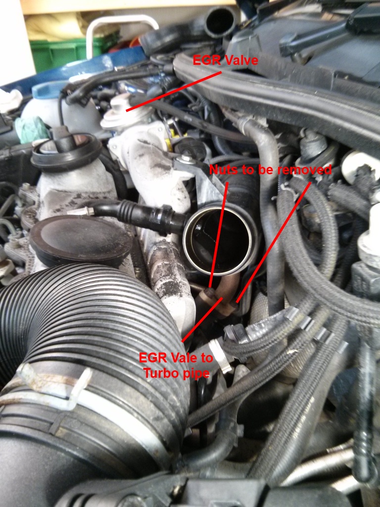

Below is a picture from the nearside of the car.
You can see the disconnected induction pipe and underneath you can see the bottom section of the EGR Valve -> Turbo pipe.
By removing this section of induction pipe, you get easier access to the nuts securing the EGR  Valve -> Turbo pipe.
The nuts on mine were 12mm.

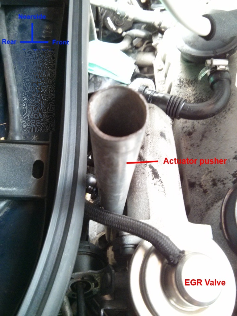

To make life easier and save your thumb, after you've applied Mr. Muscle, just stick a rod/pipe down the back of the engine to push the actuator.
