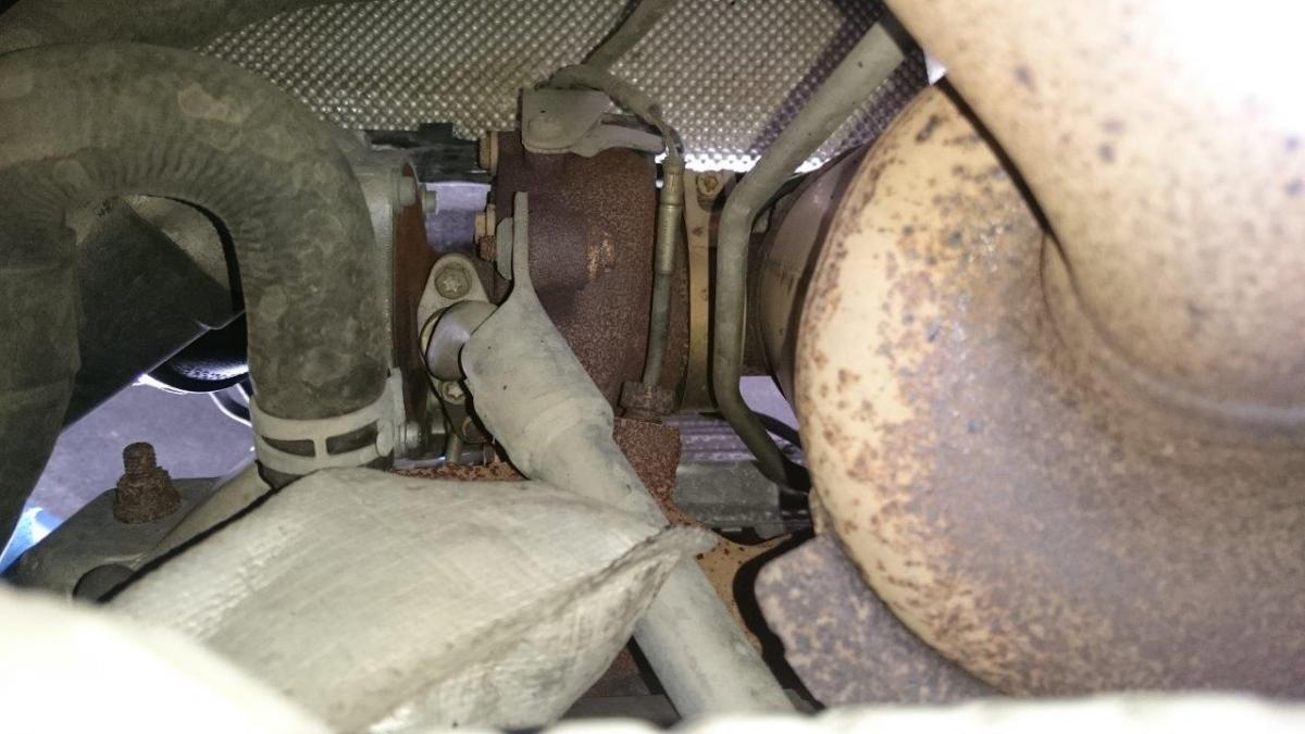

I've attached two photo's one of the bottom of the turbo, viewed from underneath the car,post-52897-0-18651900-1426155392_thumb.jpg

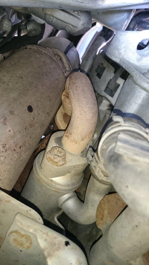

and another photo of the pipe I think will be the access point to exhaust side of the turbo.post-52897-0-40847700-1426155879_thumb.jpg

I have yes, its mentioned in the thread, it takes dexterity and patience but the small egr pipe under it did come off and i was able to replace with ease.
uno both ends of the egr pipe, and wiggle and swear and have a cuppa, kick the cat and return itll behave after that

I've attached two photo's one of the bottom of the turbo, viewed from underneath the car,attachicon.gifDSC_0612.jpg
and another photo of the pipe I think will be the access point to exhaust side of the turbo.attachicon.gifDSC_0622.jpg
