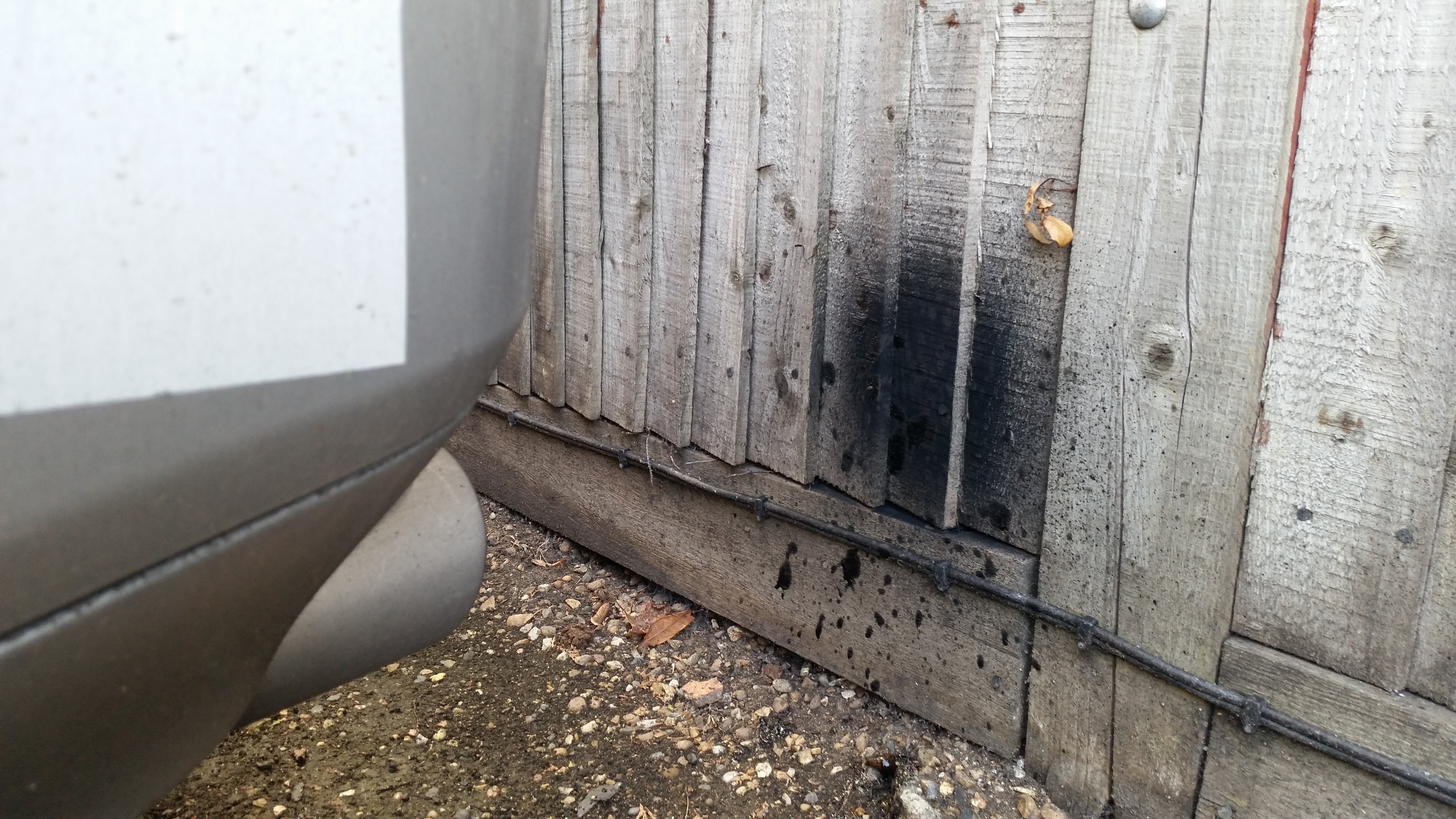

Might be worth noting : Try not to be parked up near something when you first start up :D

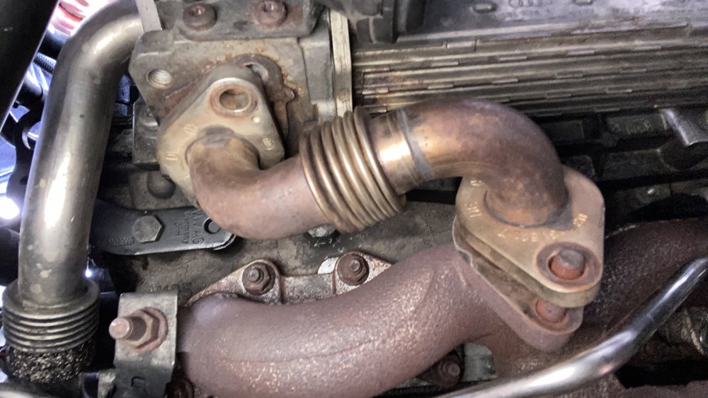

  • PIPE TO UNDERSIDE OF EGR WIDER VIEW SHOWING RATCHET POSITIONED ON UNDERSIDE ALAN KEY BOLT OF EGR PIPE TO MANIFOLD PIPE REMOVED SHOWING ALAN KEY BOLTS FROM UNDERSIDE OF EGR MR MUSCLE DOING
  • Right i know the engine, i did this treatment on a passat set up similarly. Egr on front of engine, pipe goes to right and around the back to the cooler. Underneath the cooler is a small version of th

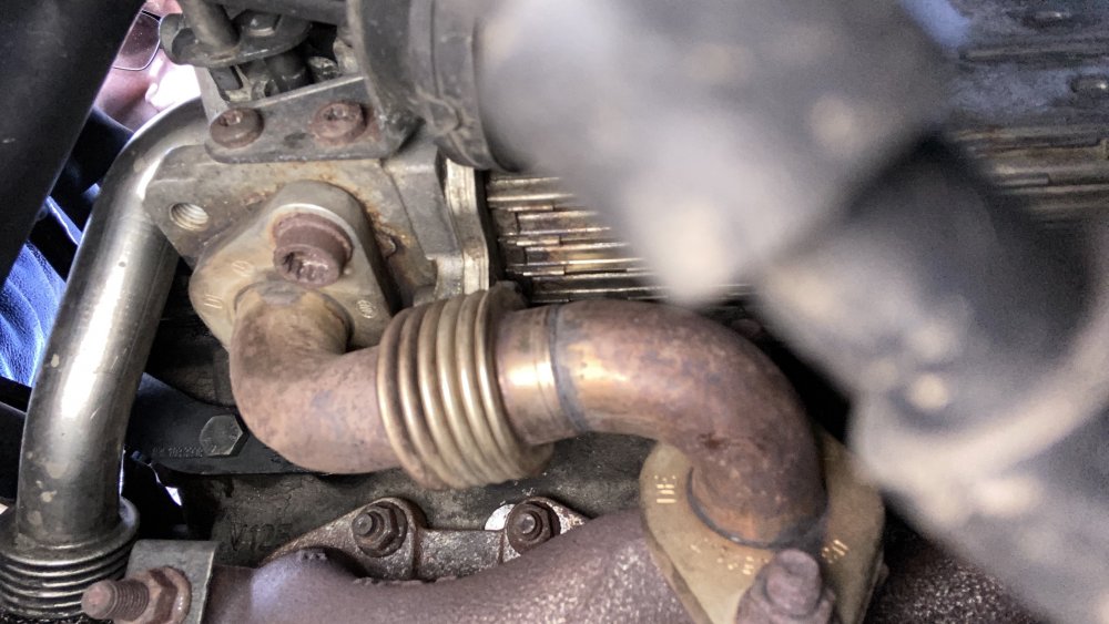

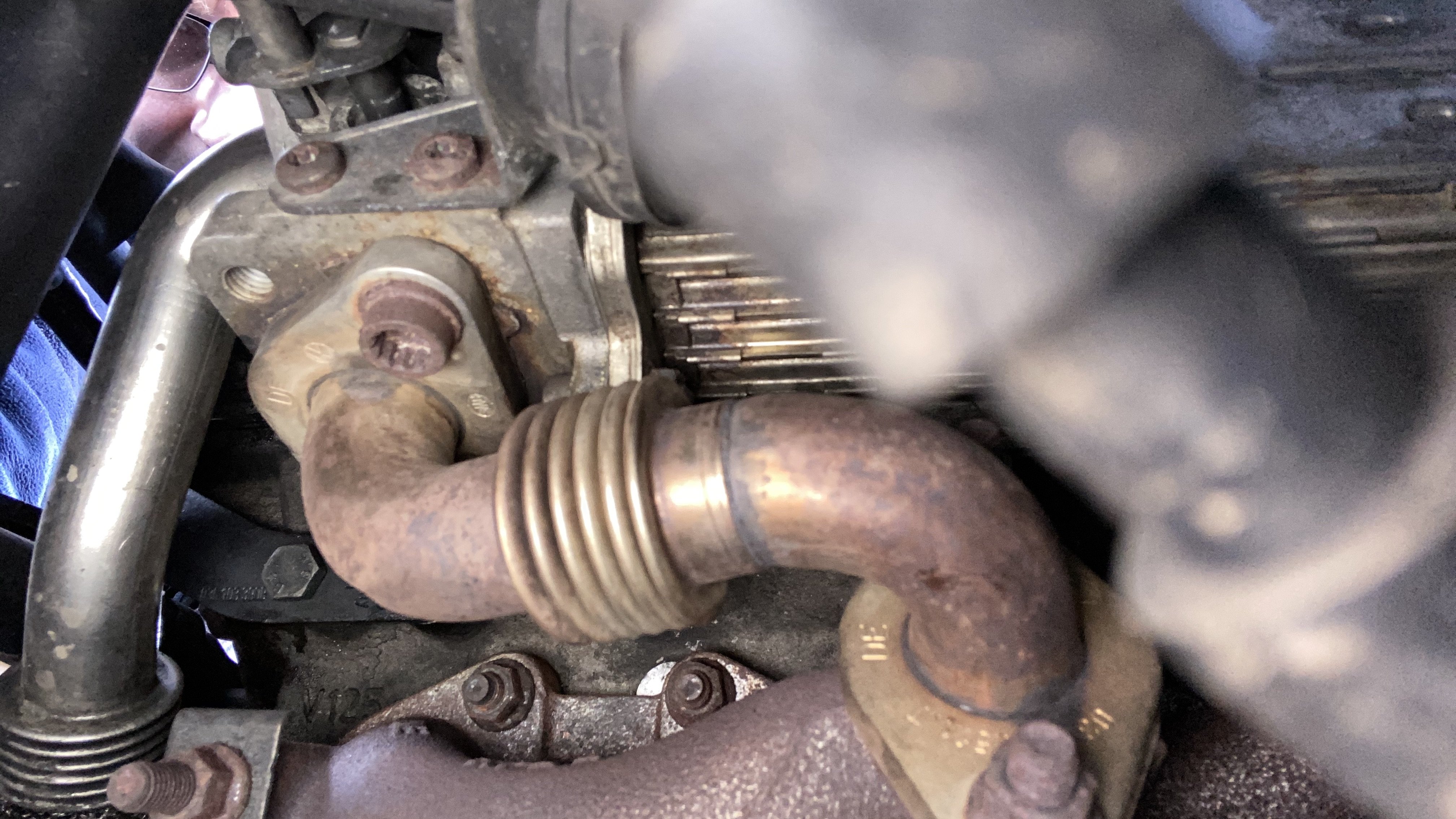

Another happy customer but on a vRS Tdi pD. Managed to get the small brass EGR pipe off enough from underneath (still terrible access) but managed enough to get the silicone pipe in. From above its impossible. Car has power low down the Rev range again. So happy! Only thing to note as I was so blind I wasn’t 100% sure it had gone to the turbo or the engine (risky but worked)

No it's immediately shot out the exhaust, no risks there.
Just read how many people have done it and not one case of problems with regurgitated Mr muscle

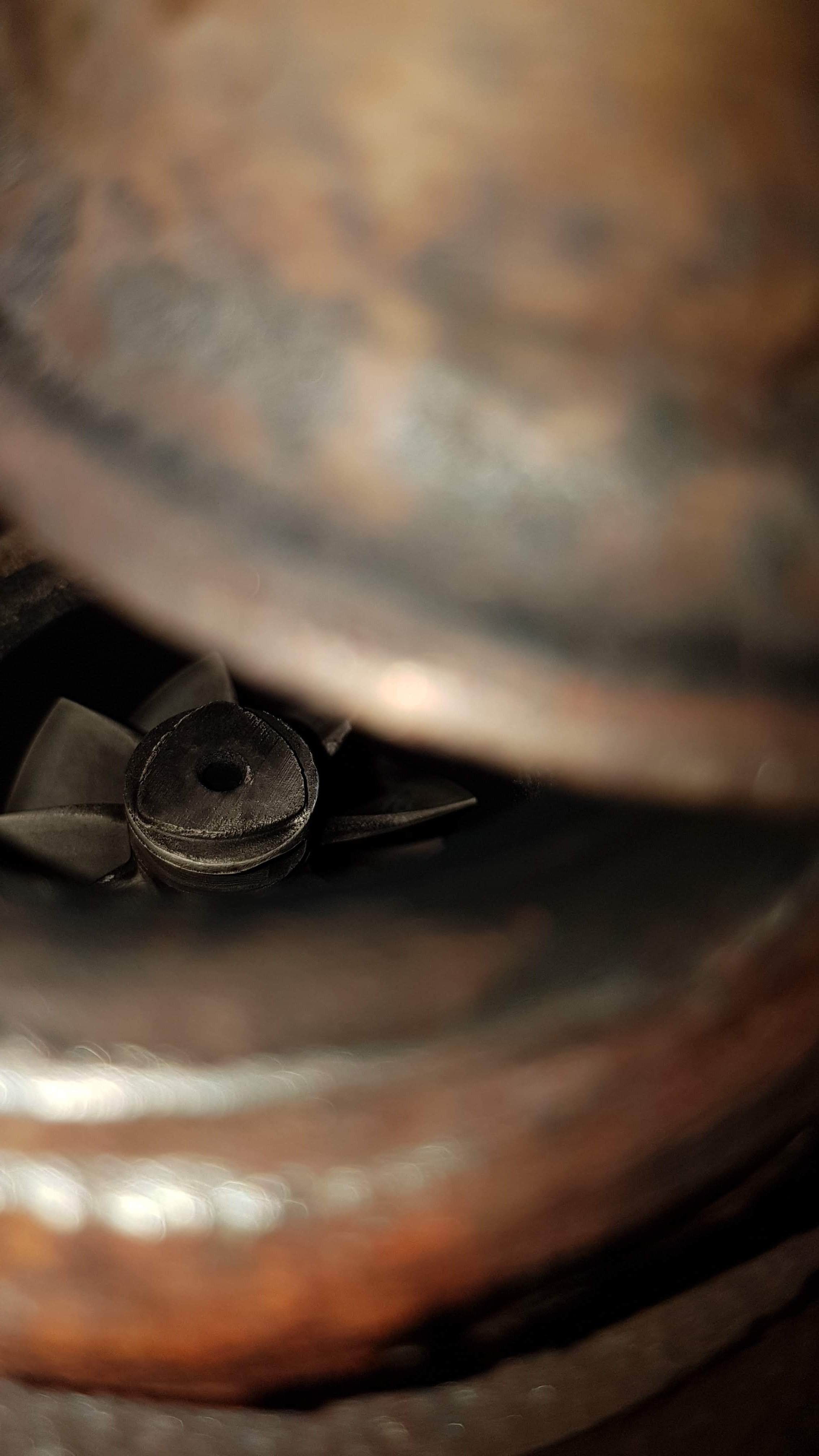

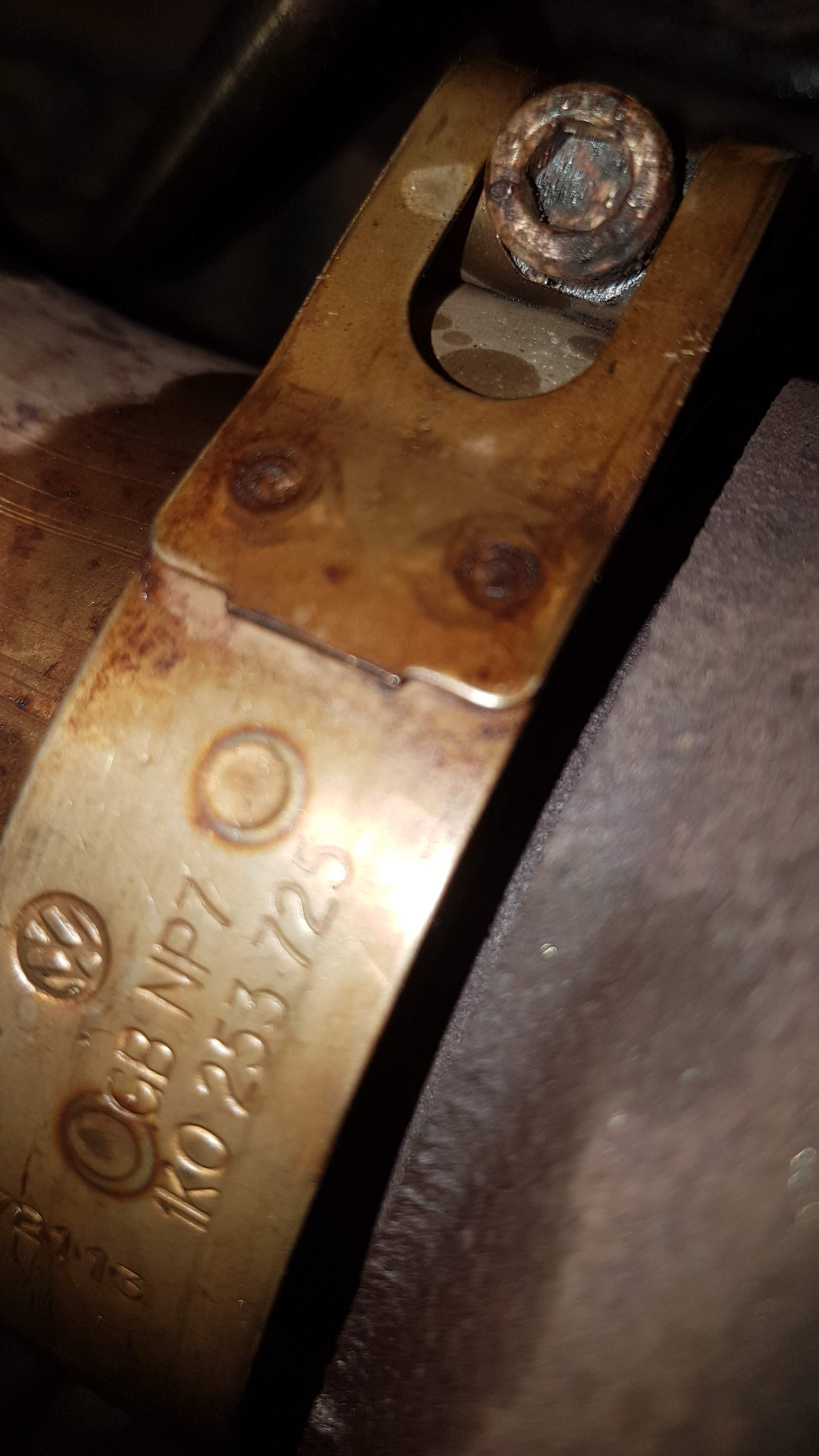

Have tried again, this time I have opened the hot side of the turbo by tasking off the V Clamp between the turbo and Cat. On this car access is really tight and the bolt for the V-Clamp was fitted along the top of the manifold directly under the oil feed pipe for the turbo. I accidentally removed the bolt initially and found that I  could not manage to get the clamp off or find the thread again after several hours of trying. Got a new one, tried again and totally knackered the clamp, that still stayed stuck. Ended up driving for a week with just corrosion holding the clamp on until I decided to just get a big jubilee clip and use it to secure the clamp and give up. Went under the car and the clamp was hanging loose. When splitting the parts, found the cat has a hanger using one bolt near the flexi pipe. In hindsight, probably removing this and giving it a shake would have loosened the clamp.
After splitting the pipes I had good access to the turbo, photo below and gave it a right good dose of Mr Muscle, even partially closing the opening back up to try and get as much in as possible. Actuator has always seemed to be free though and was moving OK as far as I can tell. followed the 2 hour process, actuating the actuator several times. Built back up and just as bad as It was.

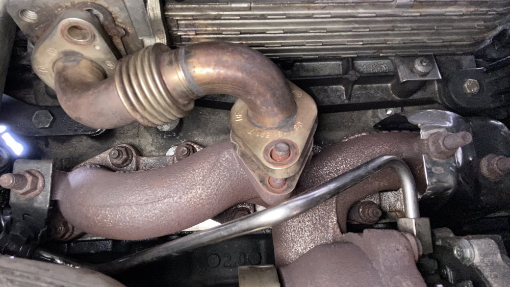

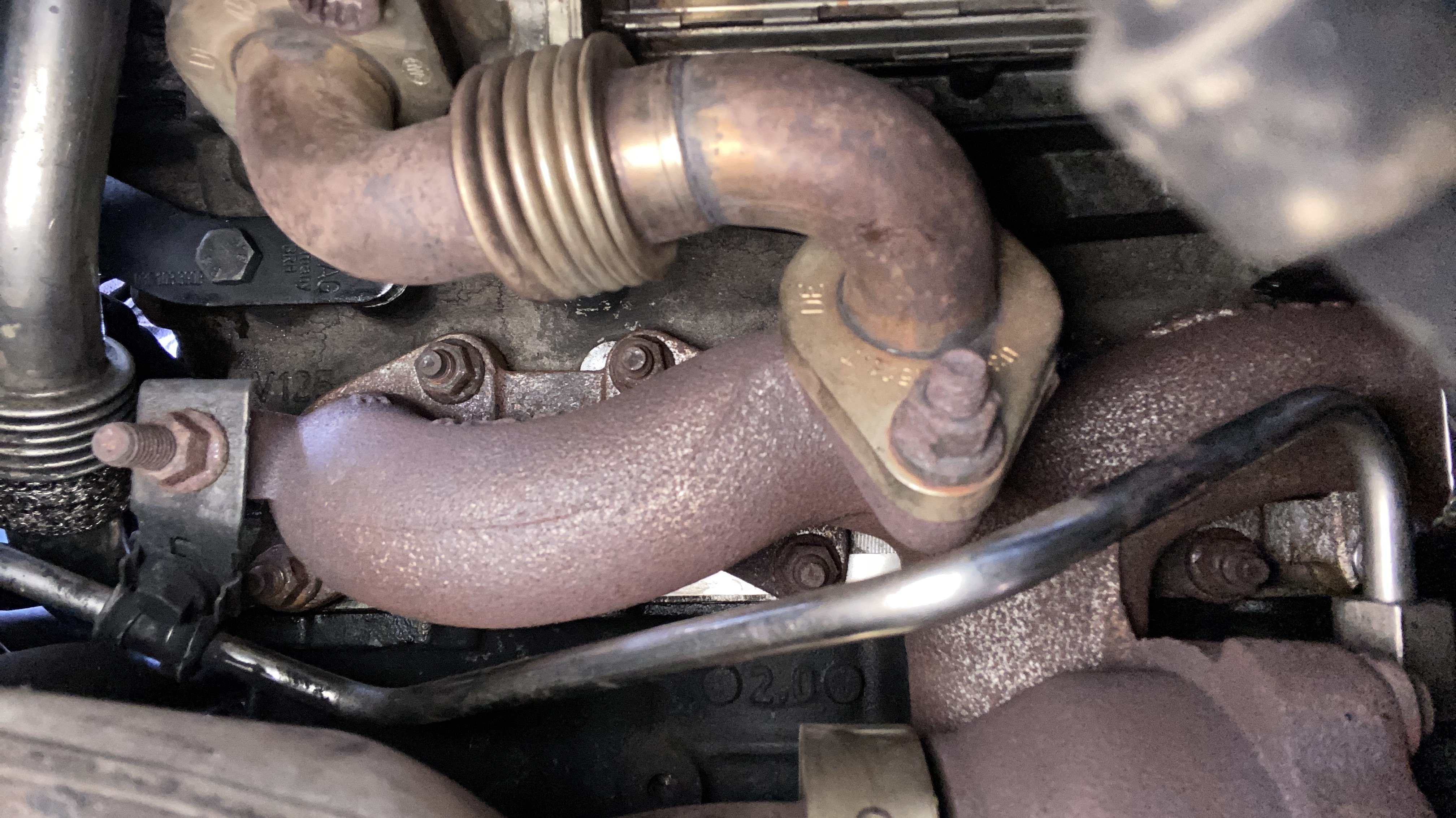

So today I was changing oil and filter and decided to try to clean turbo. Not that it needed cleaning, although it whistles a bit so I thought maybe it will help. Btw the engine is BKD.
So I took out air box and pipe that continues after MAF sensor, and had to take out the battery with casing as well.

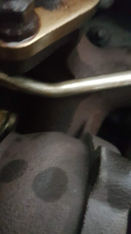

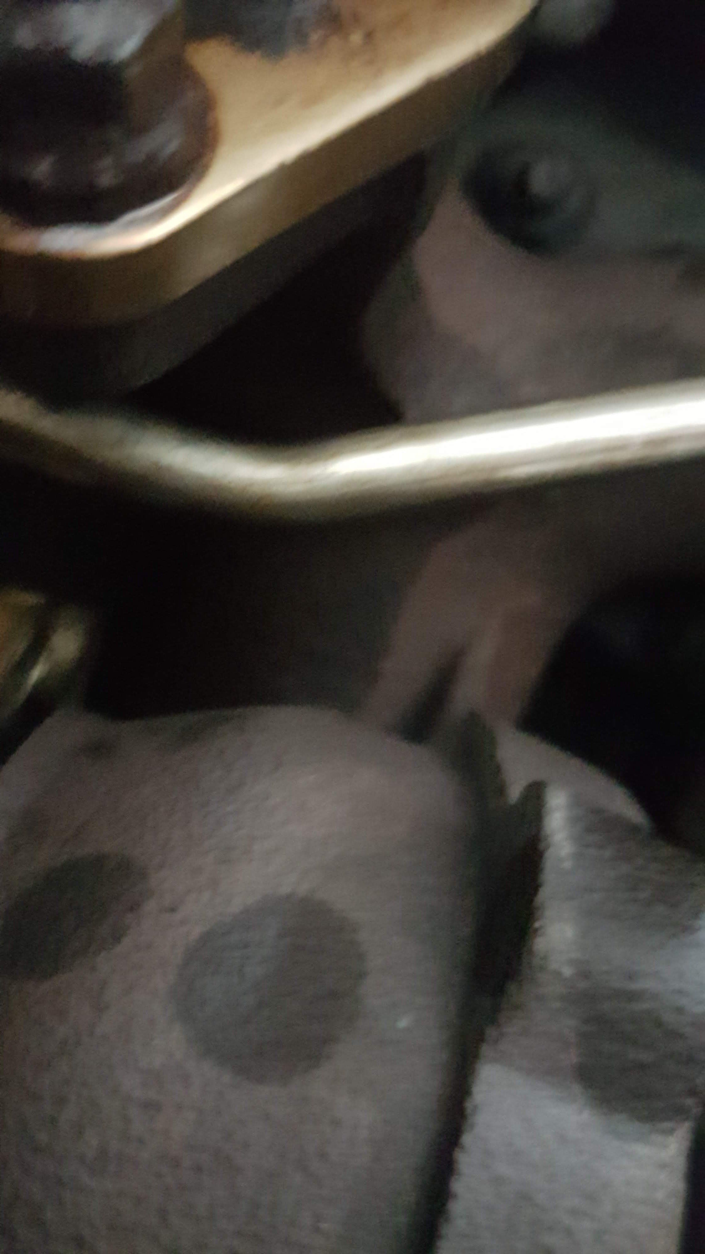

As didn't know what to look for or what to unscrew I put my phone behind the engine, just above the catalytic converter, aiming the camera below the EGR cooler (I think) and made a few pics to try and figure out how to get into the turbo. Basically, I made a picture in my head and unscrew the bolts on small pipe that goes from cooler to manifold, all by touching as couldn’t see anything. It’s very tight over there and you will have to work out where to put the socket wrench. Once you figure out how things are positioned it’s pretty easy to do it.
The bottom nuts, on manifold are 12mm socket and the top ones, on cooler are bolts triple square spline bit size 8 i think.
I then put a tube in the manifold and pushed it all the way to the turbo and started spraying. I had 6mm tube and it was too big so I would advise you to get smaller diameter, maybe 4mm. Someone mentioned a flexible tube from WD40 spray, that would be ideal I think. I couldn’t not spray in enough due to tube being too wide and the cleaner was leaking everywhere on side so this operation was not quite successful.
