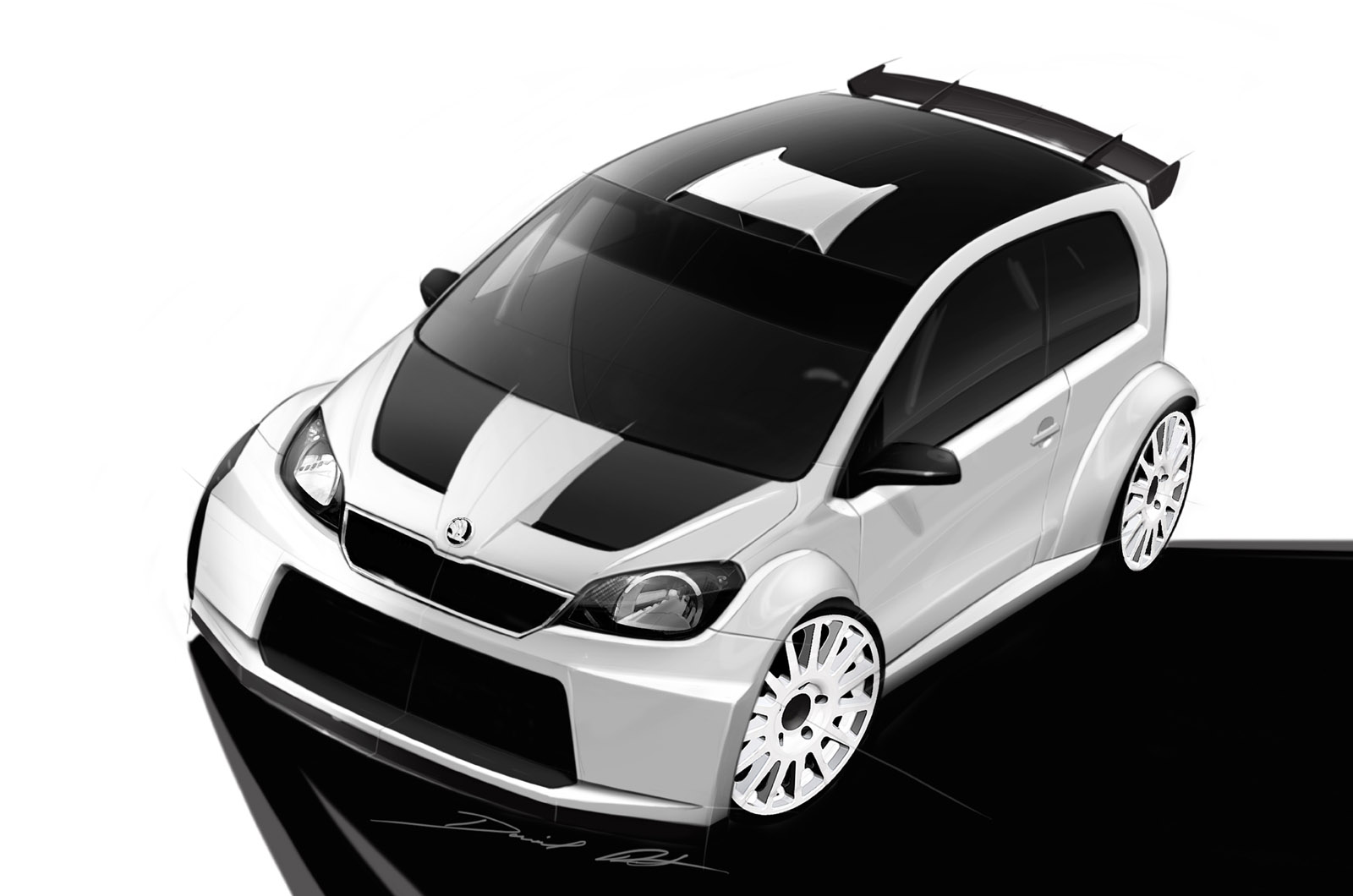

CitiGo-Go, a Citigo with more Go.
Only if we don't want fit an turbo and/or manifold. :D
The Citygo only seems designed to take a 1.0 3cyl engine, or something of a similar size.
