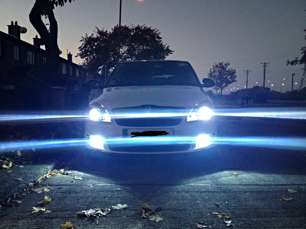

Got the headlights and fogs done, looks pretty good
