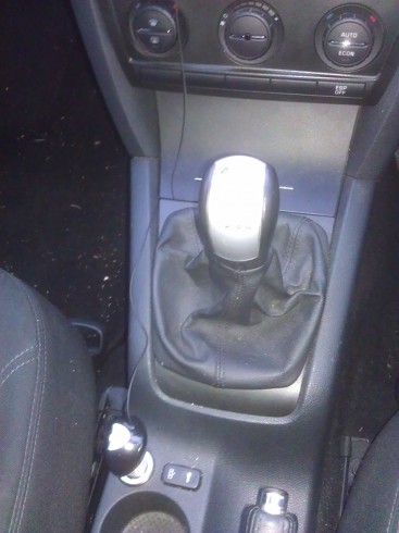

For the times I plug in my phone to use as a satnav, I route the cable to the side of the gear lever and clamp it down using the lid on the storage tray infront, so it isnt loose and in the way.

For :) the times I plug in my phone to use as a satnav, I route the cable to the side of the gear lever and clamp it down using the lid on the storage tray infront, so it isnt loose and in the way.
Could you make a photo of your cabling, if it is not too much bother? Thank you

Its a little late, but as promised, here is how I route the cable to my phone, so its clear of the gearstick.
