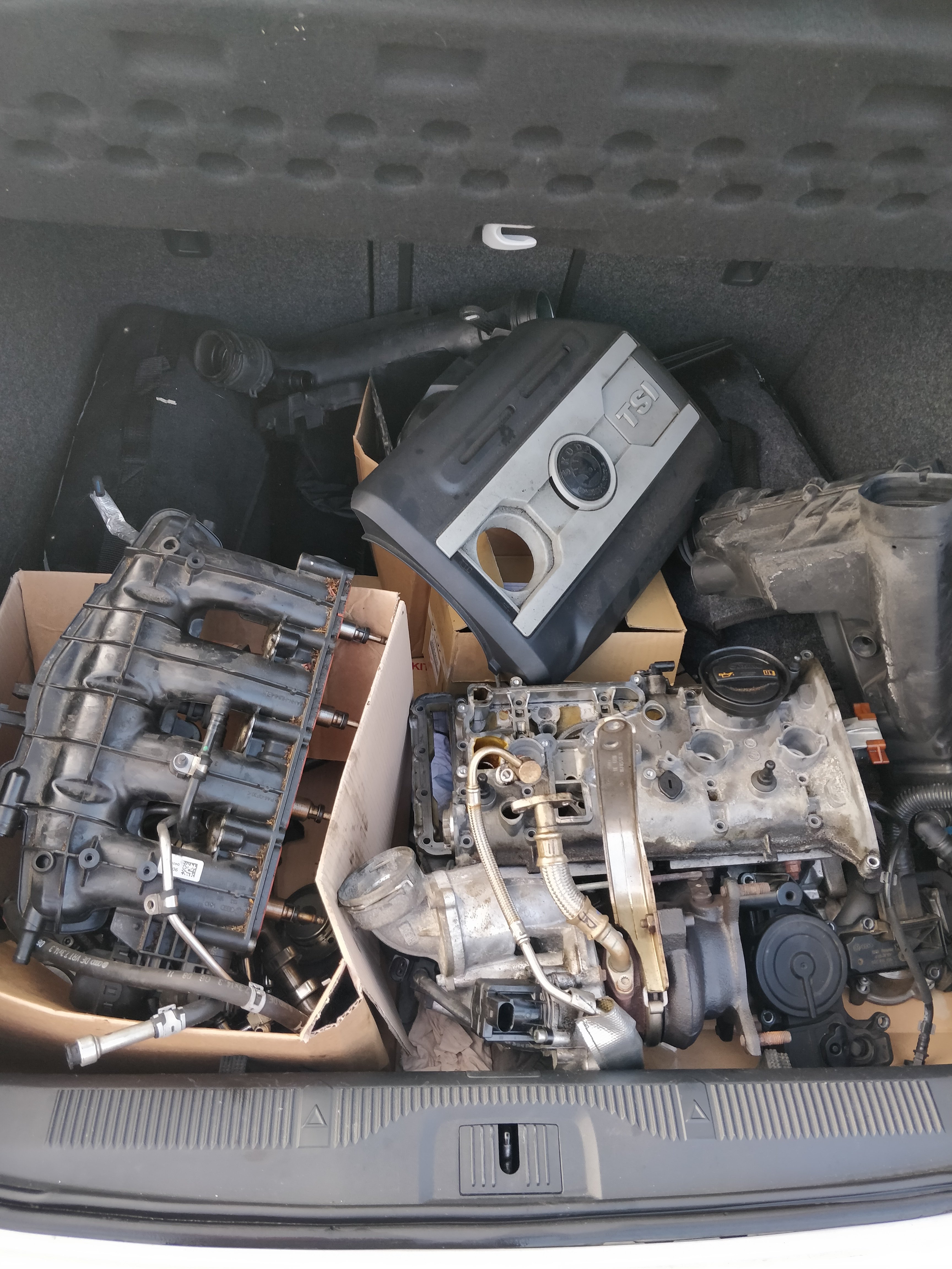

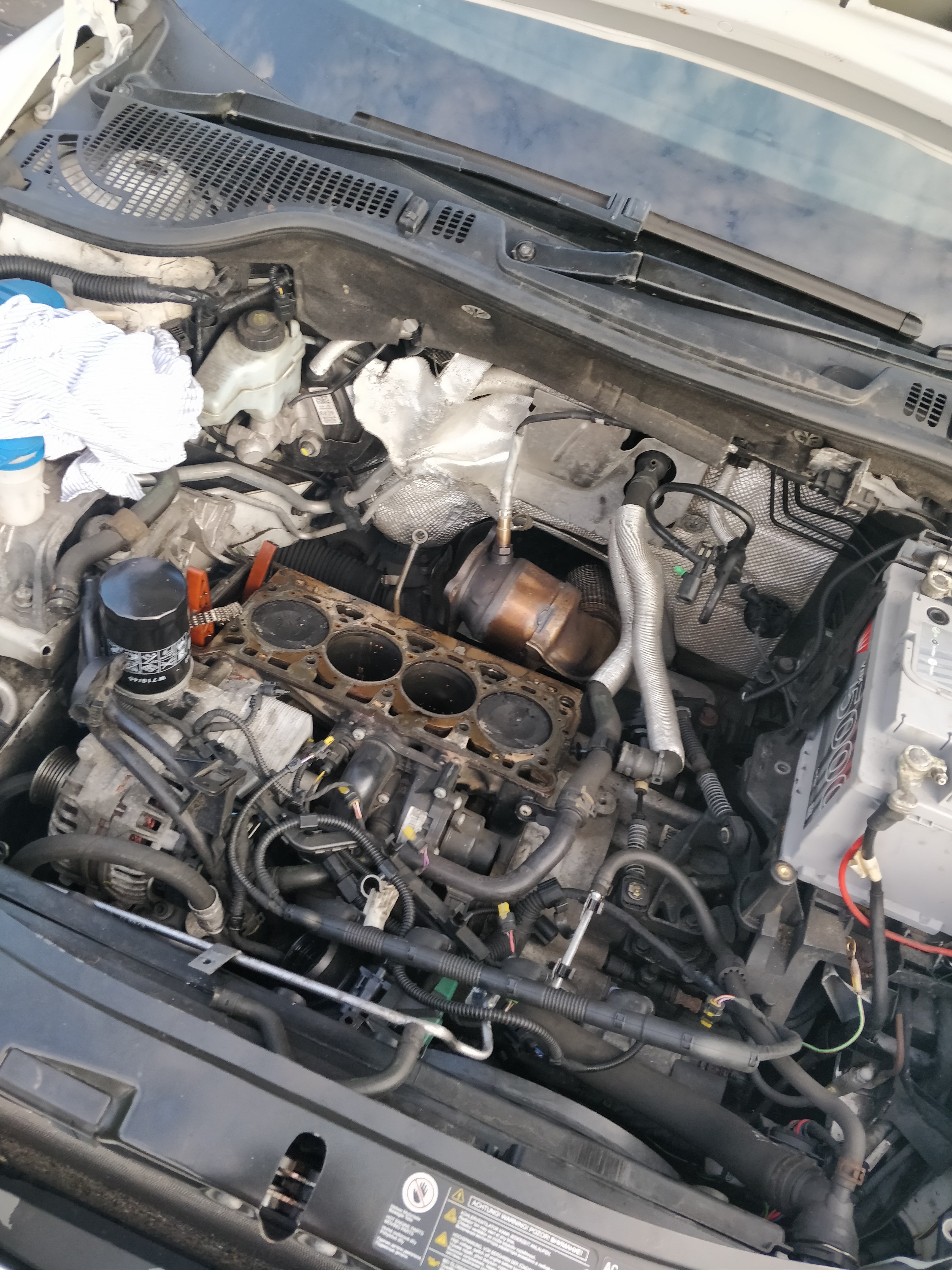

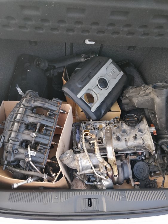

hey guys...... looks like i am the latest victim of the ticking time bomb i.e. the 1.8 tsi engine..... today i was changing the spark plugs an behold found the spark plugs on piston 2 and 3 are oily. 1 is fine and 4 is not so fine. I guess i will have to get th pistons and the rings changed.
Since i am supposed to change the pistons and rings i might as well get forged pistons this time. Will be changing my water pump as well as the chain tensioner. Please can u guys help me so as to where i can get the parts from? Links and suggestions are welcome.
