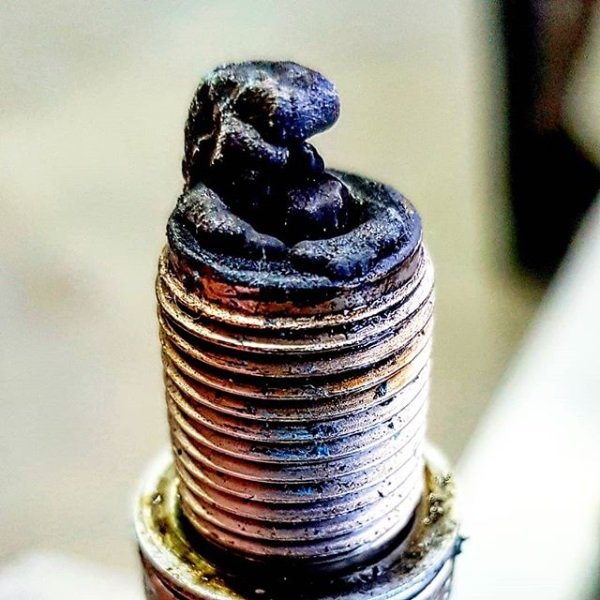

EA888 1.8TSI, engine CDAB, 112kW, mileage +200 000km
oil consumption 1 liter per 200km ...
I had a sparkplug fouling last year but no where near as bad as that! 😳
