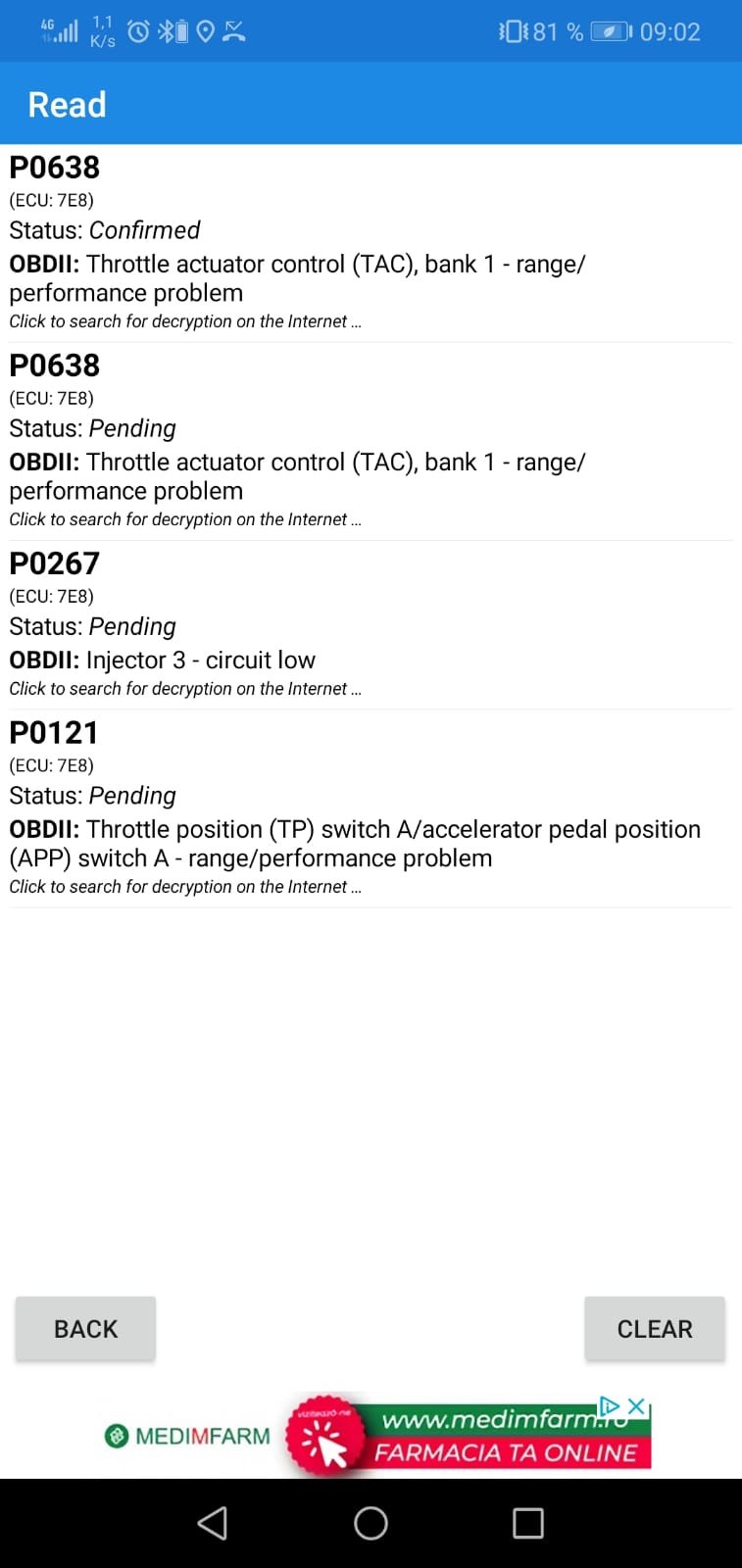

Hi there. I'm the new proud owner of a black beauty: Skoda Octavia FL Combi 1.8 TSI + LPG. And while the engine refrains itself from eating any oil and is rather silent while under operating temperature (80 Celsius or higher), it does have a weird temper while cold.
I get misfires on cylinder 1 (P0131 I think) and today I got a bonus round of errors.
Have you ever seen something similar? Because I didn't in any of my previous cars.
Actually, other than changing the spark plugs with NGK ones (designed for LPG), I also went to Skoda and did a compression test, it got 11 bar on 3 of the cylinders and 10 bar on the 4th one. So it shouldn't be a compression issue.
I really suspect a culprit on the electrical side, being either the battery or some gremlin in the wires.
What do you think?
Oh, and thank you if you take the time to answer to this post. :)
I haven't seen the combination of errors. First instinct, if it were a conventional petrol 1.8tsi, is either coil pack or injector problem if plugs are ok. Swap cyl 1 coil pack and see if problem changes cyl.  Also, suggest opening a new thread with a specific title to your problem.

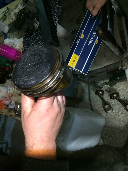

So, we have change the pistons, piston rings, con rod, chain and the tensioner. The mechanics did an outstanding job and I am very grateful to him.
Attached please take a look at the old piston. It looks awful. Bear in mind that the car has done only 112k km with it.
Regarding the fuel consumption, the car uses 7,8-10 liters per 100 km.
I have only done approximately 300km with car after it has been repaired. So far it had used 0,5l of oil. Is that normal?
Not unusual for a rebuilt engine. You are running / driving in the engine.
Get to know the Cold Check oil level & then the At Operating Temperature oil and then do not overfill.
What oil are you using now?  5w 40 FS to VW502 i hope and not 5w 30 FS III (long life) VW 504 / 507
Did the garage get the bores honed? - This can be usual to help new piston rings bed in.
With the fitment of new rings and pistons you need to effectively run in the engine - probably more so compared to a brand new one as you have new parts bedding into worn parts (the bores!) .  Be careful for a while as new rings can have a hard life especially against a bore wear lip. I used to fit "stepper" rings on engines where I was installing new pistons/rings into a block that hadn't been re-bored.
As is usual when you get a new car, whilst bedding in the new parts oil consumption may be higher for the first 1000 miles or so.

A big thank you to @Roottootemblowinootsoot and @bigjohn for reply which got me some peace of mind regarding the current oil cinsumption:)
Yes, the bores had been honed. Although I do not know what does that mean, I remember that the mechanic told me several times that he did that. He also checked the cylinders with camera to see if they are not damaged before he went to change the pistons and everything else.
Regarding the oil, I am now using 5-40.
