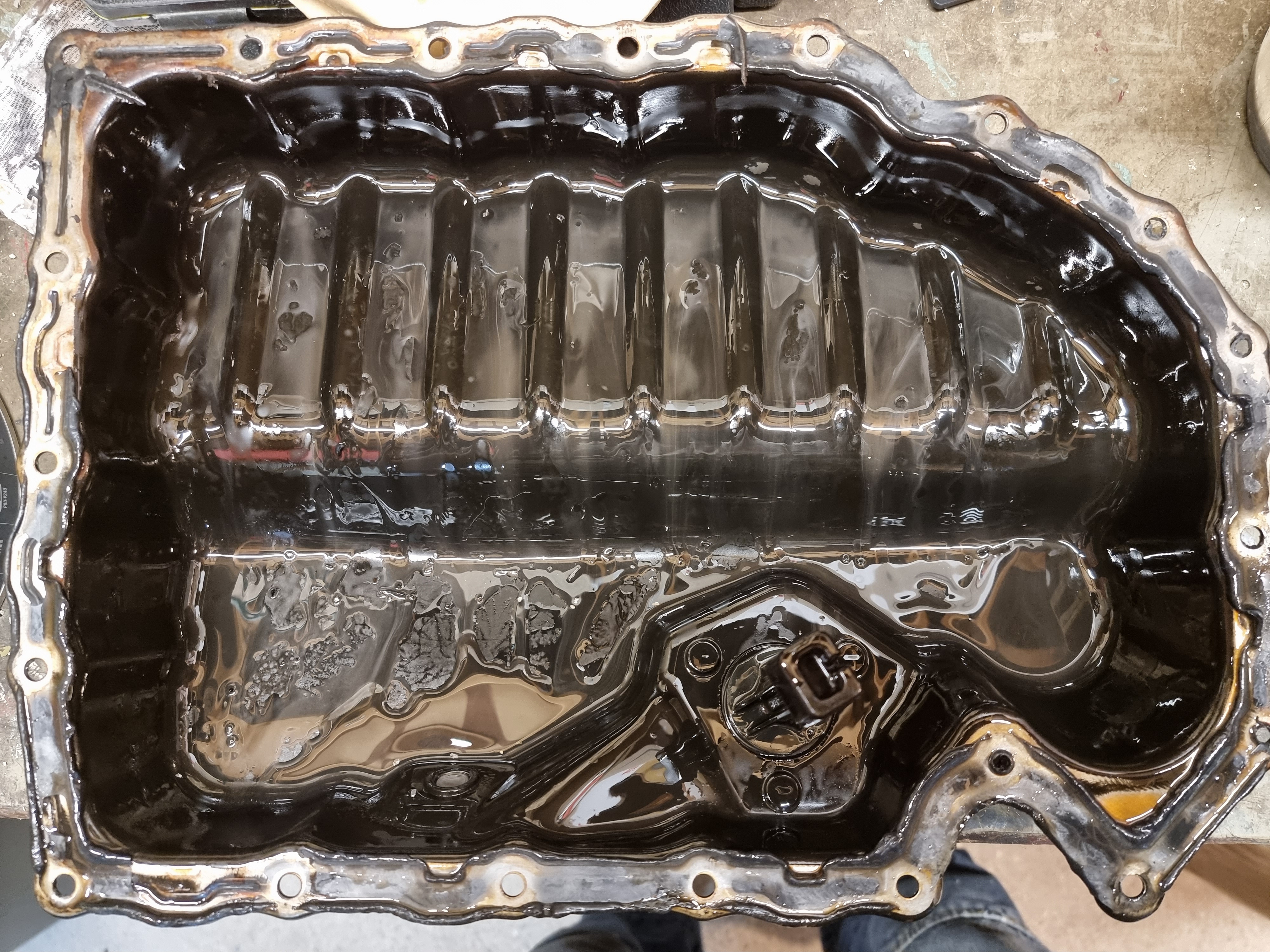

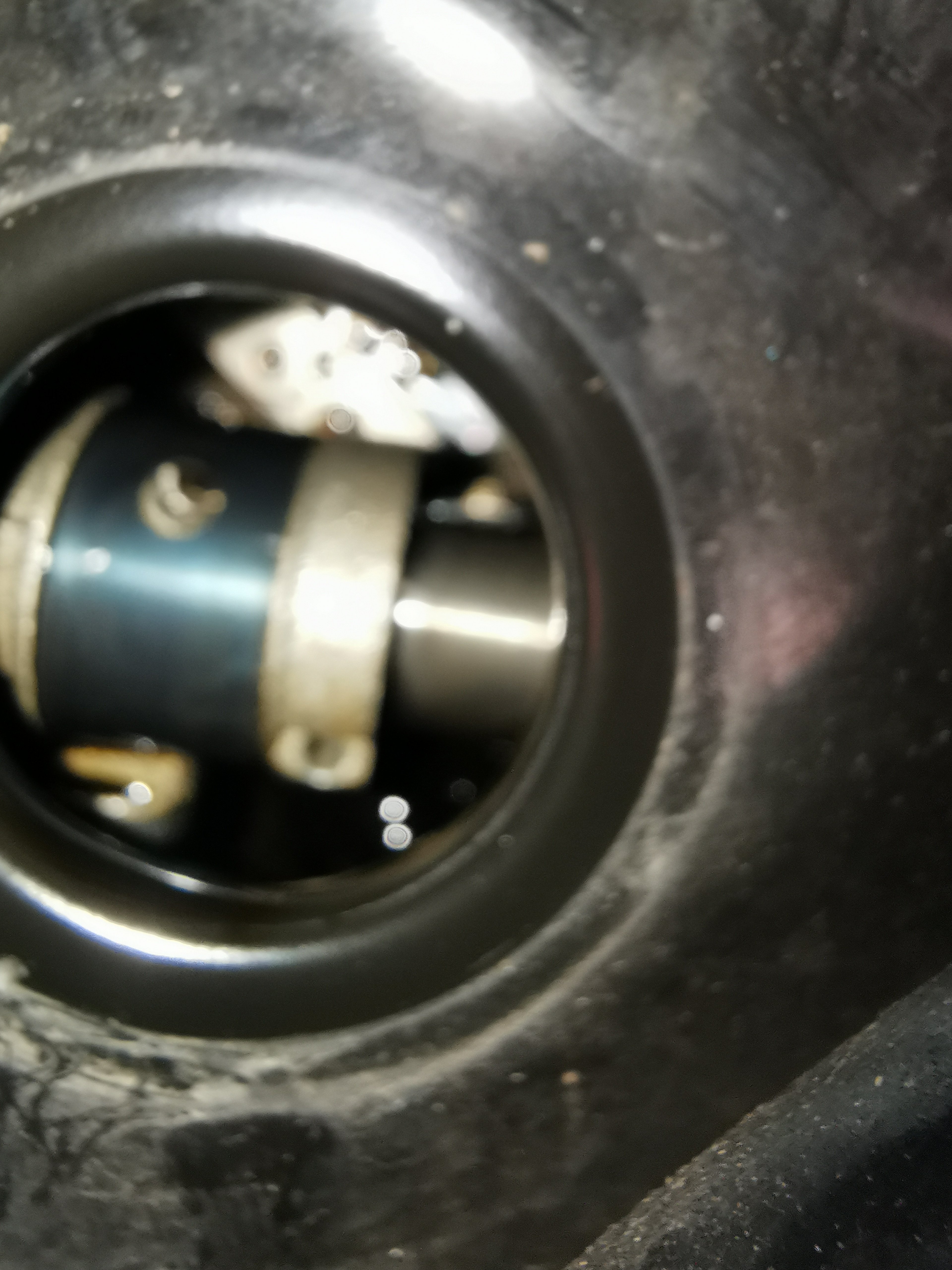

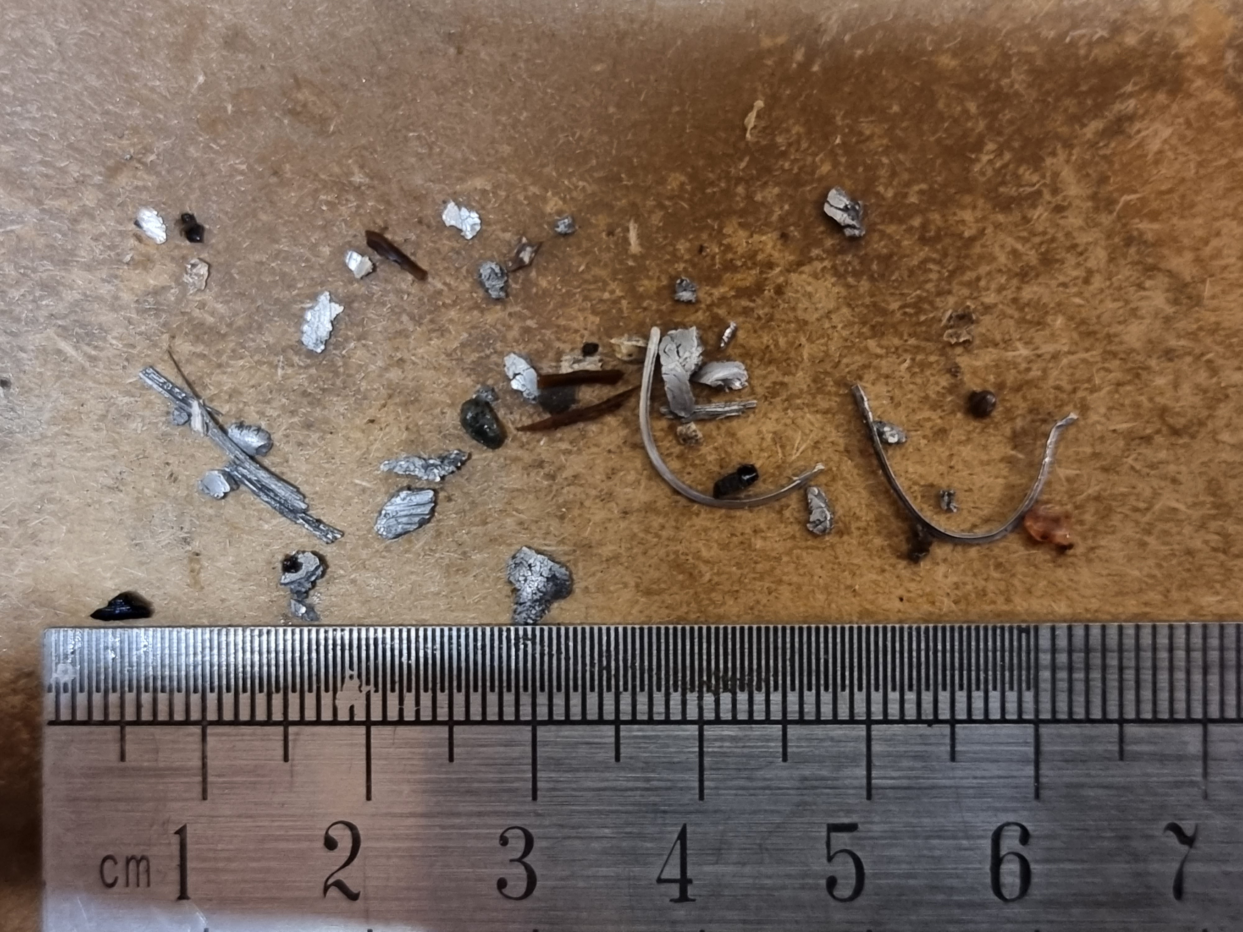

I just started tracking my 2009 ccza 2.0 tsi and got low oil pressure.
Dropped the sump and found small crumbly type pieces of aluminium (nothing ferrous).
Going into a specialist this week hopefully, but believe one of the balance shafts has seized due to high oil temp and possible starvation when i went hard round a turn.
Seems to be creeping into road cars as well depending on servicing and other factors. What an engine eh? Haha
Previously has new rear main seal and pcv due to failure, new intake valves due to the failure and preventative maintenance of camchain and tensioner as well as bearing and piston rings whilst they were in there. Spent more on the engine than what the car is worth since i bought in December 2019.
Good blog from a garage regarding the balance shafts going with almost identical pictures of debris to mine.
http://robisonservice.blogspot.com/2019/06/timing-chain-and-balance-shaft-failures.html

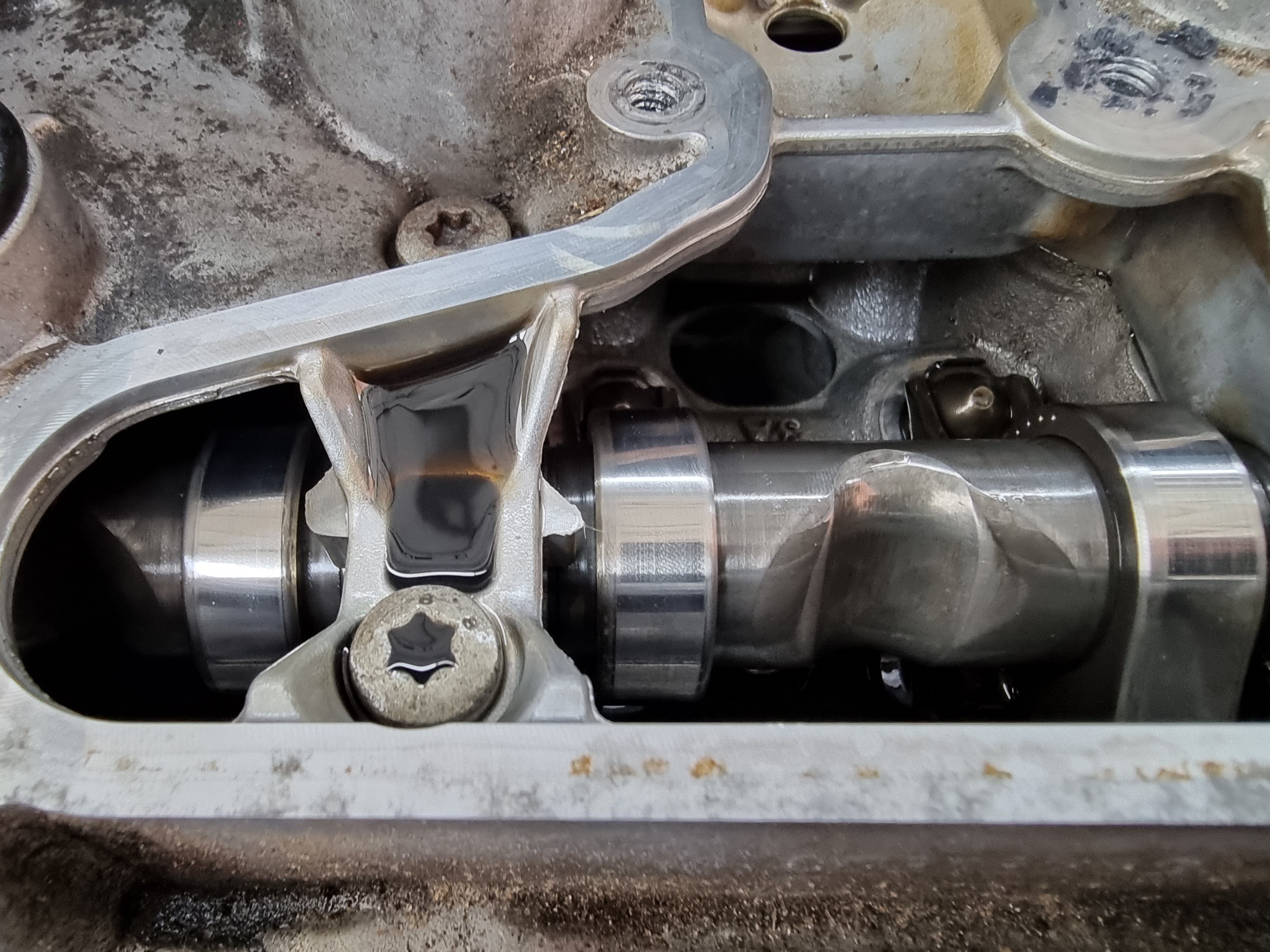

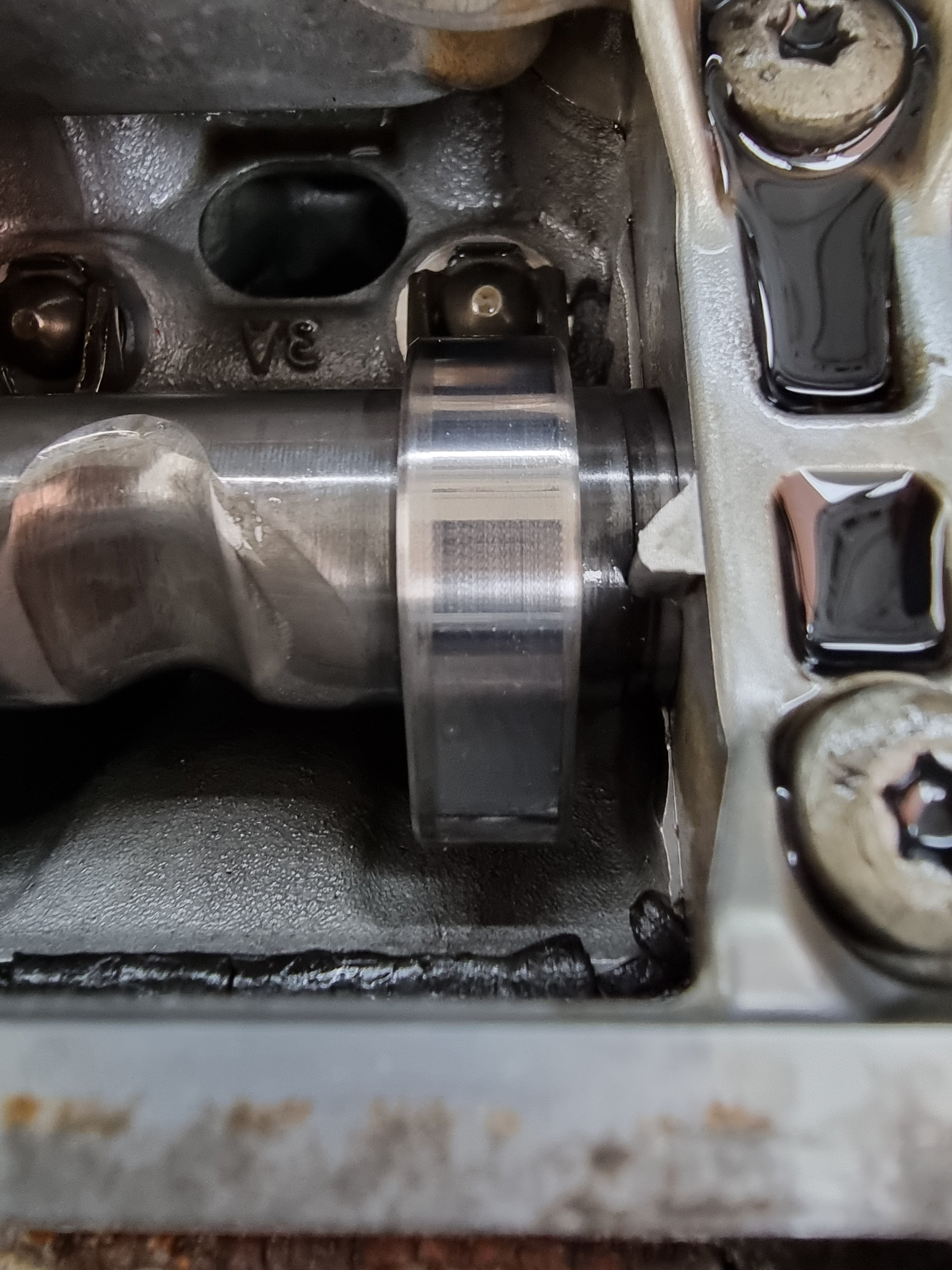

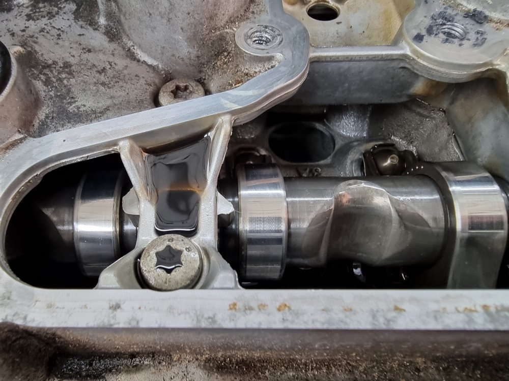

2011 vrs
CCZA with 60k on it, have a bumper to bumper 6 month warranty on it.
Skoda UK say no TSB and local Skoda dealer didn't want to quote a tensioner or price as for fitting-which is odd.
Do I drive on and just before end of warranty get it changed and if it blows in warranty so be it?
Confused dot com my mate took a photo below which I think is original 2011 unmodified part?
IMG_20220318_134338.thumb.jpg.77f92a51f2fae024a3c0d9f697d6afe6.jpgIMG_20220318_134338.thumb.jpg.77f92a51f2fae024a3c0d9f697d6afe6.jpg
