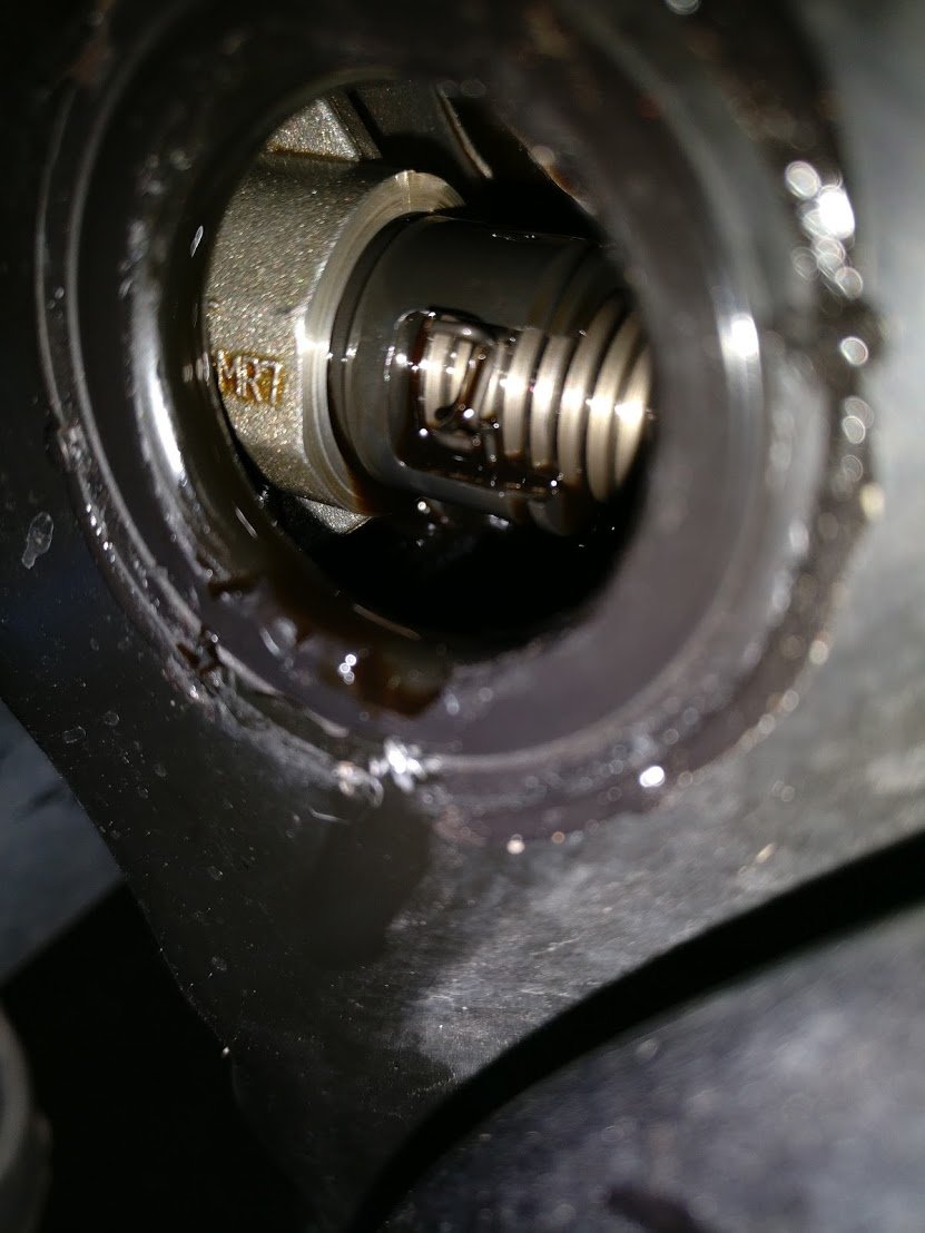

I've got a 2012 vRS TSI. Took it to a well-respected indy near me who've said I have the latest tensioner in there. My car was registered late March, so built Jan-Feb probably. No sign of any replacement in the history I have.
I'm just a bit paranoid I guess, but could it actually be the latest 'K' revision in there despite this one apparently not being available till May?
Crawled around on my back this morning, quite simple to get to actually, just a bit fiddly.
It would appear that I do indeed have the latest revision in there!
