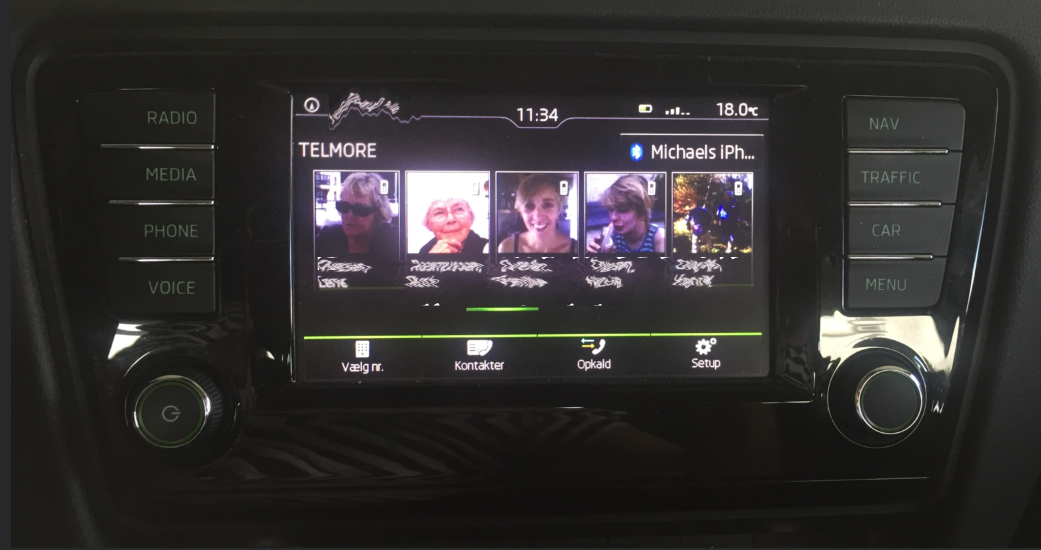

I am a Iphone BETA user on IOS 11, and have now tested it on my Škoda Auto Amundsen Infotainment system 2016.
After upgrading to BETA IOS 11, then iPhone contact pictures are now shown on the Amundsen display as you can see below. This is NOT possible on IOS below version 11.
Note you have to add the Favorites contacts again to get the pictures on the below screen. Contact pictures are there automatic from your Iphone.
Do note this feature is not yet public available to iphone users, but IOS 11 is expected to come later this year.

Having installed the final(?) beta of iOS11 today I can confirm that contact photos appear on a MIB1 Amundsen too.
You do have to delete and recreate your favourite contacts for the photos to appear, but you know it's worth doing as the photos appear in the list of contacts now also.
