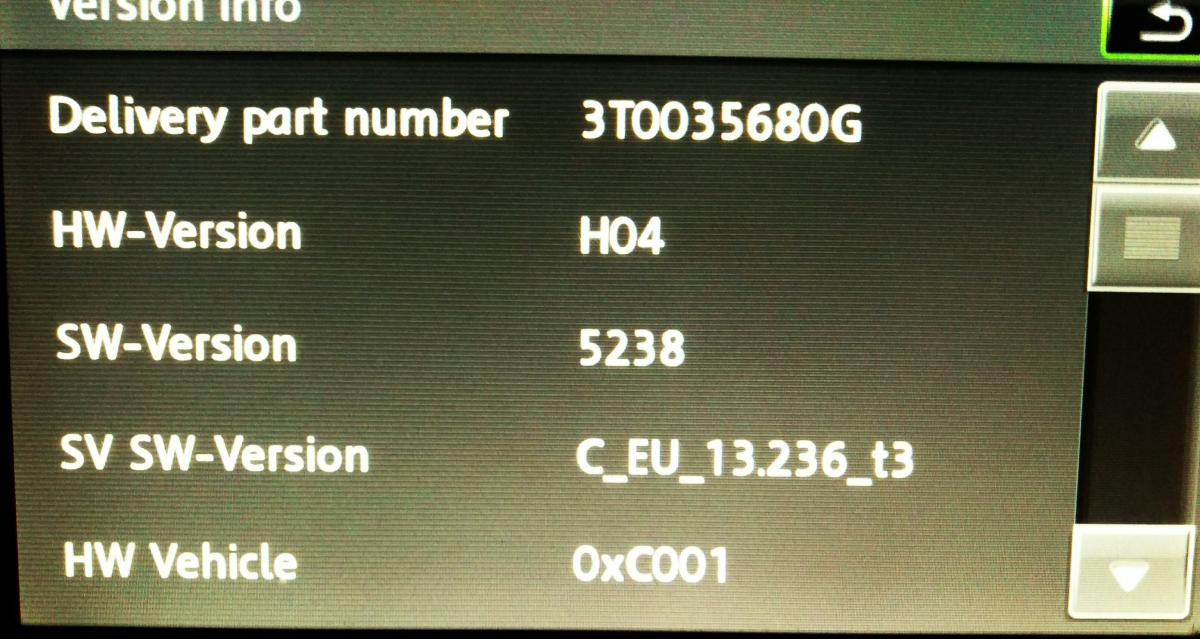

Hy, I have just updated yesturday from that sw to 4020 and it worked perdectley, now I'm going to update to 5278. I just need to find someone in torquay to help me with a vcds coding to activate my maxidot navigation.

I just wanted to try the newer sw because my mfsw command don't work and and i only have the setup and mdf on maxidot. If anybody in torquay can help me with a couding in vcds(as i suspect that is the problem) can contact me on my mail [email protected], I will leav it at 4020, if not the upgrade sames the onky chance for me to try and get the mfsw command to come back.
I think i have seen a post here, somebody said that after going for 5269 original, he got the mfsw and navi on maxidot back.
If your unit is an old one then 5269 could probably kill it. Just trying newer SW isn't necessarily something I'd recommend unless you're happy to throw away your Columbus when it breaks. However, you've now changed from attempting to try 5278 to attempting to try 5269, which tells me perhaps you're guessing as to what might work and what could be fun. There is no 5278 firmware for a start.

Thank you for the quick reply rusty. I'm not trying to see what is fun....I'm simply frustrated. When i got the car it had 1004sw. I hod for a brif moment the sat nav on the maxidot, but disappeared by it self as i was driving from the dealer back home. I don't know if it is down to coding or wireconection of actual buttons. I was hoping that this upgrade will fix it. I also tried the skoda fix sw and still nothing. Now I don't want to end up with a brick and if you don't recommend 5269 I will stick with 4020. I don't care about the radio txt. The unit come with the car from new.
This info is on the unit:
Hw :H04
Sw : 1004
The unit was a 1z0...680a and has become a 3t0 after the upgrade.
The sw upgrade is actual 4024 not 4020 sorry about that.
Any way if you can give me some more advice or help it will be highly appreciated.

The old 1Z0 units are very flaky, so don't play about too much. If the Maxidot was working and then suddenly stopped, then something odd is going on. As you suggest, it might be hardware related but not sure what. In any case, 40** firmware is okay, but if you really feel the need then 5238 is a catch all firmware. Where are you downloading your images from (don't link to it as some content is removed by moderators) as there's a few places, and some better than others. Some places are even hosting US based firmwares which would not be good to use.
Can't remember exact the web site but rns firmware or my-gti. The 2 websites sugested on this topic.

Update report. Just upgrade to 5238 with succes and i have the proof for it. Special thanks to rusty.
After that I used the skoda fix but that didn't solve the mfsw problem so will have to pay a visit to devonutopia vir a vcds scan and maybe coding.
