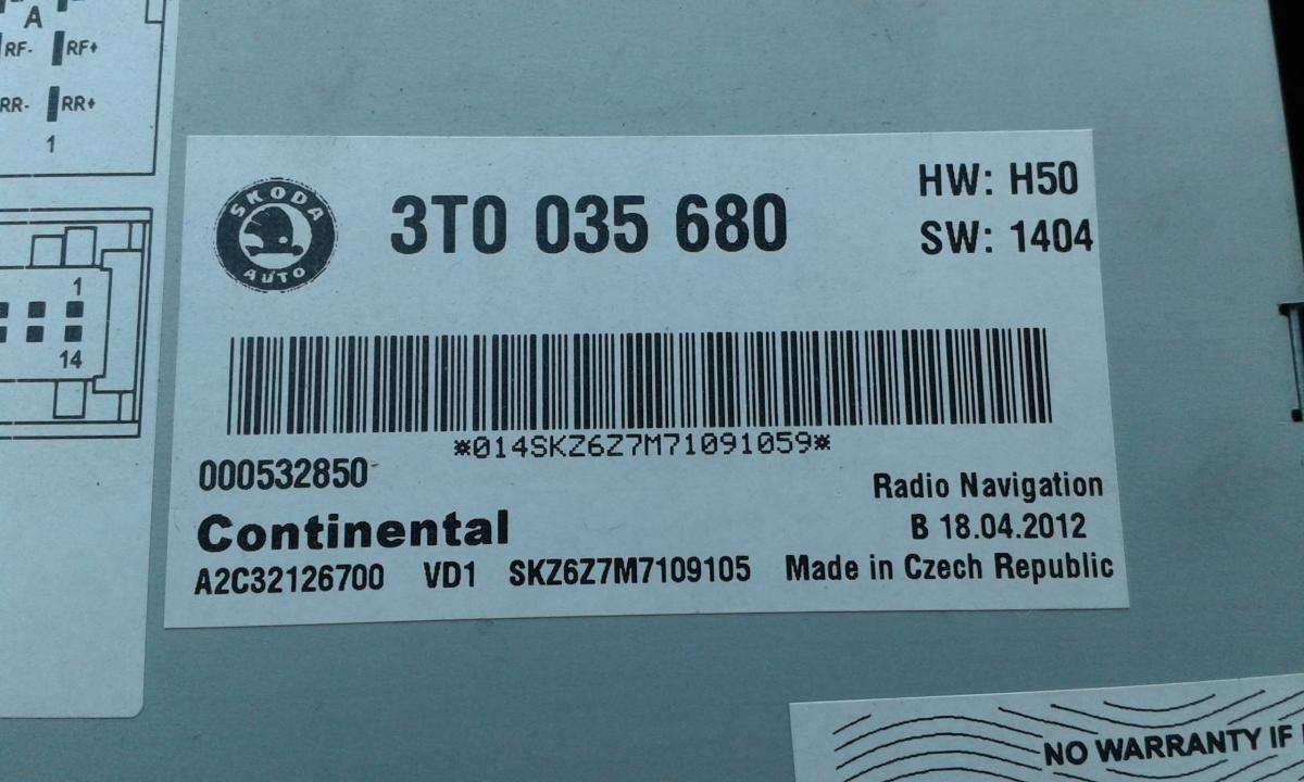

Here is the label from my Columbus (see attachment)

Yes, yours is an old unit.
IIRC 3980 has three partitions, it's just the POI & map partitions are not big enough on a 30Gb HDD for the latest maps (V.10 and beyond or earlier if speed cameras included).
If you upgraded to 3980 and you still have maps & music, then your unit was most likely upgraded previously to a version which had the three partitions. I'm not sure what you had, or why you've lost the Points Of Interest, or what you had previously regarding POI, but I would suggest loading on a version of maps which isn't butchered. The unit will accept or reject maps for any number of reasons and diagnosis is hard as to why without further info. Why did they fail to load?
