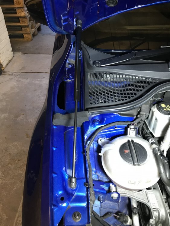

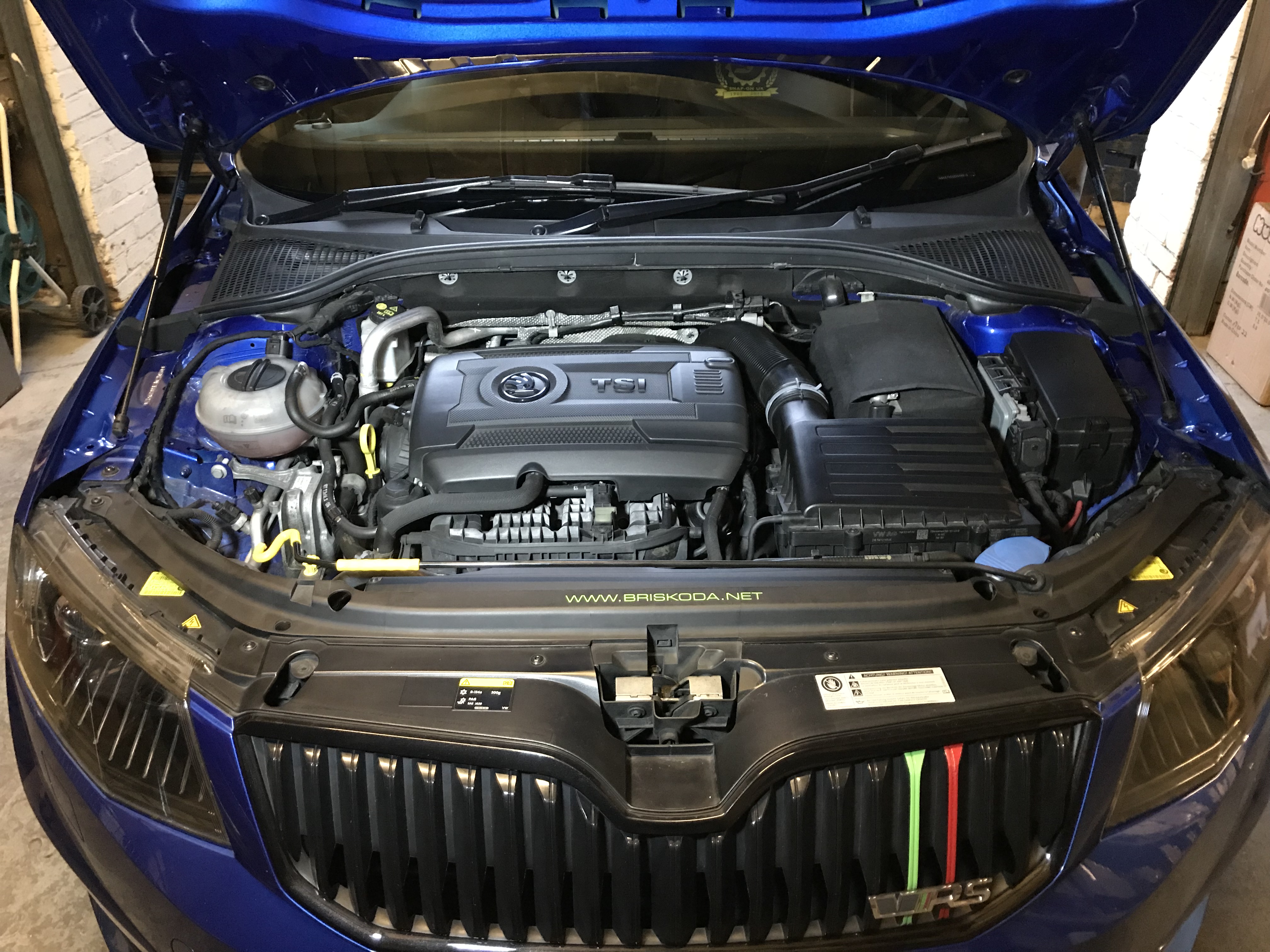

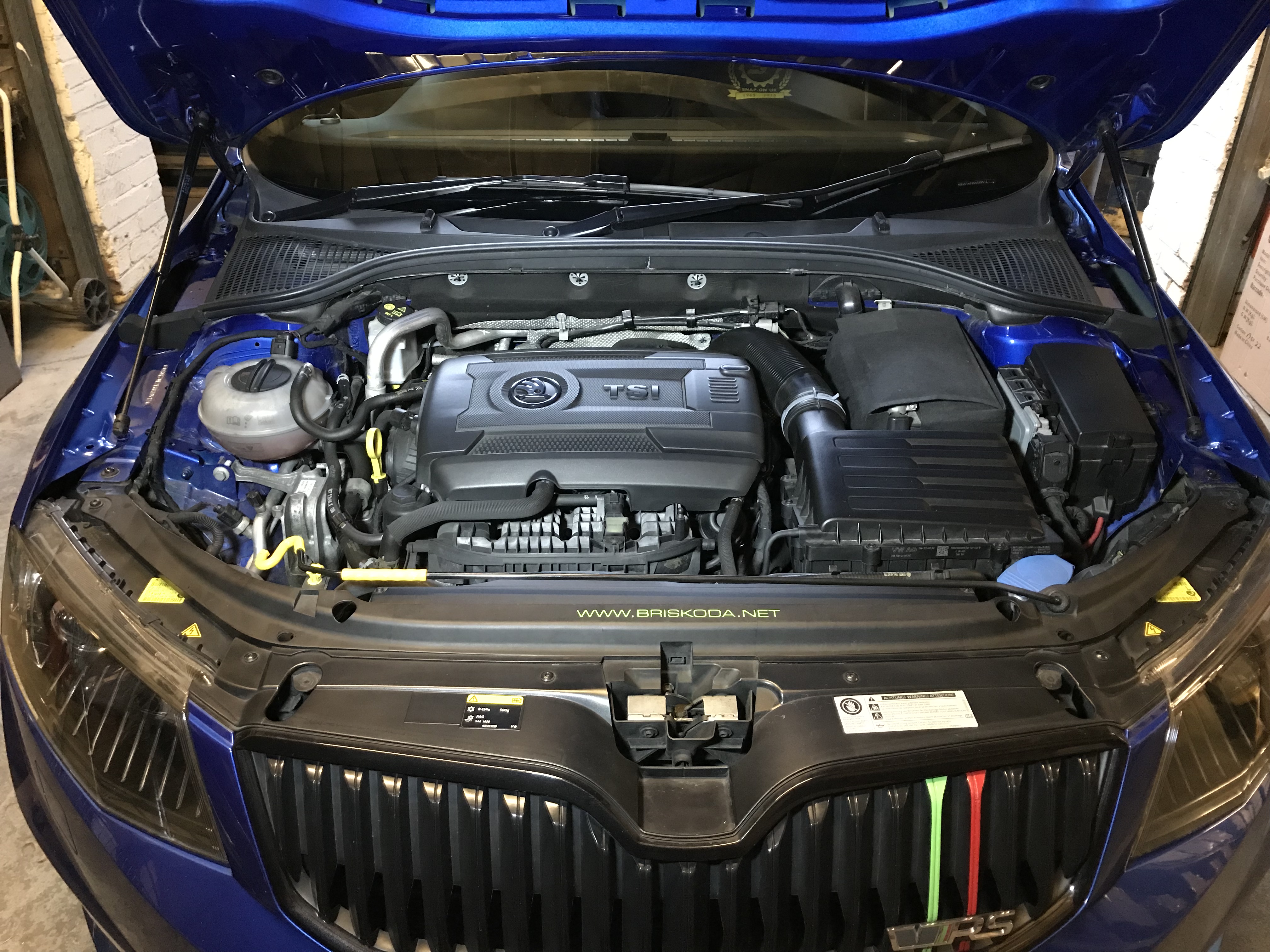

  • some folks on german forum as already came up with some part numbers for OEM stuff that is an alternative to superskoda hood dampers.   you can buy the ball pins from BMW: 2x M6 ball pin 41 62 8 18
  • No I went for Febi Bilstein ones. The Superskoda set came in about 50 euros including delivery and I read that they aren't quite as good. Would have taken longer to come too.   The Febi stru
  • Big shout out too @ahenners for your assistance & explaining what bits n bobs are needed to do this mod   & everyone else who has participated in this thread    Everything ahenners l
Thanks for the shout out @BATVANVRS  I just put together what a number of others collectively found across a few posts, into one post, that hopefully made it a bit easier. Glad I could help though! :)

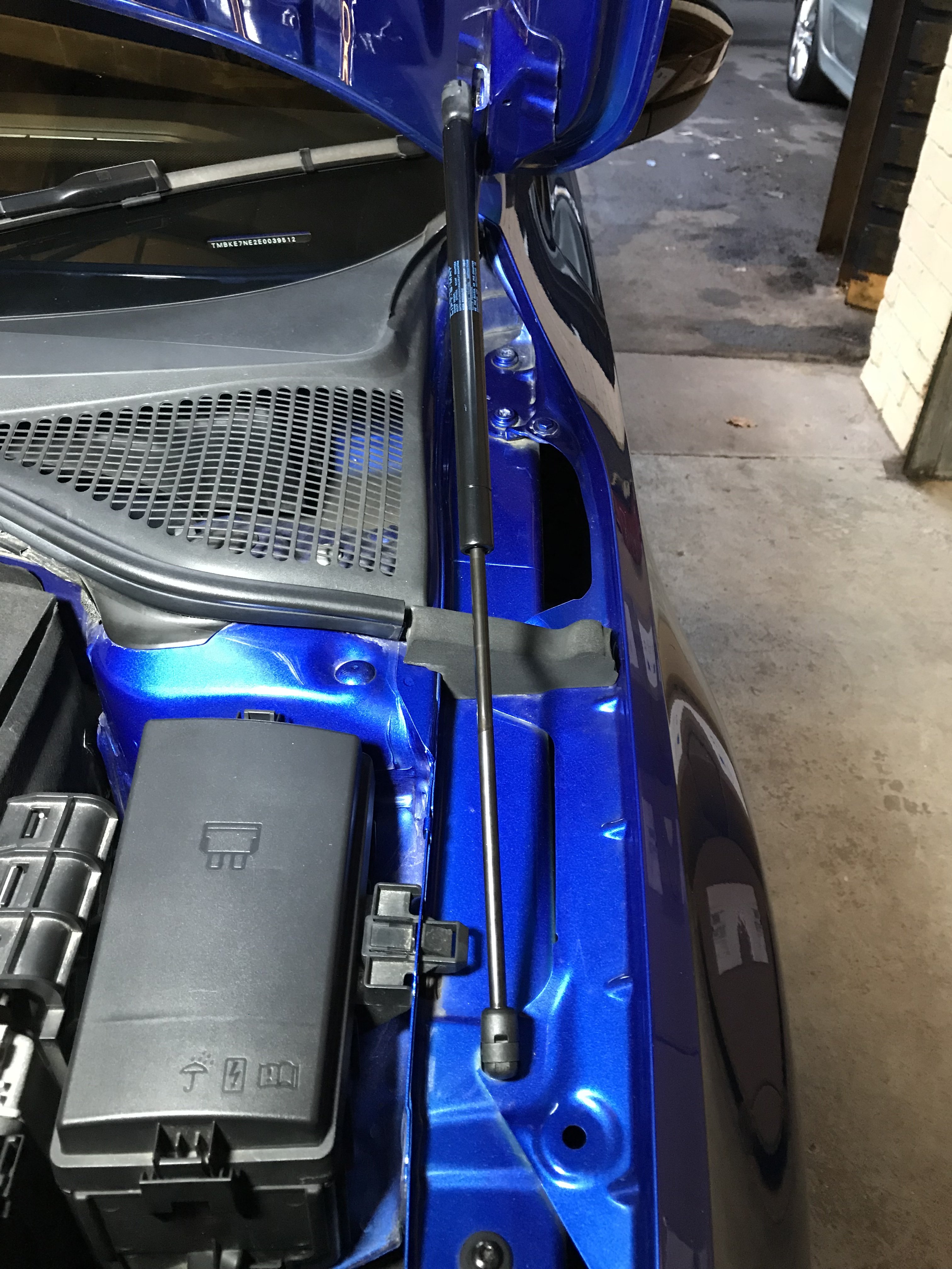

The Febi struts are perfect in strength, they can lift the bonnet unsupported after initially lifting it. They slow before they come to a stop at maximum extension too.
2x Febi Bilstein 27709 struts. About £14 each from an eBay motorparts seller.
2x M8 ball joints with a 10mm ball head and 25mm thread length: https://www.sgs-engineering.com/x4-ball-extension
2x M6 ball joints with a 10mm ball head and 12mm thread length: https://www.sgs-engineering.com/x2-ball-extension
Above ball joints came to a tenner with delivery.
2x M8 and 2x M6 washers. Bought from an eBay seller for a couple of quid.
You also need an M10 spline bit to undo the bolt on the bonnet which I didn't already have.
Painted the washers and ball joint bolts with a touch up kit I already had to make them blend in and look more OEM.
Total cost probably about £42 but happy with the result.
