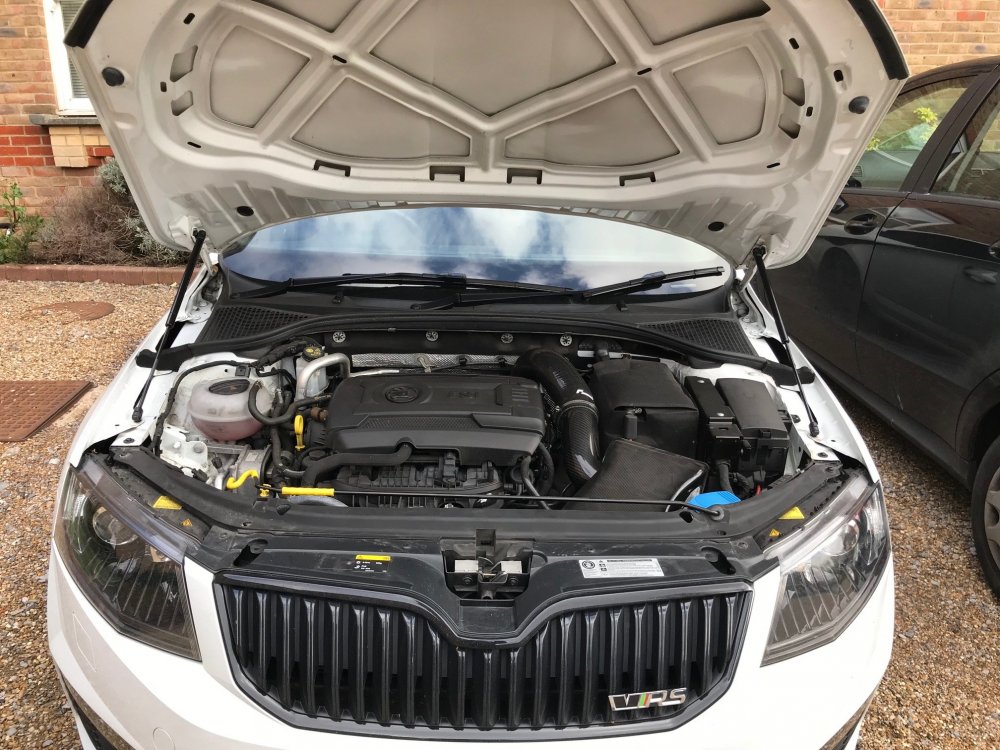

Thats mine done this morning :cool:
Definitely one of my most best mod's done to date, every time I open the bonnet, I just love that feeling of the bonnet rising B)

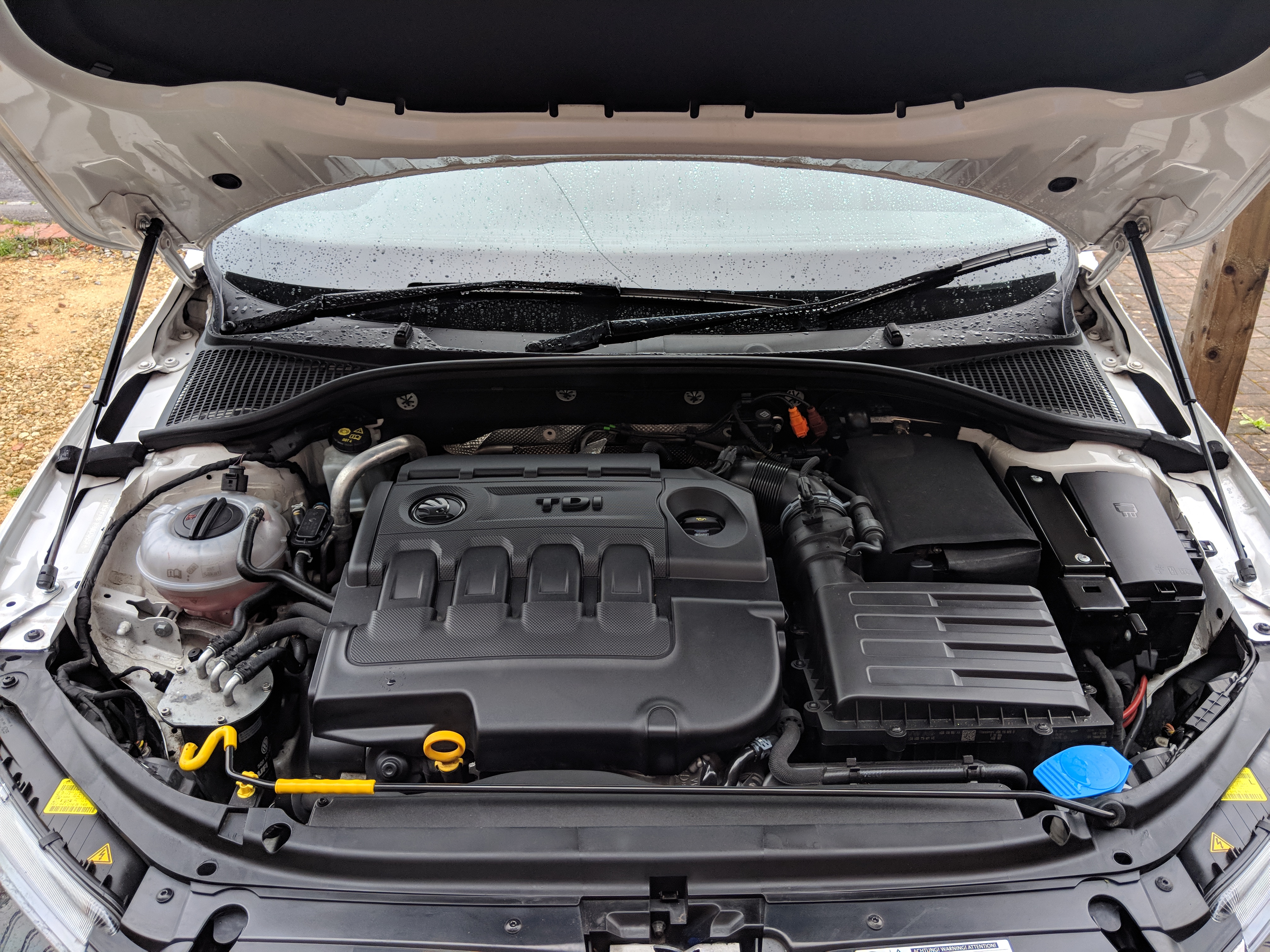

Fitted the bonnet dampers today with a friend of mine, basically he actually did most of the work as he likes to do things (hands on type of guy) takes charge etc :biggrin: B)
Painted the bolts black & the washers race blue & fitted the bonnet dampers, all in all took a good hour from fitting & including spraying the bolts n washers etc.
The bonnet feels so much more solid on opening & closing, this is one of those mods that once done makes you think “why didn’t I do this sooner” anyways enough of the chat & a few more pictures.

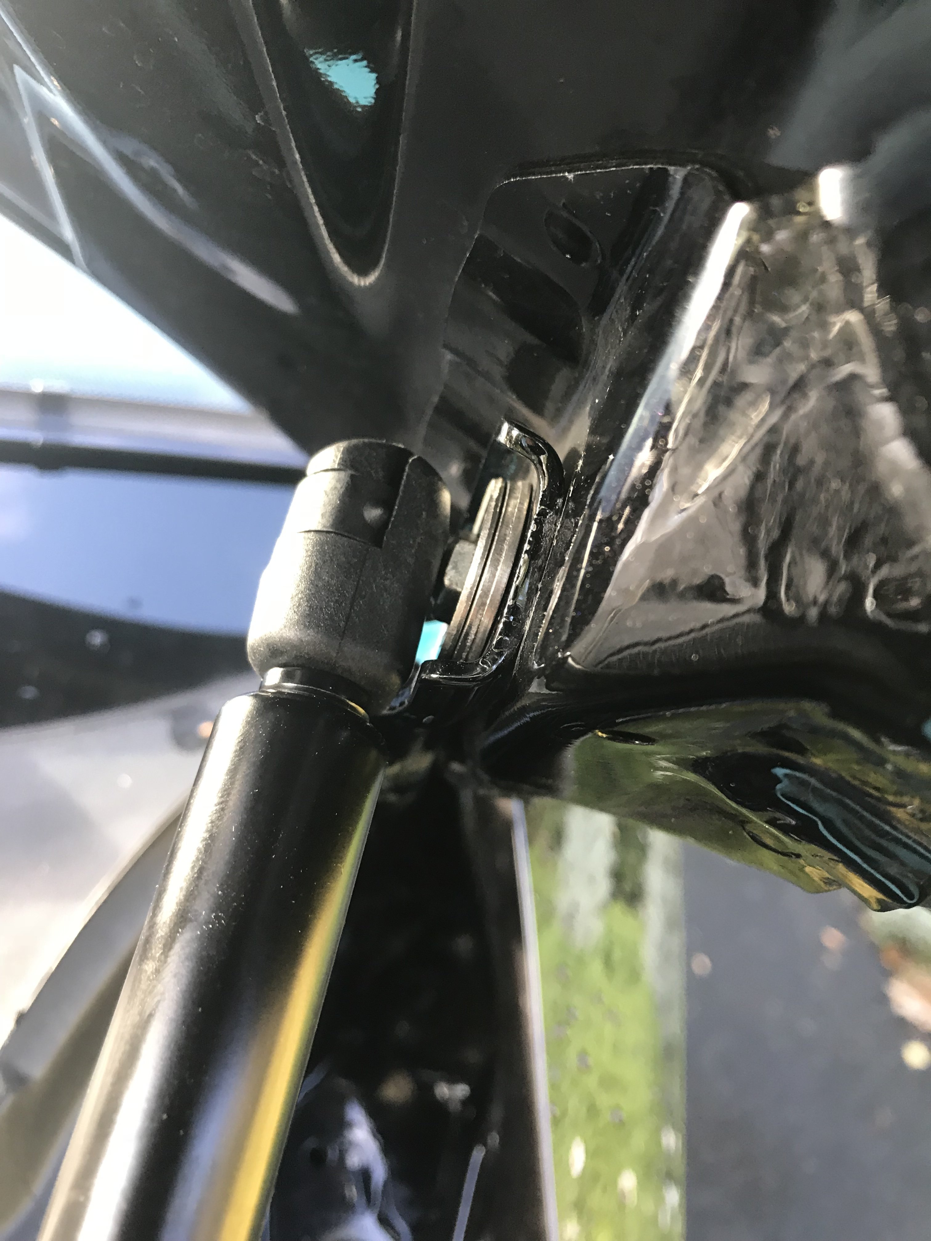

Success at last, the second strut finally arrived from Germany this morning - mounted straight onto the ball pins with a little lithium grease and job's a goodun.

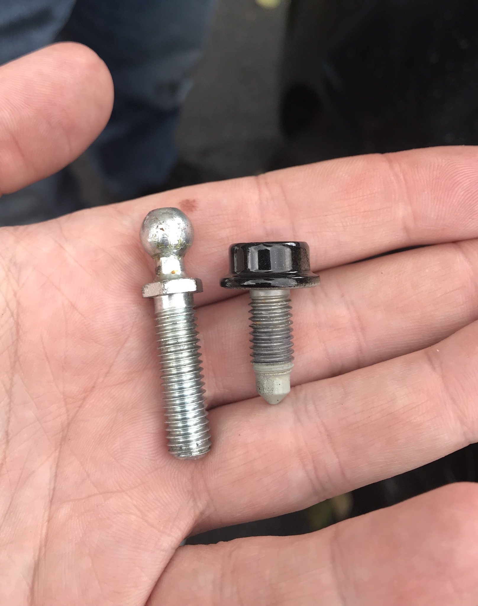

Fitter mine today. Was surprised the recommended M8 bolts were so much longer than the factory bolt? Maybe mines different as it's mk3 face lift?
This worked to my advantage in the end as I had to add 3 washers to get clearance of bonnet bracket.

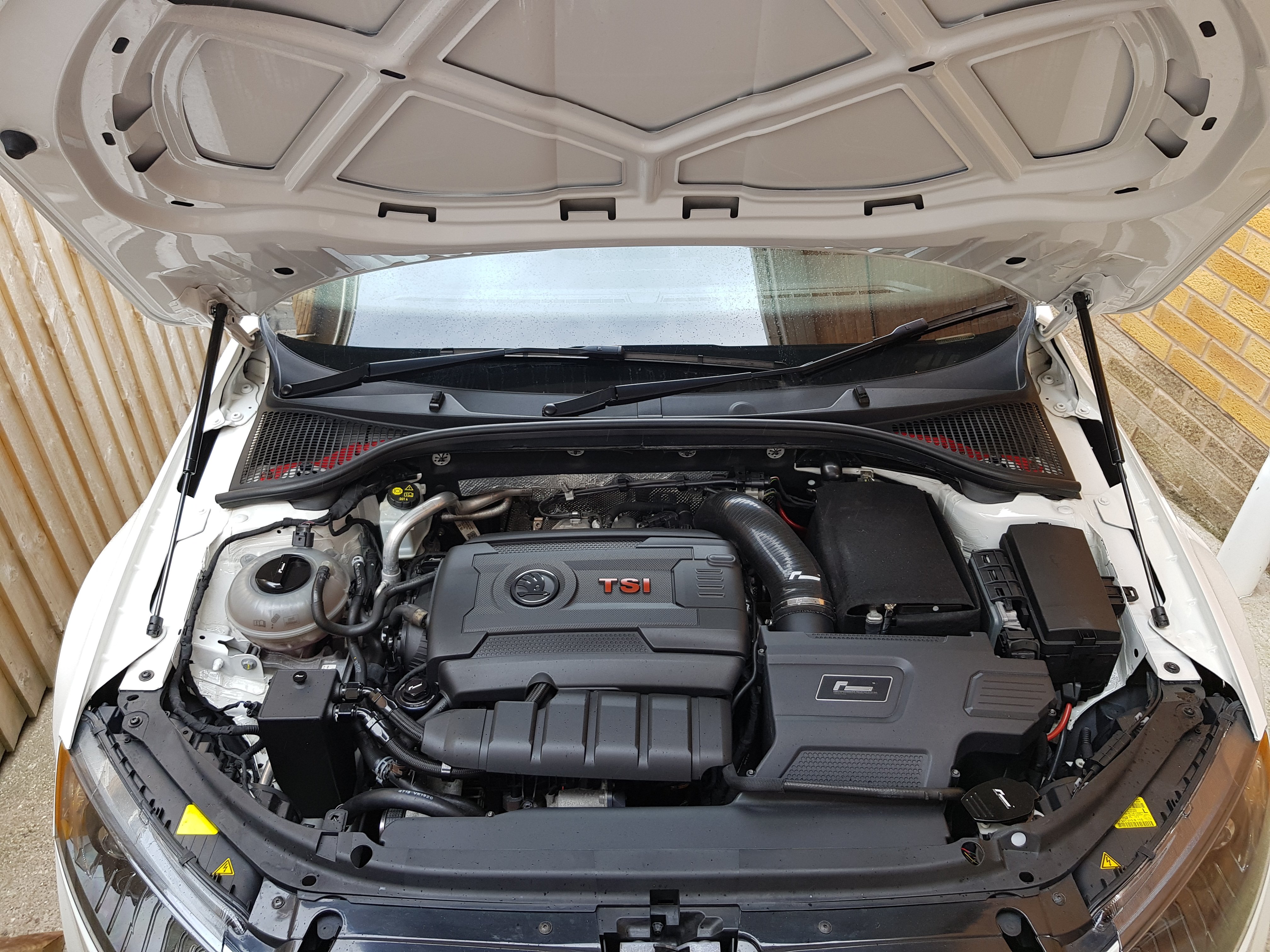

Late to the party, but massive shout out to the forum (and @ahenners in particular for collating info) for bringing this to my attention.
Opens like a dream, and feels a little better quality. Yet to fully remove the old prop - but 'til then I'll explain that it's a continuity measure... despite the fact it's not possible to use it. SHH!
Obvious point, but appreciate the advice to paint the parts as this does make the black / white (and yellow) motif work very nicely :cool:
