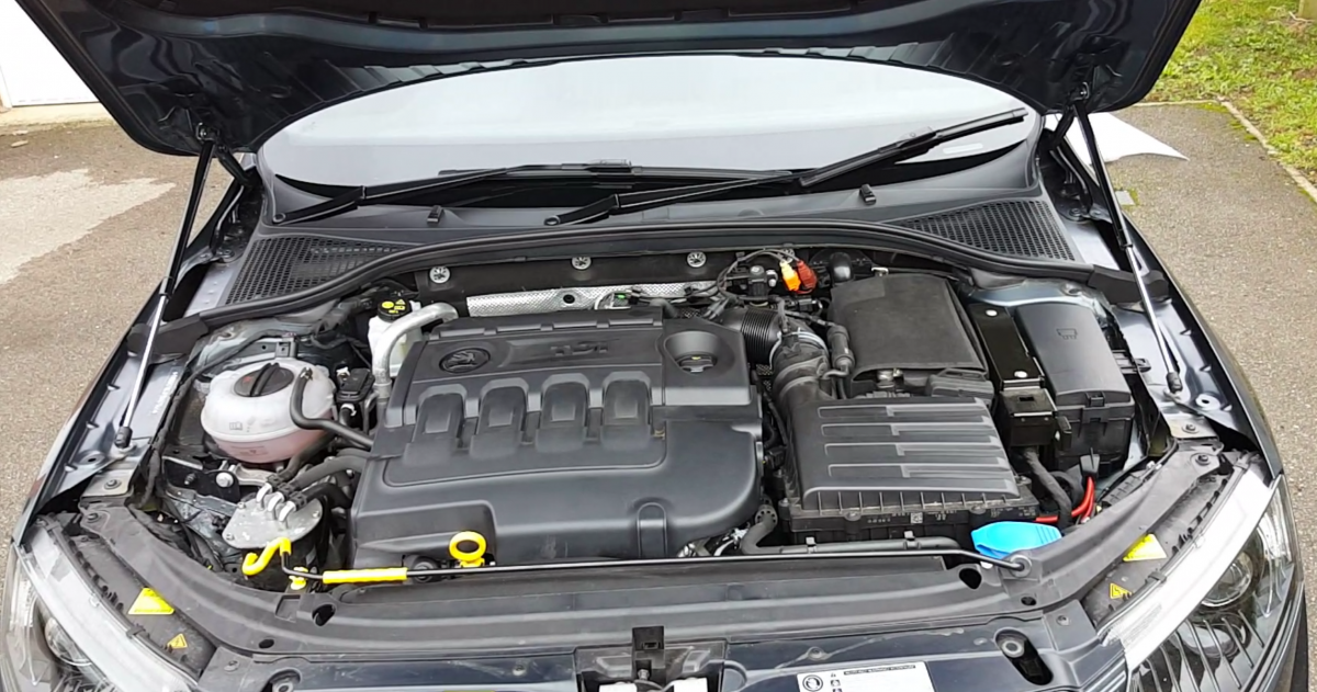

I fitted mine this morning, really really simple. post-41690-0-94713900-1477078002_thumb.png

Success at last, the second strut finally arrived from Germany this morning - mounted straight onto the ball pins with a little lithium grease and job's a goodun. Really pleased with the way that the weight of the hood is picked up once it's about 25% open, then gently comes to a stop on full extension. Just need to apply a bit of touch-up paint to the base of the ball pins. I'm inclined to bin the old support stay as soon as I'm happy that the new struts aren't leaking.
