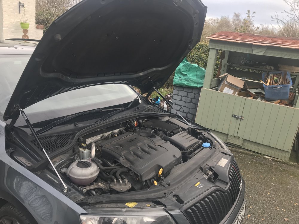

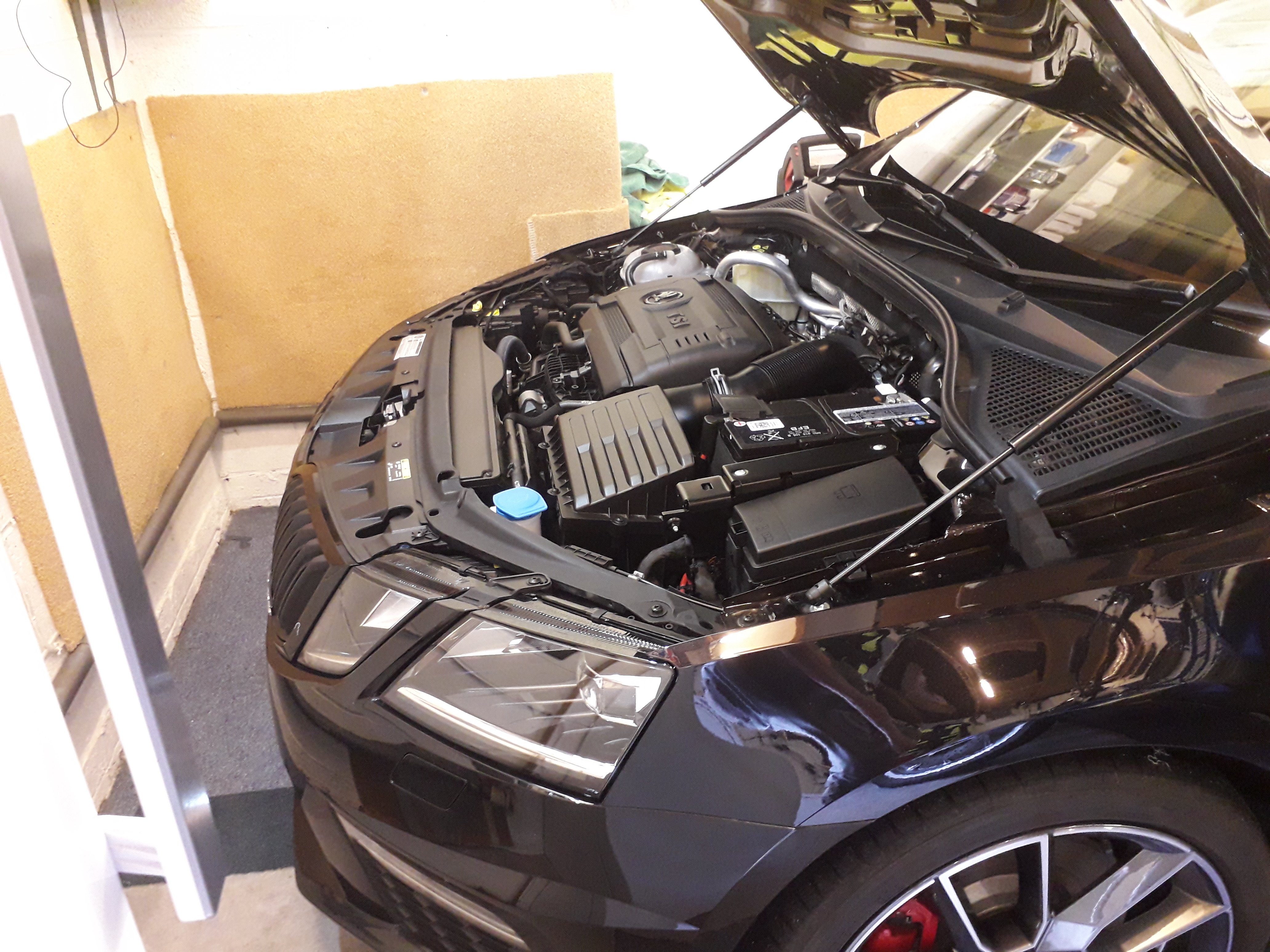

Just ordered the parts for my FL 245 Estate based on ahenners excellent guide on page 3 (thank you!).  I've bought the struts off Opie Oils using (a different) forum discount, and the SGS ball joint thingies.   I've had a "test" undo of the parts under the bonnet first.  That's next weekends projects sorted, I've got some wire on order to hard wire my dash cam as well.  Best go and clear the garage ready now.......🙂
Job done.  It just looks and feels so much better.  Why on earth didn't they do this as standard........😕
Edited by Phil245
One of the best mods I have done so far...
Thank you for all the information, guys.
Shout out to @ahenners for the comprehensive information on what to buy and all that.
Here's mine...
You need to take the old prop stand off now, it will look so much neater......👍

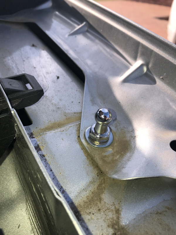

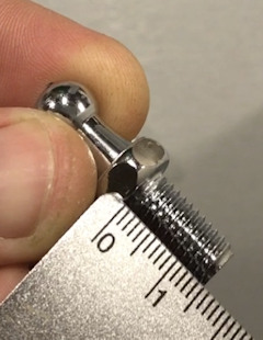

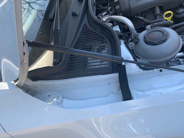

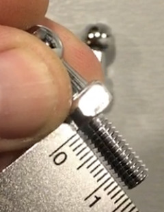

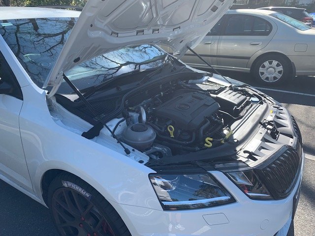

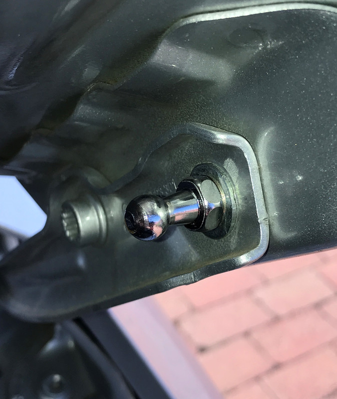

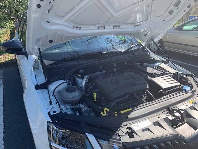

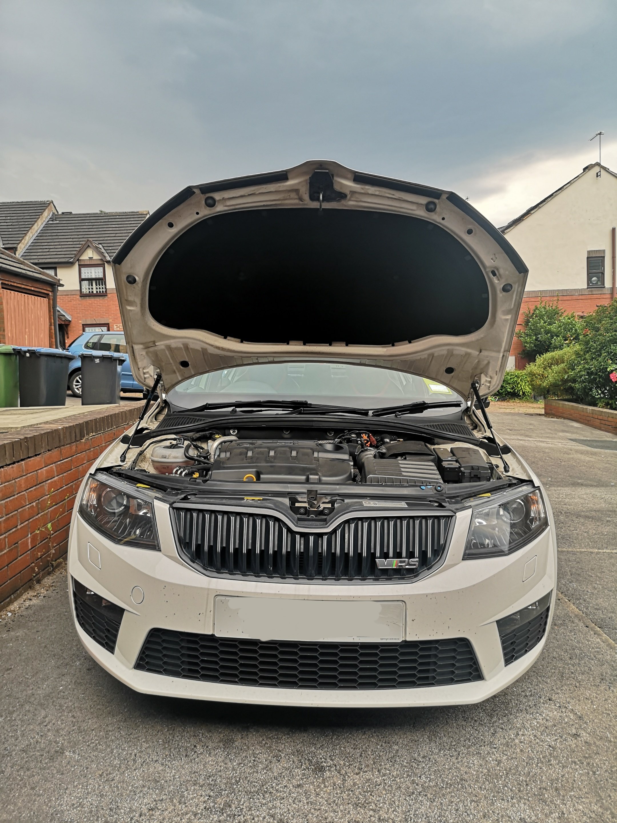

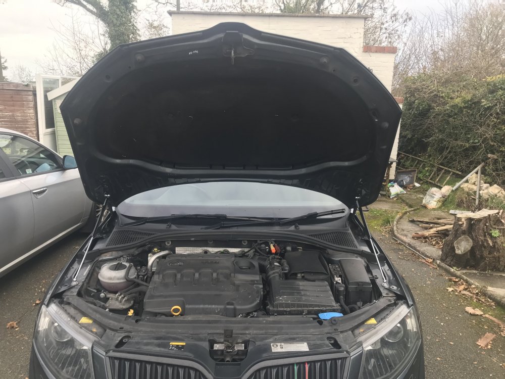

I have just done this mod on my MY19 Octavia.
Parts I used:
- 2 x M8 ball joint (thread length 14-15 mm): https://www.aliexpress.com/item/32925255326.html?spm=a2g0s.9042311.0.0.27424c4dqkYWSU
- 2 x M6 ball joint (thread length 14-15 mm): https://www.aliexpress.com/item/32975903867.html?spm=a2g0s.9042311.0.0.27424c4dqkYWSU
- 2 x smaller diameter washer
- 2 x larger diameter washer
- 2 x cheapest aftermarket Ibiza II boot dampers (Loro 101-00-070)

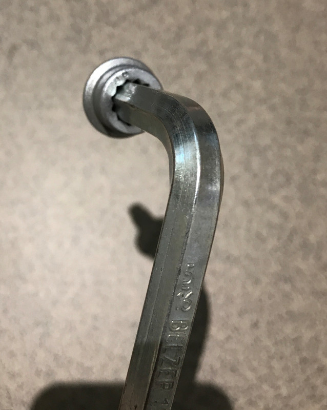

To remove the hood screw I used a 5/16" hex key. It fits absolutely perfectly, even the factory paint on the screw head remained intact. It's wasn't too tight.
The cheepo dampers are working fine without any unusual noise. Let's see how long will they last. :giggle:

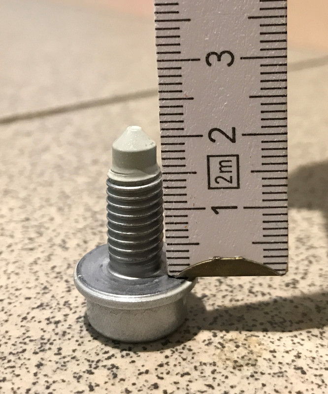

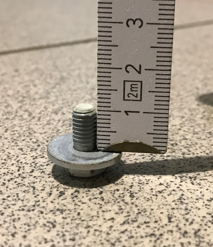

As you can see the original fender (hex) screw is quite short, the ball joint thread is longer but it still fits.
In action:
Some pictures:
